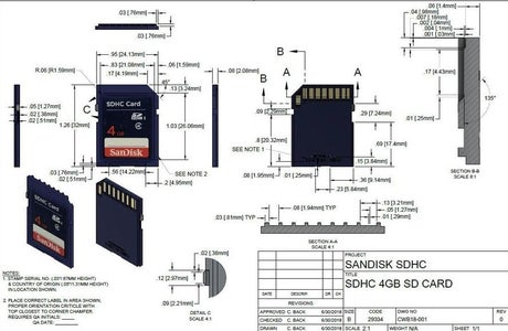

I took some serious measurements of the SD Card for about an hour, only to later discover that the exact dimensions are available on Google 😑. I have attached them above for you!
Well, coming to the point - I took all the dimensions and then exactly upscaled them 5 times, except for the thickness as that would be too thin even after a 25x upscale and the hard disk drive wouldn't fit in.
I even upscaled the connector slots that are available on the back of an SD card, used for data transfer so that the project would look even more professional. I also upscaled the sticker that is present on the front of an SD card in the same ratio.

I kept this in mind and I had already taken the measurements of the small SD card and calculated upon what the new upscaled dimensions needed to look like. This made the process a whole lot easier.
So what I generally do for these kinds of enclosures is I first design the bottom part and the lid as one solid piece and then I duplicate it and then convert one of them into a bottom part and the other into the lid by slicing them up into halves. This is the exact workflow that I followed with this project too.
I tried to replicate every tiny detail as much as possible. I also put some screw holes so that we could later screw the lid neatly and firmly in place.
