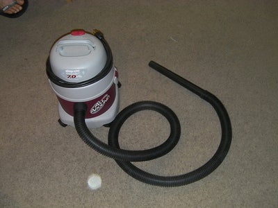

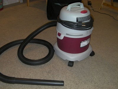

My project is a lot simpler but the principle still holds. Instead of using industrial powerful vacuum, I instead used a domestic Shop Vac Vacuum Cleaner as my main source of propulsion and some acrylic tubing and pvc connectors and masking tape to build the frame. And it works!

Shop Vac Vacuum Cleaner (with nozzle) Masking Tape and Duct Tape

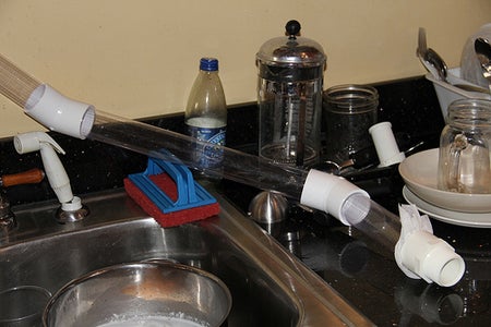

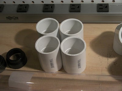

Step 3: Cutting and Measuring

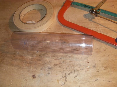

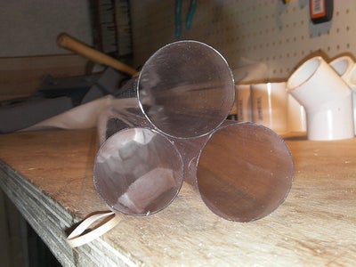

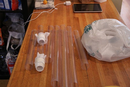

Let's begin.  First, cutting several lengths of your Clear Acrylic Tubing for the transport frame.  Depending on where you want your transport system installed,  you'll probably want to cut different, longer lengths than I did.  However, just for this conceptual build, I made two 3 1/2' lengths and three 3' lengths (total original tube length 18' 6'').
Begin by taking some masking tape and wrapped it around the cutline of each acrylic tube. This creates a secure hold so your hacksaw won't move around too much when cutting.  Finally use the Sand Paper to flatten any rough edges.
Regardless of your frame, you'll also want to cut two 12 inch lengths for the Containment Chamber.
Note: Remember to mark how far into the PVC connector piece each pipe goes.  I measured 3 inches.

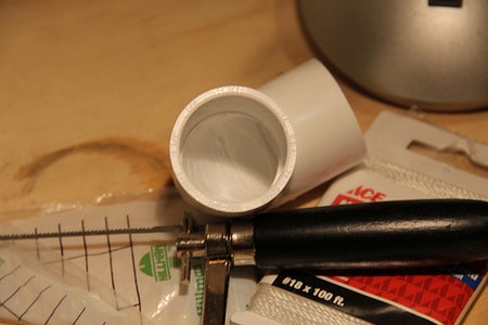

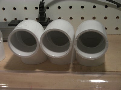

Step 4: Dremeling Inside PVC Connector

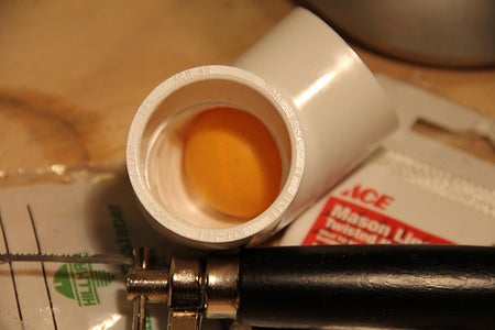

Because I'm using PVC Pipe Connectors instead of actually bending the pipes, as professional ones are constructed, slight adjustments need to be made.

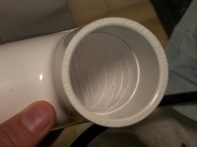

For the 90 degree angle connector piece, depending on what you use for your container (or even if you decide to use one at all- I at first used mine to transport raw cereal to a bowl), you might need to dremel the insides so it can travel in and out smoothly.  Since I opted out to use a ping pong ball for my tests, instead of a capsule, I used Instructables' 10 Speed Dremel (WOW) to hollow out the insides.

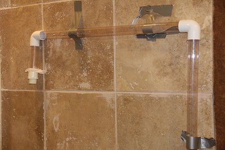

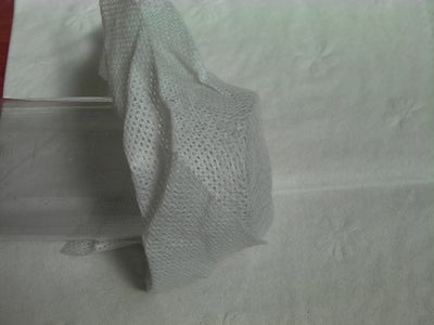

Step 5: Containment Chamber

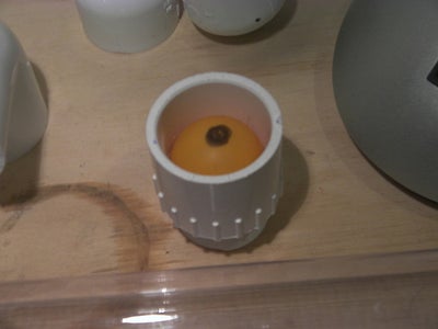

In this next step, we will be constructing the pneumatic airlock chamber that will house the item you wish to transport, be it a ping pong ball, M&Ms, cereal etc.

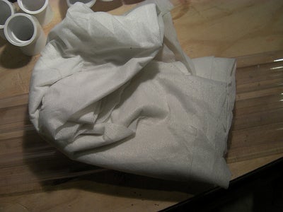

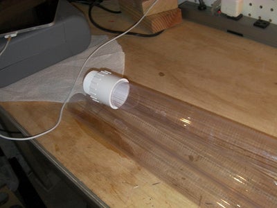

Cut a small square from the Mesh Lining and wrap it around the bottom of the the 12 inch clear acrylic tubing we made in step 3.  Then cap it off using the PVC Scew On End Connector.   The final result will be a simplified air tight chamber with a mesh filter to prevent your objects from being sucked into the vacuum cleaner.
You'll be building two of these, one for the Beginning Chamber and an identical one for the End Chamber.

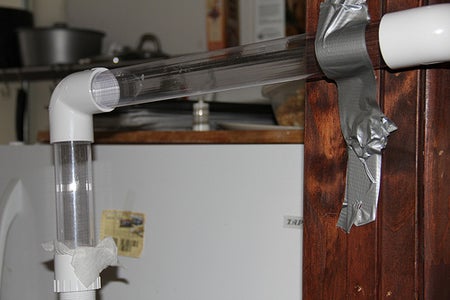

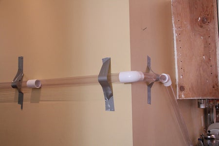

Step 6: Building the Frame
Now it's time to put everything together. Ever played with Tinker Toys when you were a kid?  This is a lot like that except less colorful, less pieces and it's not a toy.

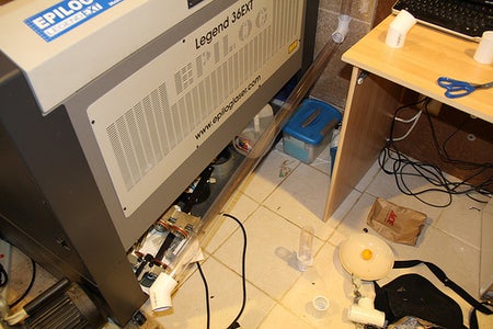

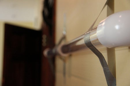

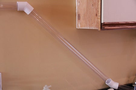

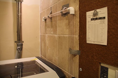

The PVC Pipe Connectors should all fit tightly and evenly around the clear acrylic tubes, so you should have no trouble connecting them together to build your simple frame.  Attach the Containment Chambers at each end of your system frame, and then using Masking Tape, tape around the edge of your Shop Vac Nozzle Hose so that it can fit into the bottom of the chamber.  Lastly, you can use duct tape to secure your frame to the wall.

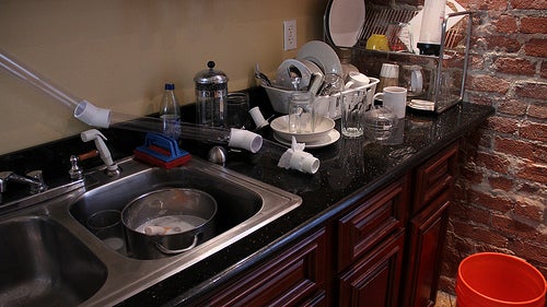

Step 7: Begin Testing!
"Like shooting Ping Pong balls through an Air Conduit."
Finished!  You now have a very efficient Pneumatic Transport System, perfect for rapid across deliveries or transports!  Go ahead and try transporting a bowl of cereal, M&M candies, jelly beans,, Mentos, anything you want across the room at lightning speed.
