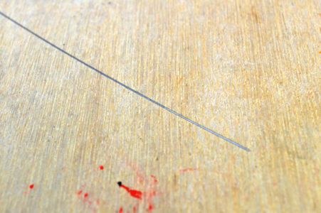

1. Push the wire through the fish. Keep it low on the fish and somewhere near the middle.
2. Once the wire has been pushed through, bend the end again so you make a “U” shape. Then push the end through the fish again. It’s a little hard to explain but I’m sure the images will be self-explanatory
3. Next, and this is an important bit, you need to decide what the turn radius will be for your fish. Too much and he will hit the sides, too little and it will look a bit silly. In the images below you can see that I only left about 10mm and then bent the wire so it was pointing up. This was too small. The ideal length of the wire is around 15mm.
4. Lastly, (and this isn't something I did initially but worked out later) you will need to slightly modify the tail. I found that if you add a little bit of super glue to the side of the fish and stick the tail to it, then it won't touch the sides of the globe. I had to trim down the tail in my initial one (which worked fine as well) but gluing the tail was a lot easier. You add the glue right where the tail joins to the fish and bend the tail slightly so it is touching the glue. Hold in place for 20 seconds and it should be well stuck together.

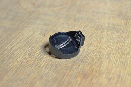

This is a pretty simple step but critical if you want it to fit inside the light socket
Steps:
1. If you try to add the battery holder without moding it, you won't be able to screw the bottom of the socket on. Get your dremel out and remove some of the section shown below.
2. Place inside the socket to see if you can screw the bottom on. Keep on sanding back until it fits.
