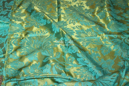

Let's talk fabric.
If you get fabric that frays, you'll need to do hemming on the edges to finish it off...like the robes I did.
If you pick out something that doesn't fray, you don't even need to hem those edges! Imagine how warm you'd be in a fleece cape!

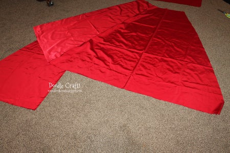

I used my mad photoshopping skills to make a basic pattern guideline.
Because I was making these to fit adult sizes, I used large amounts of fabric...but you can scale it down for any size person.
Keep your fabric folded in half like when you buy it.
(the right side of this picture is the folded edge)
60 inch width fabric made this perfectly flowy!
I used all the width at the bottom and tapered it up to the top.
2 pieces are separate and cut on the selvage edge.
1 piece was cut on the fold.
3 pieces for the cape.
Measure from the base of the neck to the floor for the length measurement.

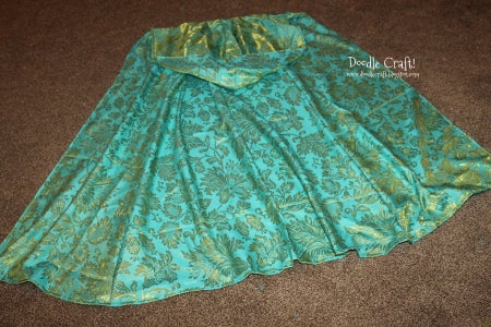

Step 4: Sewing!
Then take the 3 big pieces and sew the diagonally cut lines together.
2 long straight stitches.
Stitch on the tapered edges to sew all 3 pieces together.
Then I rounded off the bottom edge and hemmed it.
As well as rolling that selvage edge and hemming the sides.
(again, not necessary unless your fabric frays)

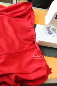

Step 6: Attach the Hood to the Cape!

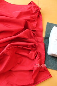

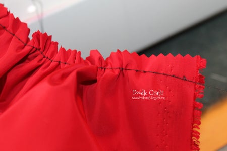

I gathered the top edge of the cape just enough to fit the width of the hoodie.
Then I pinned it in place...yes, I rarely use pins...but this is a must!
Pinned so that the 2 pieces are the same width. With just a subtle amount of gathering to make up the difference.
Then I sewed them together on the underside.
I knew I wouldn't wear the hood up all the time and I didn't want the seam to show at the neck...so it's on the backside, but even with the hood up it covers the hem.

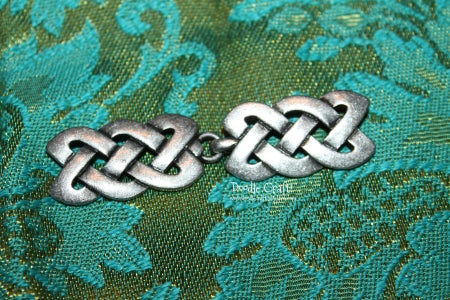

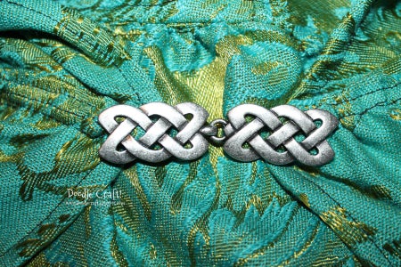

Step 7: Cape Clasp...the Crowning Piece!
The crowning piece, I knew would be the clasp.
Belle's was a cool Celtic knot of pewter.
I bought one just like it on ebay for about $10.
I really just typed in "Celtic knot clasp"
It just hand sews on like a button.
For Red's cape, I used an old belt buckle and sewed it on with some ribbon.
You could get fancy and make one with wood or clay...
or just use a button on one side and a loop of cord on the other.
