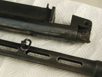

This is a Parts Kit. You can find them for under a hundred bucks if you get lucky. For a replica props builder, this looks like a great place to start for a non-firing display model of a period firearm. All the parts are complete. Everything, in fact, but the receiver.
When these are imported into the US and prepped for sale, the receiver (usually, but not always or only) is chopped into several pieces to render it non-functional. At one point this was done with a saw but BATF realized it was too easy for an industrious person to weld the bits back together. Now it is done with a plasma cutter, with long diagonal cuts that remove up to half an inch of metal with each pass.
So, what to do? I could carve a replacement receiver out of a solid block of wood. Trouble is, there are some tricky details that have to be just the right dimension in order for the other parts to fit back on. I could take molds off the parts of the old receiver, and create a master from those and raw dimensions that could be cast in resin. Trouble is, I wasn't sure resin was tough enough to support the weight.
I could fabricate one in aluminium. This seems promising, if it can bear the load. But there don't seem to be any detailed plans readily available, and with the original in little pieces I'm kind of guessing at the way everything fits together. Also, I don't weld aluminium. (Not yet, anyhow).
Which leaves a reweld. Even if I did chose to go forward with a different plan, I'd learn more about the shapes and dimensions if I could weld the jagged pieces back together in some semblance.

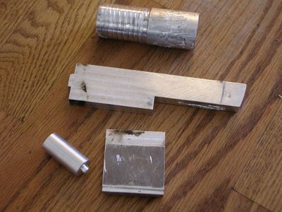

To align the parts for welding I wanted something structural. And I didn't want to use the actual parts, out of some quixotic desire to leave them pristine for the next builder to make use of. Historical weapon, after all, even if it was originally manufactured in large numbers.
So off to the mill, and the lathe. Oil-soaked wood might work -- might have even worked better -- but I chose to mill my elaborate "weld backing plates" out of scrap aluminium.
So the "bolt" sits in the chamber and keeps the various bits of the receiver tube aligned during welding. The "trigger assembly" sits between the side plates to keep weld metal from creeping in their as I repair the torch cuts made through that section. The "barrel insert" keeps the inside of the trunnion clean and the "magazine" is mostly there to protect the slot where the magazine catch sits.
Of course, I developed this as I went. I didn't even lean how to use the mill until after I'd made the first couple of welds -- so those welds were done with eye, strips of plywood, and lots of clamps.
And, of course, by the time I'd finished all these parts I'd done almost as much machining as it would have taken to create a new tube from scratch.

Turns out one of the flats I milled on the fake bolt is just slightly small or off; it catches on the lip of the drum magazine meaning it seats just a fraction too low to catch the magazine catch. It stays in pretty well, though, from sheer friction.
The take-down works, the trigger pulls, safety engages, barrel and shroud take down, the site ladder ladders. Even the cocking handle moves a little.
But that said, after all of that it is really a pity not to be able to cock and dry fire. This is a tough choice anyone facing a reweld has to make, really.
