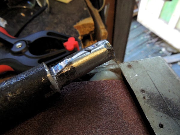

How to hold a wide bar in a narrow chuck
The bar was about an inch in diameter - way wider than the jaw capacity of the drill chuck. To get it to fit, I first had to hand-grind a step down in diameter at one end of the bar to form a narrower protruding cylinder. This would later become the screw thread used to attach the mandrel body to its base. Grinding this down took quite a long time. I roughed it out with an angle grinder to start with, trying to keep the new narrower outcrop in line centrally to the larger diameter bar.

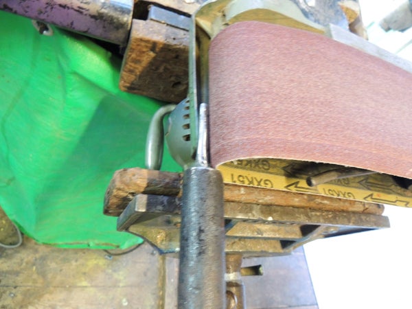

To finish it off I eventually used a belt sander locked in the woodworking vice. to even off the shape. By holding the larger end and rotating it while the narrower end was on the belt, I could smooth the roughed out piece into a pretty even cylindrical shape. This was effectively like a lathe in reverse. I turned it down to about 9mm, because I was going to cut an 8mm thread on it later.
Once I had one end of the bar a size that would fit the drill chuck in the lathe, I ground a conical recess in the other end, to match the conical centre on the lathe tailstock. I then locked the bar into the chuck and locked the other end onto the tailstock, ready to get turning. I tested this well, because it needed to be super secure, because if it escaped, it might throw the bar in my face.

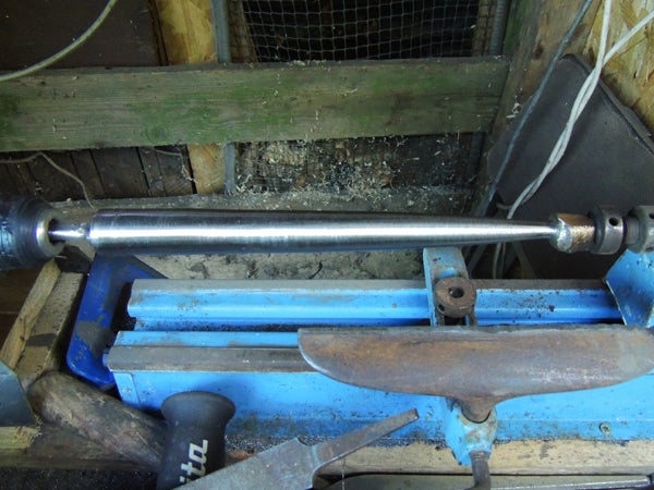

Grinding the mandrel's cone shape from the bar
The main challenge now was how to remove the amount of metal needed to create the cone shape. I initially thought I could do this by using a hand hacksaw held against the rotating bar, but this was painfully slow to make any progress. I had also tried rough metalworking files and they were even slower.
So this got me thinking what if I used an angle grinder to cut the metal. These cut metal really fast. Additionally The lathe was rotating the bar in the opposite direction to the grinder wheel. This meant it was being cut even faster than the basic angle grinder because the cuts were happening at the combined speed of both the lather and the grinder - genius!
The rest of the lathe work was just about patiently forming the shape. This still took a fairly long time - a couple of hours and quite a lot of grinder blades. I broke two diamond blades and ground down a load of carbide ones.
But eventually I had my basic cone shape and you could see the mandrel. It was almost the final shape apart from having a plug of waste metal at the tail end.
Smoothing and polishing
Cleaning up the base shape involved a load of repeated passes on the lathe with increasingly tools and abrasives. You can see the range in this picture.

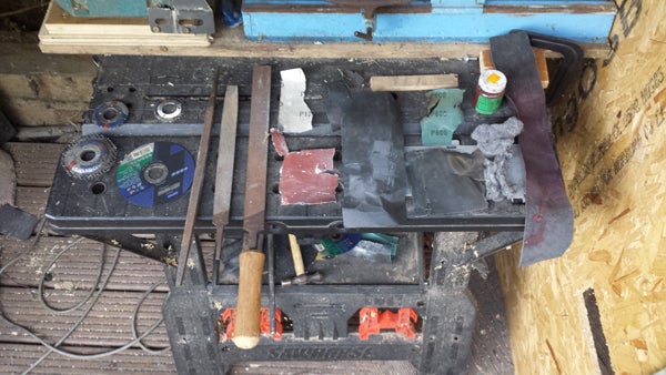

The angle grinder left a pretty rough finish, so I started with a coarse metalworking file to smooth out the deep cuts from the grinder. Eventually the grooves were only as deep as the file would normally make. I then swapped it for a finer file and repeated this with an even fine one.
I then used sandpaper, starting with 100 grit paper, then 180 grit, then 240 grit, 400 grit and eventually 600 grit. This took hours. I had music on my bluetooth headphones to stave off the boredom. 600 grit leaves a prety smooth finish, but this was made even smoother using fine steel wool.
Eventually the finish was nice and smooth. Once there were no marks left, I used a piece of leather with emery paste to polish super shiny. This is the same method barbers use to get a super fine edge on a cut-throat razor. It works really well. Emery paste is waxy paste with extremely fine powdered grit in it.

Tools for metal turning
Obviously, if you don't have a lathe, then this part would not be possible. However, if you do, then the most unusual extra tools were the angle grinders. The rest of the tools like files and sand paper and leather for a polishing strop are readily available.
