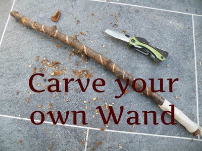

Wands can be decorated several ways, but the Scoutiest way to do it is to whittle or carve with a sharp knife.
A nice effect is to just cut through, and remove, narrow strips of bark.
Press the knife-blade into the bark at two 45 degree angles - 45º to the bark, working away from your body, and at 45º to the wand itself. Twist the wand, and the knife should cut a spiral up the wood.
Reverse the wand, press the blade in next to the first cut, and spiral back down the wood, staying close to the first cut.
You should now be able to lift a strip of bark from between the cuts, leaving a pale-coloured spiral pattern up the wand.
