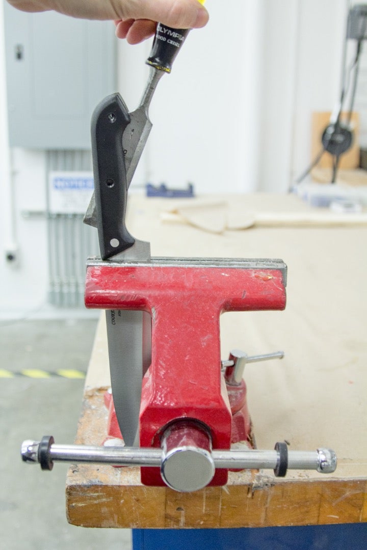

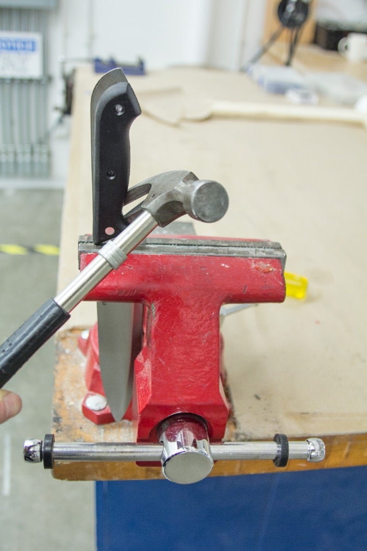

Step 2: Remove Handles From Knives

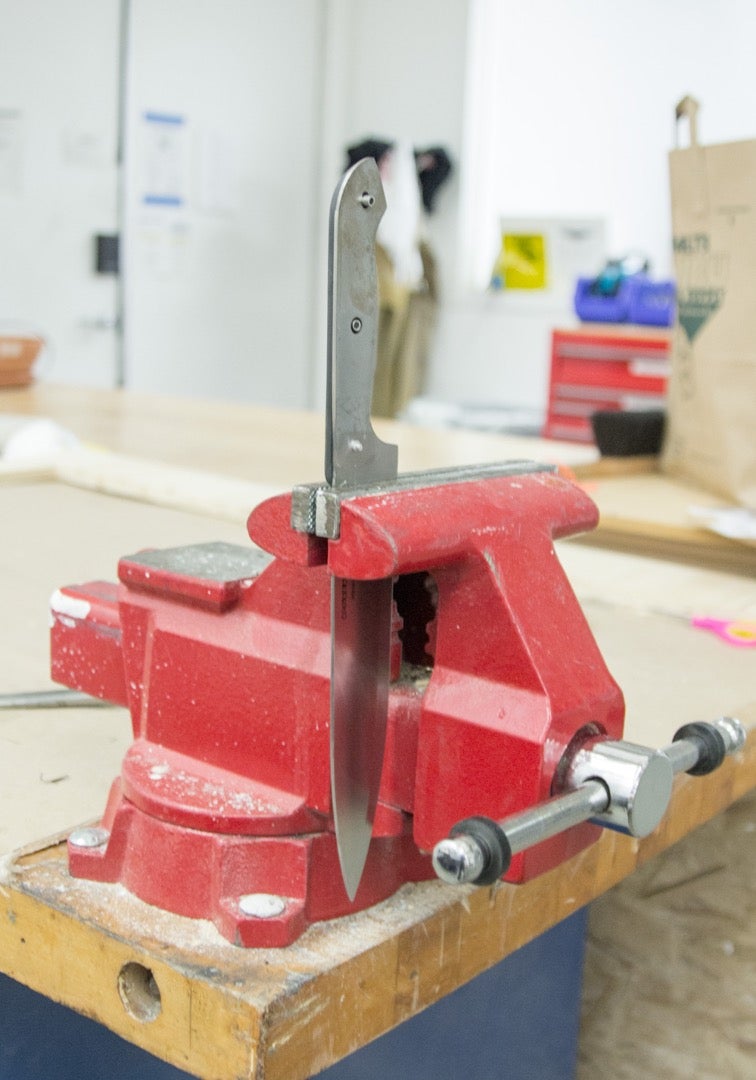

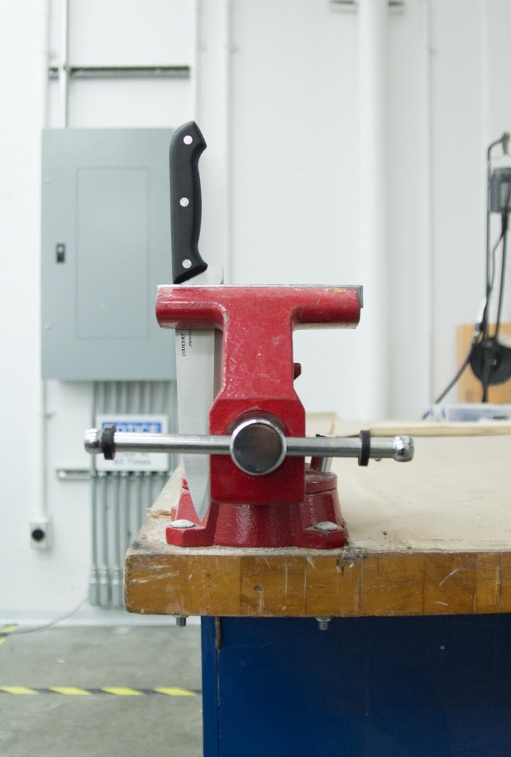

The first step is to remove the plastic handles from the knives. The beauty of buying knives from a dollar store is that they are poorly constructed so the rivets should pop out easily. There's no definitive way of going about this but after a little experimentation I found the following to be fairly quick and easy.
Parts:
  • Knives
Steps:
  • Insert knife into vice with blade pointing down.
  • Try to separate the plastic from one side of the handle by hammering a chisel between the plastic and the metal, this should be enough to pop the rivets.
  • If there are rivets still remaining after using the chisel, you can use the claw of a hammer to pull them out.
  • Go through the same process on the other side of the knife.
  • Rinse and repeat for second knife.

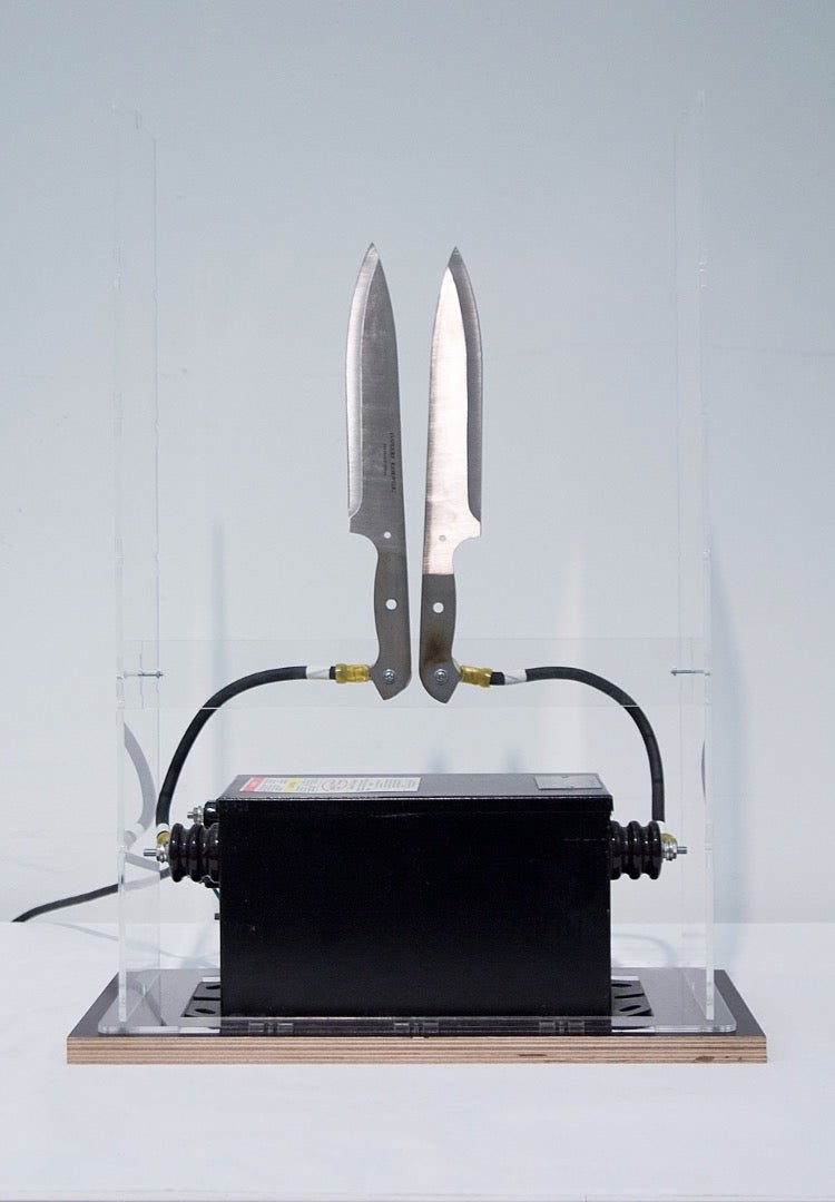

We're now going to attach the knives to the knife mount. The backs of the knives are facing each other so that the distance between the knives increases gradually as the electric arc climbs up them (even though the other direction might look a little cooler).
Parts:
  • Assembly from previous step
  • Knives
  • 2 lengths of high voltage insulated cable
  • 2 #6-32 2.5" Pan Head Machine Screws
  • 4 #6-32 Nuts
  • 10 #6-32 Washers
Steps:
  • Before starting to put everything together, check that the two lengths of cable that you have are long enough to reach from the high voltage terminals of the power supply to the knife mount holes but not so long that there will be lots spare.
  • The cables that I'm have terminals on them. If yours do not, you will need to strip their ends.
  • Attach a knife to the knife mount and cable using the ceramic insulators, screws, nuts and washers as shown in the first picture.
  • Tighten with a screwdriver and a wrench until the knife stands up on its own.
  • Repeat the last two steps with the other knife.

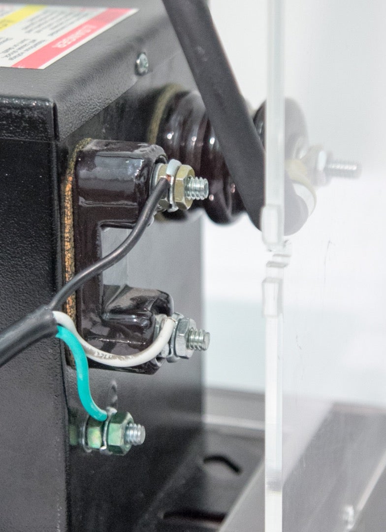

Step 6: Wire Up the Transformer
Parts:
  • Back of case (laser cut acrylic)
  • Power cord
Steps:
  • Attach the cables to the high voltage terminals of the transformer. The high voltage terminals can be identified by the fact that they have a much larger insulator below them than the other terminals on the power supply. If you are unsure which terminal is which, read the documentation for your transformer.
  • Thread the power cord through the hole in the back of the case as shown in the second picture.
  • Wire up the power cord to the 110V terminals of the transformer. The cord I have has US color coding, so black is hot, white is neutral and green is ground. If you are unsure, read the documentation for your transformer to determine which wires should be connected where. In the case of my transformer, the hot and neutral wires are connected to the terminals with insulators underneath them and the green terminal goes to the terminal that comes straight out of the case.

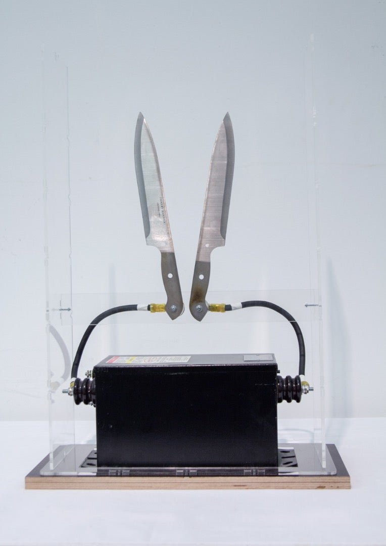

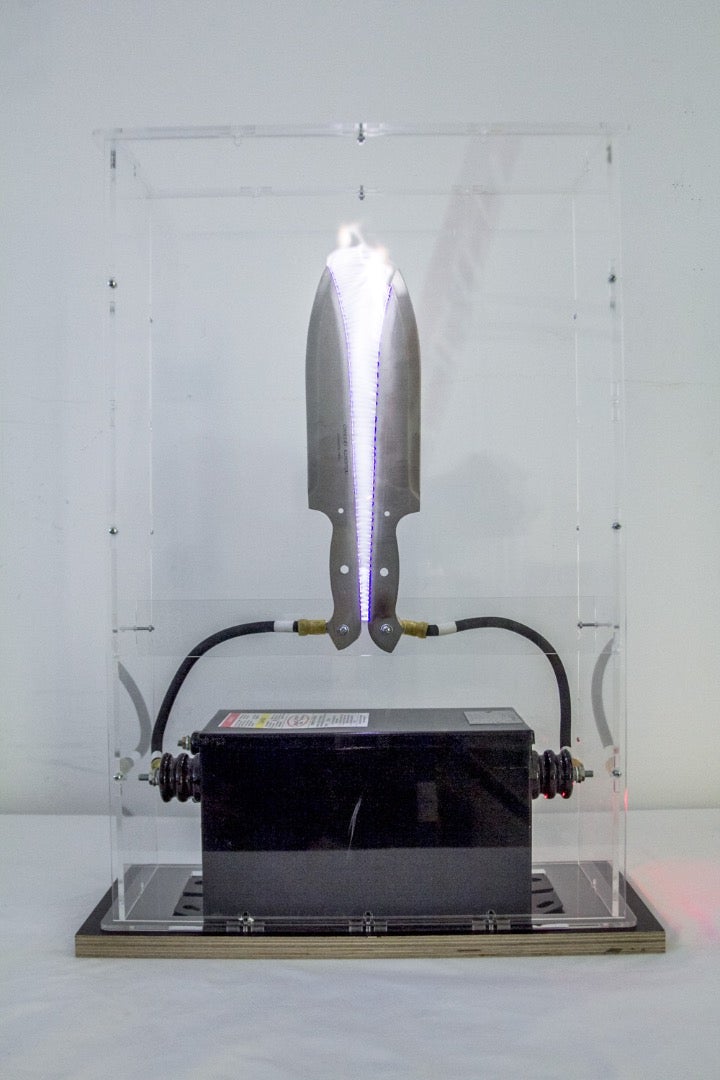

Step 7: Adjust the Knives
DANGER!! WE WILL BE TURNING THE DEVICE ON IN THIS STEP. WHEN THE TRANSFORMER IS PLUGGED IN THERE IS NO NOISE OR VISIBLE SIGN THAT IT IS POWERED UP. DO NOT TOUCH THE DEVICE WHILE IT IS PLUGGED IN. EXTREME CAUTION IS ADVISED!!
In this step, we will adjust the position and angle of the knives to get an electric arc that consistently travels from the bottom to the top of the knives. N.B. The third photo is a long exposure shot so your electric arc will not look like this.
Parts:
Steps:
  • Make sure you are nowhere near the device, plug it in and observe. If there is no spark, the knives need to be moved closer together. If there is a spark, but it doesn't travel up the length of the knives then the angle between the knives is too large.
  • ENSURE THAT THE DEVICE IS POWERED DOWN BEFORE ATTEMPTING ANY ADJUSTMENTS BY UNPLUGGING IT AND PLACING THE PLUG BESIDE THE DEVICE WHERE YOU CAN SEE IT. The knives can also become hot during operation so take care not to burn yourself. This is less of a problem than with a traditional Jacob's Ladder that has thinner electrodes, as there is more metal to absorb the heat.
  • Once you are sure that the device is powered down, you can begin adjustments.
    • Angle adjustment: unless your nuts are screwed on incredibly tightly, it should be possible to change the angle of the knives without loosening them.
    • Distance adjustment: to chance the distance between the knives, you will need to loosen the nuts at the back of one of the ceramic insulators. You should then be able to slide it towards the other insulator. Be careful of cutting yourself when doing this as, once the nut is loosened, the knife will fall down. Once you have a distance you're happy with, tighten the nuts back up again.
  • Go back to the first step and repeat until you are happy with the arc's behaviour.

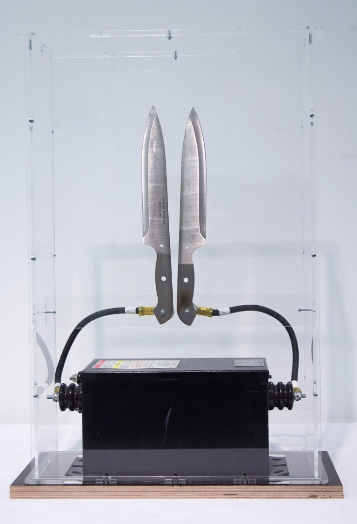

Step 8: Add Front, Back and Top of Case
Parts:
  • Front of case (laser cut acrylic)
  • Top of case (laser cut acrylic)
  • 32 M3 x 12mm pan head machine screws
  • 32 M3 nuts
Steps:
  • Pull the power cord through the back panel of the case until there is no slack left within the case.
  • Slide the tabs at the bottom of the back into the holes on the base as in the first photo.
  • Push the back onto the case so that the tabs on the sides go into the holes on the back.
  • Insert a screw on each side of the back to secure it.
  • Attach the front of the case in the same way as the back.
  • Put the top onto the case so that the tabs on the front, back and sides go into the holes in the top.
  • Now go around the case and secure everything with screws and nuts. To insert the screws at the bottom you will need to slide the acrylic case over the edge of the wooden base just enough to allow the screws to be inserted upwards.
