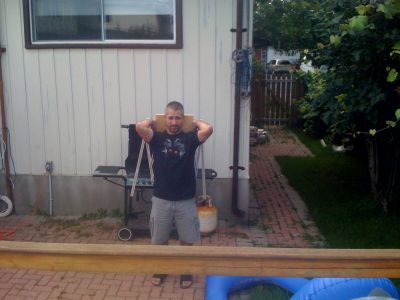

Step 2: Prototype
Design is great, but I was mostly on my own here, so I determined to see if this was possible. I grabbed a piece of plywood, and a bunch of flat trim from Home Depot. This trim is a few dollars for 12+ foot lengths and light.
If I could make something neat out of 12 dollars worth of trim, I knew I'd be onto something.
I used a 1-foot to 1-square conversion and cut the lengths, then I drilled the holes and threaded a bunch of nuts and bolts I'd picked up at Home Depot as well.
Holding it to my back with the wings outstretched it becomes clear that the first measurements I guesstimated would do just fine.
Since then I've played with different lengths and the 2:3:4 range seems to provide the best bang for the buck to begin with. It provided about 8 feet in width and height, fitting into most rooms.
