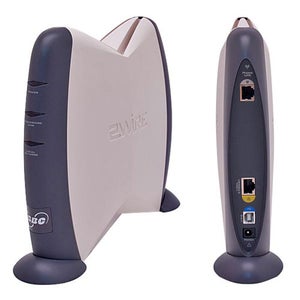

If you have a "2Wire" brand router, it should take in 5V.
Basics done, check some technical stuff!
Check your router, make sure it takes in 5V for power. If it is not written on the router you should be able to see it on the power supply for the router.
Check to make sure you have the right plug to fit the power jack on your router. Don't cut the original power cable, since you'll need it once the power is back on.

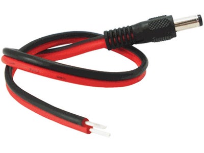

Step 2: Make Special Power Cords
If you've moved on to this step, I'm assuming you have a router that runs on 5V.
Now, you will need a plug that fits your router's power jack, and a USB cord.
Cut off the peripheral end of the USB cord so you are left with the part that plugs into your laptop.
Strip the wires on the jack and the USB cord, and connect the red wires and black wires, if the wires in the power jack cord are a different set of colors, match red to one of the wires and black to the other, then move on.
