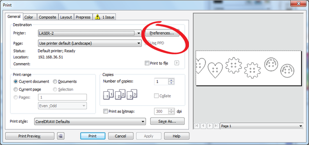

I used CorelDraw to design my buttons. Begin by creating a document with the same size as your work piece.
Here's where you get to be creative. Draw the shapes you'd like for your buttons. It's important to use a Hairline stroke. That's what the print drive will interpret as vector cuts and will cut the material all the way through. I found that 0.0625" for the thread holes is about the right size.

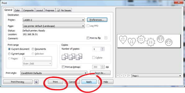

  1. File > Print

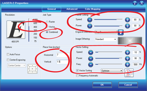

  2. Preferences. This will open the Epilog dialog.
  3. Settings
    • Resolution: 400
    • Piece size: The same as what your document is
    • Job type: Combined
    • Raster setting:
      • Speed: 80%
      • Power: 90%
    • Vector setting: (for 1/4" plywood)
      • Speed: 10%
      • Power: 90%
      • Frequency: 500
  4. Click "OK"
  5. Click "Apply", then "Print"
  6. Hit "Go" on the laser
