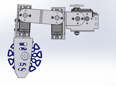

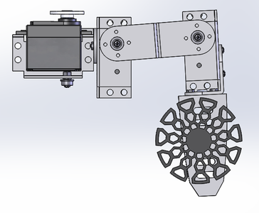

Step 2: The Leg
This is a new variant of the Lynxmotion Quadruped Robot which features a new lower leg design that includes housing for a motor and an added tank module. The idea behind this new leg design is to allow the robot to transform between walking and driving at any given time. The bottom leg is made in Solidwork and printed using PLA filament. . All the leg files will be posted at the bottom of the page in .step format.
3D Viewer : https://sketchfab.com/models/14e2ce2c8d514292ac0ec...

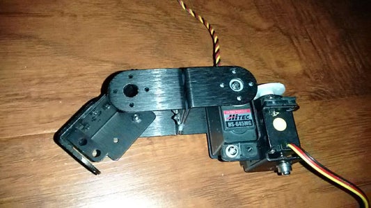

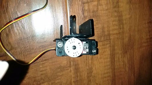

Begin by Constructing the Multipurpose Servo Bracket, the C servo Bracket , and The L Connector Bracket. The instruction came in the package when you buy them so it is self explanatory on how to assemble this. Once you have these 3 pieces constructed move on to the next step.
Step 4:
First, attach a HS-422 servo to the side with the ball bearings and make sure that the servo head is directly above the ball bearing ( this is very important). Then attach the C servo bracket to the multipurpose servo bracket as shown in the second picture. After the 2 pieces have been attached together, put the HS-645 MG on as shown in the third picture. Finally attach the L servo bracket on the left side of the C servo bracket as show in picture 4. Note: it is very important that you put the right servo in the correct place or else it will affect the performance of the robot.
Step 5:
Next, attached the LowerLeg to the servo bracket as show in the first picture. Now you should have a single completed leg. The big hole in the LowerLeg served as the housing for the motor which will be used to put the robot to driving mode. If you want to have to have the driving mode go to the driving module section for instruction.

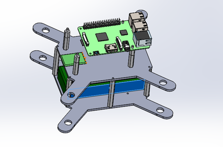

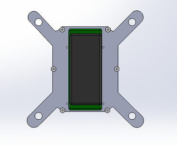

Step 6: The Body
The body were made using Quadrapod Body Kit - Mini QBK-02. There are 2 batteries which are placed on the lower level. The green battery is the 6V NiMH/NiCD which is used to power the servo and the motor. The black battery is the Anker portable charger for the raspberry pi 2. I decided to use a second battery for the raspberry pi because the main battery is already under heavy load from all the servos and motors. Putting more load on it is not a good idea. Furthermore, the Anker portable charger can power the raspberry pi for about 1-2 hour with the camera plugin whereas the main battery can do 30 min max. After the batteries is placed in its appropriate spot, screw in the top cover and put the raspberry pi 2 near the end of the robot and the mini-maestro servo controller at the top as shown in the last picture. Now the main body is finished we will move on to constructing the camera module.
3D Viewer : https://sketchfab.com/models/9c0d9cc3603648c99de3c...

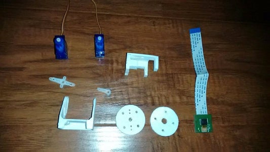

Step 7: The Camera Module
The camera is 3D printed out using STL files from http://www.thingiverse.com/thing:350229 . Once you have printed out all the necessary components. I constructed the camera module by looking at the picture from the site. It is self explanatory. The Camera module is powered by 2 Hitec HS-5055 servos. These servo are relatively cheap and cost about 2 dollar each.

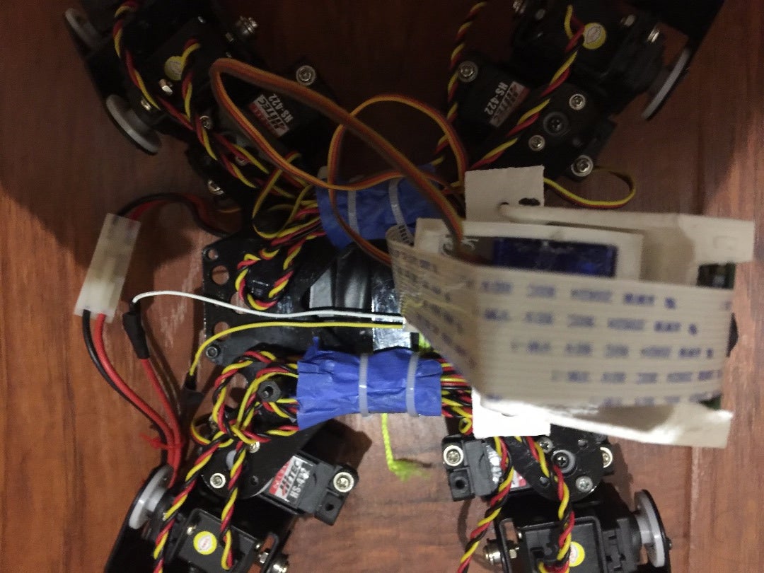

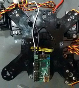

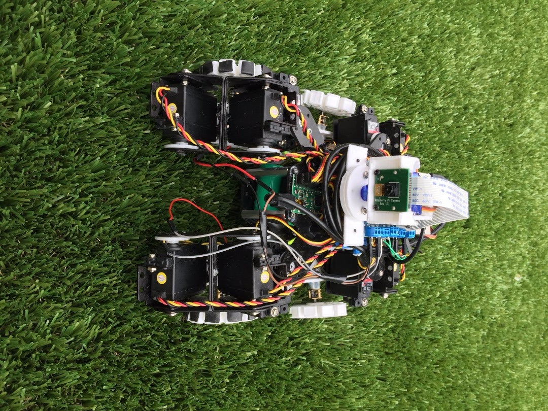

Step 8: Putting Everything Together
At this point, the four leg should be completed and ready to be integrated into the body. At the four corner of the Quadruped body there is a big hole. This is where you put the leg. Look at picture one for reference.
Step 9:
Next ,we attached the camera module to the body. The camera will be placed on top of the mini-maestro servo controller. It should be placed high enough so that it is in the way of the wire. That about it for the placement of the camera. Refer to the above pictures to get an idea of where to place the camera module.
