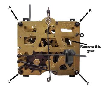

In order for the stepper motor to drive the clock the escapement has to be disconnected. The escapement prevents the clock gears from free running and regulates them allowing them to turn a step on each pendulum swing.
To disconnect the escapement you need to remove the first gear in the escapement train. This is labled no8 middle gear in the enclosed diagram (pic 2). The removed gear is shown in pic4.
Pic 1 To remove the gear I just losened the movement nuts A a little bit and then losened nuts B enough so the gear could slip out. If you are carefull no other gears will fall out. While the movement was loose I also removed part 17 "verge escapement" (pic5). This is optional and just clears some space.
Once these parts are removed the nuts can be tightened up.
The pendulem leader (pic6) can also be remove as it's no longer used.
Keep all these parts safe so the clock can be returned to it's original state in the future.

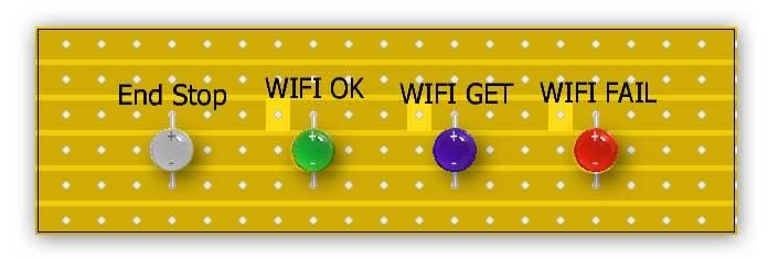

Pic 6 LED Veroboard.
Pic 7 LED Veroboard rear.

Pic 1 Indicators when logging into the router/NTP time server.
Pic 2 Once time has been fetched the Gn LED lights and the clock will start stepping until the end stop is reached and will then stop.
Pic 3 End stop reached Wh end stop LED lights.
