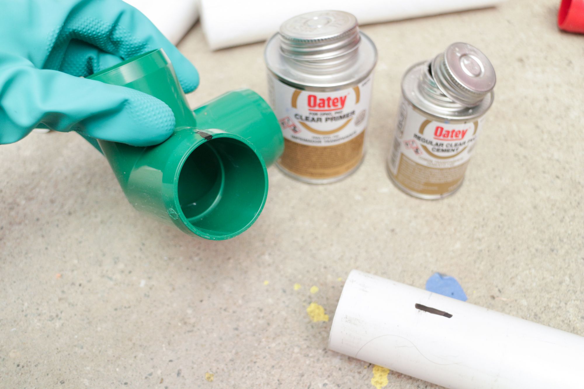

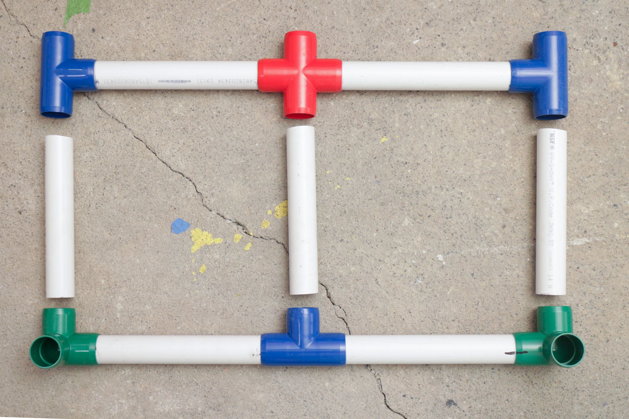

I love working with PVC because it's lightweight, strong, and a bit like tinker toys. The tricky thing about working with PVC is being precise when lining up the pieces and making sure every pipe is completely nested into its connector. There are lots of tips that make joining PVC easier.

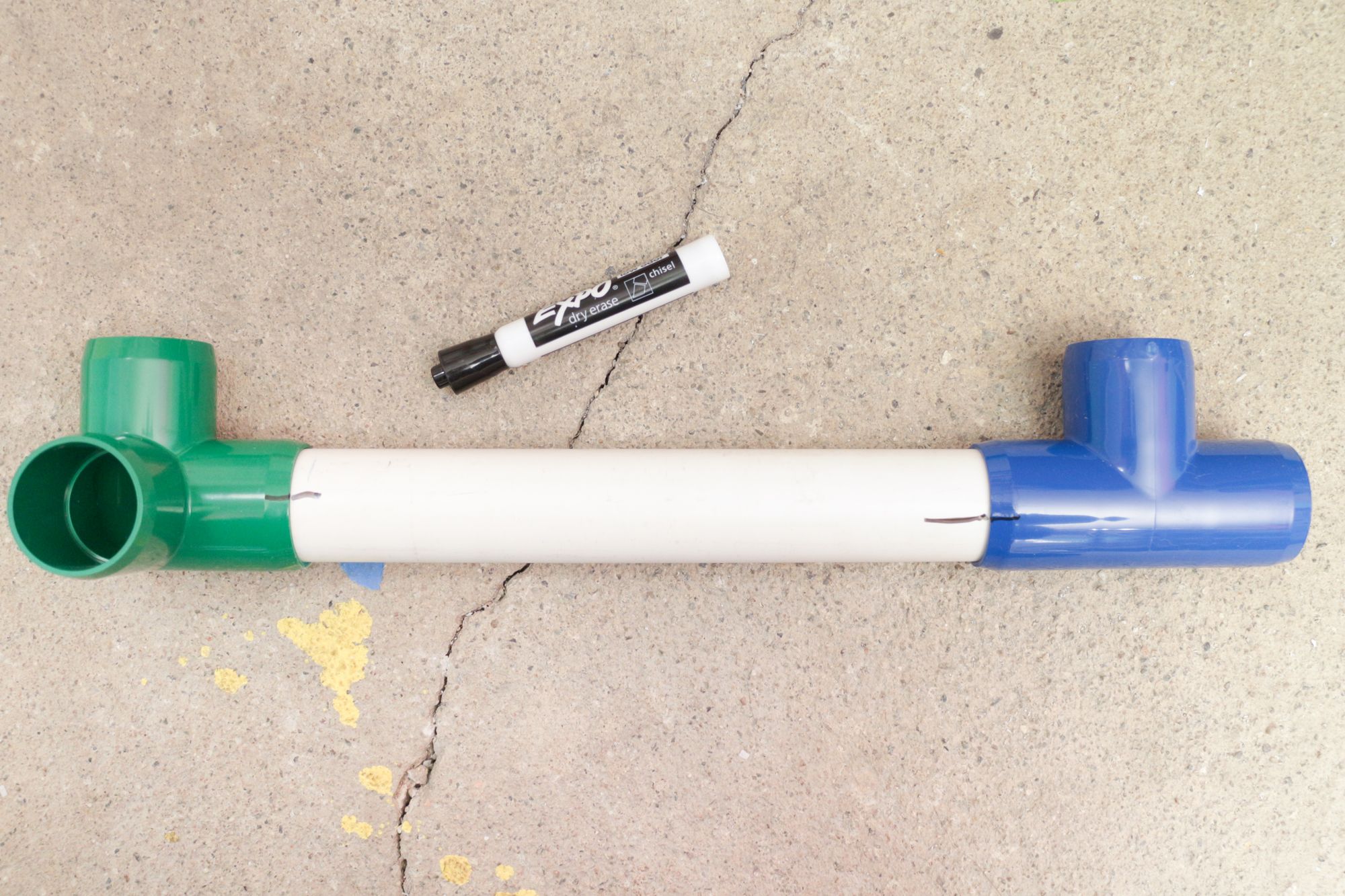

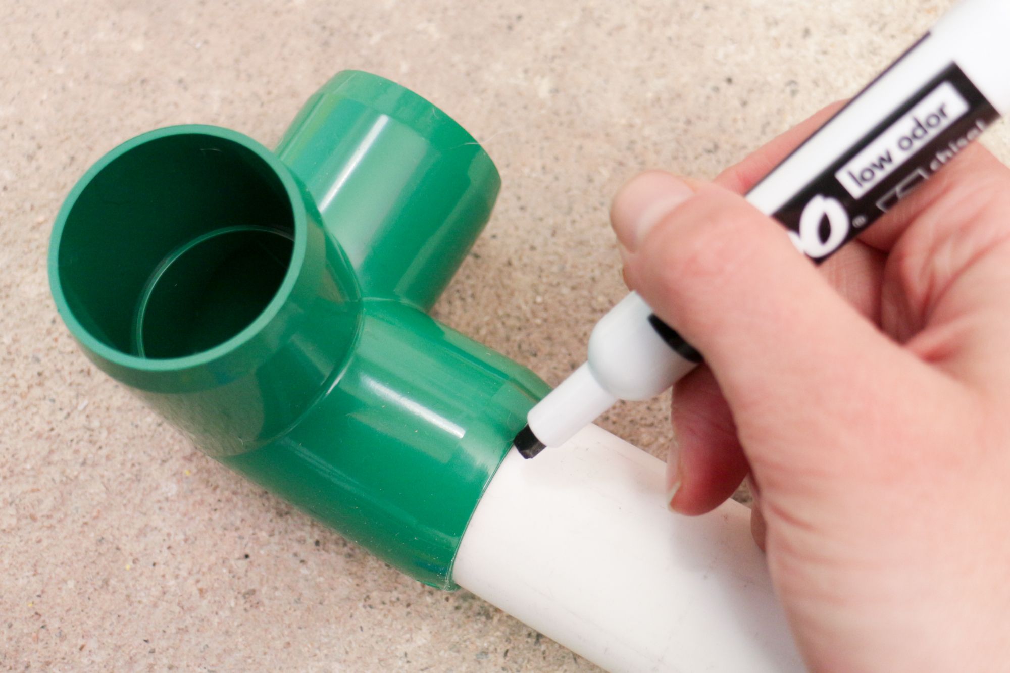

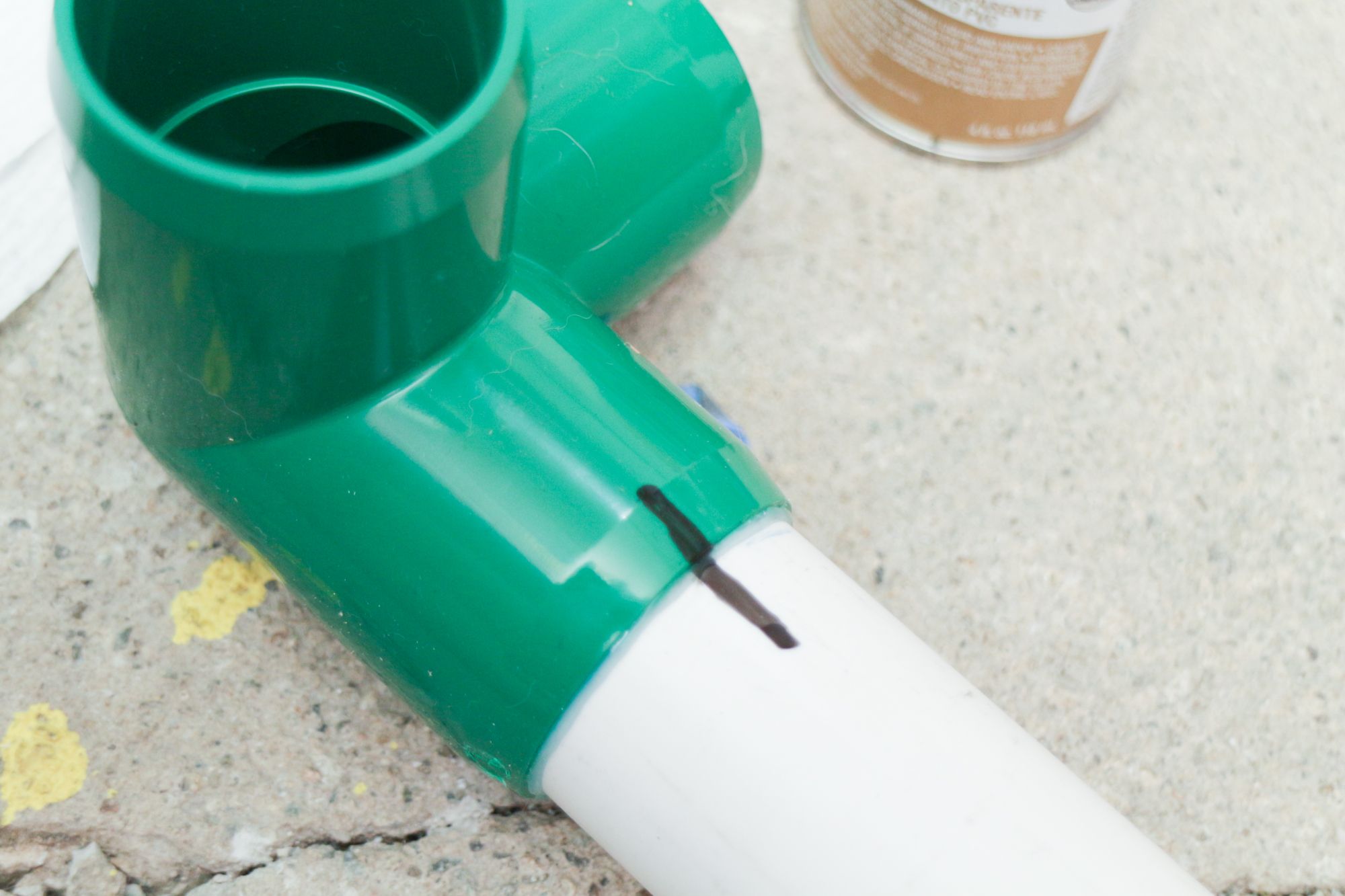

Using a dry erase marker to create registration lines for your connections is a great way to make sure you are able to maintain the alignment of your dry-fit parts.
It is best to construct one length at a time, working shortest to longest. Shorter connections are more difficult to manipulate after they have been cemented, so it is best to glue them first.

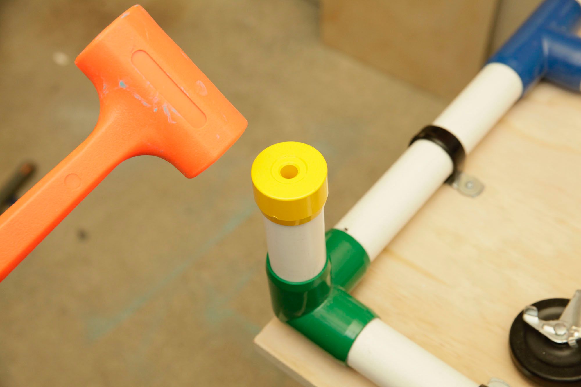

Lastly, get out dead blow hammer, you may need some help making sure your connections are complete and the PVC is all the way inserted into the coupler.

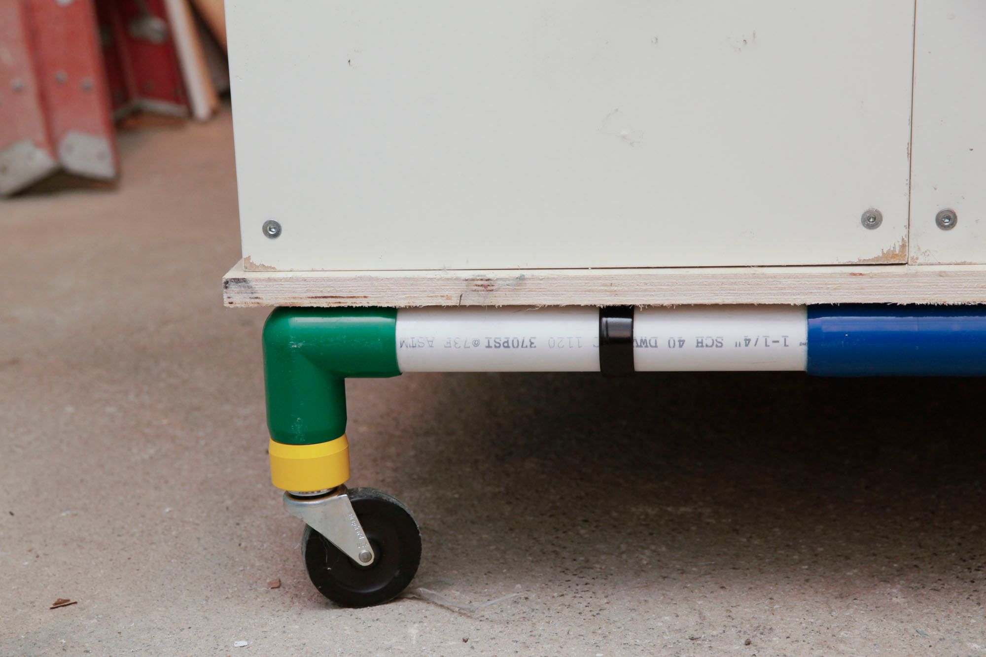

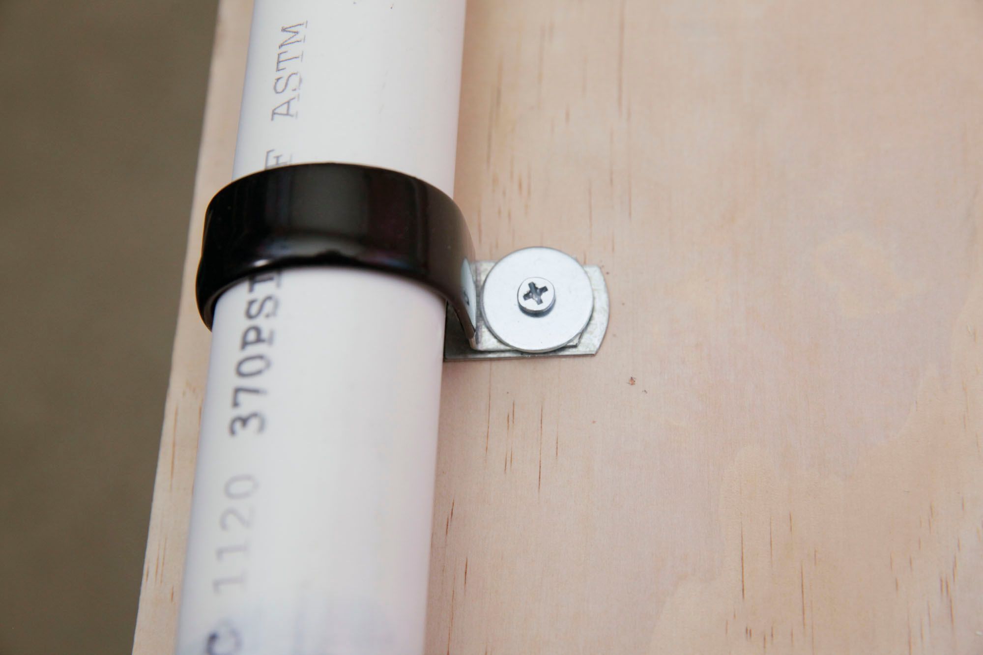

To attach the PVC supports and casters to the frame, I began by drilling shallow holes for my anti-vibration pipe clamps to mount to.
The squat little screws didn't have a large enough screw head to use with the clamps so I got some 1" fender washers to keep the clamps shut with the tiny screw.
Without cementing the caster joints in place, I used a dead-blow hammer to couple the remaining 'feet' of the frame. There was no space between 3-way elbow joint and the caster connector.

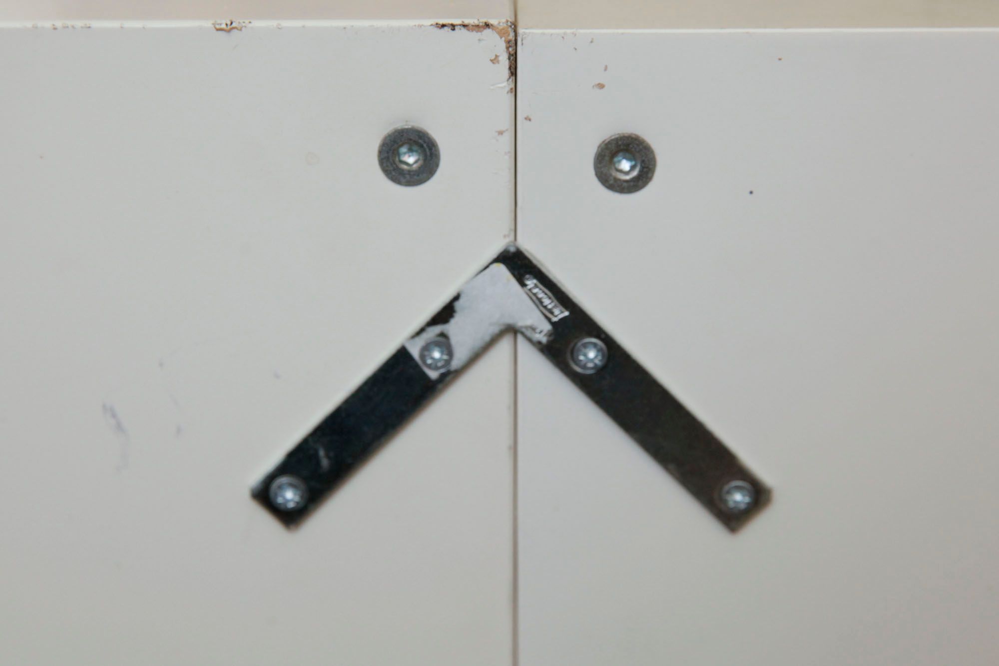

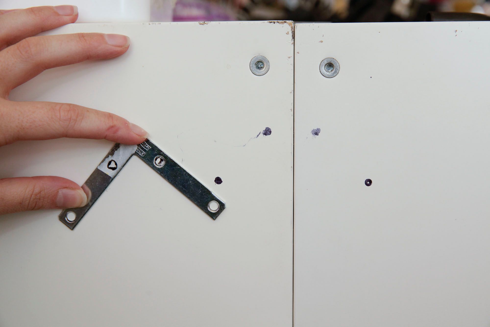

To prevent the shelves from splitting or moving apart from one another, I used flat corner braces to secure the units to one another.
To make sure I had no space between the two shelves, I used a ratchet strap to nest the two units back to back.
Once the shelving units were in place, I marked, drilled and anchored the corner braces into place.
I thought I would have to secure the shelves to the base, but it was so heavy that no additional anchors or hardware were needed. Thanks, gravity!

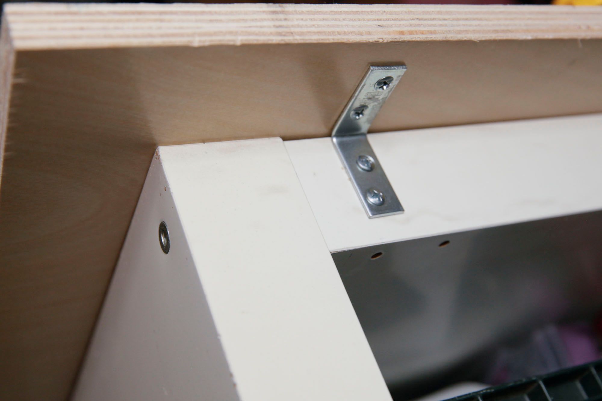

To secure the top, I used short corner L-brackets and screws. If I ever needed or wanted to replace the top, I wanted to be able to swap the wood out easily, so I only used 4 L-brackets, one on each corner.
