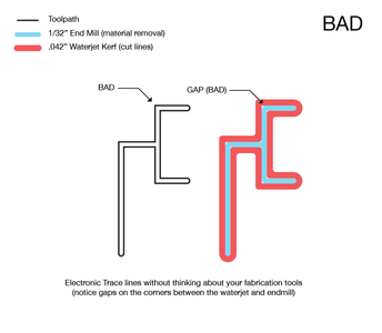

The two most important considerations when designing your circuit is the waterjet kerf (width of the cutting stream) and the diameter of your End Mill. At Pier 9, the nozzle on the Omax Waterjet has a kerf of 0.042". The smallest End Mill that I was using was 1/32" (0.03125").
Since the electronic traces cut on the waterjet must fit precisely into their CNC milled negatives, it is important for the design files to consider both of those tools.
- When cutting the traces on the waterjet, the kerf applies a radius to interior corners.
- When cutting the negatives of the traces on the CNC shopbot, the End Mill diameter applies a radius to exterior corners.
If you don't compensate for the waterjet kerf and the End Mill diameter for all of your design files the waterjet inlay won't fit nicely into its milled negative.
It is best to do this in your design file, before you get to your waterjet and CNC milling toolpathing step. This way you only have to worry about it once. Above are two diagrams to help explain why it is important to compensate for your tools. The above diagrams show an example of an electronic trace. One design does not compensate for tool width and kerf, the other does.
