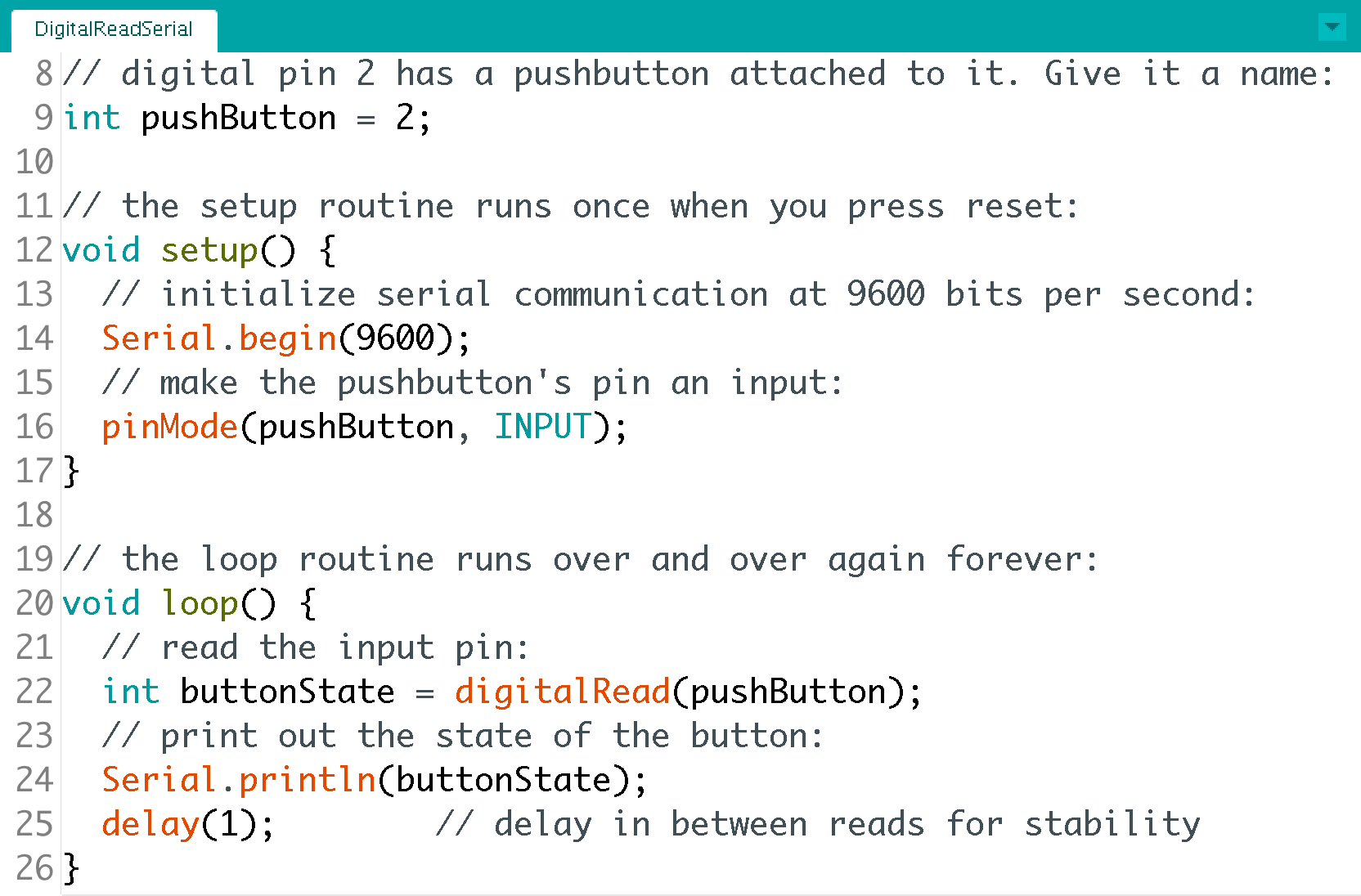

Step 3: The Serial Monitor
Keeping track of everything going on in your program can be an uphill battle. The serial monitor is a way to check in on different spots in your code by reporting back to the computer over the USB cable.
Find this circuit on Tinkercad
This circuit uses the same button configuration as the previous digital input circuit, but just doesn't use the LED. Load up the code from this module or find it in the Arduino software by navigating to File -> Examples -> 01.Basics -> DigitalReadSerial. Upload this code to your board and click the Serial Monitor button in the upper right of the sketch window. You can also open the virtual serial monitor in the Tinkercad Circuits module above (button at the bottom of the code editor).
To create a serial connection, you should use Serial.begin(); inside your setup. The number 9600 is the baud rate, or data speed, in bits per second (bps). Inside the main program loop, you can use Serial.print(); to send information to the serial port. Serial.println(); does the same thing, but prints on a new line. Line 24 in our code prints the current value of buttonState (HIGH aka 1 or LOW aka 0) to the serial port. So with the serial monitor open, we have a live scrolling view of whatever the Arduino senses at pin 2. The serial monitor is exceptionally handy when troubleshooting, since you can easily compare what you think should be happening to what the Arduino is doing. You can also use serial communication to talk between devices and much more, which you can read about in the Arduino reference.
