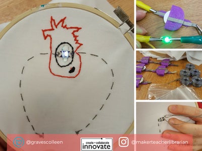

Step 1: Create Sewable Battery Holders
Since the cheapest coin cell battery holder to buy is two dollars a unit, I decided to make my own battery holder to keep costs low for my sewing circuit club. I found this great tutorial on sewing your own battery holder, but I didn’t have any neoprene fabric, so instead I hacked a coincell battery holder in Tinkercad to be sewable.
Hack or print this battery holder designed in Tinkercad. Then use conductive fabric tape to make your positive and negative paths for sewing. Make sure your tape doesn't connect from positive to negative. Run tape from inside the battery holder to the sewable leg for both connections. (You could hack this holder to just use conductive thread by making the hole on the front and back of the holder a little larger and sewing direct pads here.
Test those holders before sewing!
Step 2: Sew Positive and Sew Negative
Share your own half-baked prototype (in other words, make it functional, but not too pretty.) If needed, share a template for students to follow.
Share with students how to sew from the positive end of the battery to the positive leg of the LED with a running stitch. Make sure they knot and cut their thread after sewing to the LED. Start a new thread to sew from the negative end of the battery holder to the negative leg of the LED.
Let students be creative in sewing with conductive thread! My students made cat patterns, Octopus, and more instead of sewing in a straight line! The important thing is only that the two sewing thread paths do not cross.
Once you've sewn each connection, you've made a simple circuit!
Put in a battery and let there be light!
Here is a downloadable template if you need it.

Step 3: Embellish With Embroidery, Markers, Puffy Paint, Etc
Once the circuit is sewn, let students get creative with embellishing and designing art with thread, markers, or puffy paint.
