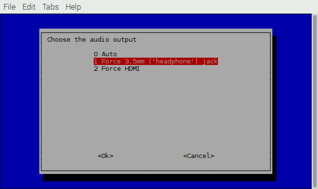

2) raspi-config
sudo raspi-config
Use the down arrow to choose Advanced Options. Then choose Audio and the output you would like to use. For my examples, I chose the 3.5mm headphone jack because my HDMI display does not have speakers (but many do).

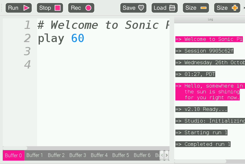

Play Notes
You can stay in Buffer 0 if you like just highlight and delete the default text to start with a fresh page. Start by using play with a number next to it:
play 60
Hit Run. You hear a note play! If you don’t hear a note, you may need to set your preferred sound output in the Preferences menu accessible through the button in the upper right corner of the window. The lower the number the lower the note, the higher the number the higher the note. Play around and see how low or high you can go until the note becomes inaudible. Make sure the volume is turned down a bit as you get higher. Notice how there is an autofill? Once you typing a command a menu pops up with a list of commands that start with the letters you have typed. This is not only a convenient way to look up how to type something but it can lead to new discoveries too!

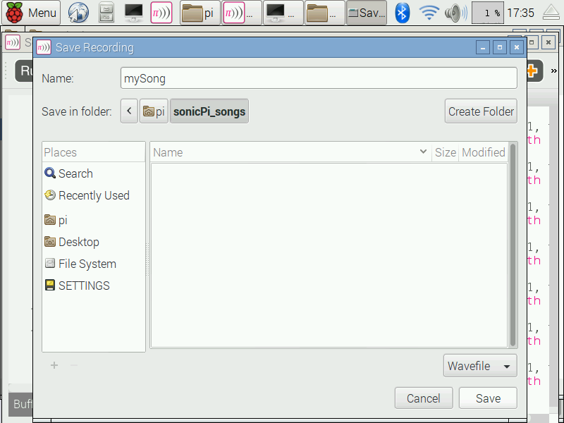

Step 8: Sonic Pi: Save and Play Your Sounds
You can save the code you wrote as a .txt file but clicking the Save button. To save the audio hit the Record button. When the button starts to flash hit Run to play your song. When it's done, click Record again and save the wave file.
Create a new directory called sonicPi_songs to store all your creations. To play your song on the RPi, use omxplayer, aplay, or Pygame.mixer as you learned earlier in this lesson. Make sure to use the correct file path and audio output.
omxplayer -o local mySong
When the file is saved it is not automatically given a .wav extension, although it is a wave file. So, writing it like this:
aplay sonicPi_songs/mySong.wav
will not find and play the file, but if you remove the .wav it will:
You may also add the .wav extension when you save the file or by renaming the file in File Manager, in which case you would use the extension when referring to the file in commands.
