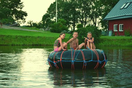

At this point, I had already come up with the way I wanted to tie the rope around the tube. Orange rope was going to make the main structure and the blue rope was going to be used to make knots and hooks and to fix the orange rope so that I could not slide around and come loose.
Oh and before you start tying the rope let some air out of the tube. This way the tying process will be easier and later when you pump it full the ropes will be held in place by the pressure. This last part is really important as minimizes the chance of somebody getting stuck between the rope and the tube and thus creating an accident!
Not gonna go much further with this since our first attempt was unsuccessful. See the pictures and do not do it this way.
Step 4: Let´s Roll Again
After the first attempt, we left it there and brainstormed new ways to tie. We came up with this solution.
Once again the orange rope would be the main structure and the blue one would fix it all together.
This time, we twirled the orange rope around the tube from both directions while making knots at the points where they met. We used two rolls (25 meters) for this. When this was done we took the blue rope (20 meters) and started making a circle on the outer side. From time to time we made small hooks for grabbing on. Oce again try to make the hooks small enough so that no one can get stuck. When this was done we took another blue rope and repeated the same process on top. Pictures are probably better expositors.
Double rainbow that appeared confirmed that we were on the right track ;)
Now there was nothing left to do but to pump it full and have some fun!
