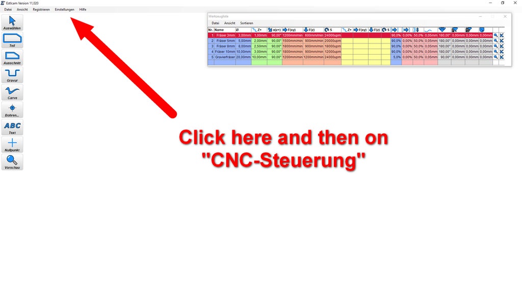

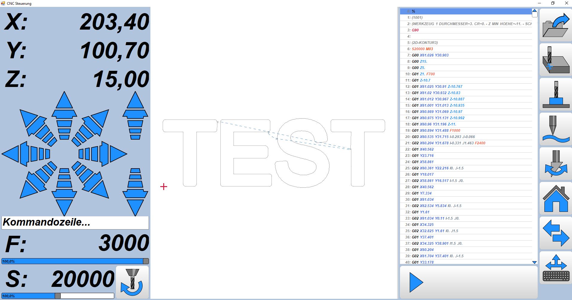

- [06.03.2019] Added step "Configure Estlcam for This Machine" + video of test run
- [07.03.2019] Added video of CNC in action

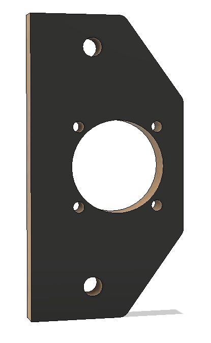

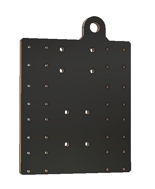

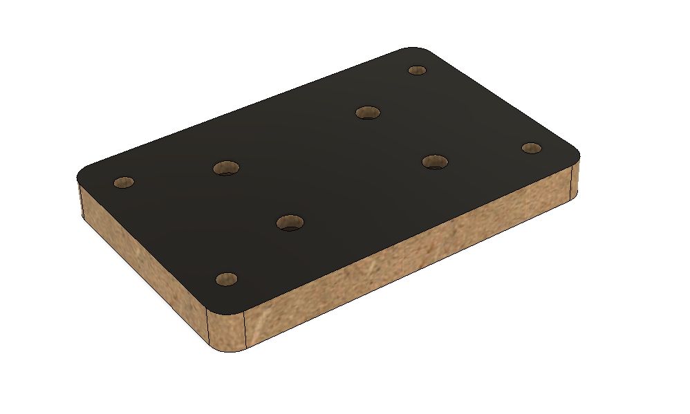

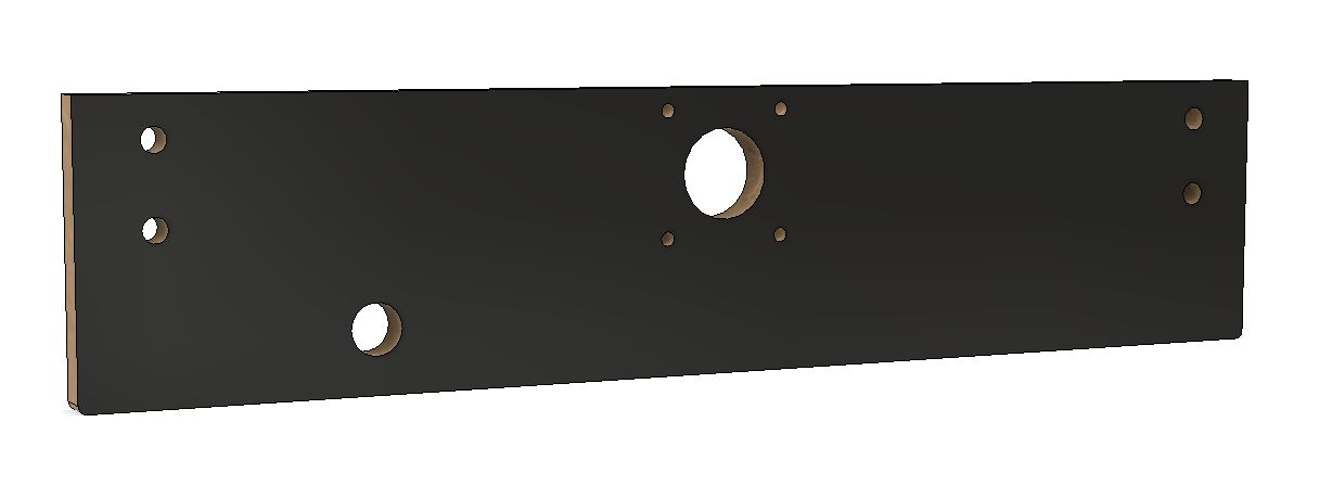

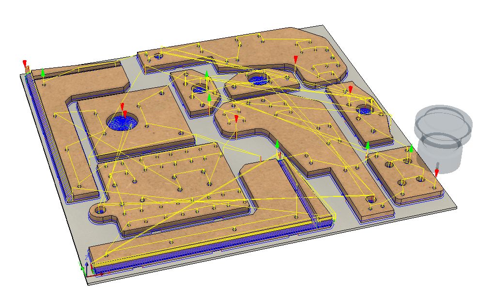

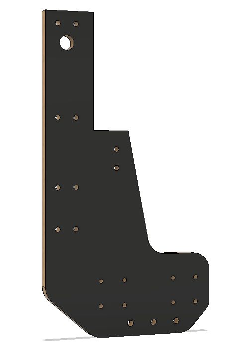

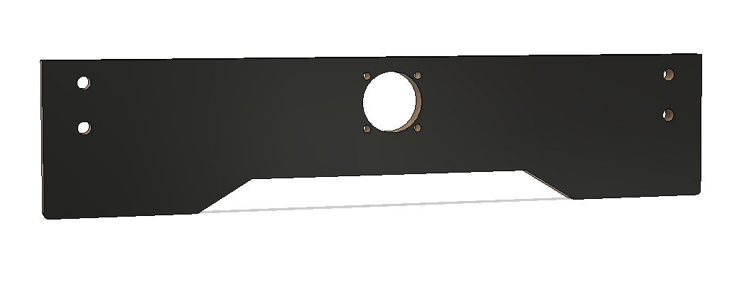

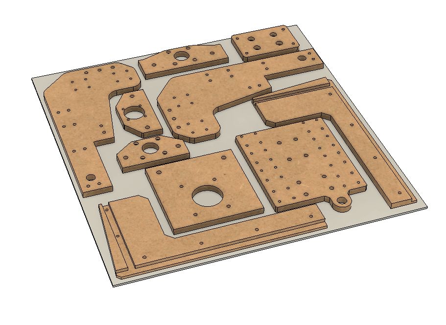

CNC-Milled-Parts:
Here are all required CNC-milled parts. You can buy all the CNC-milled parts in my Online Shop. The total cost of all the CNC-milled parts will be 150€ + shipping.
Quantity | Description | How the part looks like |
1x | Y_Axis_Front | |
1x | Y_Axis_Rear | |
1x | Y_Axis_Nut | |

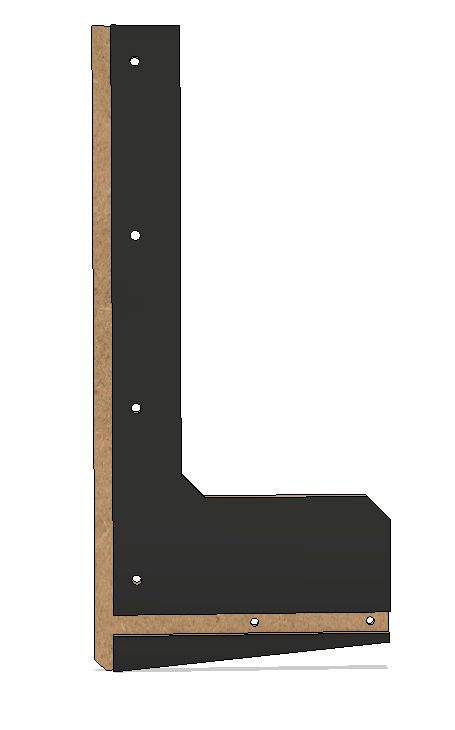

2x | Portal_Side | |

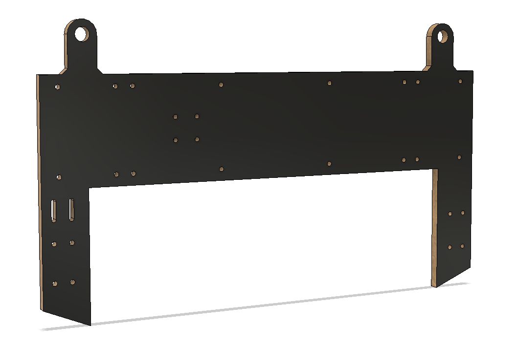

1x | Portal | |

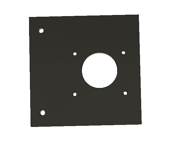

1x | X_Motor | |
1x | X_Bearing | |

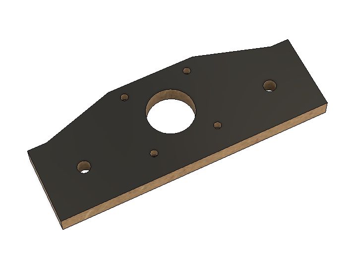

1x | X_Carriage | |
1x | Z_Motor | |
1x | Z_Plate_Front | |
2x (normal+mirror) | Z_Plate_Side | |
1x | Spindle_Mount | |
1x | Main_Plate |

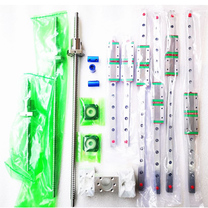

Linear parts and custom machined ballscrews:
For the CNC mill you will need three custom machined 1204 ballscrews. I have attached a drawing with the dimesions at the bottom of this step. Additionally you will need MGN12 linear rails, ballscrew, bearings and housings. Because it was a littlebit hard to source all the parts, I contacted a manufacture, who can supply all these parts for a resonable price. This manufacture will also make the custom machined ballscrews. You can buy all the parts here: Aliexpress
1x | 1204 Ballscrew 425mm |
1x | 1204 Ballscrew 395mm |
1x | 1204 Ballscrew 200mm |
4x | 400mm MGN12 Linear Rail |
2x | 250mm MGN12 Linear Rail |
12x | MGN12H Linear Rail Wagon |
2x | FF10 Ballscrew Bearing |
3x | 24mm 1204 Ballscrew Housing |
3x | 5 to 8mm shaft coupler (rigid ; not the red or flexible) |

Now it is time to install the Y-ballscrew to the main frame. At first install the Nema 17-motor to the rear plate and fix it with four M3x16mm screws. Then you can slide the 395mm ballscrew in. Once the ballscrew is in place, attach the FK10 bearing at the front plate. The FK10 bearing is fixed by four M3x16mm screws and M3-nylon nuts.

Step 6: The Portal Side
What you need for this step:
4x | M4x16mm DIN912 cylinderhead screw |
4x | M4-T-slot nut 5mm Slot |
1x | 330mm 60x20mm aluminium extrusion 5mm slot |
6x | M5x20mm DIN912 cylinderhead screw |
6x | M5 washer |
16x | M3x12mm DIN912 cylinderhead screw |
16x | M3 washer |
2x | Portal_Side |
What you have to do:
At first you have to connect the two Portal_Side plates to the linear wagons. After that you have to attach the 60x20mm extrusion to the Portal_Side plates by using the six M5 screws. Finally connect the ballscrew housing from the previous step to the extrusion.

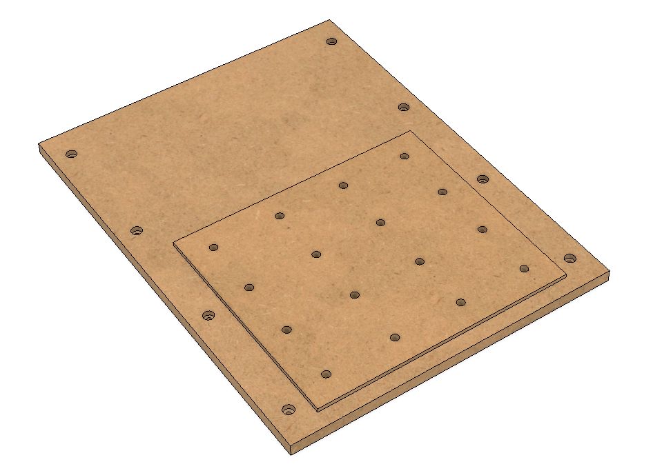

Step 7: The Main Plate
1x | Main_Plate |
16x | M6 hammer nut |
You have to hammer the 16 hammer nuts to the predrilled holes.

At first you have to connect the linear rail to the aluminium extrusion.Then place the extrusions on the portal plate. Now screw the extrusions to the extrusions. Don't forget to place the angle brackets.

You have to place the ballscrew between the two linear rails. The connection of the motor and the FF10 bearing is made by four M6 screws. Don't forget to cut the four M6 threads to the aluminium extrusions.

1x | Spindle mount |
Place the spindle mount on the Z-axis. Then connect it to the Z-axis with four M4x16mm screws. Once completed, you can slide the spindle inside the spindle mount.

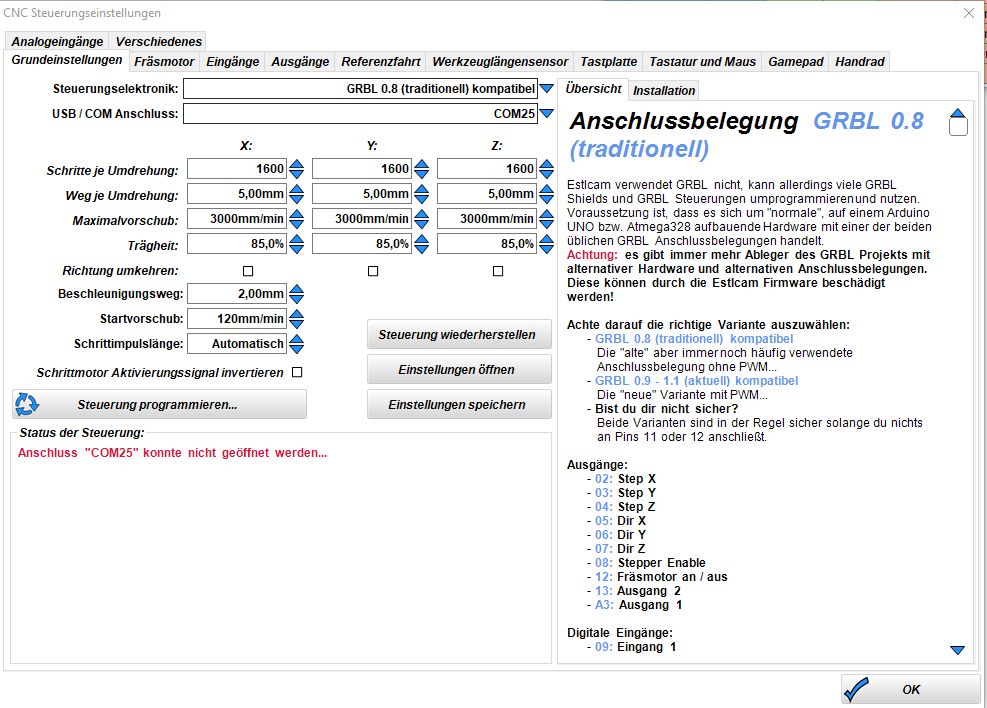

Step 22: Configure Estlcam for This Machine
I personally recommend to use Estlcam over GRBL for this CNC because of these aspects:
- It is a lot easier to configurate than GRBL
- It has a build in CAM, so you don't need any additional Software
- Controller and CAM are combined in one Software
Now I want to show you which configuration you have to do, that the machine will work propably:
1. Open Estlcam and go to "Einstellungen" then click on "CNC Steuerung"
2. After that a window will open with some configurations. There you will see all the basic values for this machine. Once you have all the settings like in the picture, connect your Arduino to your computer, select the right COM-Port, click on "Steuerung-Programmieren":
3. If the programming of the Arduino was a success, close "Estlcam" and open "CNC-Controller". Now you should be able to move your machine.
4.Here is a video of the test-file. The test file can be downloaded at the bottom of this step. The feedrate in the testfile is 2400mm/min.
Step 23: CNC-Milled Results
Here I will show you some CNC-milled parts, which where milled on this machine. ( list will be extended in the future )
