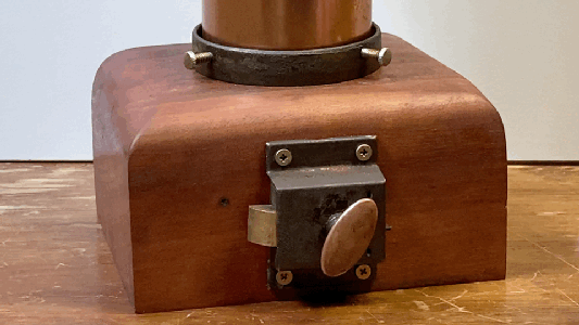

Step 6: Making an On/Off Switch From an Old Lock
I was just going to add an old switch that I had lying around but after a bit of rummaging around in the parts bin I found this old lock buried deep. After a little messing about I decided that it would be an awesome way to turn off and on the lamp!
STEPS:
1. The first thing I did was to give the lock a bit of a polish. I only wanted to bring out the brass on the lock so only gave those sections a good polish.
2. Next I slightly modified the inside of the lock in order to be able to fit the momentary level switch inside. Once I was happy with how it worked I soldered a couple of wires to the switch and super glued it into place. Yes, this is the second place I added some super glue!
3. I also added a little strip of plastic to the inside of the lock to ensure the switch didn't short on the metal.

Step 12: Adding the Lock Switch to the Front
This was pretty straight forward as I had already drilled the holes in the wood and modded the lock into an on/off switch.
STEPS:
1. First, I placed the lock in the position I wanted it on the front of the wood
2. Next I threaded the wires from the lock switch through the hole and out through the large top hole
2. I then drilled 4 holes for the screws and attached the loc
