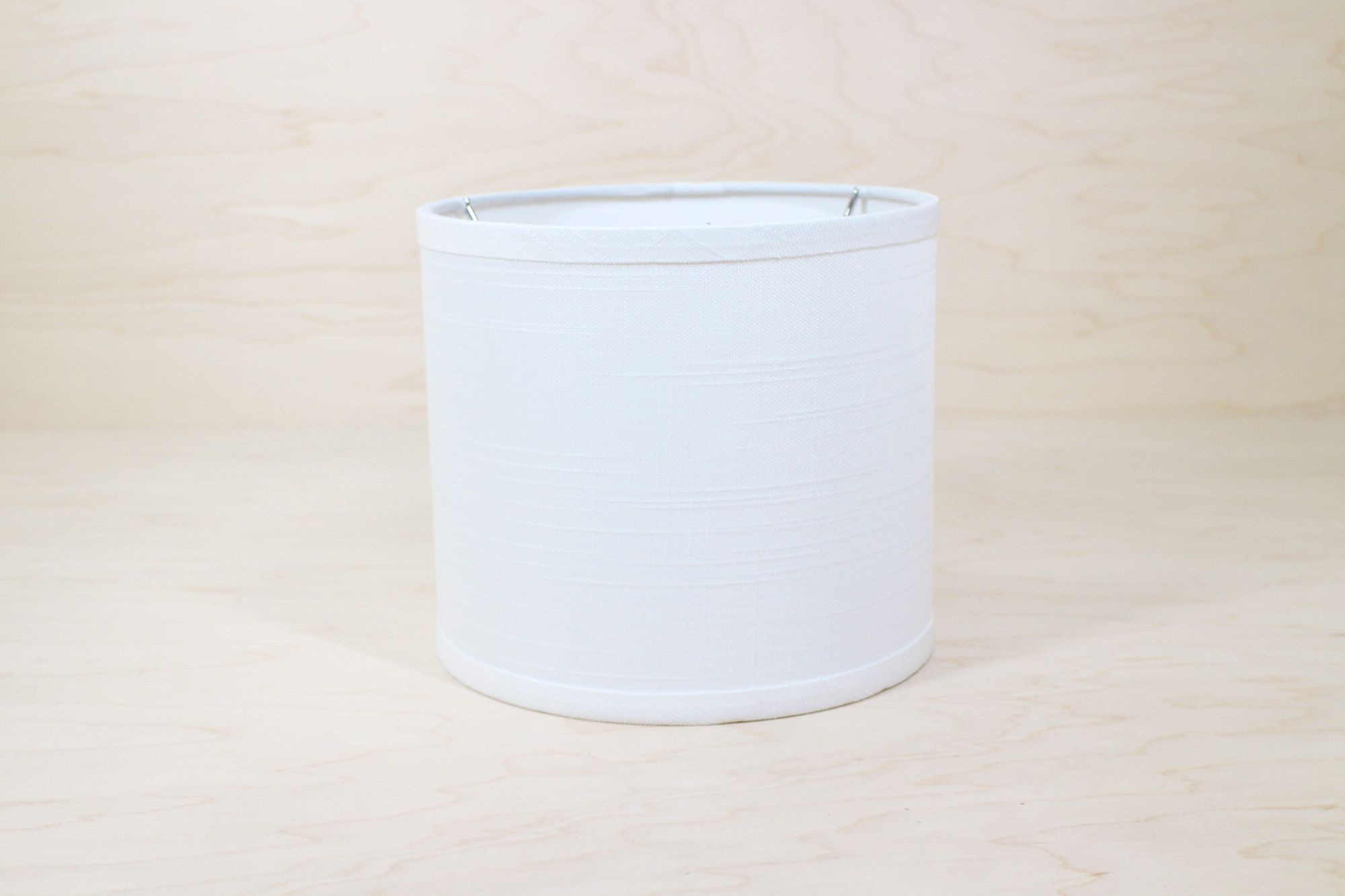

2. Hardback shades (plastic backed drum & 'A' shades) work best with modern and contemporary lamp bases, while fabric backed shades, especially those with piping, are great for more classic and traditional bases.
Modern hardback shade.

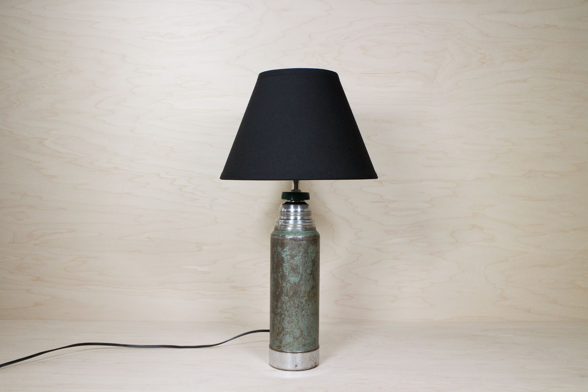

Ok, here's a better hint than just 'feel' it: A shade's height should be about 2/3 the height of the base. In most cases, this creates a visually balanced relationship. (I'm always open to exceptions!!)
