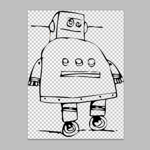

Step 1: Prepare Layers: Part 1 Black
First I imported the robot image into Photoshop.  Using the magic wand tool, I selected areas of color and deleted them from the layer.  The remaining black areas are the pieces that will be cut out (fig 2).  I made sure to connect all islands of material with small tabs so that they do not get cut away, I did this using the eraser tool (fig 3).  I decided the fingers of the robot were too small to add tabs, so I just filled these areas with black for now (fig 4).  I'll add color back in these spaces in a later step.

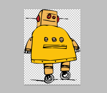

Step 2: Prepare Layers: Part 1 Yellow
I selected the background of the image with the magic wand tool (fig 1).  Ctrl+command+i to select the inverse.  I selected the yellow color from the robot using the eyedropper tool.  I created a new layer and filled the selected area with yellow (figs 2 and 3).  Then I deleted the original image (background layer).  I used the erase tool to remove unwanted pieces from the remaining yellow layer.  I chose to remove the antenna and wheels from the yellow layer since there will not be any yellow on these parts in the final image (fig 4).
