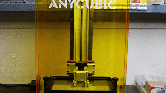

I have uploaded all the files to this step. I printed them with a layer height of 0.2 mm and a nozzle diameter of 0.6 mm. I used old filament. Some of it was more than 7 years old. Therefore I had to dry it first and still had some brittle parts and some parts that didn't print well. But since it was such a big model it didn't really matter.
The flame was printed with my SLA 3D printer.

Step 19: Printing the Flame
Printing the flame is pretty straight forward. I broke the support structures away, before cleaning and curing the print.
Step 20: Curing and Sanding
After curing the print I sanded away the leftover support structures and wet sanded it with 360 grit sandpaper. Since the print was slightly yellowish after the curing I airbrushed translucent white paint onto it.
