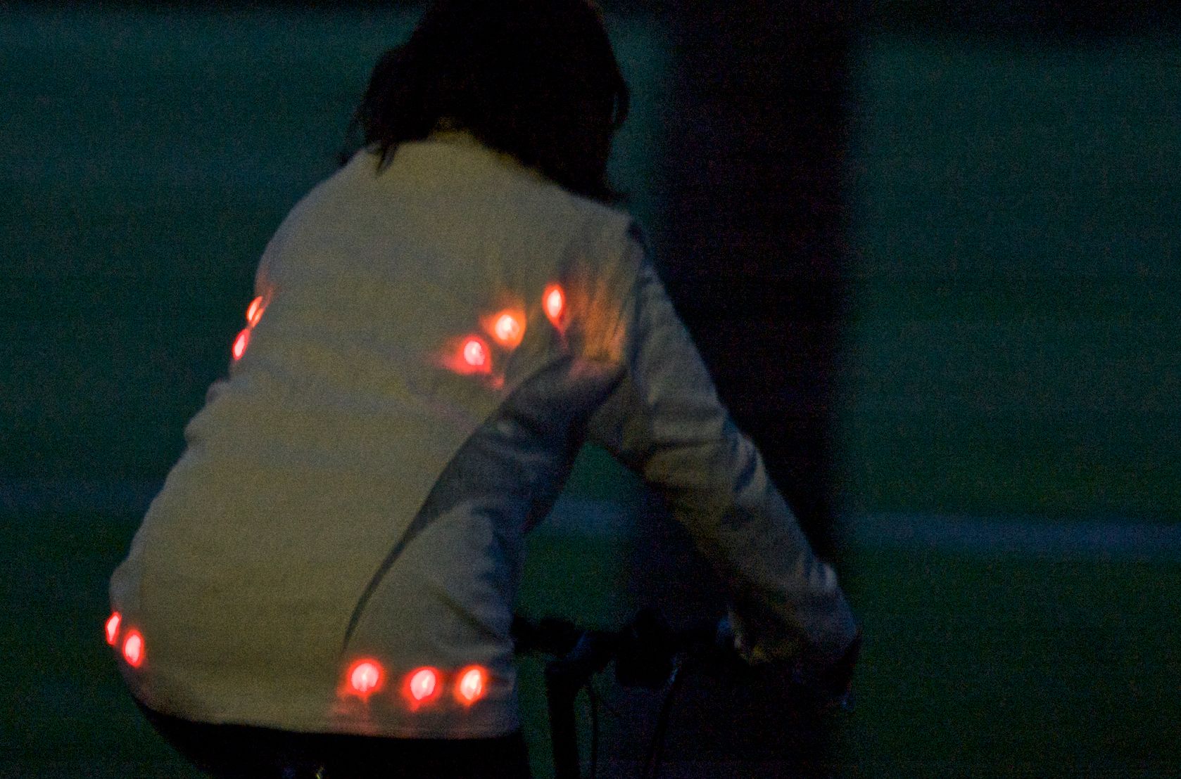

Introduction: Light for Life: 3D
In 2009 i created and published a jacket called Light for Life. It consisted of an Arduino, a set of LEDs integrated into the buttons,and two pushbuttons to activate them. I really wanted to make more of the buttons, but they were hard to make; requiring a drill, glue, and filing down each LED lens.
Now that desktop 3D printers are around, its time to make some the DIY 2.0 way!
NEW: I made a video of the jacket here. Check it out!
