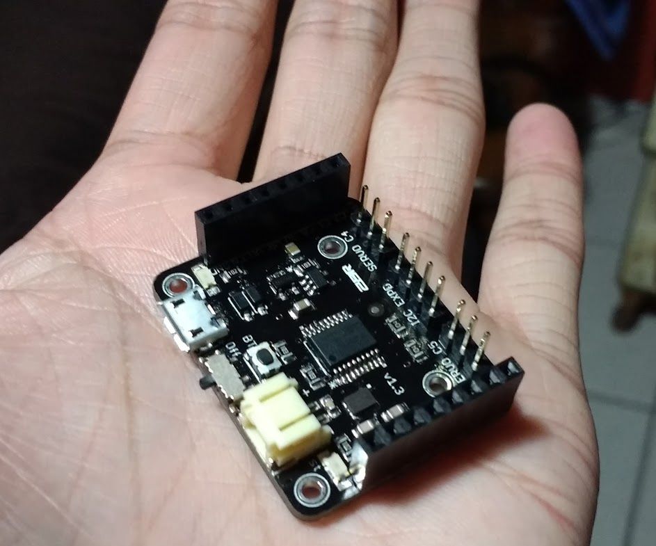

I made it to be programmed with the Arduino IDE, but is also possible to use the development IDE that you prefer. It has a powerful PIC32 with an USB bootloader, so you don't need a programmer. It also has an ON/OFF switch, a reset and a start/program button. The LEDs are connected to the motors PWM signal, so you can see the power that you are applying easily.

As you can see in the pictures all the component are SMD, is the perfect opportunity to practice your soldering skills. This robot was soldered by 3 of my students, so you can do it without trouble. All the design files are attached, you can see the files with EAGLE. Gerbers are also included if you want to the boards to your favorite PCB manufacturer.
The two boards are joined together with an acrylic piece, the laser cut pattern is included too. I used M2 screws and nuts for keep it in place. The ball caster is also placed in here. And if you crash the robot the acrylic will break and protect the boards from damage, ideal for testing! The flat wire is used to do the connection between the CPU and the sensor board. The motors are easily connected with wires to the CPU board.
Note: the PIC uses a custom firmware, is a modified version of the DP32 original firmware. You can get the firmware here. An ICSP connection is included on the bottom of the CPU board.
