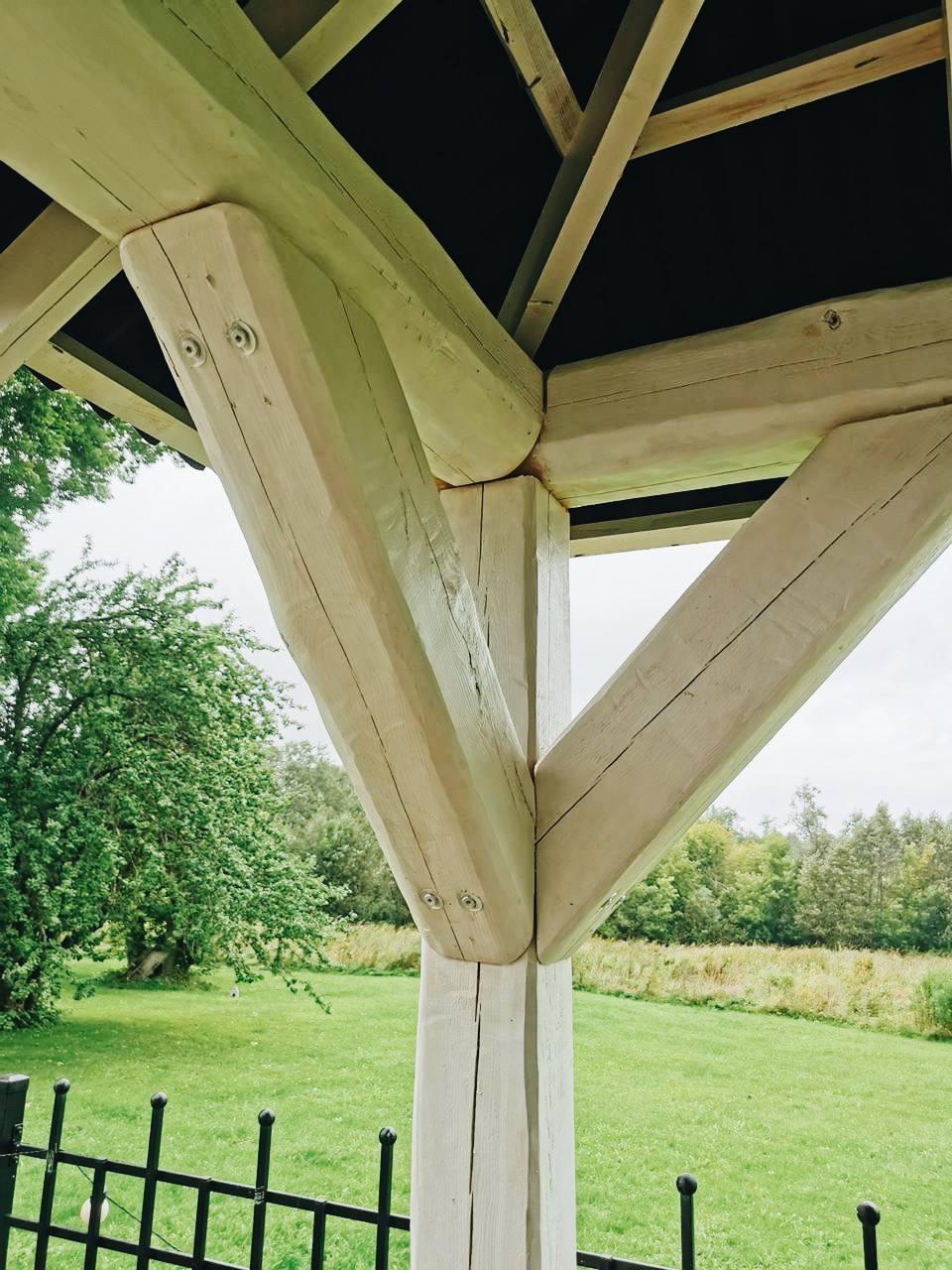

Step 10: The Diagonals
As imagined the structure was a bit wobbly. It was missing diagonal bracing. To fix that each post got two diagonals between the post and the frame. These were cut from the leftover material and were exactly 1 meter long. I started getting really nice cut quality with the chainsaw and it made me happy. The diagonals were attached with four big bolts. After these were attached there was no sign of the structure being wobbly anymore. Well, to be honest, I did not manage to add all the diagonals straight away as we ran out of material once again.

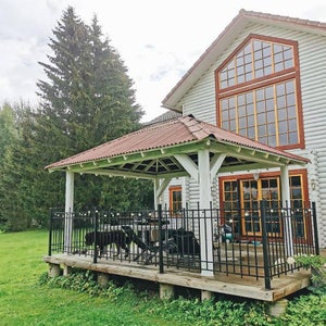

Step 12: The Roof
To add the roof 2X2 purlins were added perpendicular to the rafters. The spacing between those was 400 mm. Everything was covered with protective wood finish before adding the roof sheets. Great in theory, but as you can see it did not turn out so good. The problem was that that the person, who installed the roof sheets was really inexperienced. He installed the sheets by nailing them in the low seam. This is a big mistake as water flows in there and leaking is inevitable. Also, the nails protruded through the purlins as they were too long. The correct way would have been to nail the sheets through the high seam.
