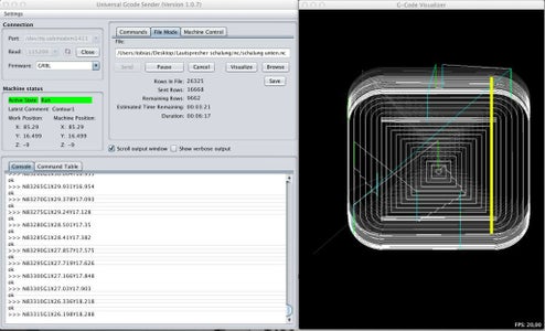

Step 2: Milling Out the Molds
The molds were milled out of 40mm thick styrofoam. The material allows for fast feed rates of the machine and therefore little time in making all the parts needed. But it is still rigid enough for holding the details and to be filled with concrete later on.
This step was made on my DIY shapeoko-style Desktop CNC mill.
