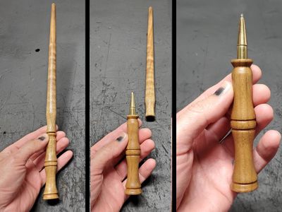

This is the fun part where you can use your imagination. I make a mark with a pencil at about 4 inches from the bottom, this will be the handle section. The handle has to be long enough to accept the pen kit, for the Slimline kit I am using 4 inches will work. Then I make a few marks to indicate where I will be cutting into the wood to get the various contours I am after. I usually don't have a plan for this I just kind of make a few cuts here and there and see what look right. The key here is to make sure you don't remove too much material; the pen kit will be going in to a 5/16-inch hole so the smallest I make the handle is about 5/8 - 3/4 of inch round. This gives you a little wiggle room when drilling the hole. If the walls of the hole are too thing they will break.
As you can see from the pics, I use various carbide cutters to make the different shapes. I also make sure to make a transition from the handle to the shaft section. This is no right or wrong here just make what feels or looks good to you.

Once the epoxy is cured you can assemble the pieces. The pen assembly goes into the handle and then the wand shaft slides over the pen tip like a pen cap would.
Step 26:
This project was trickier than I expected. Both my kids and my wife really liked the final result. My son even said I should send this to the Harry Potter Company because people will be willing to spend a lot of money on these. I thought that was really nice of him to say. I really liked the end result and see myself making more of these in the future to give away to all the Harry Potter fans in know. Thanks for taking the time to read this, I hope you find this Instructable helpful and maybe it even inspires you to make your very own pen wand...wand pen...pen wand? I don't know which should go first the "pen" or the "wand"?
