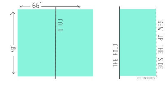

Find a pattern that works for you. I followed the one labeled "Fur Snood" found on this website : http://www.cottonandcurls.com/2012/11/diy-infinity-or-circle-scarf-tutorial-aka-the-snood/
"Cut 2 pieces of fabric, the outer piece will be about 33″ long x 12″ wide. The second piece of fabric is the liner, cut it to be 33″ long and 2″ shorter so the outer piece will roll over into the inside a little. Pin and sew right sides together the edges together"
I use a sewing machine - but this pattern is fairly simple and you can just hand sew as well.
