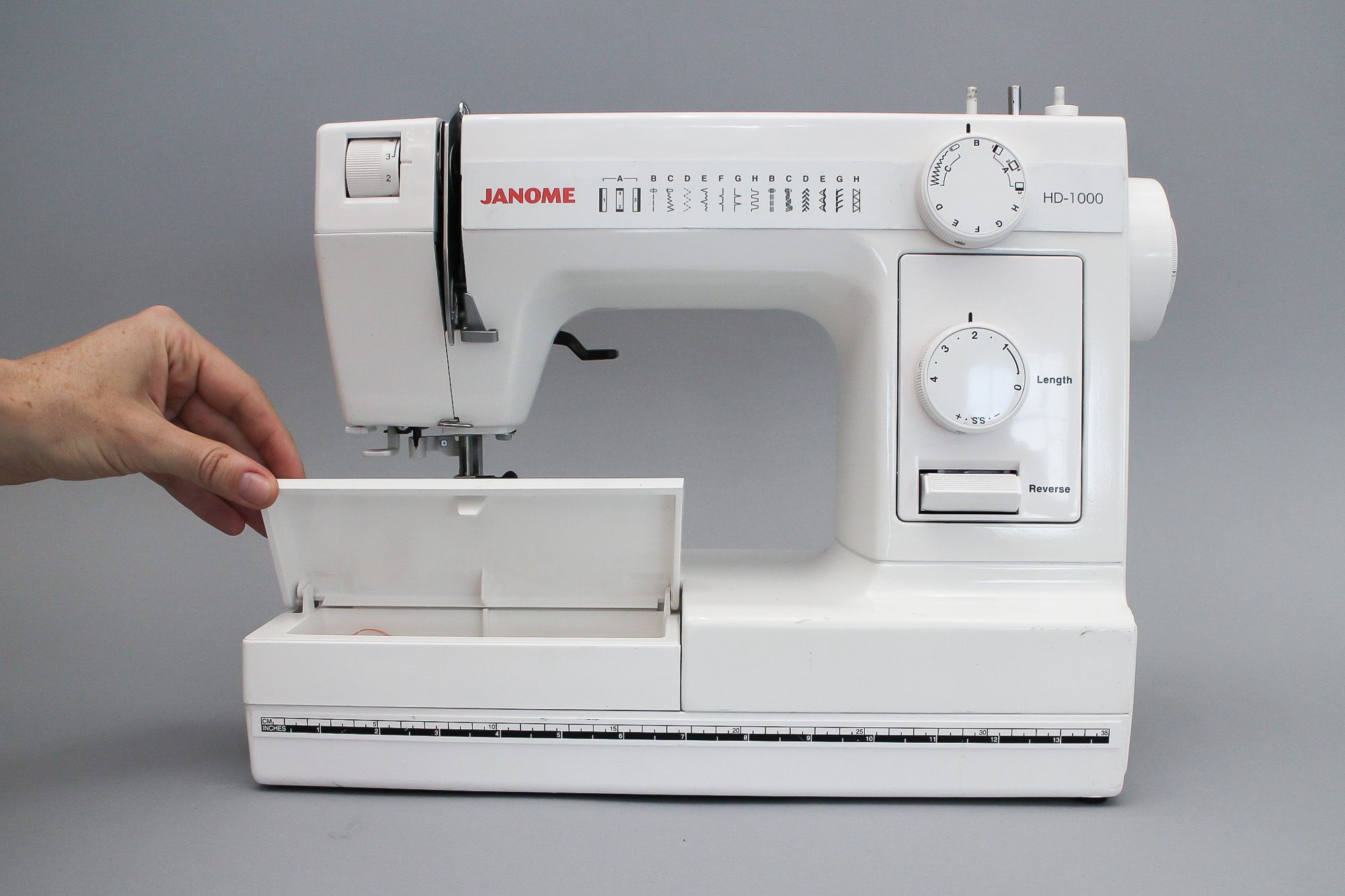

Step 2: Anatomy of a Sewing Machine
Home sewing machines all have the same basic features. Though your machine may look a bit different than the one I'm showing here, the basic functions will be the same.
I know no one really wants to read an entire sewing machine manual, but it's definitely a good idea to look through the one that came with your machine and read about the more important features, like how to thread your specific machine, wind your bobbin, etc. (If you have an old machine without a manual, you can usually find it online). I have to admit, I learned a few things about my machine that I never knew by looking through the manual while I was writing this class... so read yours! ;)
All home machines will have some variation of the basic components I'm pointing to in the diagram above. We'll learn to identify each part now, and talk about a few of them in more depth later:
Extension Table/Storage Box - most machines have a removable section here. keeping the extension table in place gives you a larger sewing surface, while removing it turns the bed of the machine into a free arm that allows you to sew small hard to reach pieces and loops like sleeves. On some machines, like mine, this removable section is also a small storage box where you keep extra bobbins, needles, presser feet etc.

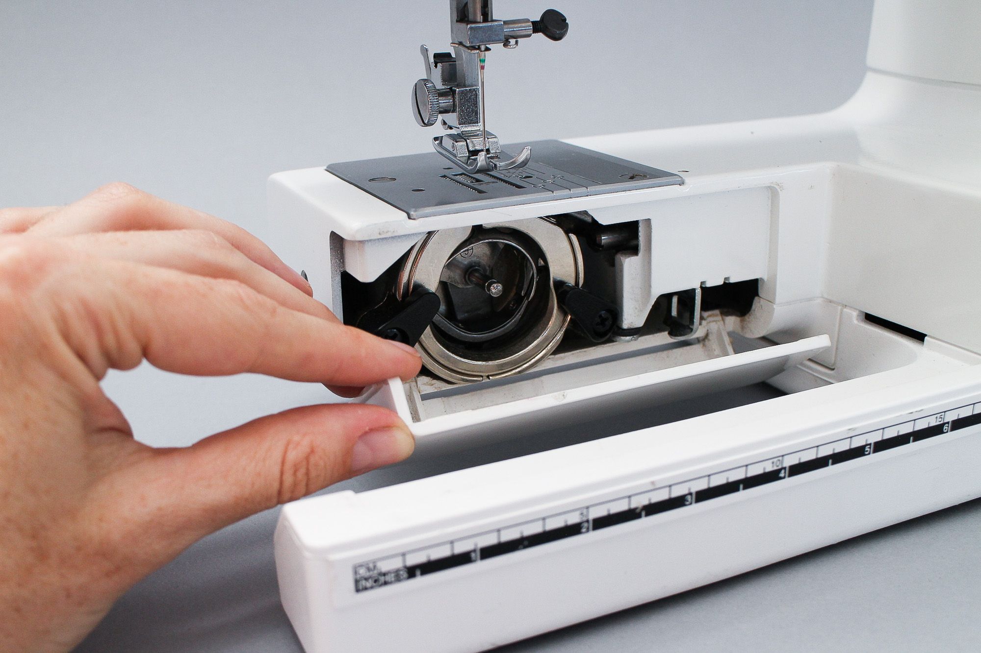

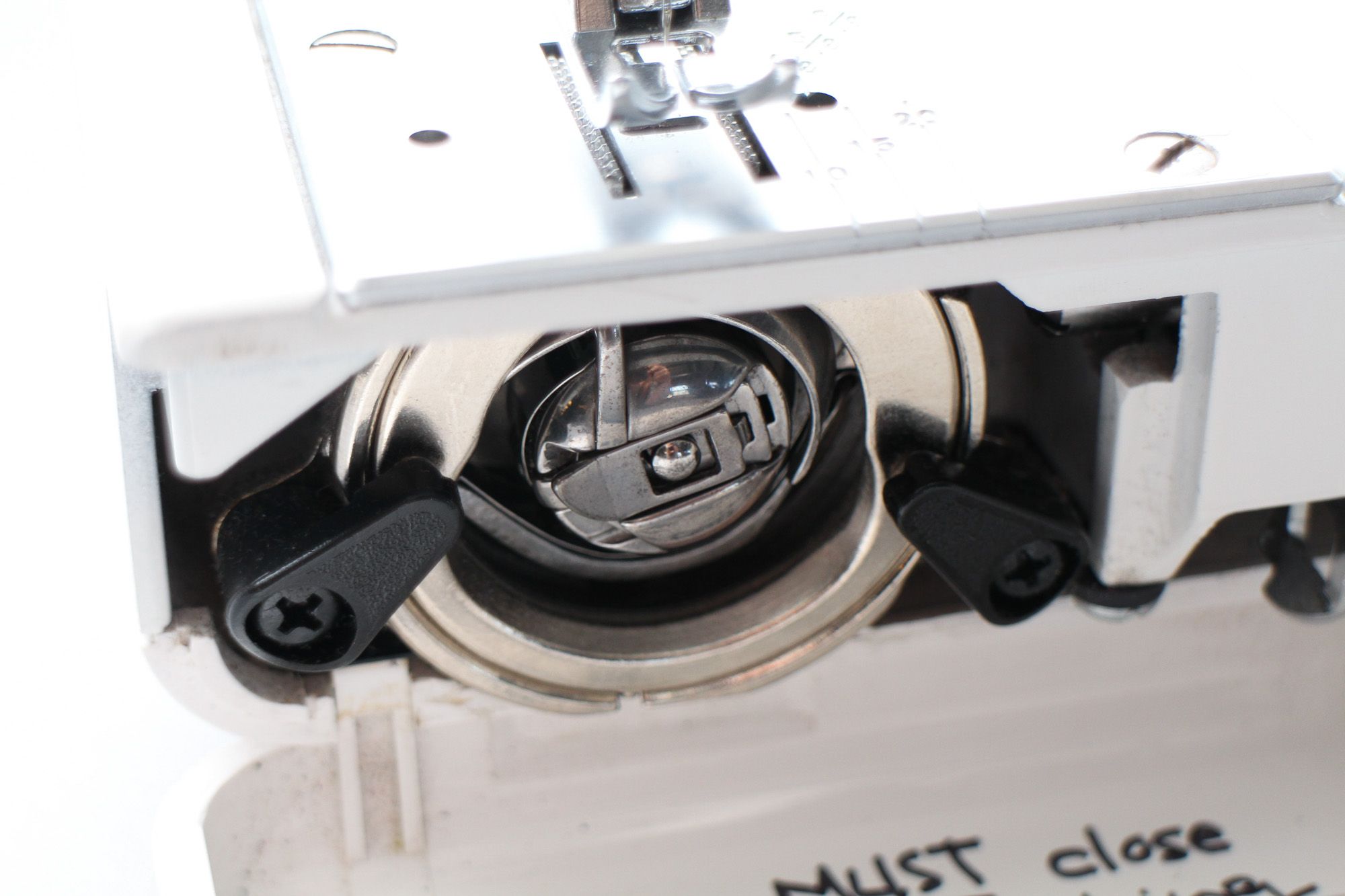

All machines will also have a bobbin assembly in the bed of the machine which is either "top loading" or "bottom loading". The bobbin on this machine is bottom loading and you access it by removing the extension table and flipping down a little panel.
Inside this panel you will find the shuttle which holds the removable bobbin case.

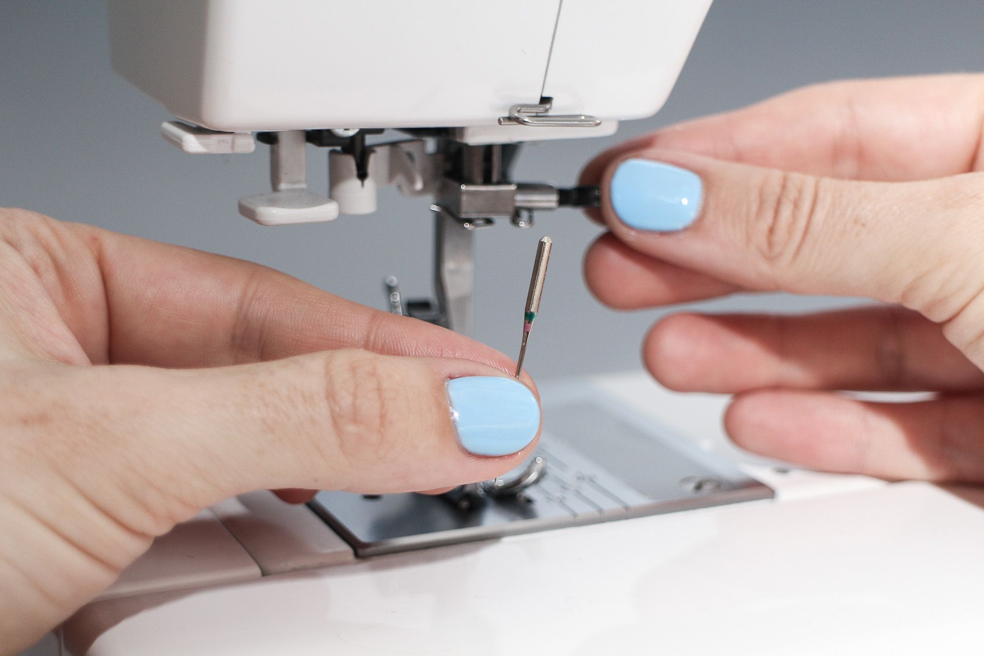

If your machine doesn't have a needle in it, you'll need to put one in, and you'll also sometimes need to change needles for different fabrics, or replace one that's broken.

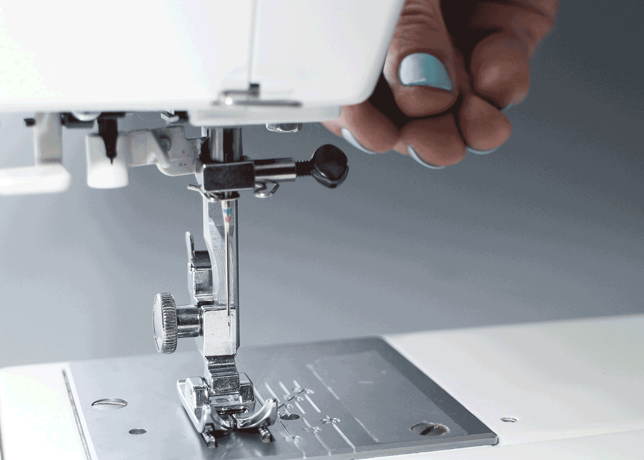

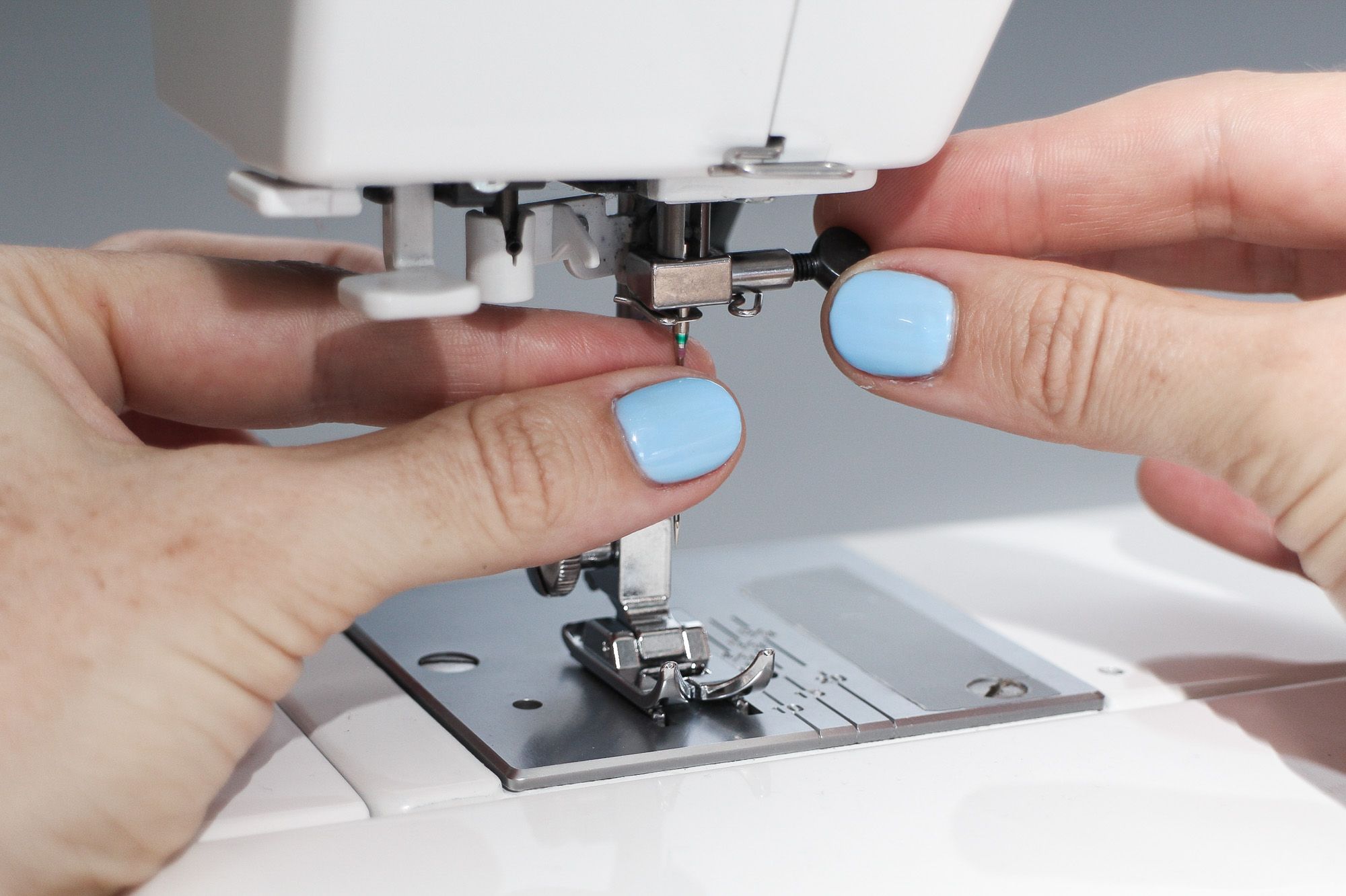

To change the needle in your machine, first make sure the power is off. Sewing machines are powerful little creatures and you don't want to accidentally start sewing while you're messing around with the needle.
Now turn the handwheel towards you until the needle (or empty needle shaft) raises to its highest point, and use the lever in the back to make sure the presser foot is lowered.
Hold the needle while you turn the clamp screw on the right side of the needle shaft towards you to loosen the needle. (On my machine this screw has a flat head that you can turn with your fingers, but on some machines you need a small screwdriver).
If there's an old needle in there, it should come out easily. Insert a new needle and tighten the screw again.

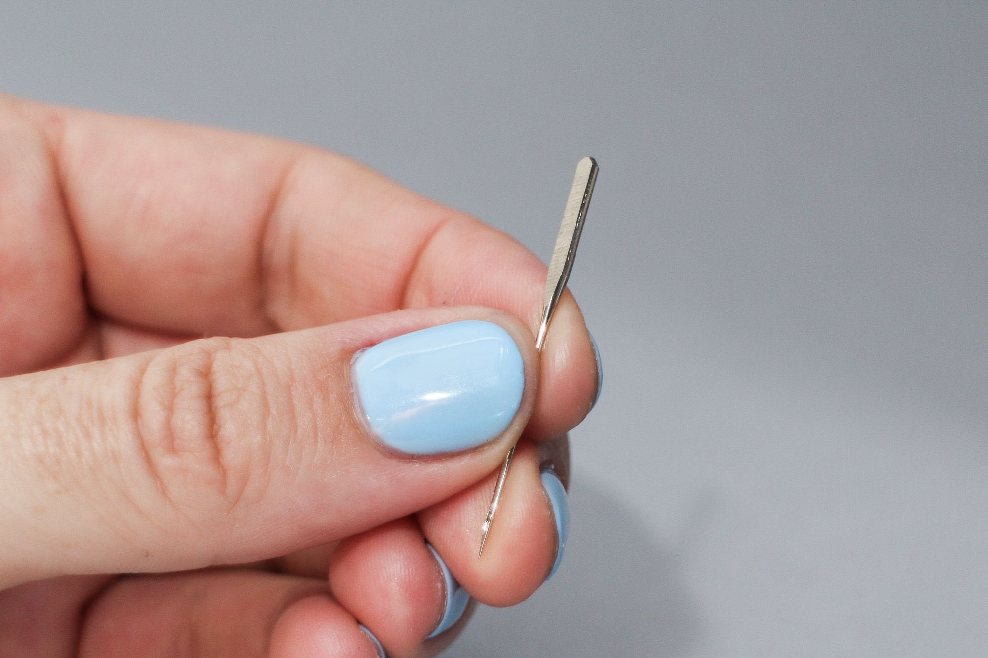

My machine, and most home machines, take standard home machine needles that are flat on one side of the top shaft. This flat side should always face toward the back of the machine when you insert the needle.

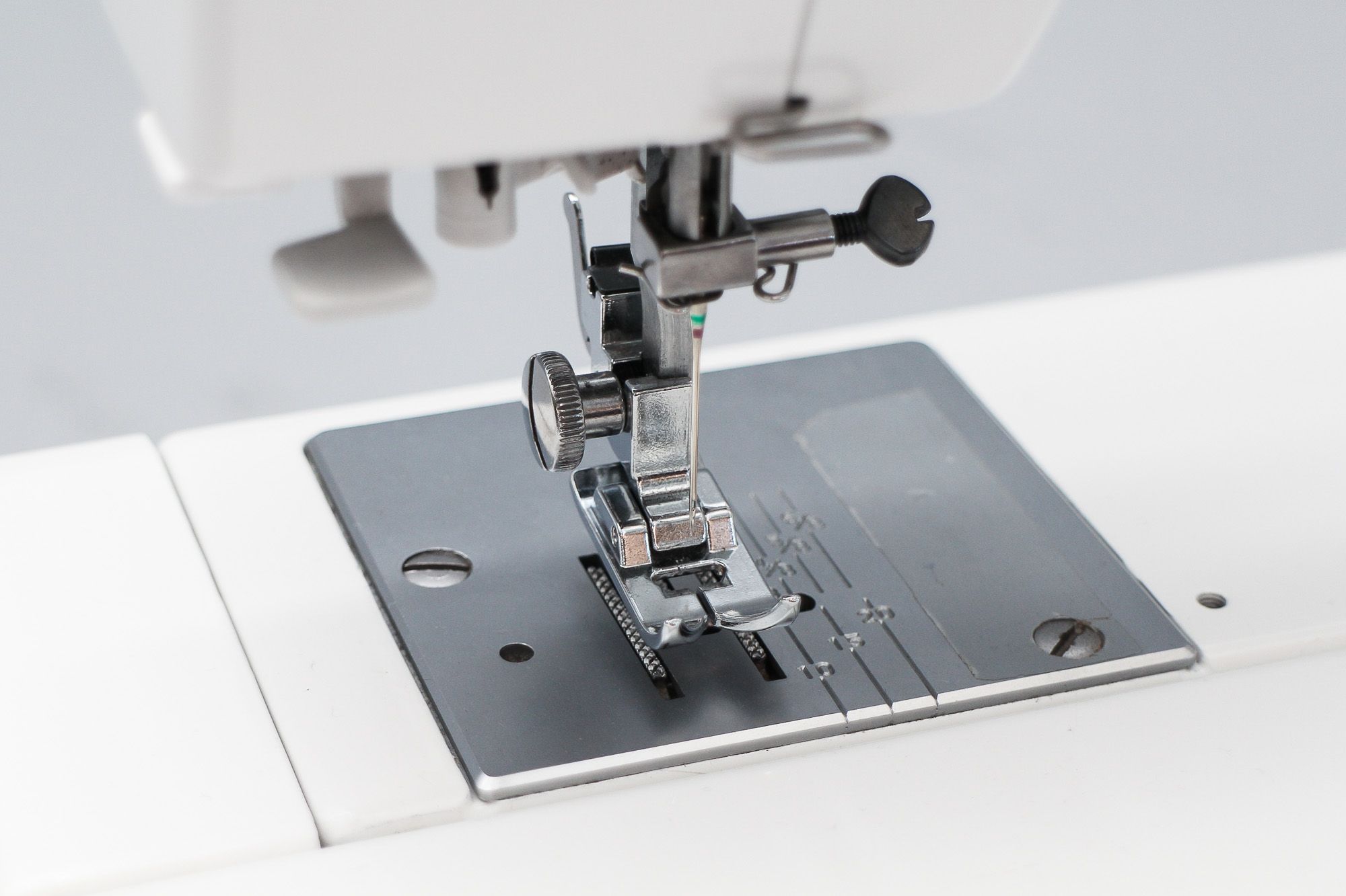

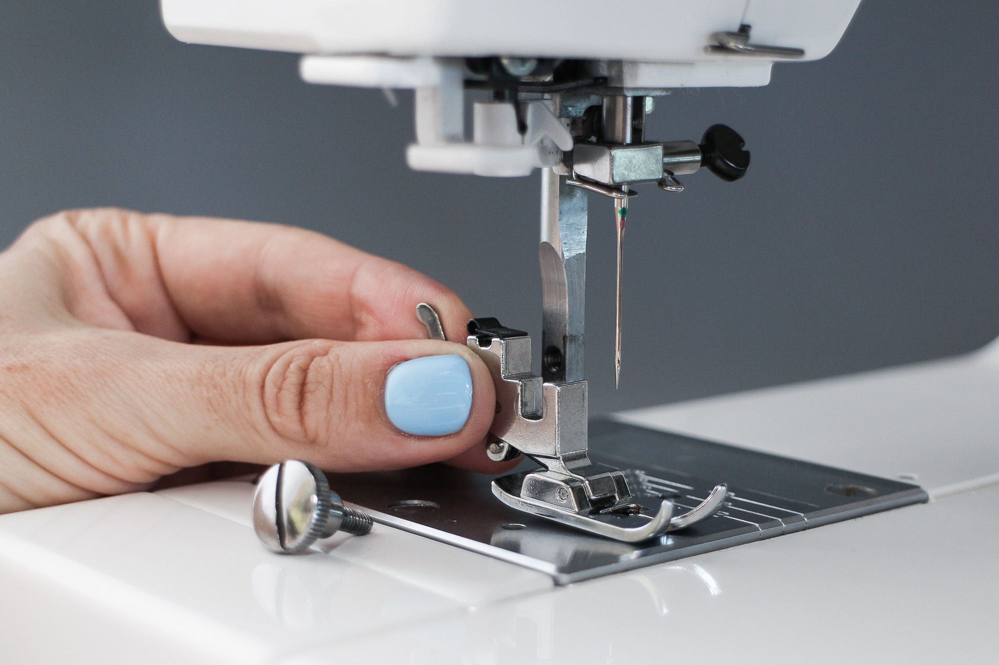

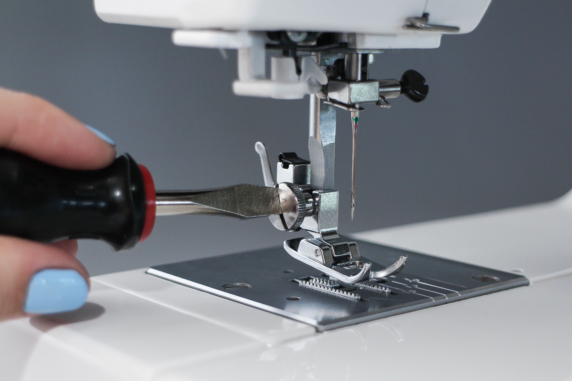

Step 4: Changing Presser Feet

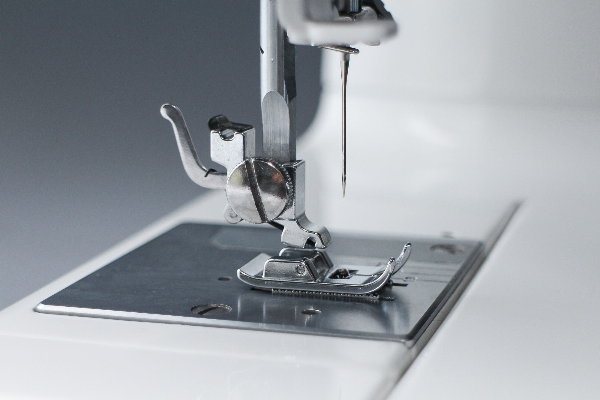

The presser foot assembly is made up of three main parts: the presser bar, the foot holder and the presser foot. Most home machines use universal assemblies that are interchangeable, but some have proprietary parts, so check your manual to find out.
The foot holder screws onto the presser bar, and then different types of presser feet can be easily attached and removed from the foot holder. To attach certain kinds of feet you sometimes take off the whole foot holder as well.
To attach the foot holder, raise the needle out of the way, fit the foot holder over the end of the presser bar, insert the thumb screw and tighten it with a small screwdriver.
To remove a foot, just press the small lever on the back of the foot holder.
To attach a foot, raise the presser foot lifter, and position a foot under the foot holder.
Lower the presser foot lifter so the holder snaps onto the foot.

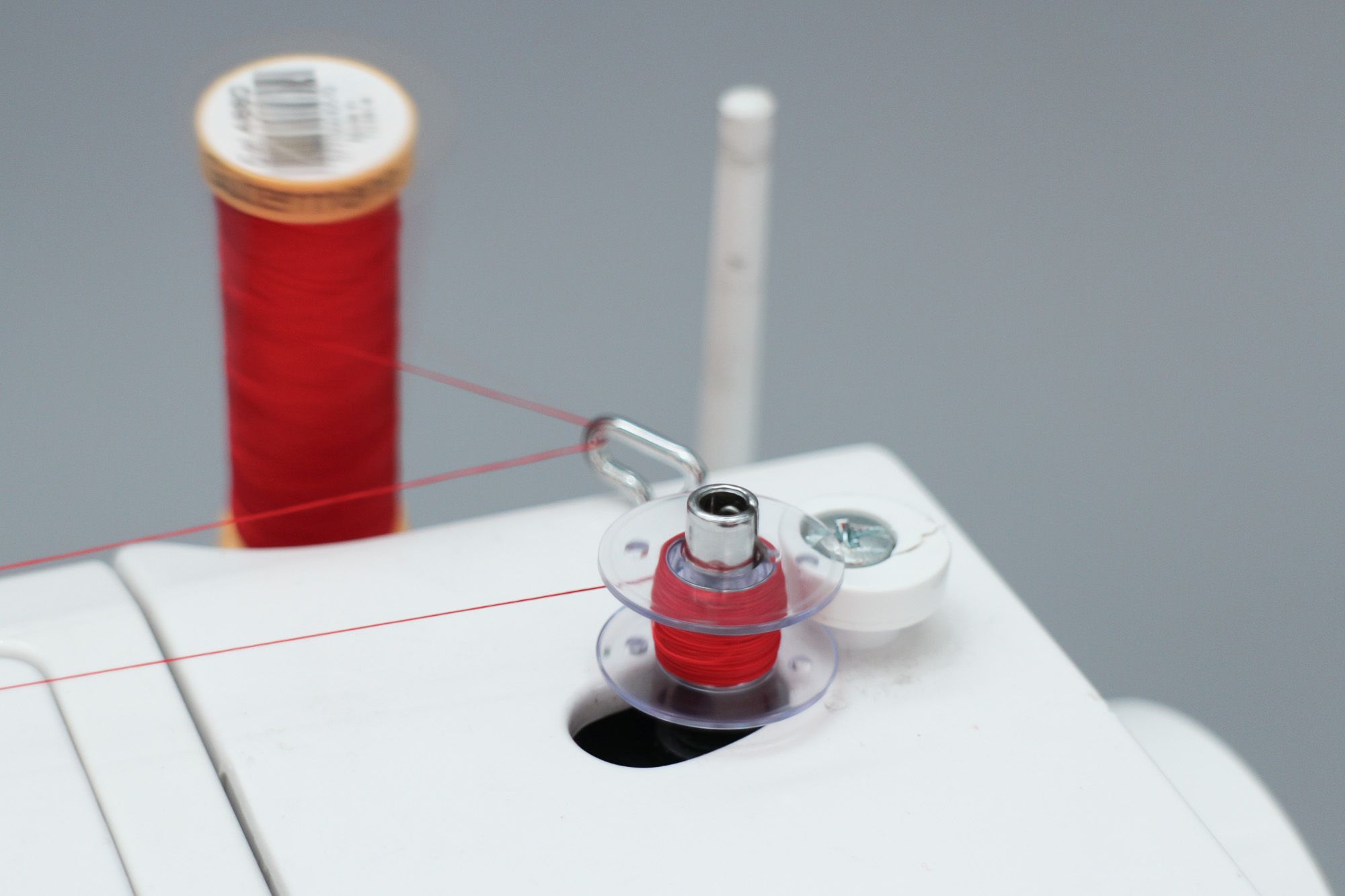

Step 5: Winding a Bobbin
The bobbin is a small spool of thread that goes underneath the needle and loops around the top thread as you sew to create a lock stitch. Before you thread your machine or start sewing, you need to wind a bobbin in the thread color you want to use. Check your manual to see how to wind a bobbin on your machine.

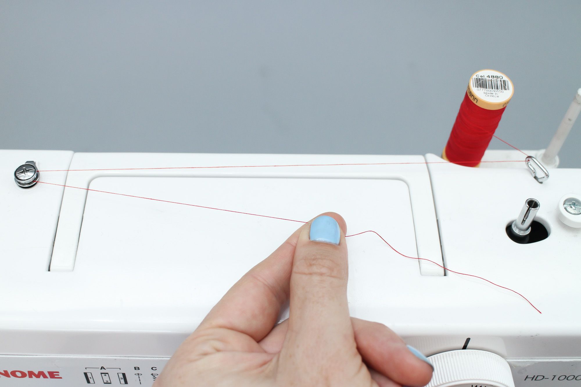

On my machine, you take a spool of thread and put it on the thread spool pin. Then take the loose end of the thread and guide it through the topcover thread guide and the bobbin winder thread guide like this:
Then take an empty bobbin and stick the end of the thread through the hole in the top of the bobbin like this: (You can also wind on top of a spool that has some thread on it already, but you shouldn't do that unless you have to).
Push the bobbin down onto the bobbin winder spindle, and push the whole thing to the right.

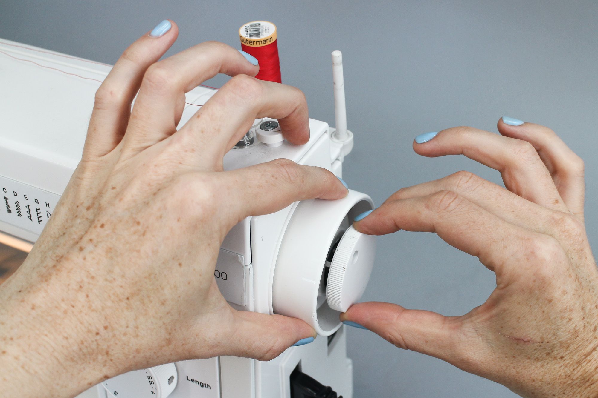

Before you actually wind the bobbin you need to disable the functions of the rest of the machine so the presser foot doesn't just pound up and down pointlessly. On my machine, you hold the handwheel with your left hand and turn the stop motion knob in the center of the handwheel towards you with your right hand.
Now hold the end of the thread that is sticking out of the bobbin while you press down on the foot pedal. The bobbin should begin to spin and thread should start winding around it. After it has wound a few times, stop and cut off the end of the thread close to the bobbin, then keep winding until it is full. Some machines have a mechanism that automatically stops the bobbin from spinning when it's full, but you can also just stop it manually.
Cut the thread between the spool and the bobbin, take the bobbin off the spindle and push the spindle back to the left hand position. Also make sure you rotate the stop motion wheel away from you again, or the machine won't sew!

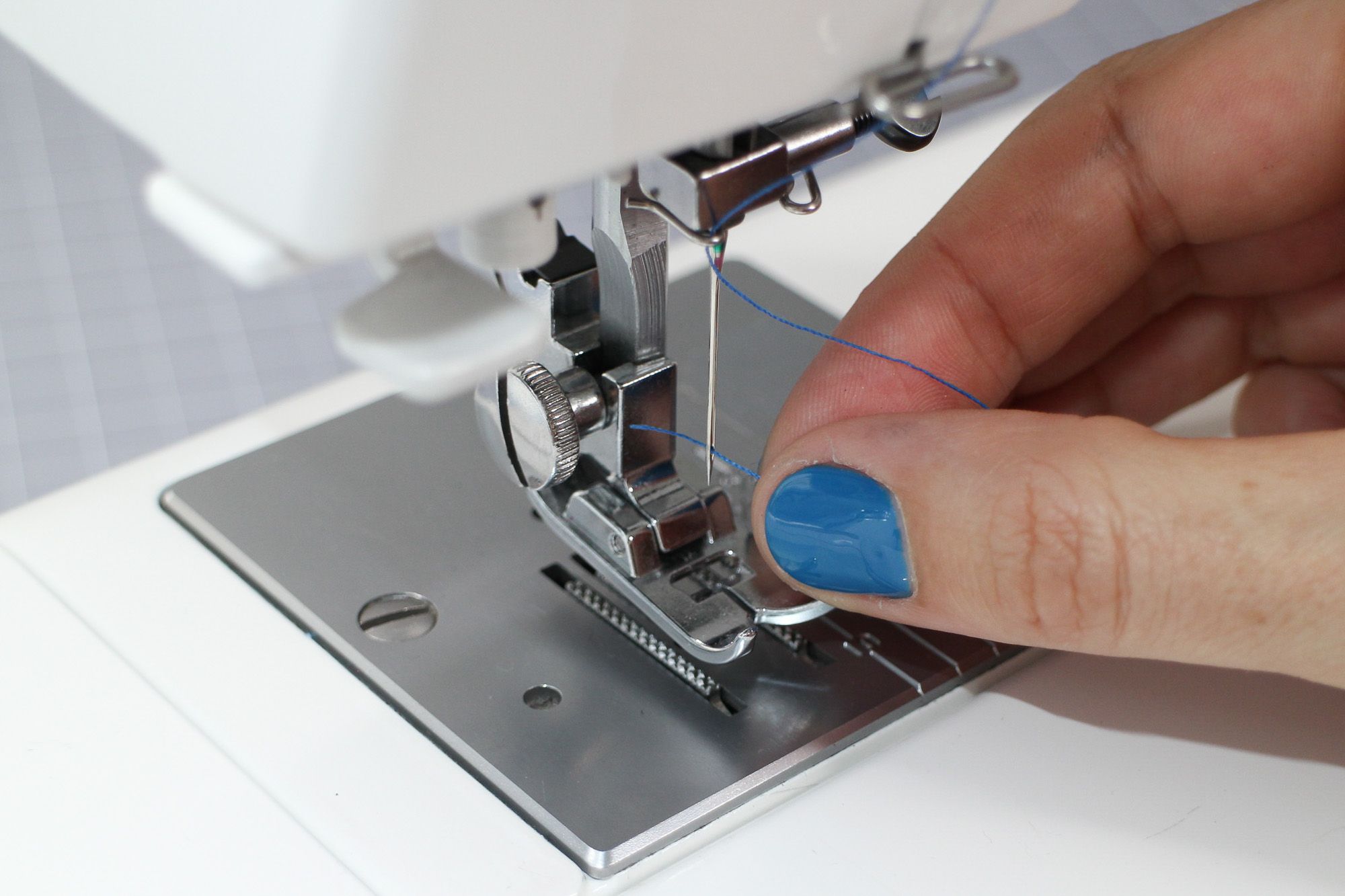

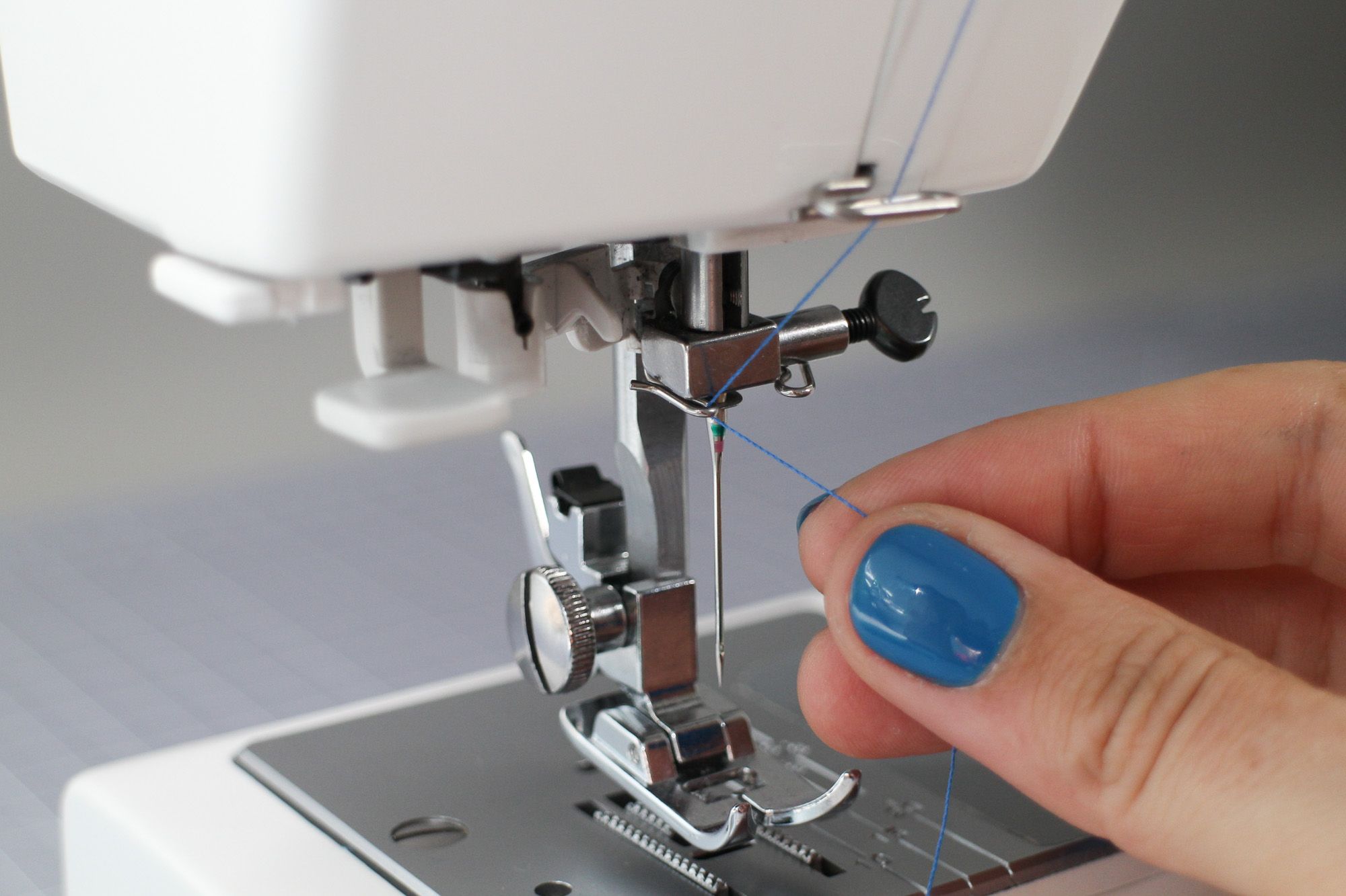

Step 6: Threading the Machine

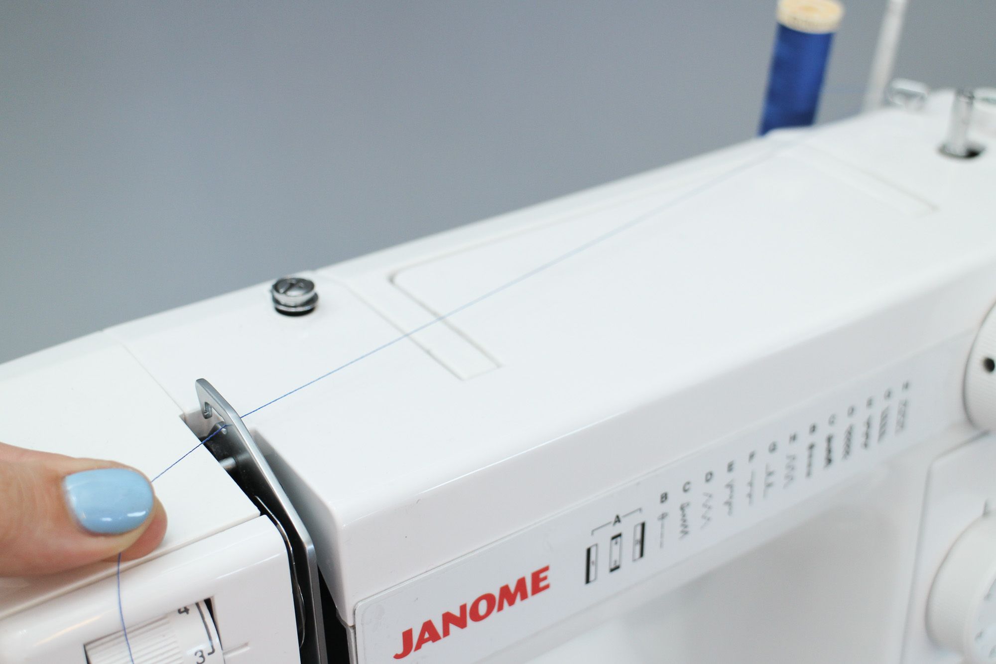

Every machine has a slightly different threading design, but they are based on the same principal. Look at your machine's manual to see exactly how to thread yours. Most of the time you want to use a top thread the same color as your bobbin thread, but for our purposes here, let's load thread of a contrasting color.
First, turn the handwheel until the thread uptake lever pops out of it's slot. Stop it at its highest point.

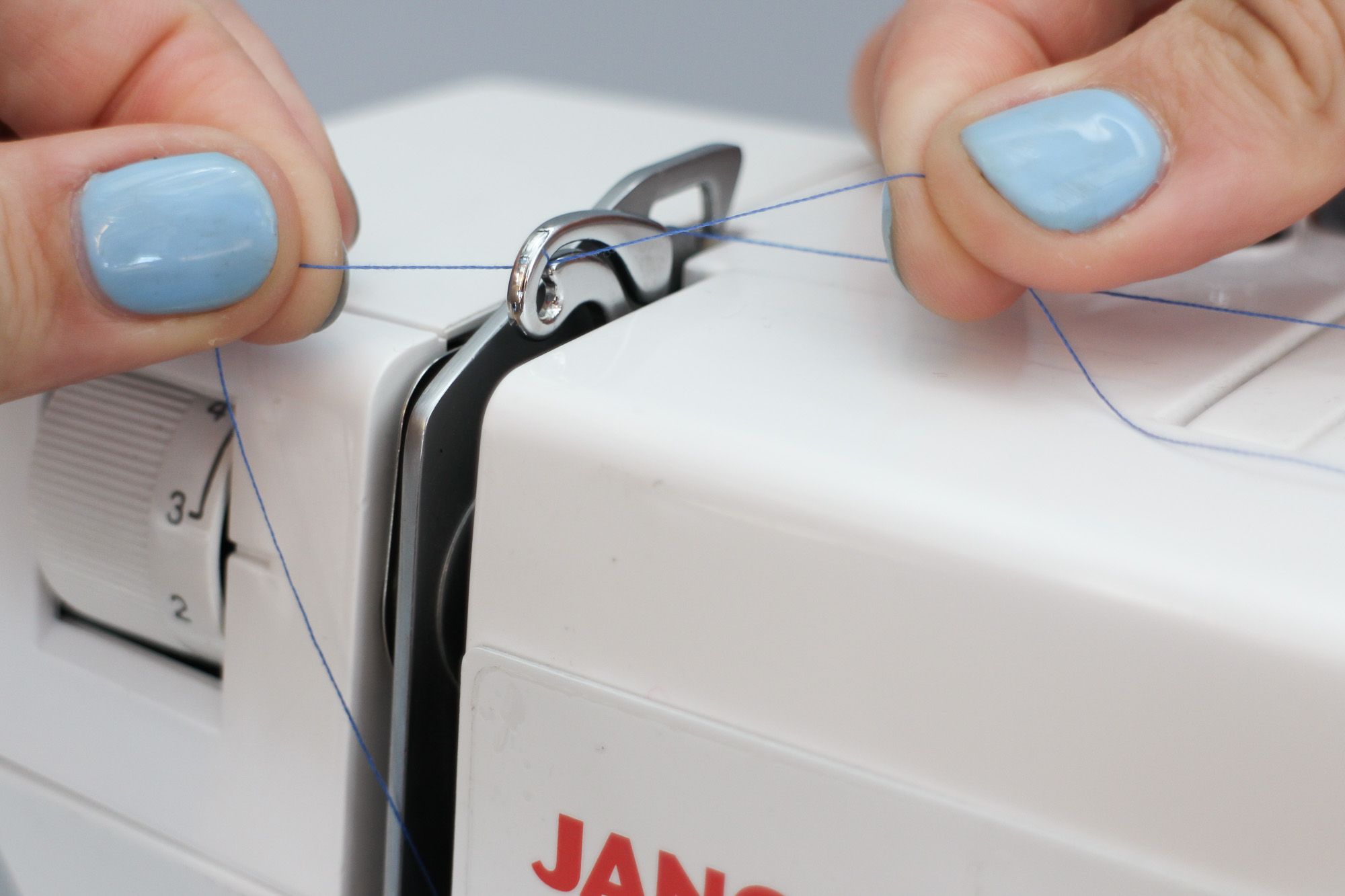

Now, put a spool of thread on the thread spool pin, and guide the thread through the top cover thread guide and then the upper thread guide.
Next, loop the thread from the left side down around the bottom of the check spring holder, up the right side and into the eye of the thread uptake lever by pulling it up from left to right.
Thread the two lower thread guides and then the needle bar thread guide.
Last, pass the thread through the eye of the needle from front to back, then pull the thread under and back between the forked prongs of the foot.

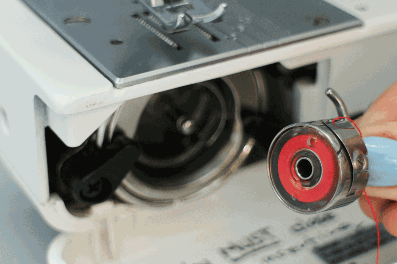

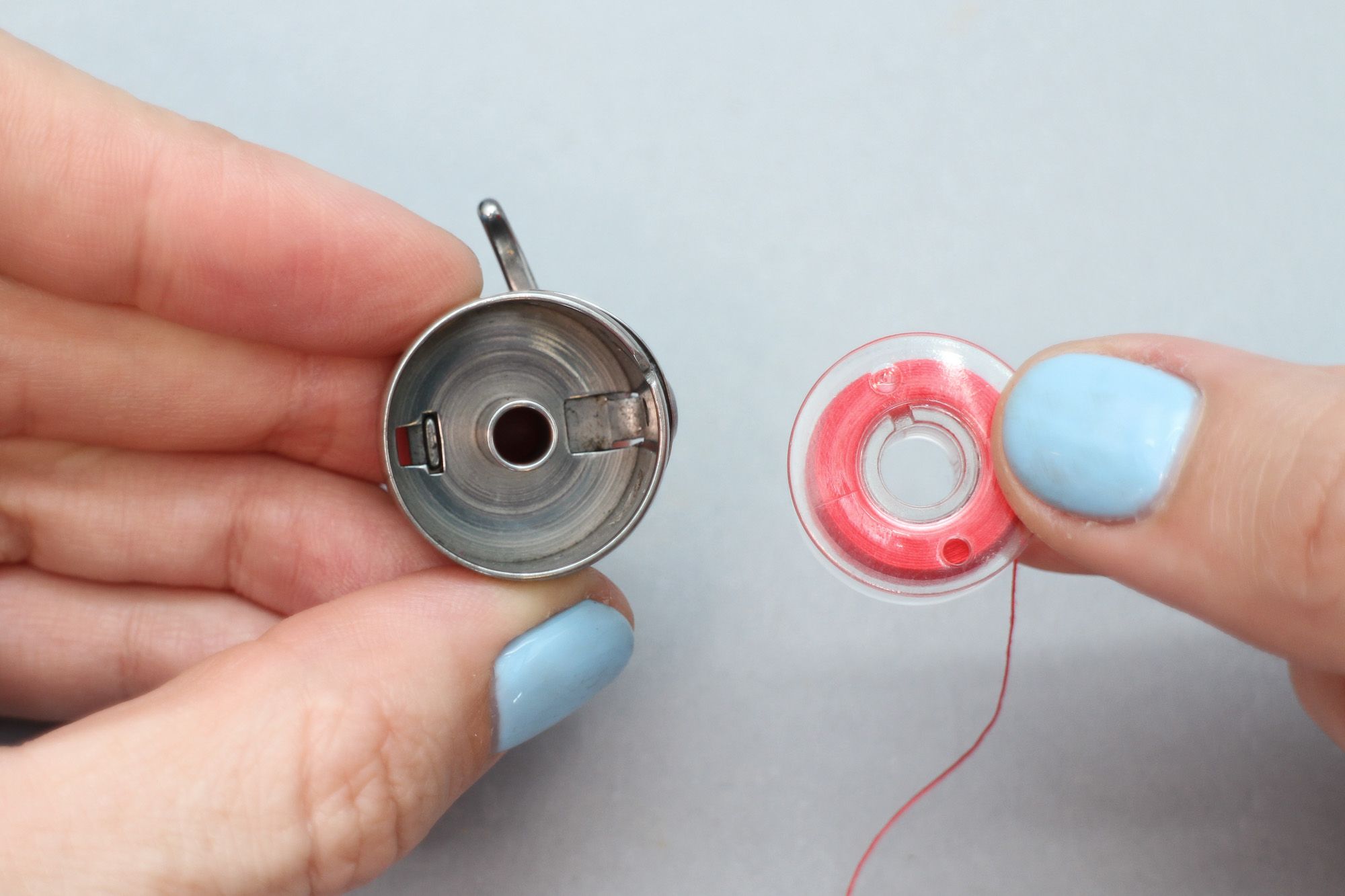

Step 7: Loading the Bobbin

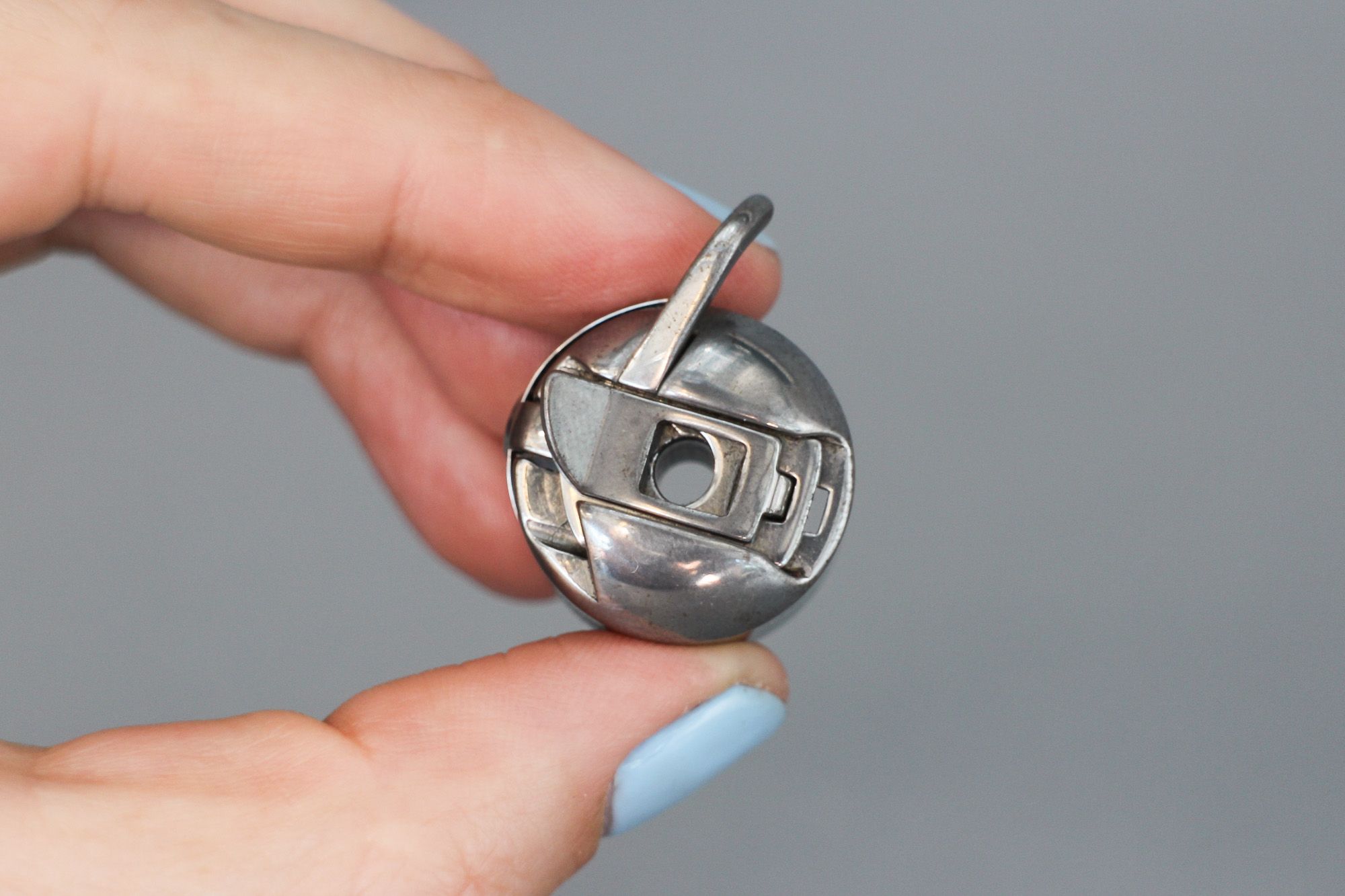

First take the bobbin case out of the machine if it's in there. On my machine, which is bottom loading, pull off the table extension and open the panel below the needle plate. Remove the bobbin from the shuttle by grabbing the little metal latch on the front of the bobbin case, and pulling it out.

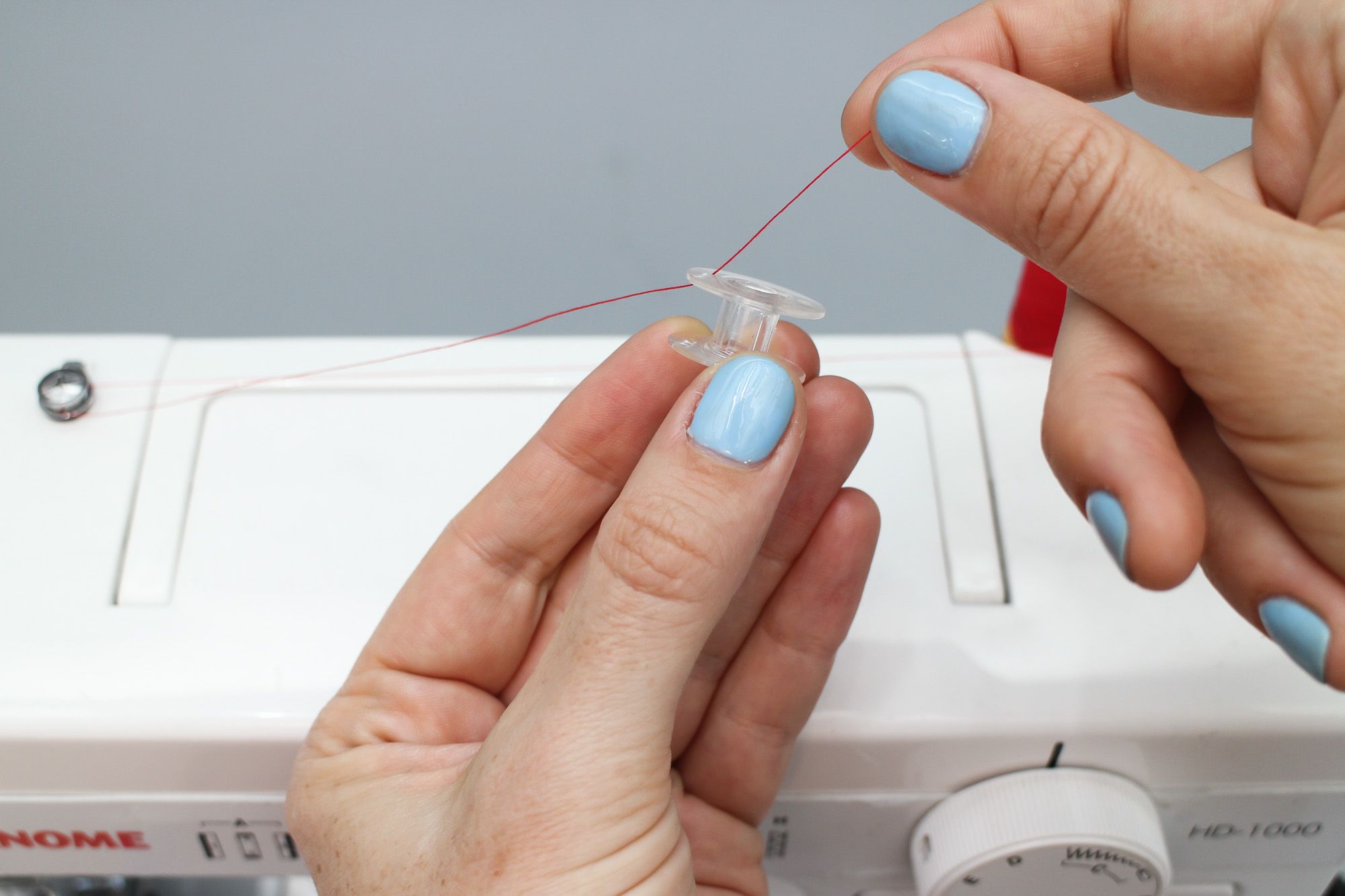

To insert a new bobbin into the case hold it in one hand with the little protrusion sticking upward. In your other hand, hold your bobbin with the end of the thread coming down off the right side so the bobbin looks like a lowercase "q" not a "p".

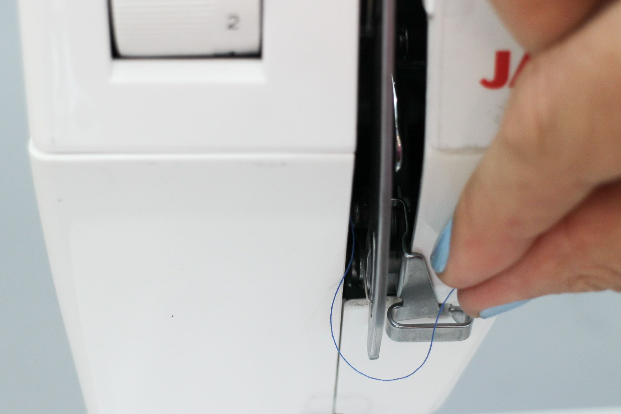

Stick the bobbin into the case, then grab the end of the thread and guide it through the the slot in the side of the case until you feel it pop. Leave about 4 inches of thread hanging out.
Now take the case and hold it by the latch lever, the same way you did when you removed it from the shuttle. Stick it back into the shuttle and rotate it a little until you feel it pop into place. When you release the lever it should stay in the shuttle.
Make sure you close the panel over the bobbin shuttle when you're done.

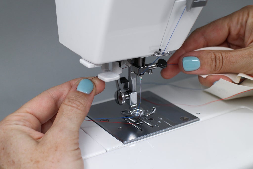

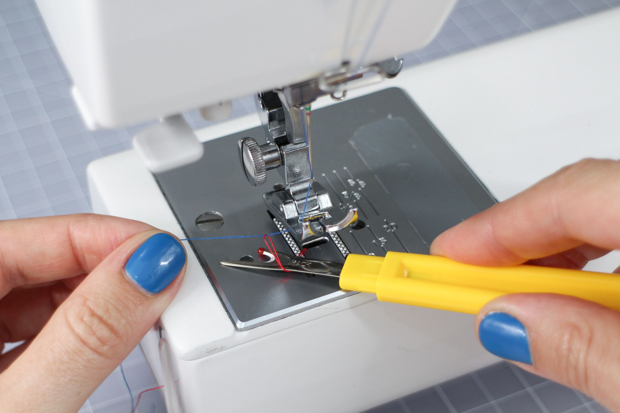

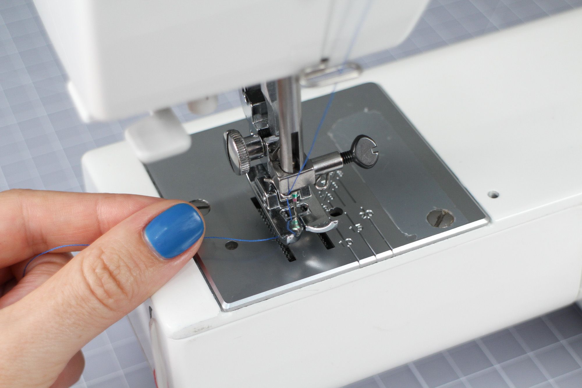

Now you need to draw the bobbin thread up above the needle plate. Raise the presser foot. Grab the end of the top thread with your left hand while you turn the handwheel towards you with your right hand so the needle dips down and then up again. Pull on the thread in your left hand and you should see the bobbin thread appear as a loop below the foot.
Pull on the top thread until you can grab the bobbin thread, sometimes you need to stick something under the presser foot to help you pull the thread out. I seam-ripper works well for this.

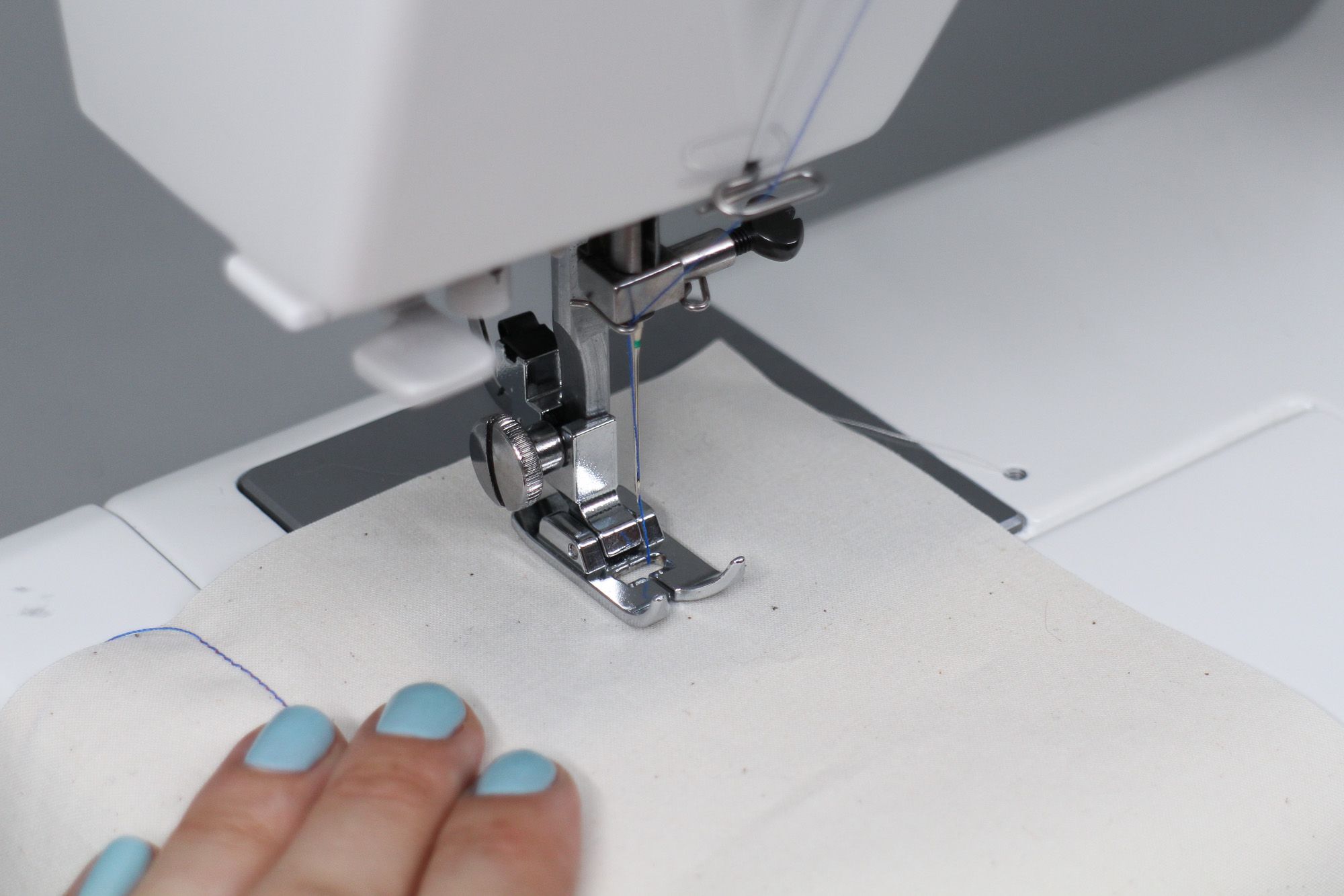

Sit down on a chair in front of your machine, make sure the machine is at a comfortable height for you to reach. Raise the presser foot and the needle and make sure at least 3 inches of thread ends are coming out under and behind the foot.
Now put your scrap piece of fabric under the foot and lower it.
Place a hand gently on each side of the fabric, and press down lightly with your foot on the foot pedal until the machine starts to sew.
The fabric will naturally feed under the foot as the machine sews, so all you need to do is guide it lightly in the right direction with your hands on each side of the fabric. As you can tell, pressing down harder on the foot makes the machine sew faster, so practice regulating the speed until you get comfortable.
Be aware of where your hands are in relation to the needle. Sewing on a home machine is fairly safe, but if you get your hand caught under the needle while it's moving, there's a good chance it will puncture your finger. Accidents do happen, so be aware, be careful, sew consciously and intentionally.

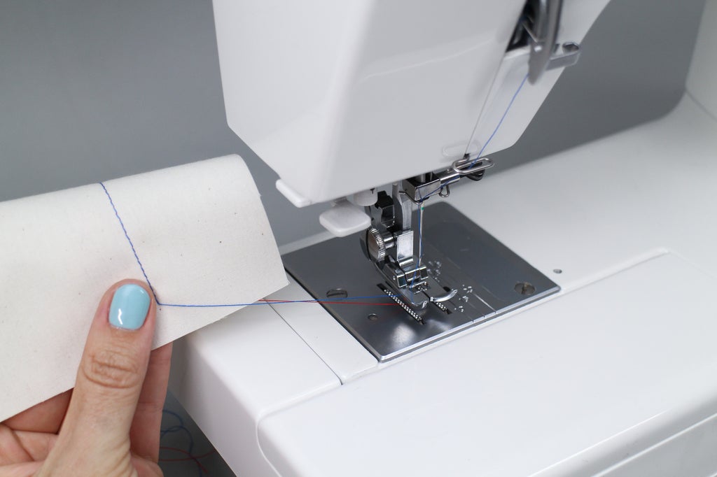

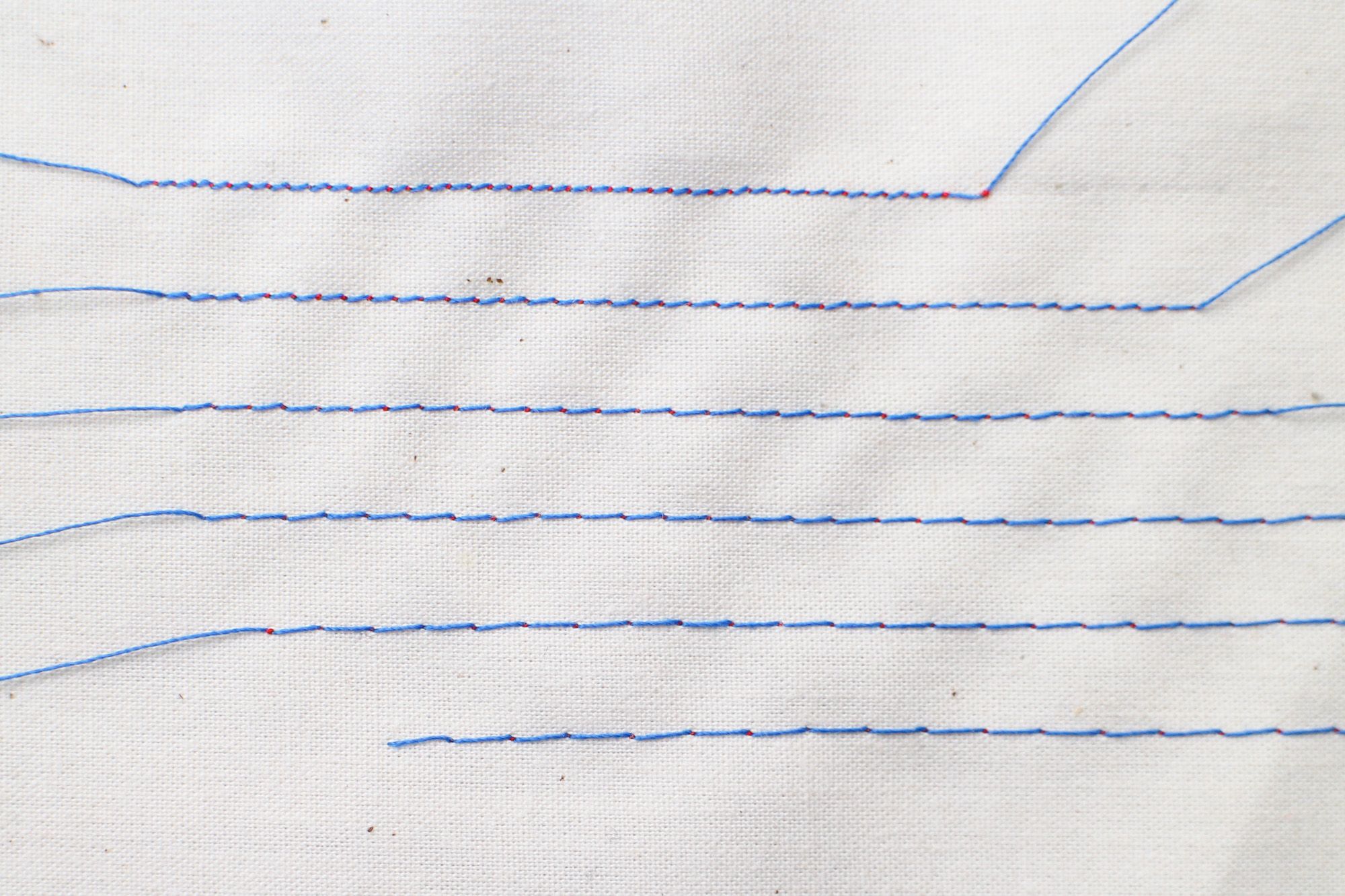

Step 9: Adjusting Tension

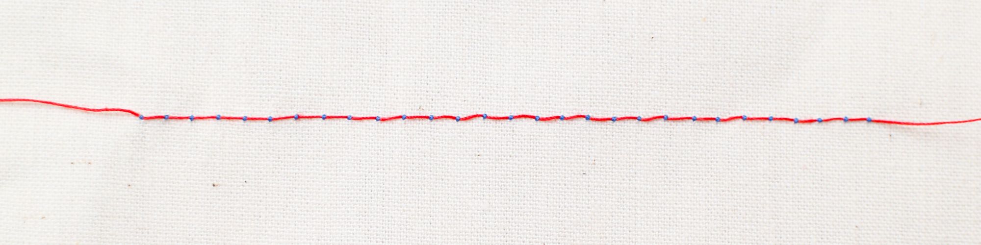

When you have practiced a bit, take out your fabric and take a close look at your stitches.
Sometimes the tension on the top thread and bobbin thread needs to be adjusted so your stitches are interlocking correctly. On a properly tensioned stitch, the place where the two threads loop around each other will be hidden inside the fabric, and the stitches will look like this:
If your tension is off, the threads from one side will be pulled up onto the other side and will appear as little dots between the longer stitches like this:
Stitches that look like this aren't as strong as stitches with proper tension because the tighter thread is just running in a straight line and can be pulled out too easily.

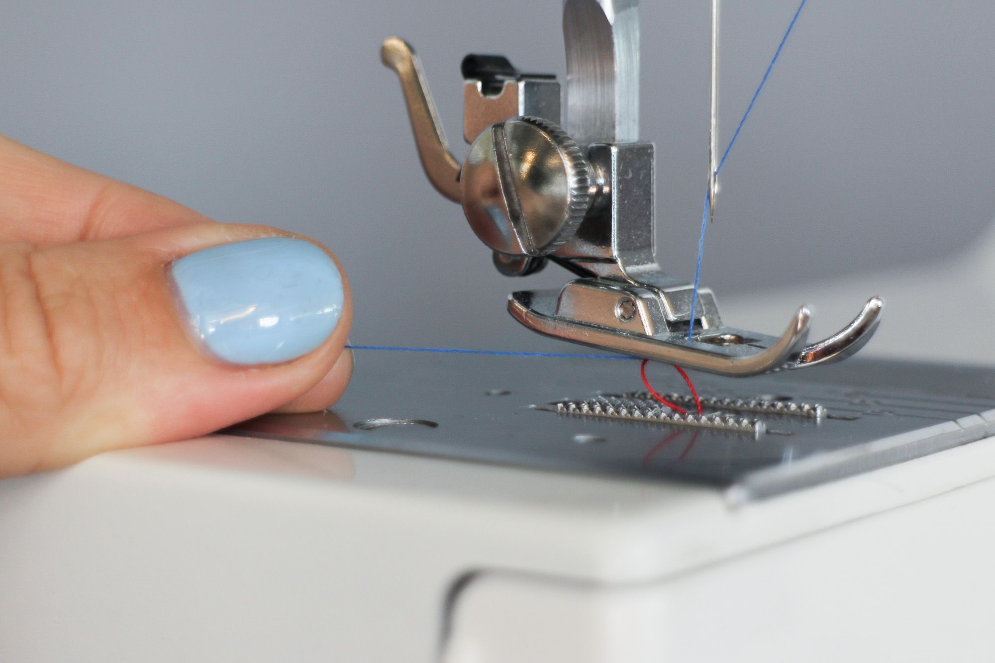

We can see this clearly here because we are using a different color of thread on the bobbin and the spool (which is not what you will usually do). If the top thread tension is too loose, we will see blue dots on the bottom of the fabric between the red stitches. In this case, turn the thread tension dial to a slightly higher number and try sewing again until the stitches look right.
If the top thread tension is too tight, we will see red dots on the top of the fabric between the blue stitches. In this case, turn the thread tension dial to a slightly lower number and try sewing again until the stitches look right.

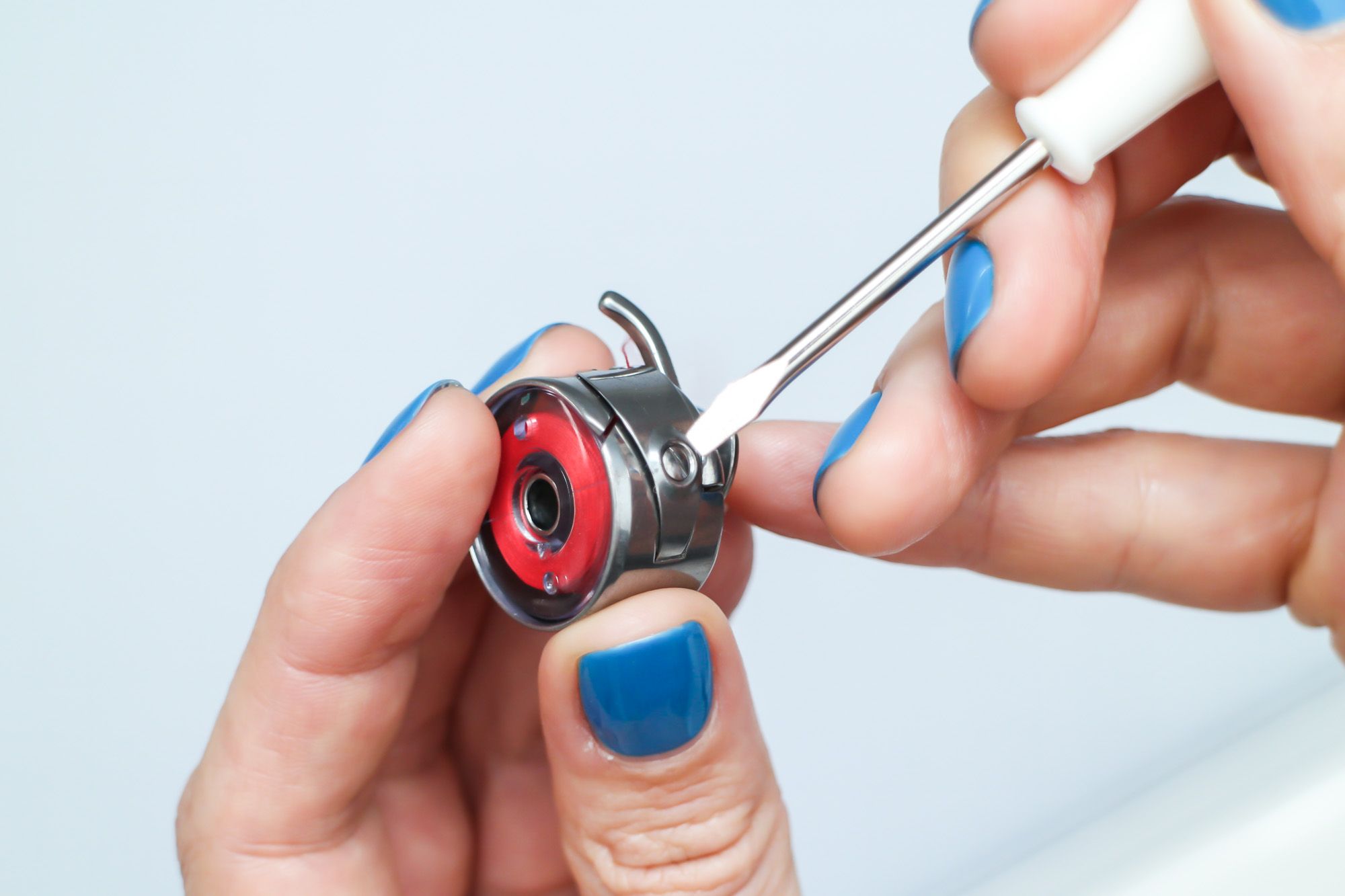

If turning the tension dial a little in either direction doesn't solve the problem, you may have to adjust the tension on the bobbin thread. To do this, take the bobbin case out of the shuttle. If you look at it closely, you will see a tiny screw on one side, turning this screw adjusts the tension of the bobbin thread. Turning the screw clockwise tightens the tension, turning it counterclockwise loosens it. You usually only need to turn it a little.
If you are seeing the top thread coming through as little dots on the bottom of the fabric between the stitches, that means the bobbin thread it too tight, so turn the screw counterclockwise.
If you are seeing the bobbin thread coming through to the top of the fabric as little dots between the stitches, that means the bobbin thread it too loose, so turn the screw clockwise.
Put the bobbin back in and try sewing again.

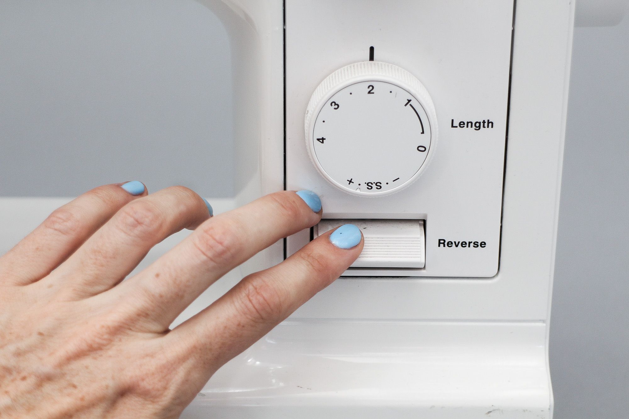

Step 10: Adjusting Stitch Length
Once your tension is right, try adjusting the stitch length by turning the stitch length dial, and sewing to see what different length stitches look like. Different stitch length can be good for different purposes. Longer stitches are often better for top-stitching that is going to be visible, but shorter stitches are stronger. Seams are usually sewn at a setting of about 2.5, and topstitching looks good around 3.

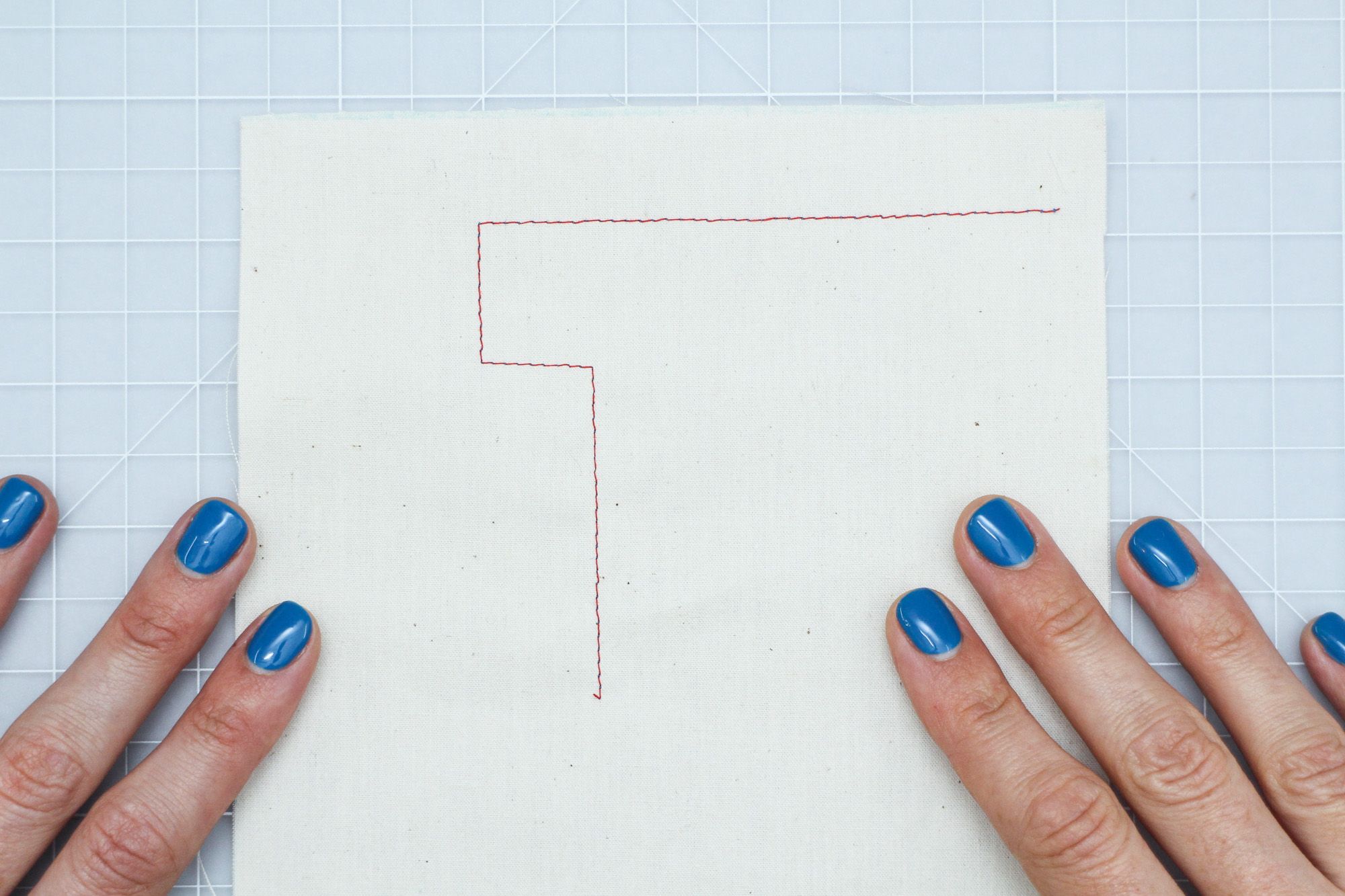

Try sewing a line parallel to the edge of the fabric: use the edge of the foot, or one of the seam guides as a reference. As you sew, keep your eye on the right hand edge of the fabric, not the needle, this will help you sew straighter lines.
Try backstitching: at the beginning and end of most lines of stitching, you need to lock your stitches by sewing backward and forward. Practice this by stopping at the end of a seam, then pressing the backstitch lever and the foot pedal at the same time to sew backwards a few stitches. Try to sew back exactly in the stitches you just made so your sewing looks neat.
Try changing stitch direction: when you need to make a sharp corner with your sewing line, stop sewing, turn the handwheel so the needle drops down into the fabric (if it isn't already), then raise the presser foot and rotate the fabric around the needle to a new position. Drop the presser foot and keep sewing.
Try sewing curved lines: draw a curved pattern on your fabric and try following it with your stitches. When you start to get off track you can stop, lower your needle, raise your presser foot and turn the fabric a little so you are going in the right direction again as I'm doing in this video. Don't worry if yours looks a bit messy, this is hard stuff, and we'll go over it more later.
