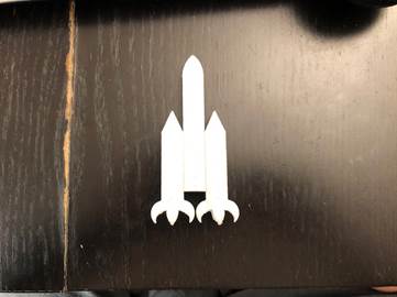

Step 2: Designing the Rocket External Tank
Start making the Rocket by making the External Tank with the size of 12.5 mm of diameter and 68.46 mm tall.
Next, make the Rocket's Nose Cone by using the Tangent Ogive shape using the all filters of shape generators on the right sidebar. Rotate it 90° to the right. Make its diameter 12.5 mm and its height 13.69 mm.
Lastly, put the External Tank cylinder and nose cone together.
Step 3: Making Solid Rocket Booster (SRB)
Start making the Solid Rocket Booster (SRB) by constructing the cylinder with a diameter of 12.5 mm and a height of 44.5 mm. Create the nose of the SRB by making a cone with a diameter of 12.5 mm and a height of 13.69 mm.
Also, create the rocket stand. Begin by making 6 elongated spheres (1 solid sphere and 5 hole spheres) with longer diameters of 13.69 mm, shorter diameters of 12.5 mm, and heights of 6.28 mm. Arrange them like in the graph shown above. Group them and copy that group into 4 sets. Put the SRB cylinder, the nose cone, and the rocket stand together. Duplicate the rocket into 2 SRB rockets.
Step 4: Assembling the Entire Rocket
Assemble the Entire Rocket by simply installing 2 Solid Rocket Boosters to the left and right of the Rocket External Tank as shown below. Make the color white.

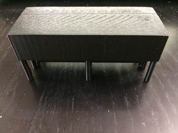

The Launch Pad needs a small monitor controller below to monitor and control the launching of the rocket. Start making it with a new cube and put it under the top cube. Make it 98 mm by 24 mm by 9 mm.
Because the Launch Pad controller is 9 mm tall in this design, I recommend you to make the 2 middle poles right under the controller into 13.5 mm, although this is optional. (Obtain the height of the middle poles by subtracting the original poles heights by the controller heights, which is 22.5 mm – 9 mm = 13.5 mm.) If the heights of the 2 middle poles are not lowered, it will be ridiculous because the people in the controller cannot walk here and there due to the poles. It is actually up to you to lower this or not.
Now, change all of the colors into black as shown below.
