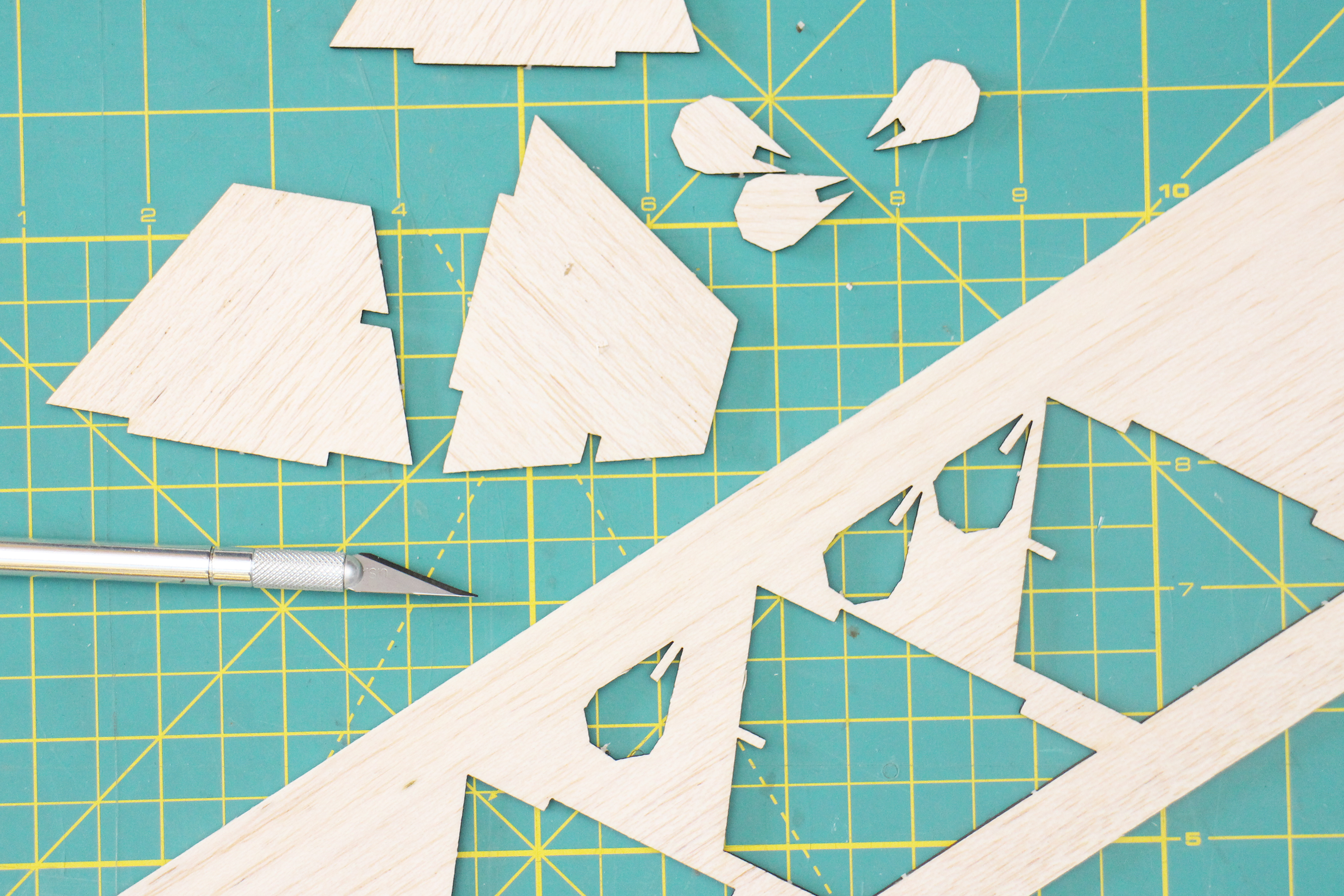

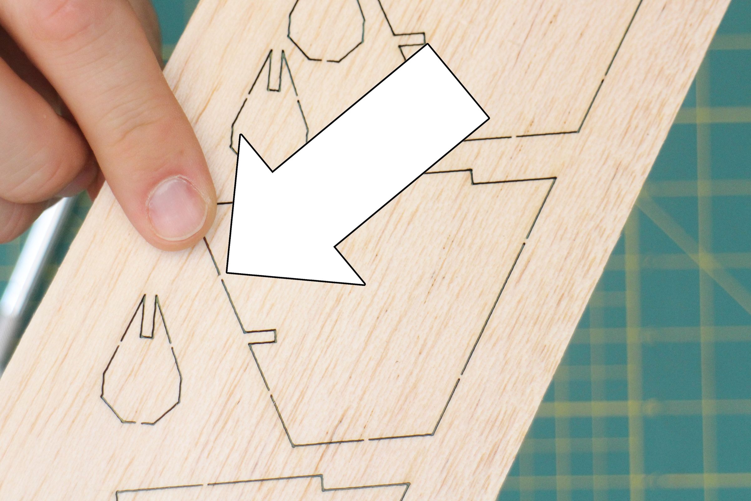

Step 3: Remove Fins

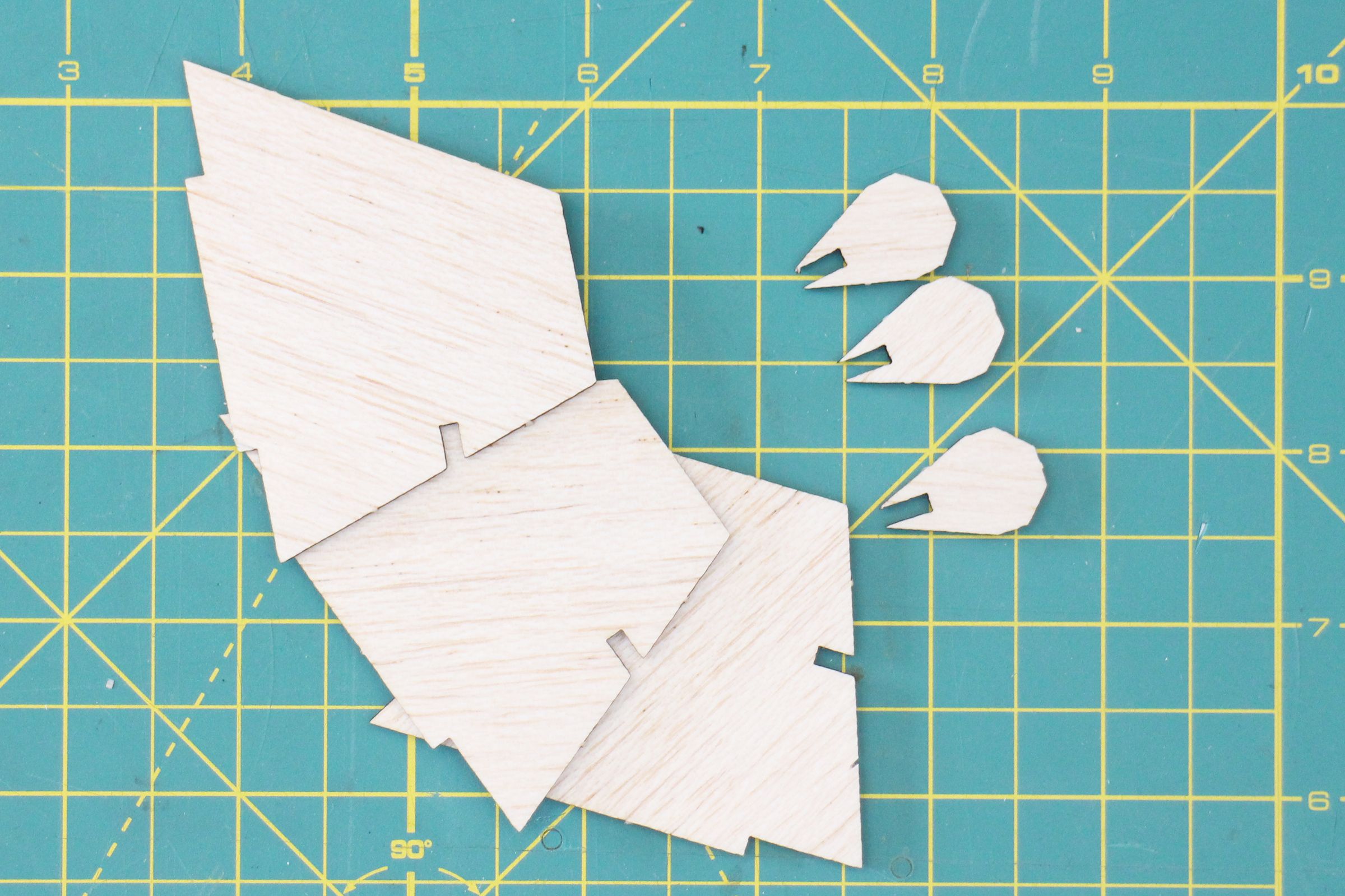

Most model rockets have stiff fins that help guide them straight when in flight. Some fins are made from wood, while others are made from cardstock – either way they are typically die cut from a large piece to the correct shape. Before removing the fins from the sheet they are cut from, lightly sand their surfaces (both sides) while they are in the parent material. This makes their edges easier to sand once removed.

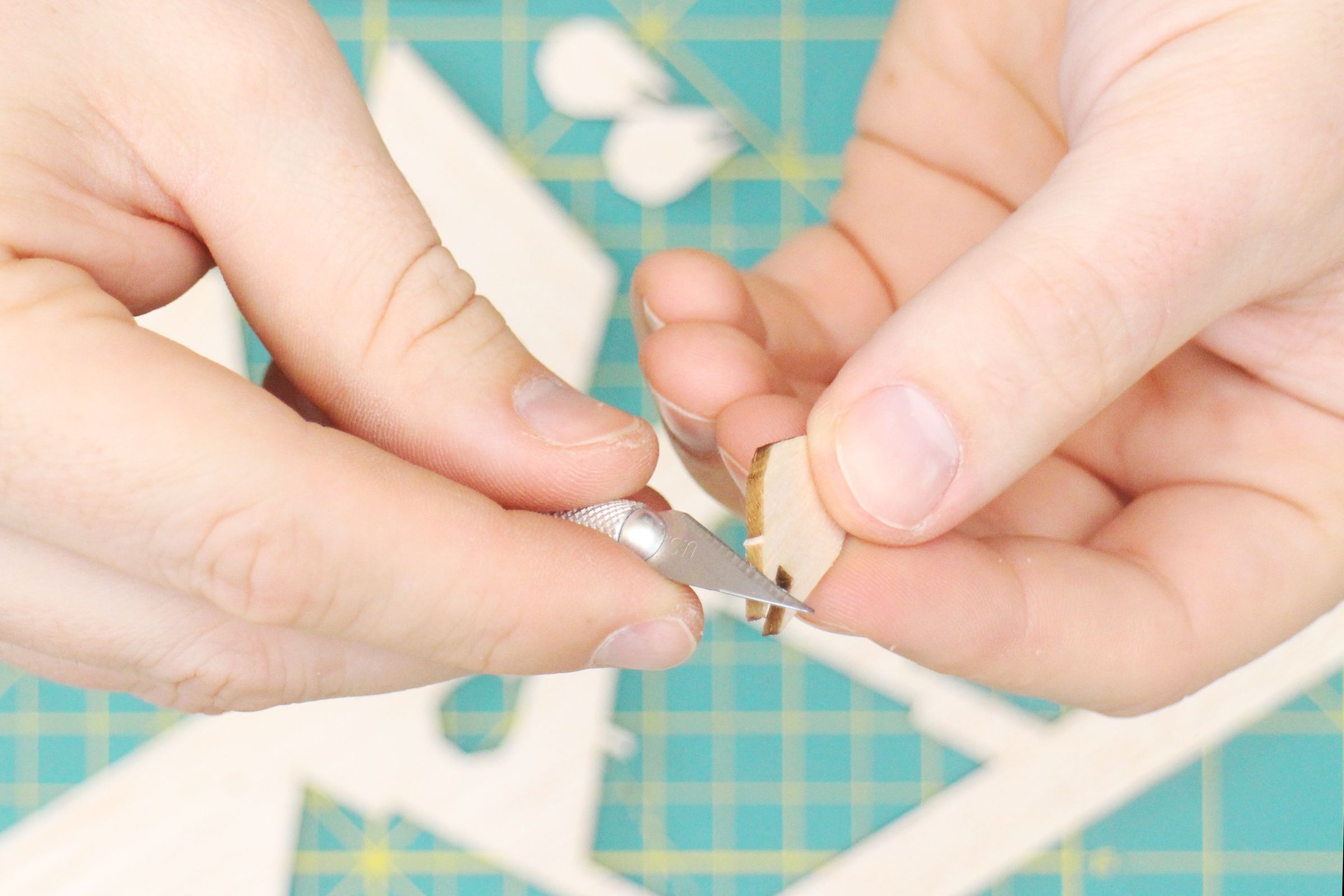

If you look closely you can see small tabs where the fin pieces are attached to the parent material,. These will need to be cut free in order to remove the fins.
A sharp and thin hobby knife makes quick work of freeing all the fin pieces. Most rockets have different shaped fins, and some are made from more than one piece. Make sure you get all the fin pieces from your parent material.
After removing the fins you may find a few tags left over, these can be cleaned up with the hobby knife.
You can sand the edges if there are any uneven parts, or sand the faces if you find they need it. Set the fins aside for now, we'll come back to them after we finish assembling the rest of the rocket.

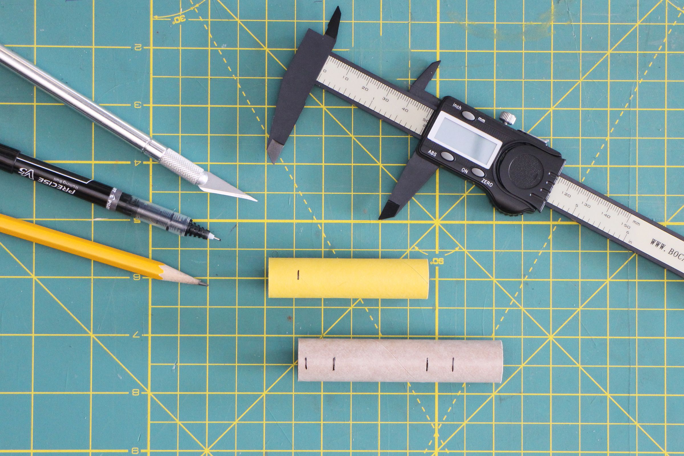

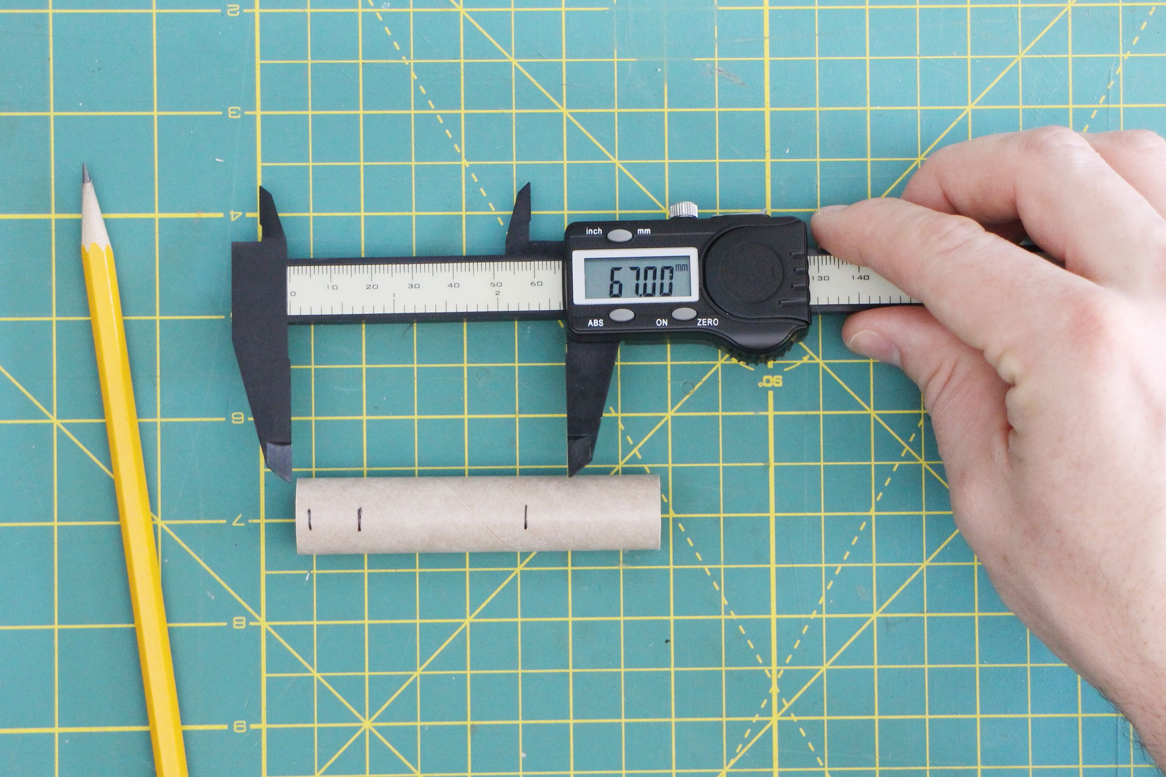

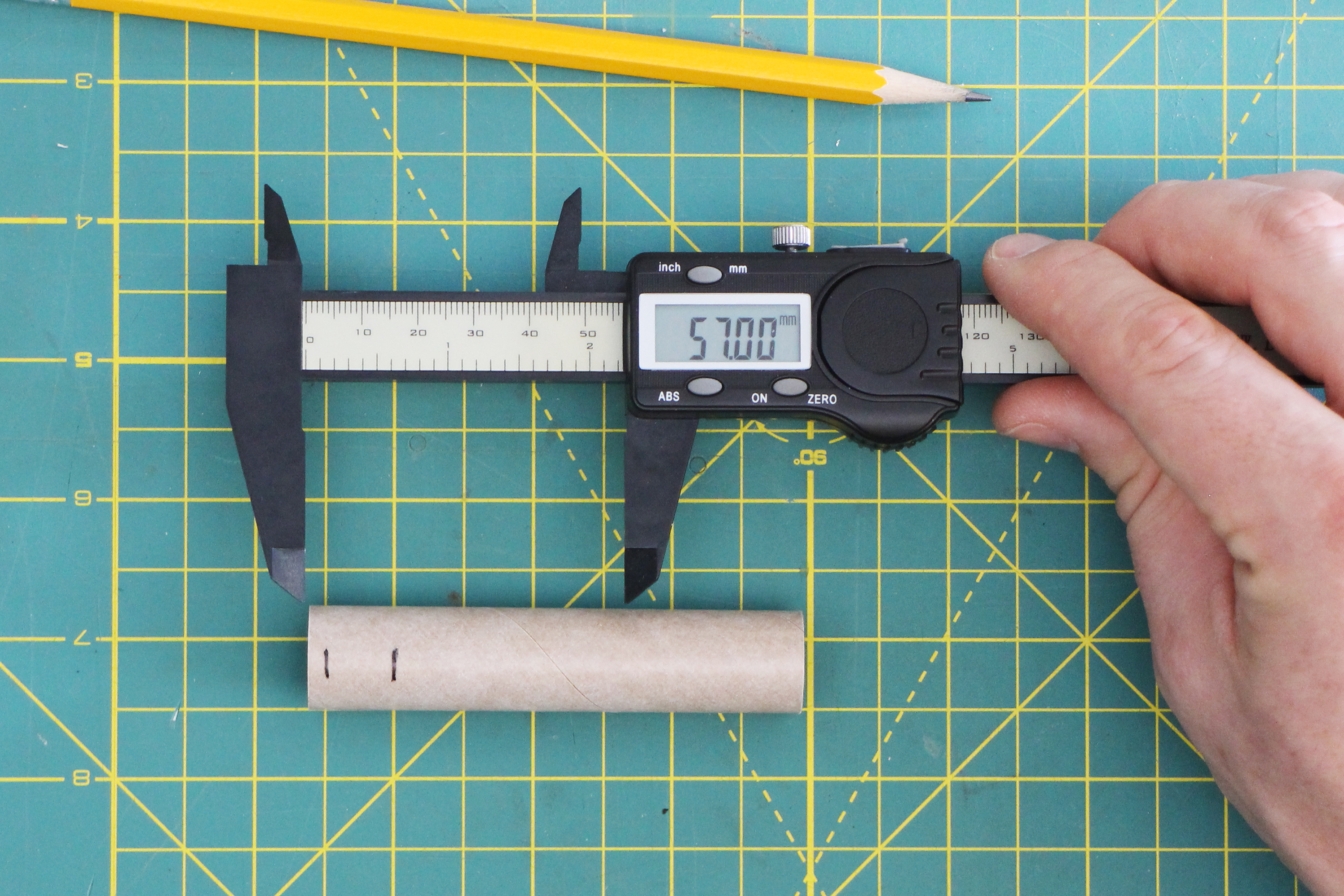

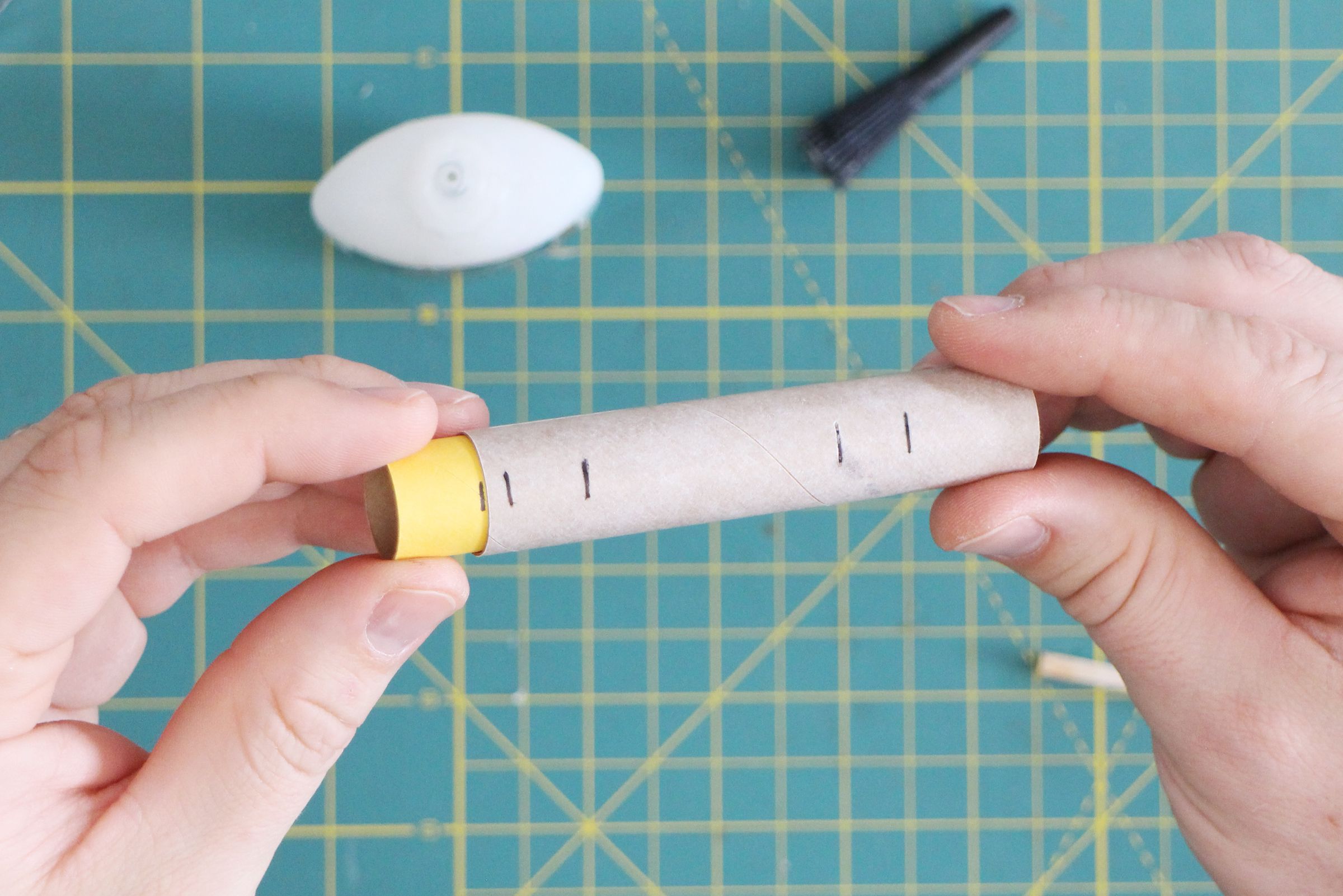

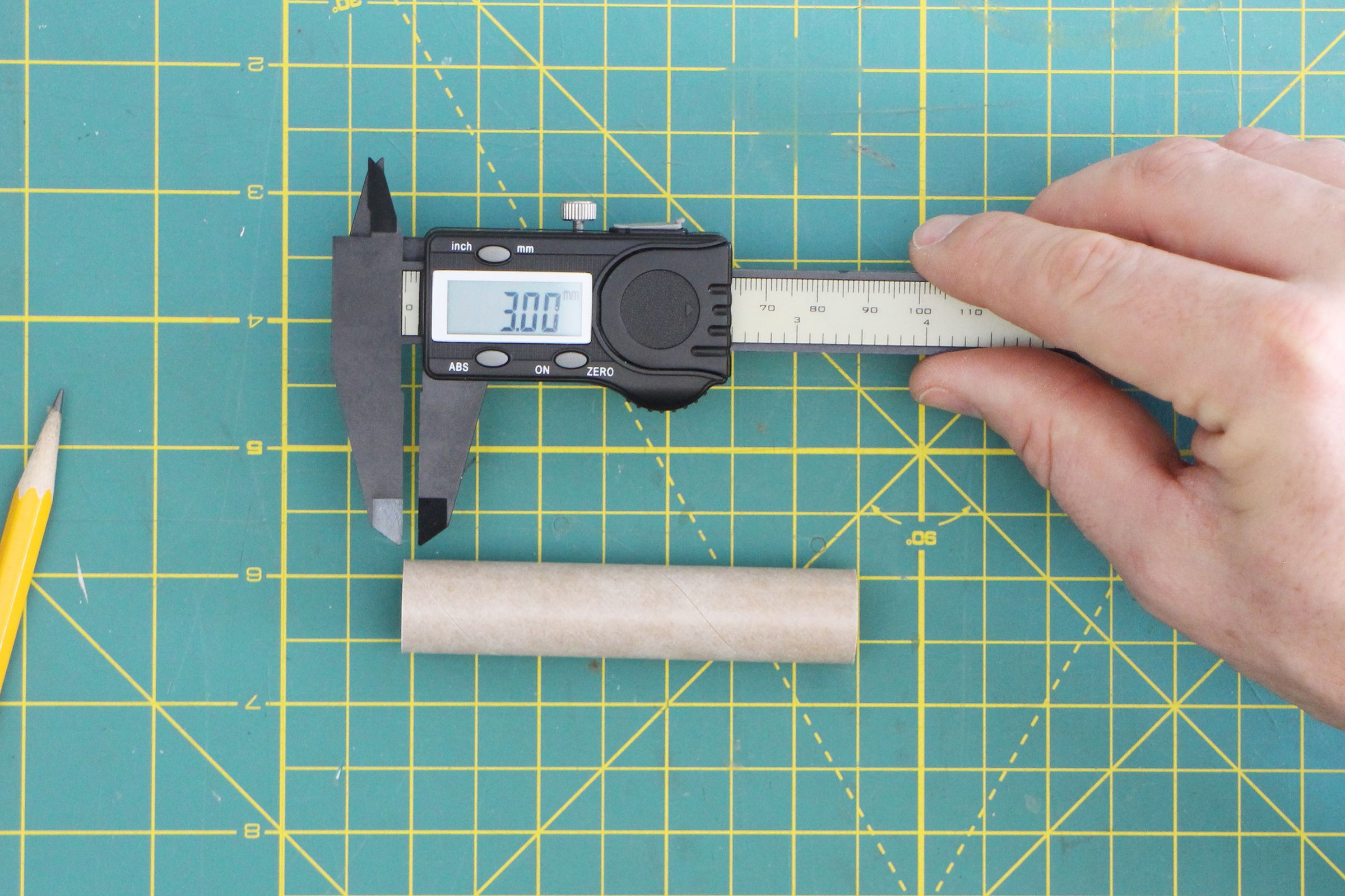

Step 5: Measuring

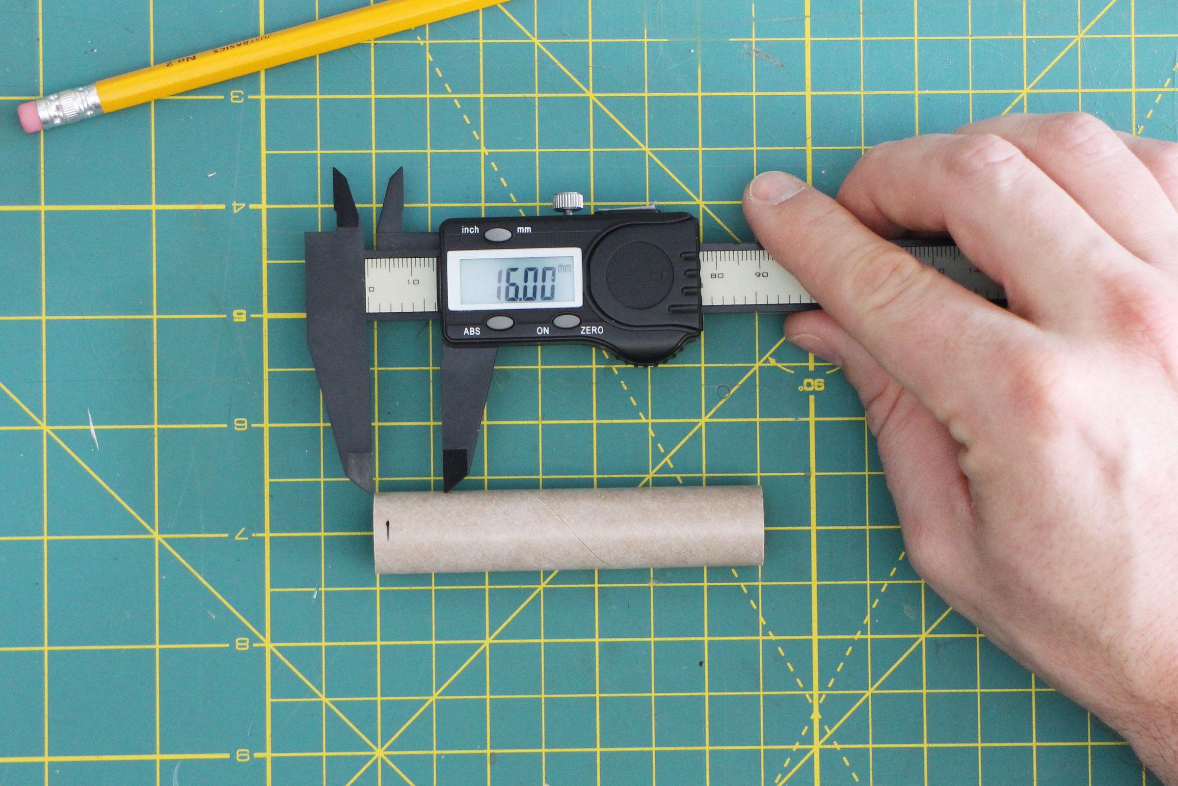

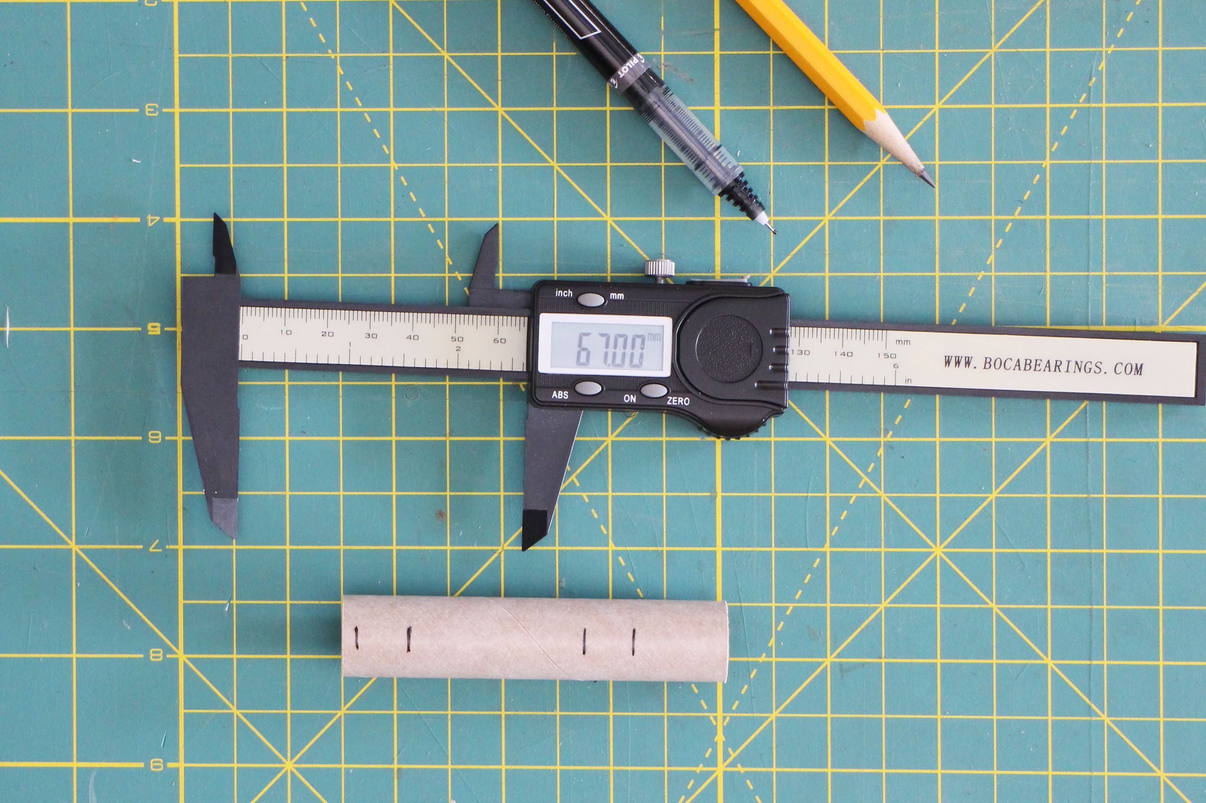

To make sure the components go together correctly with the proper spacing we'll need a measuring tool. I find digital calipers a great choice for this.
For the small increments we'll be working in, it's easiest to use metric millimeters, as counting in whole numbers is much easier than imperial fractions. All digital calipers have a units button that will switch between imperial and metric. To do this, turn your calipers on, push them completely closed, hit the 'zero' button, and switch to metric. You're good to go!
Engine mounts can differ depending on the manufacturer, but most aim to isolate the engine from the fuselage (rocket body). What we'll do here is measure out where the spacing rings will be placed on our engine mount before inserting the assembly into the fuselage. Your numbers may differ (and that's okay), but the concept is the same.

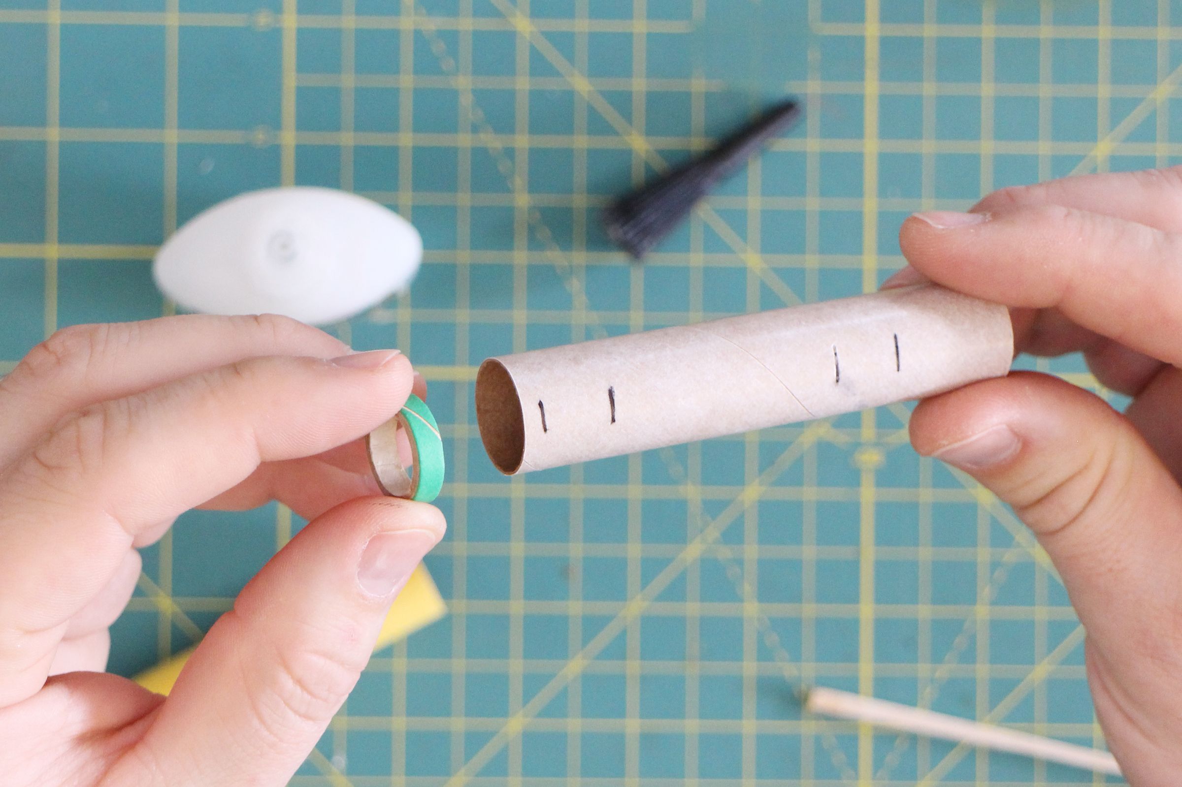

Start by taking the engine holder and choosing an end to measure from. Measure out 3mm from your chosen end and make a mark. This mark will indicate how far the engine mount will be inserted into the fuselage once assembled.
From the same chosen end, measure 16mm and make another mark. This mark is for where a spacer will be placed.
Continuing from the same end, measure 57mm and make a mark. This mark will be the incision we make in the next step to place our engine hook.
Lastly, measure 67mm from the same end. This will be the second spacer ring location.
From left to right, the markings are: insertion depth mark, spacer ring location, engine hook incision mark, spacer ring location.

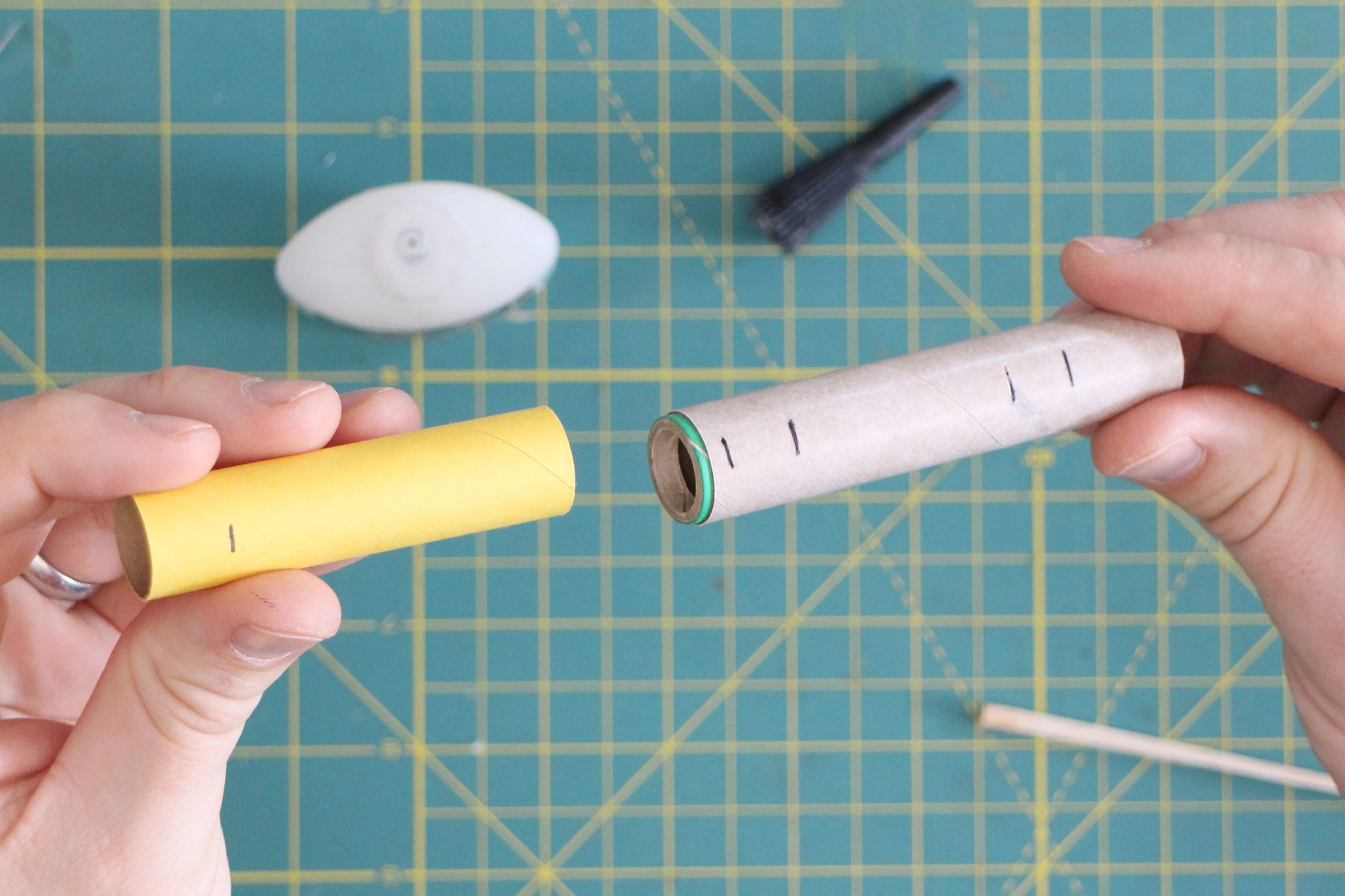

Step 6: Spacer Tool
The yellow spacer tool is the exact size of the rocket engines we'll be using and slides perfectly inside the engine mount tube. We'll make a mark at 13mm from one end,. This mark will help us accurately place a spacer inside the engine mount.
Here's what my engine mount and spacer tool look like with all the markings made.

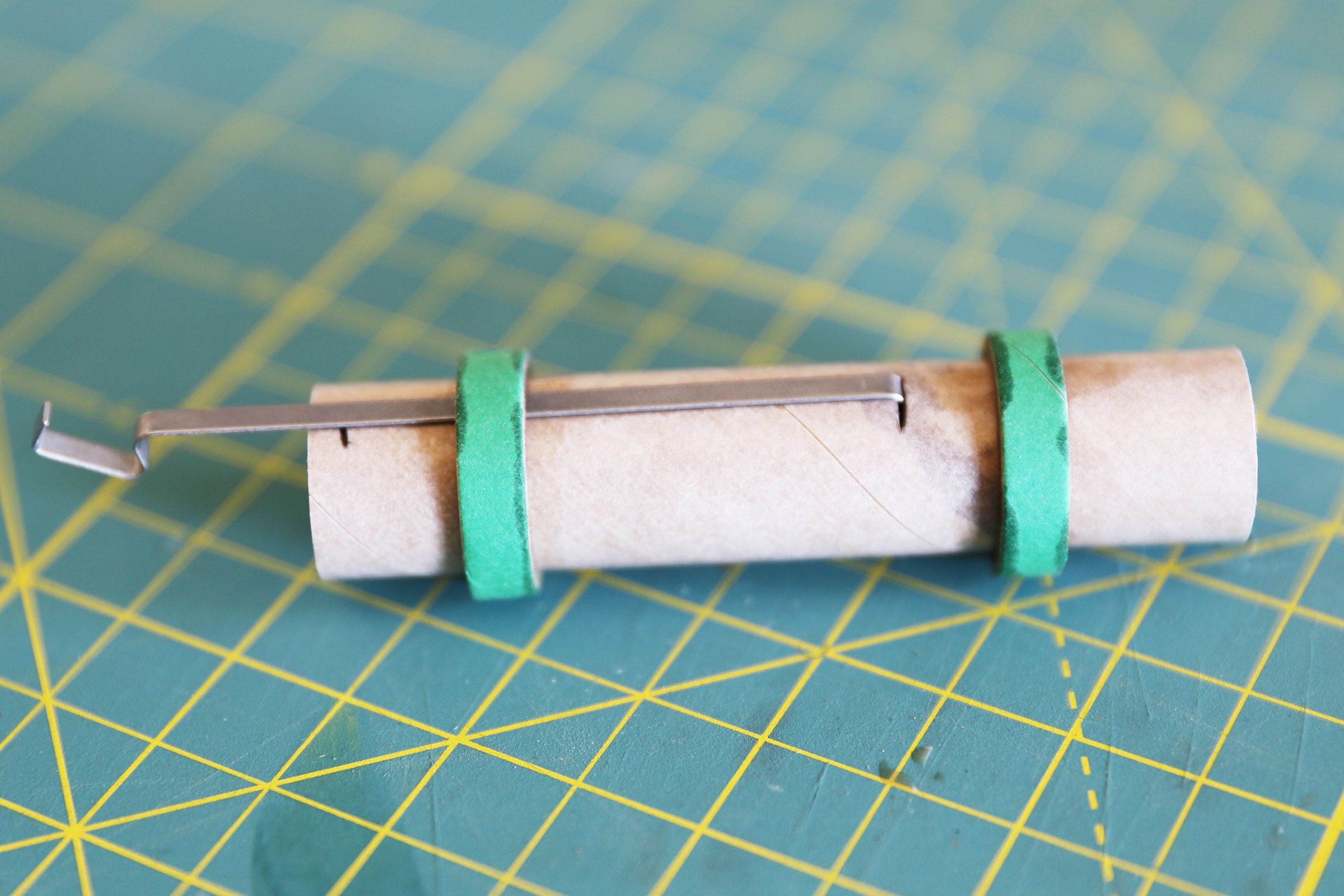

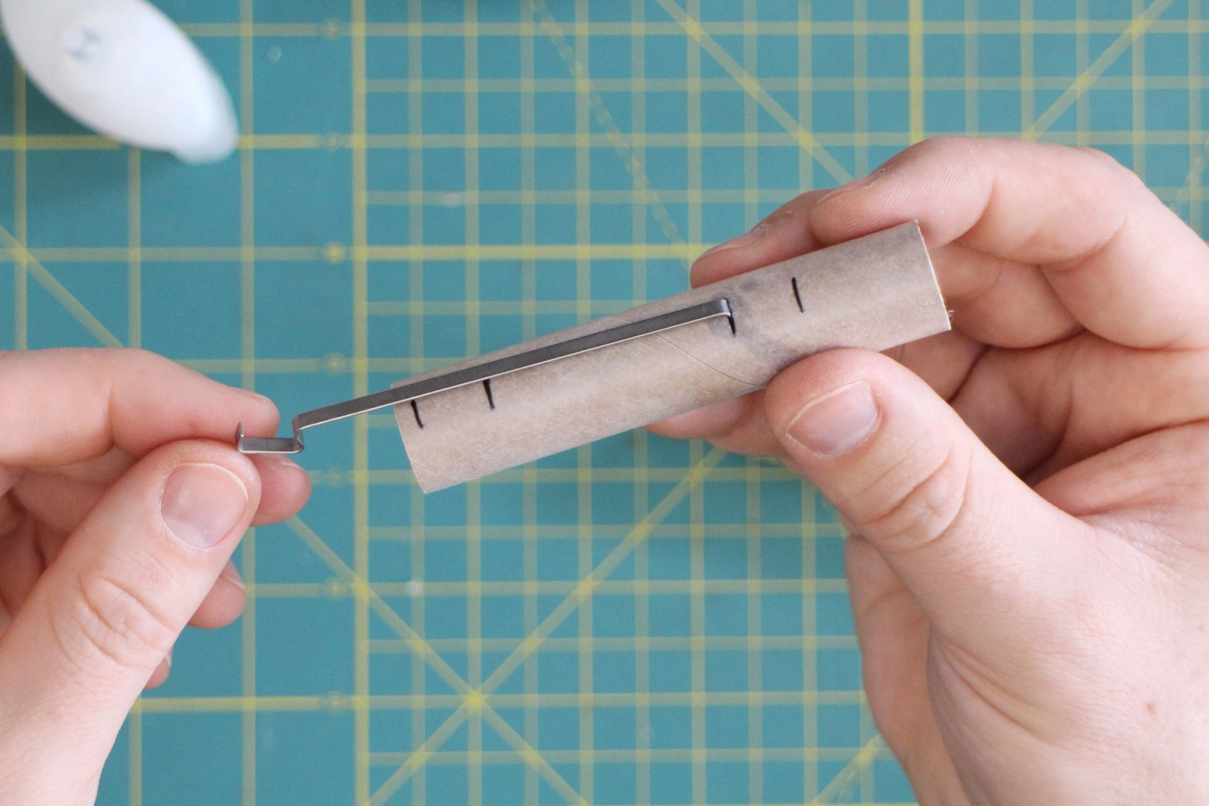

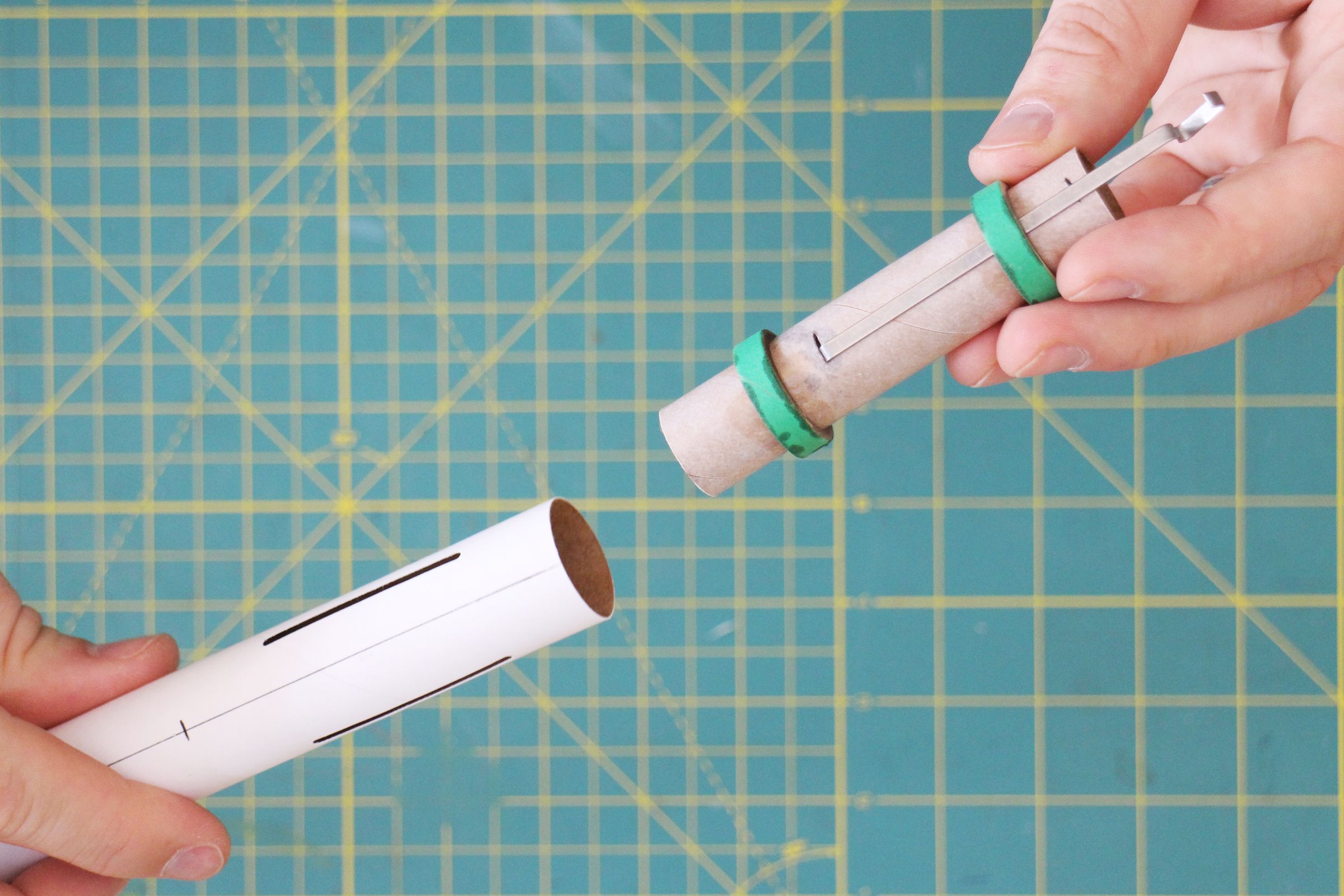

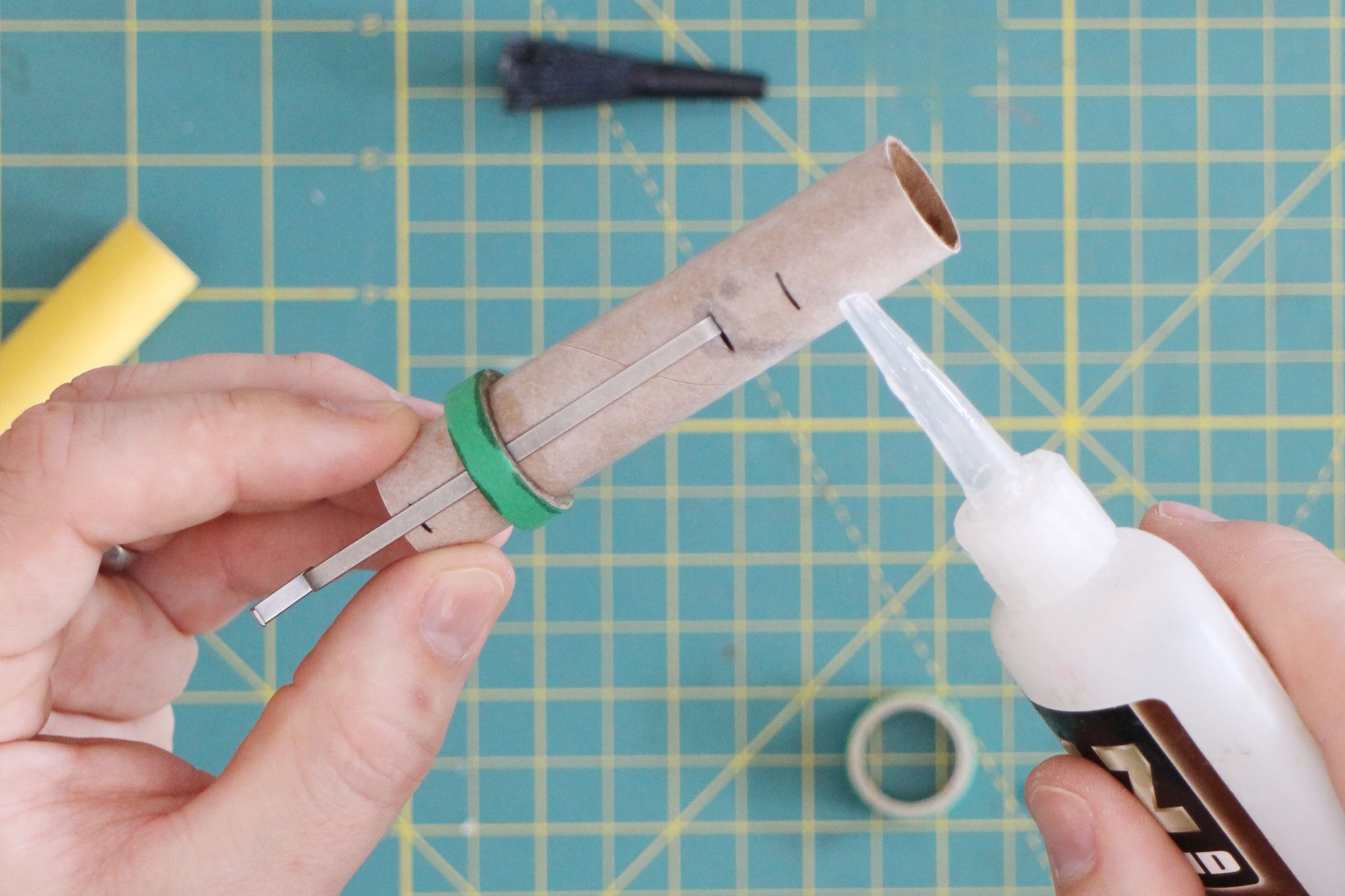

Step 8: Engine Hook + Centering Rings (Large Green Rings)

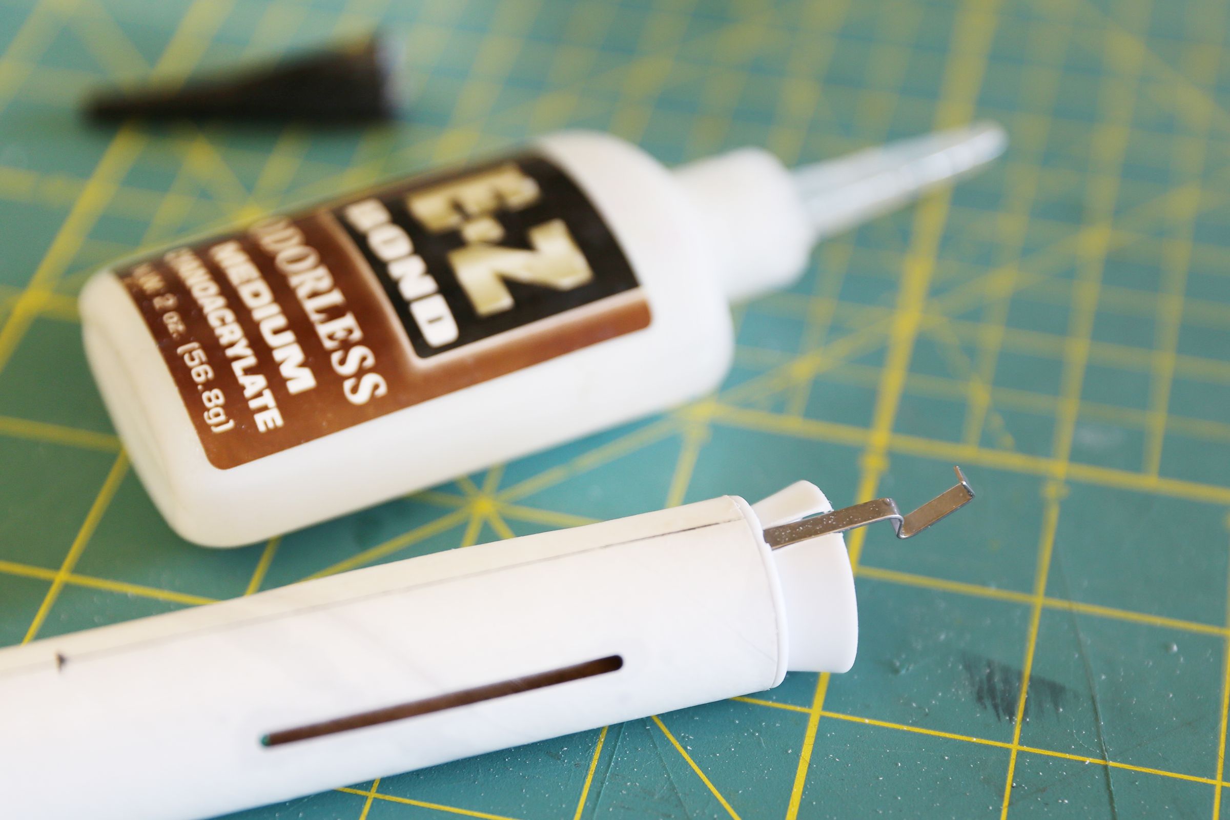

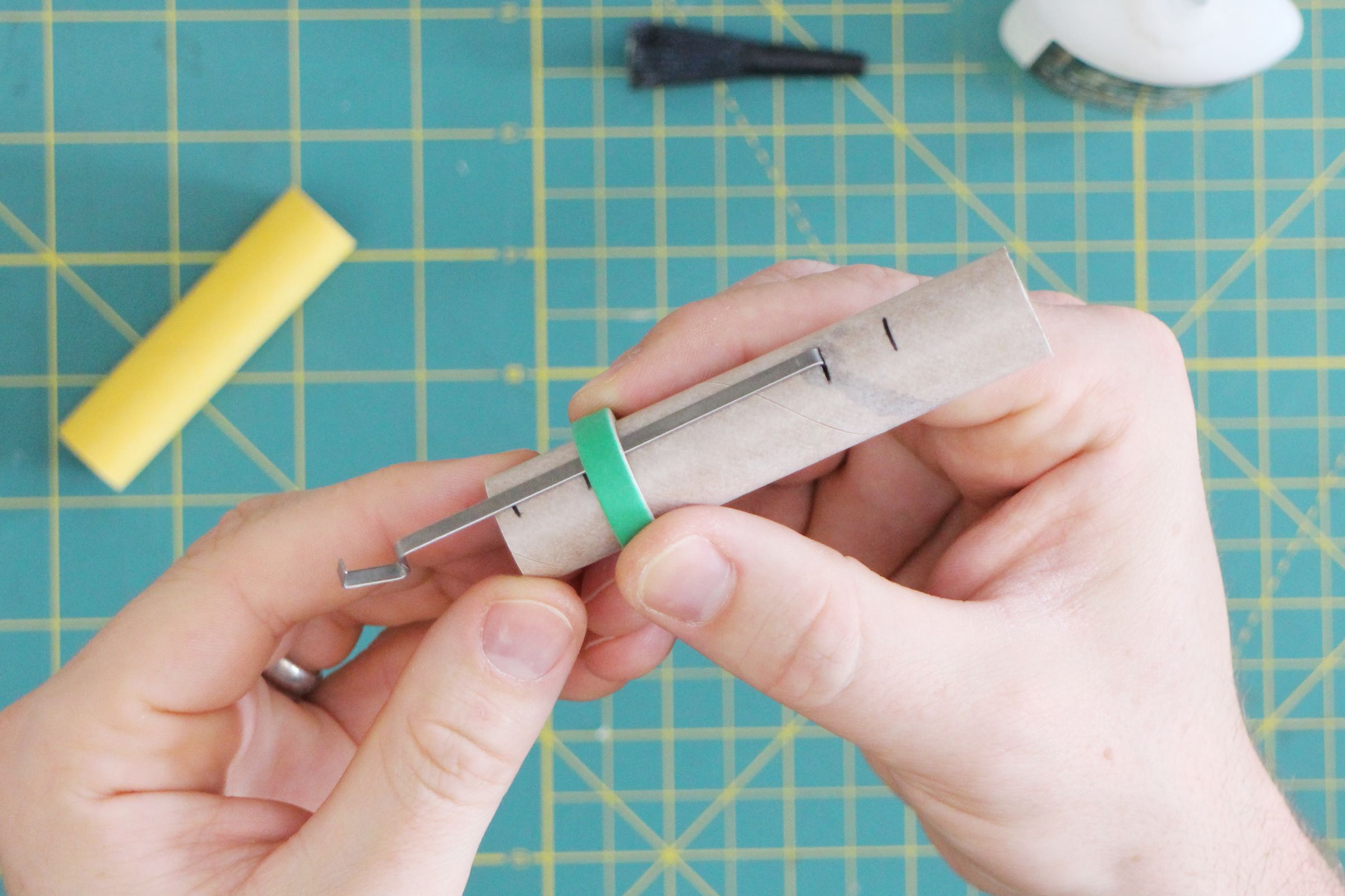

Before adding on the centering rings we'll install the engine hook. This hook's job is to push against the rocket engine bottom and keep it locked in place. To remove the rocket engine, we can just push the hook aside and pull the engine out to replace it after it's spent.
The yellow spacer tool pushed the engine block ring to just past the third marking on our engine mount tube. Using a sharp hobby knife, carefully cut a small 4mm incision at the 3rd marking (57mm from our reference end).
The 90° bend end of the engine hook can be placed inside this incision until fully seated.

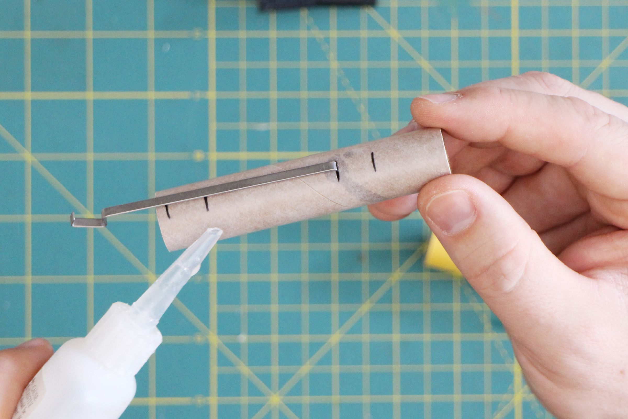

With the hook in place, put a small dab of glue just above the 2nd marking (16mm from our reference end).

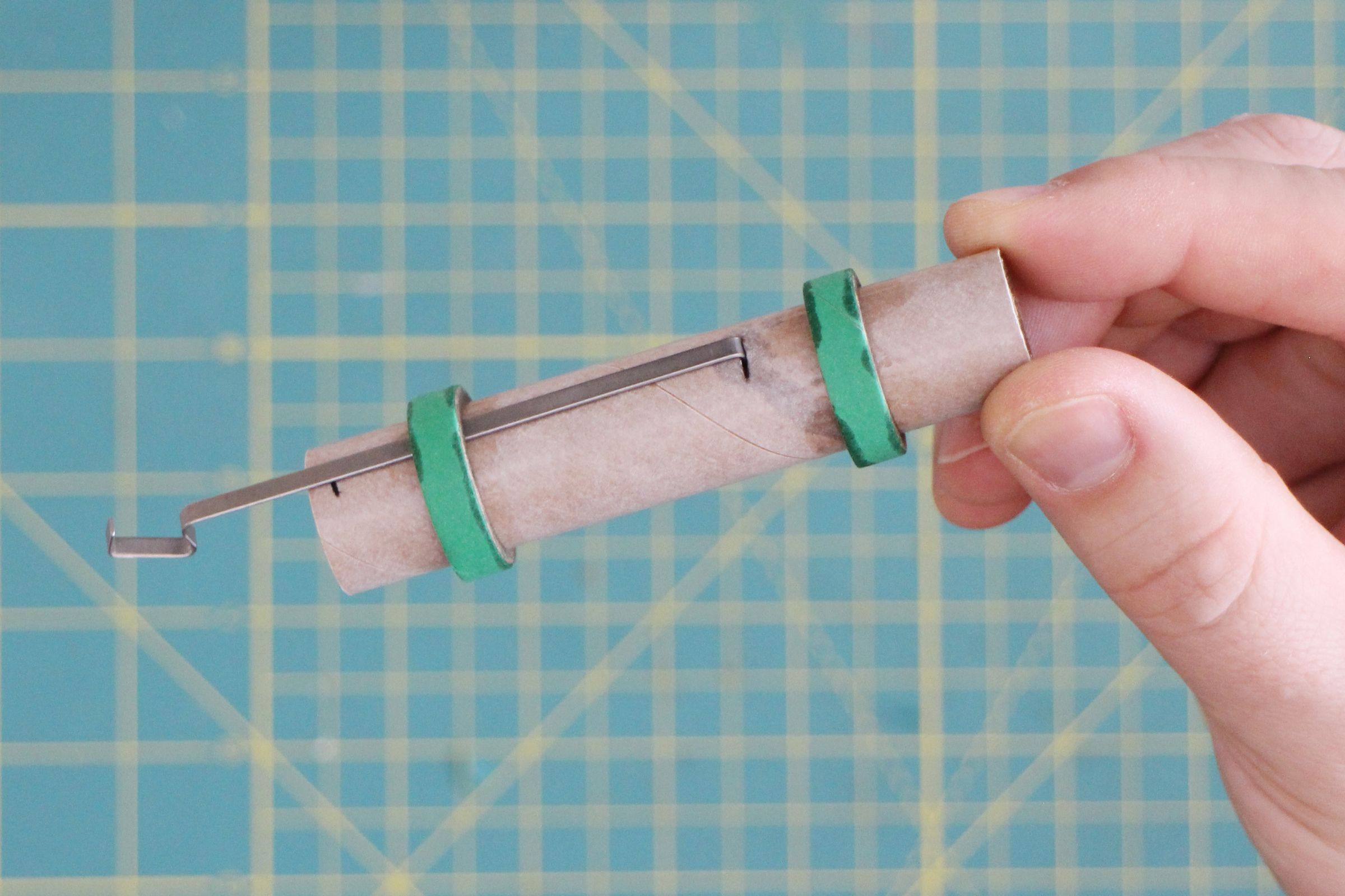

From the opposite end of the tube, slide on one of the green centering rings. Push the ring down the engine mount tube, over the engine hook, until it reaches the 2nd marking and the dab of glue. The glued ring will secure the engine hook in place.
next, add a small dab of glue to just above the 4th marking (67mm from our reference end).
Slide the second centering ring onto the engine mount tube until it reaches the marking.
Once the centering rings are installed, add a few extra dabs of glue around the centering rings to ensure a good bond.

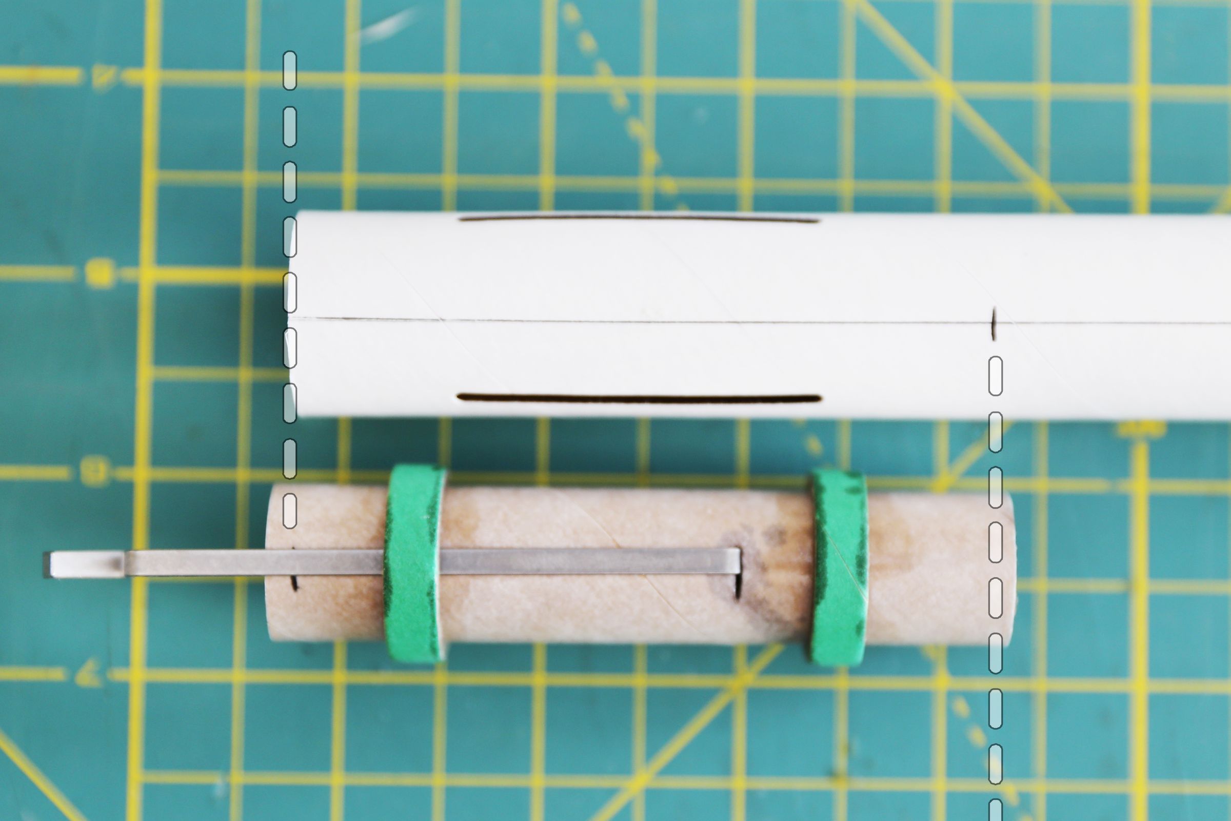

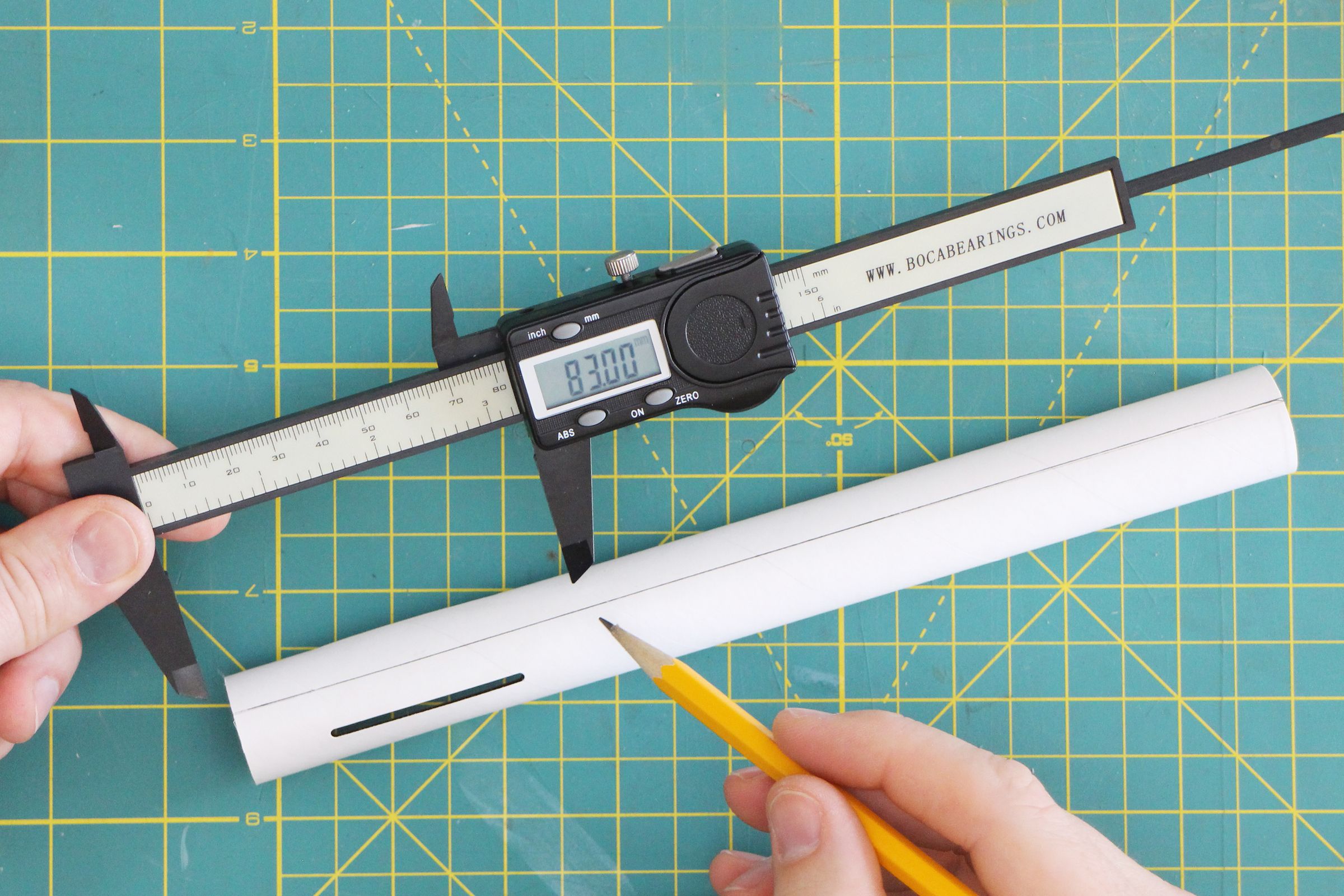

Adding a center line to the fuselage will give a reference point to where to place out launch guide, and allow us to measure up from the bottom of the fuselage and make a mark on how far inside the engine mount will be placed.
Using a pencil and a straight edge, draw a line down the length of the fuselage as straight as you can. This line will act as a reference which we'll use to mark measurements on the fuselage.

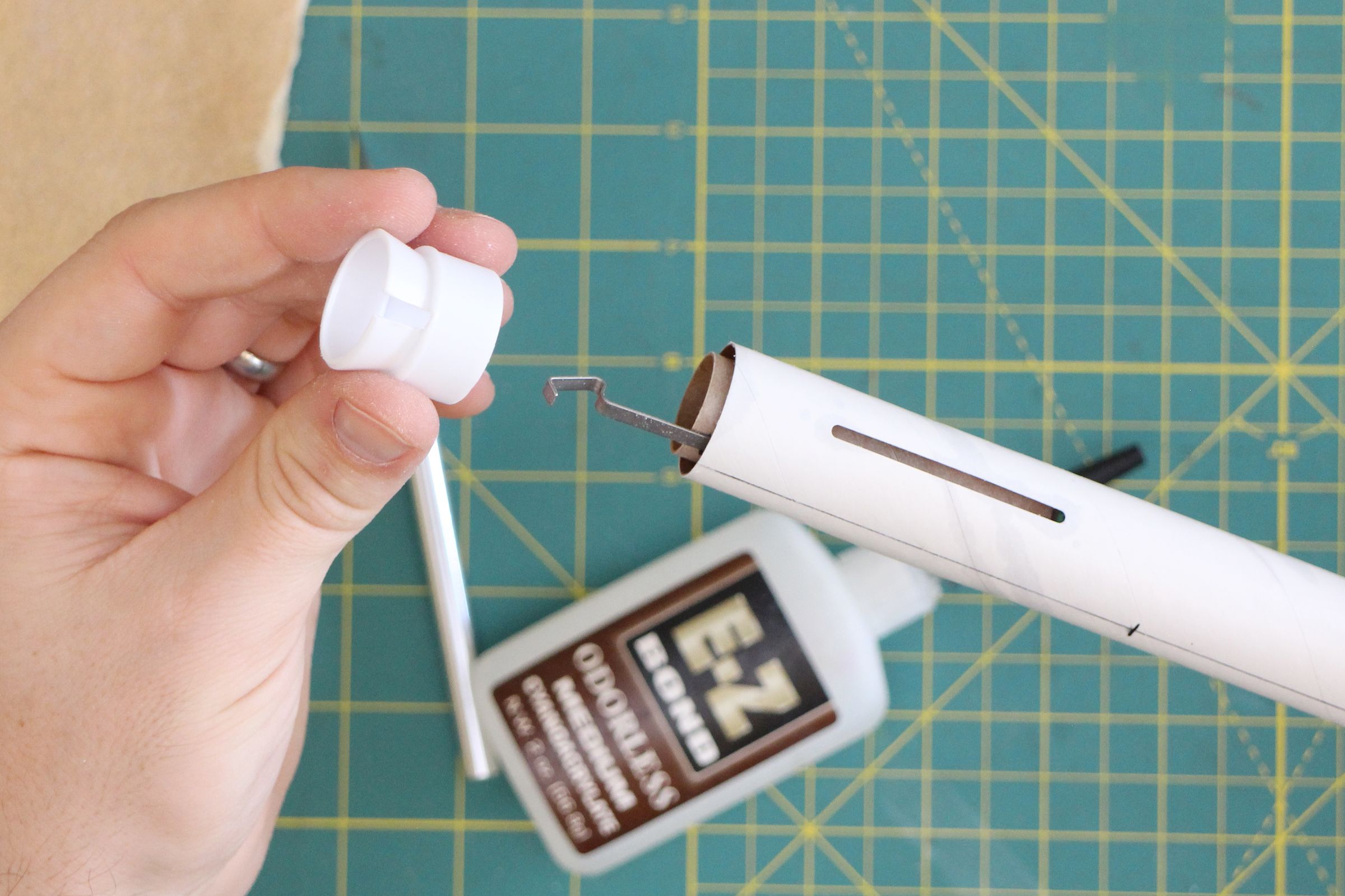

In order to allow the future pieces to be installed on this rocket the engine mount needs to be placed precisely inside the fuselage. Using the calipers, measure back 83mm from the bottom of the fuselage and make a mark on the previously drawn center line.
If you line up the engine mount assembly next to the fuselage, you can see that the mark you just made on the fuselage lines up with the top of the engine mount, and the bottom of the fuselage matches the first marking on the engine assembly. This means that we measured everything correctly and that the engine mount assembly, when inserted into the fuselage, will be at the correct depth.
Start inserting the engine mount into the fuselage from the bottom, ensuring the engine hook is is pointing away from the fuselage.
Gently push the engine mount into the fuselage until the last marking on the engine mount lines up with the bottom of the fuselage.
Carefully turn the fuselage so that the hook is pointing straight up to the sky and drop a very small amount of glue inside the fuselage tube, onto the centering ring that's closest to the end. This will help secure the engine mount assembly in place.

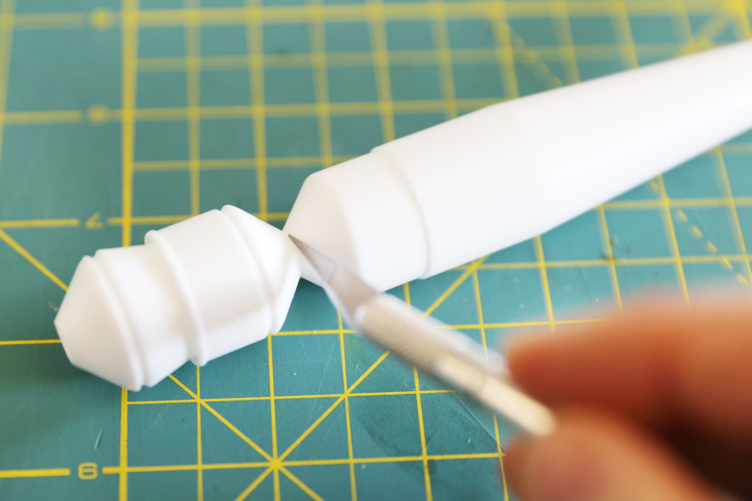

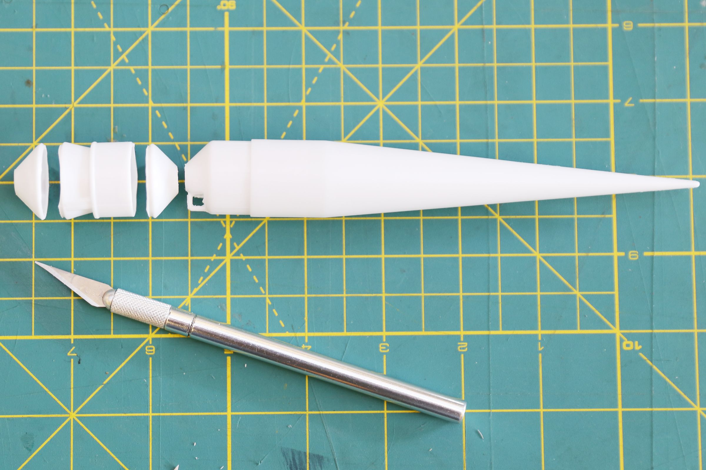

As mentioned earlier, each rocket set is different. My rocket came with the nose cone and the engine nozzle as one piece of plastic that need to be separated.

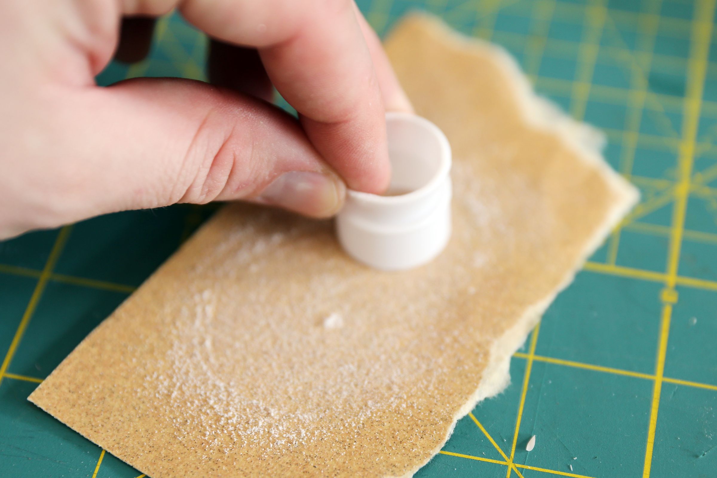

Though the plastic isn't thick, it can sometimes be difficult to separate the nose cone and engine nozzle. To separate mine, I used a sharp hobby knife to pierce the plastic connection and carefully work the blade around the circumference of the narrowest part of the back end of the nose cone.
There is a fluted section between the nose cone and the engine nozzle that needs to be trimmed away. Then, another fluted section at the end of the engine nozzle which also needs to be removed using a hobby knife.
Once the plastic pieces have been cut at the appropriate sections, the ends of the nose cone and engine nozzle must be sanded to remove any burs, making them smooth.

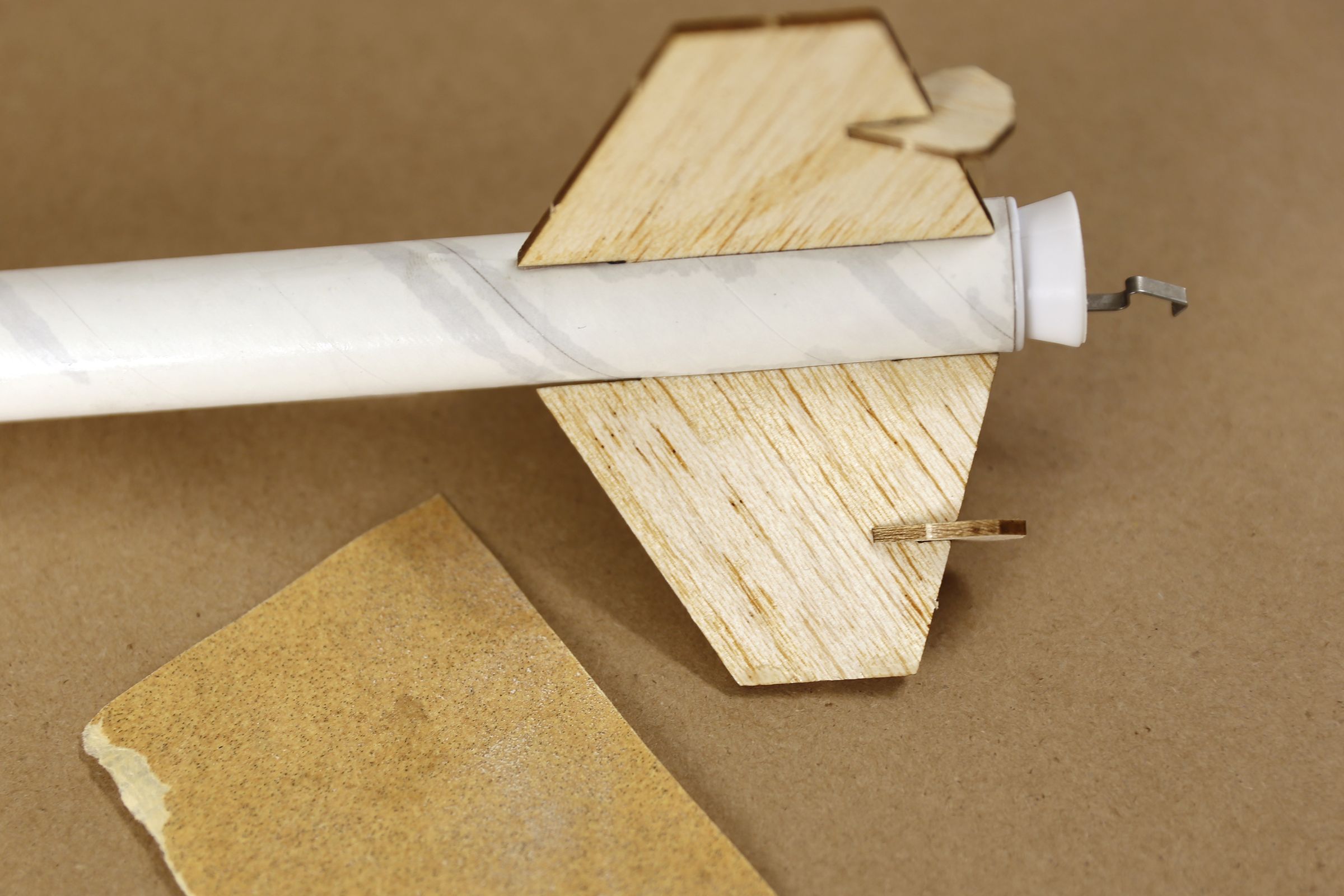

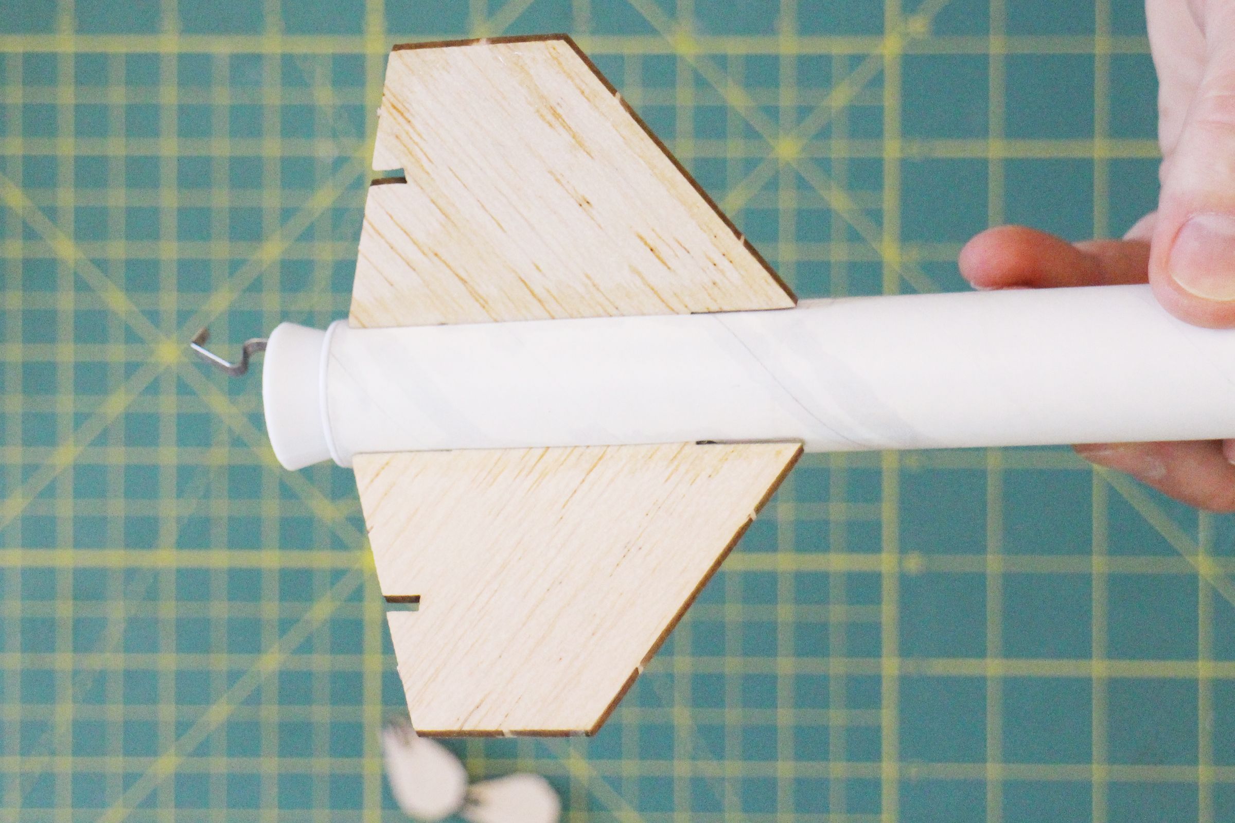

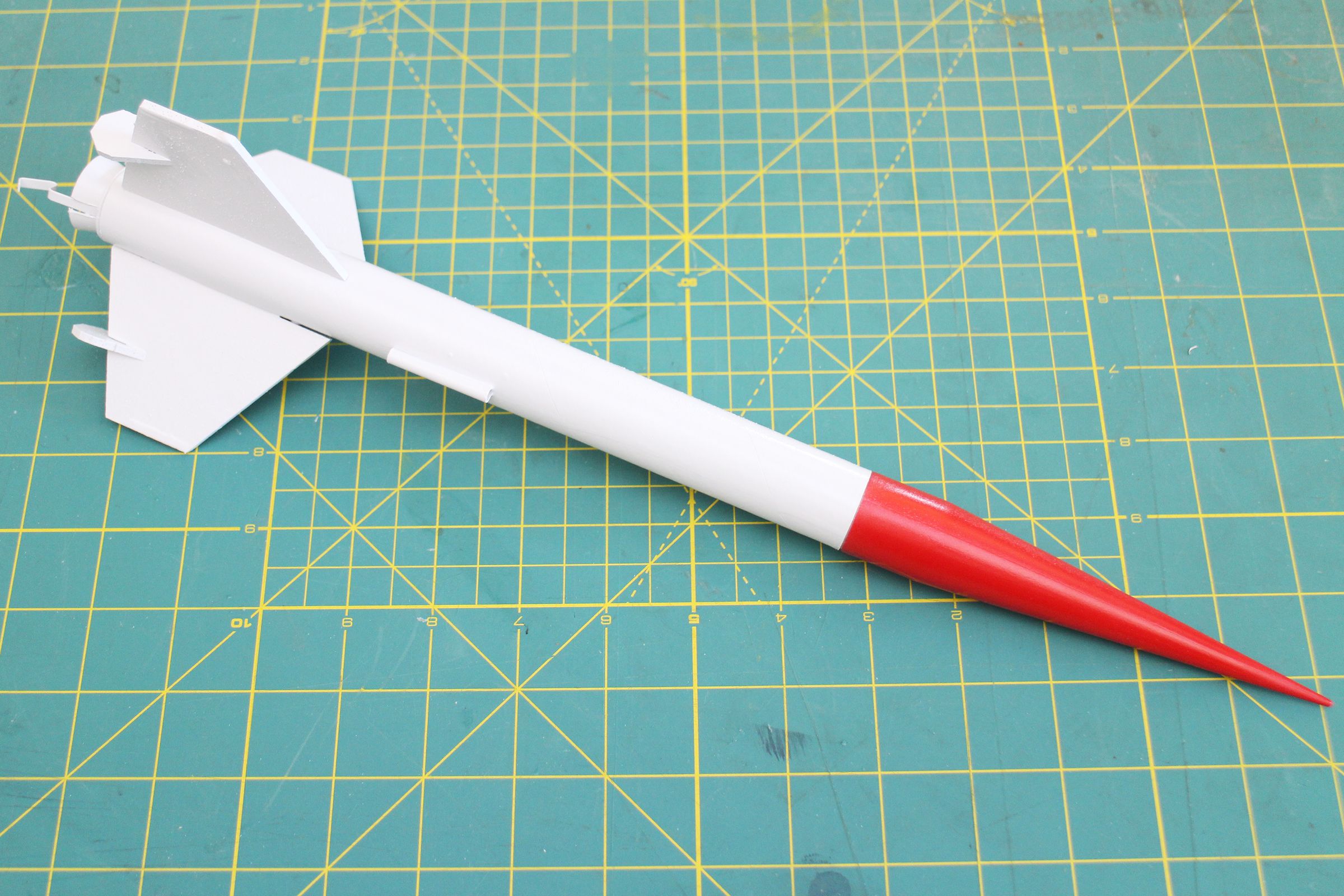

Step 12: Rocket Fins
With most of the rocket assembled, the rocket fins can be installed.

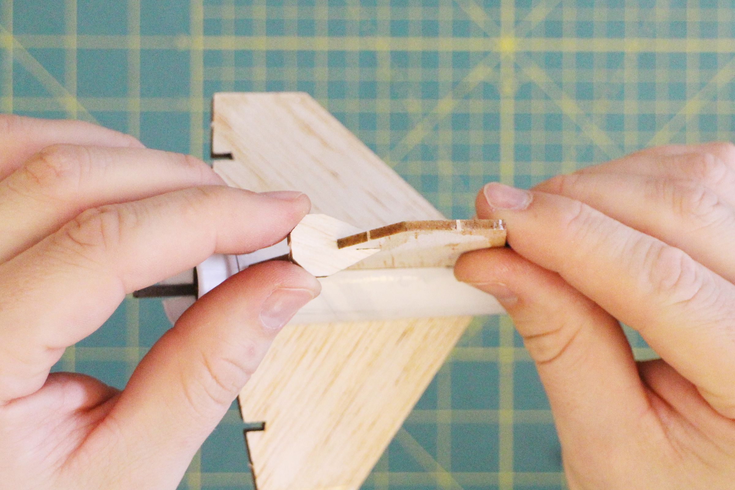

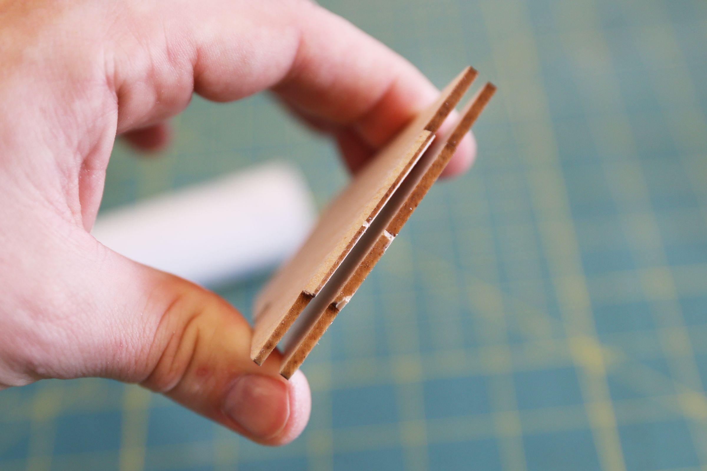

Start by dry fitting the fins into the slots at the bottom of the rocket fuselage. It may be that the tabs on the fins need to be sanded slightly to take the hard edge off and allow them to slide into the slots a little easier.
The picture above compares two fin tabs, one sanded and one with a square edge. The sanded tabs will slide easier into the slots on the rocket fuselage.
Apply a small dab of glue onto each fin and install them one at a time into each slot on the fuselage.

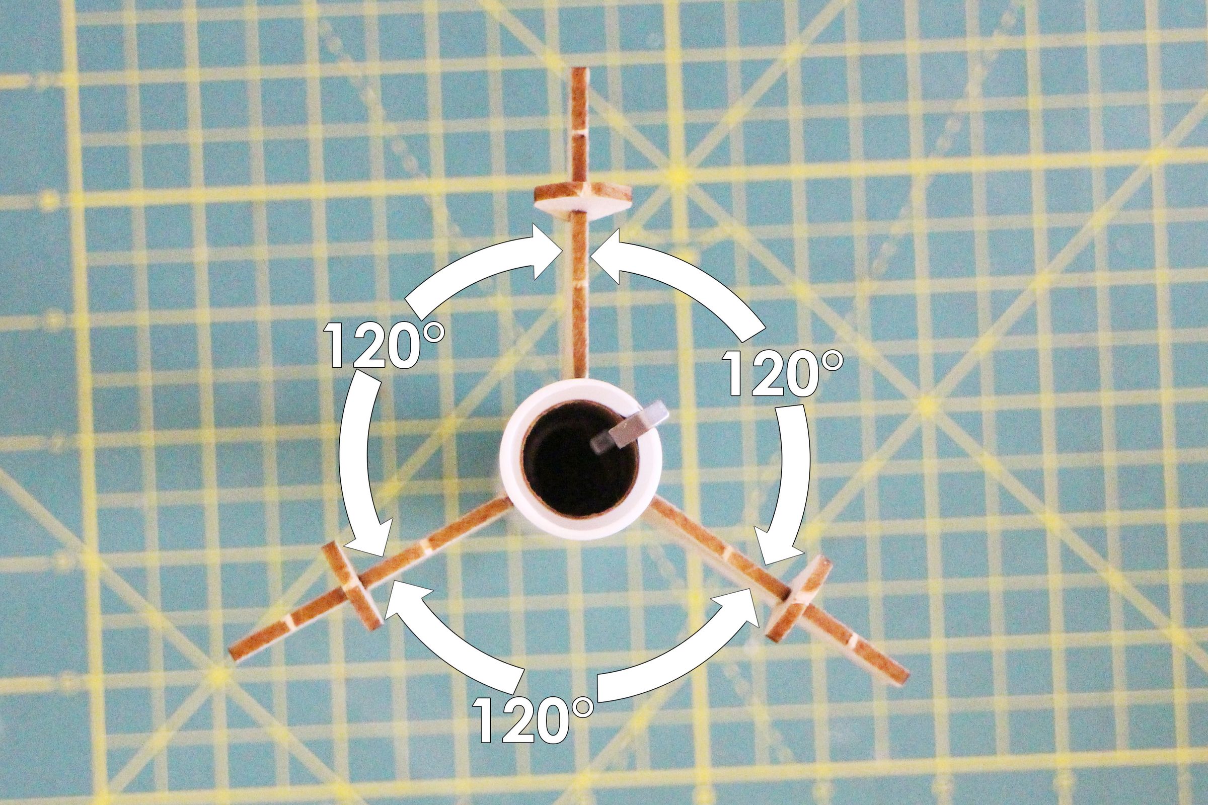

To get the best stability from the rocket in flight, it's important to make sure the fins are equidistant from each other. Looking from the bottom, down the rocket fuselage, align the fins so there is equal spacing (120°) between them.
This model has stabilizing stakes that are attached to the bottom of each fin, allowing it to rest on the fins. These stakes have slots that fit neatly onto the existing fins and are glued in place.

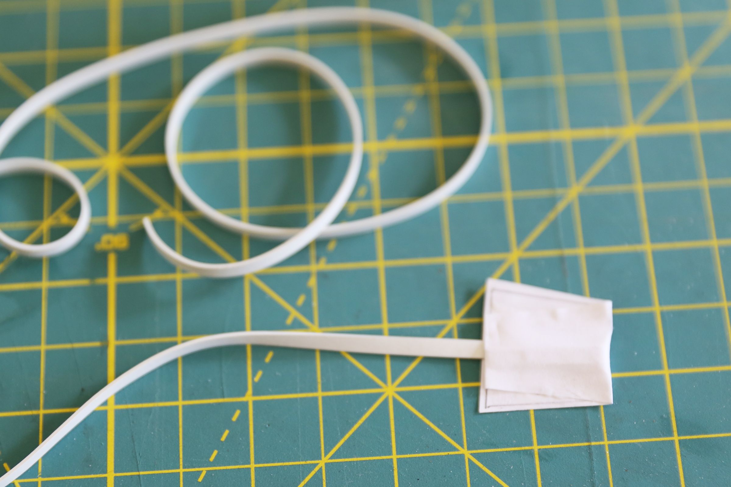

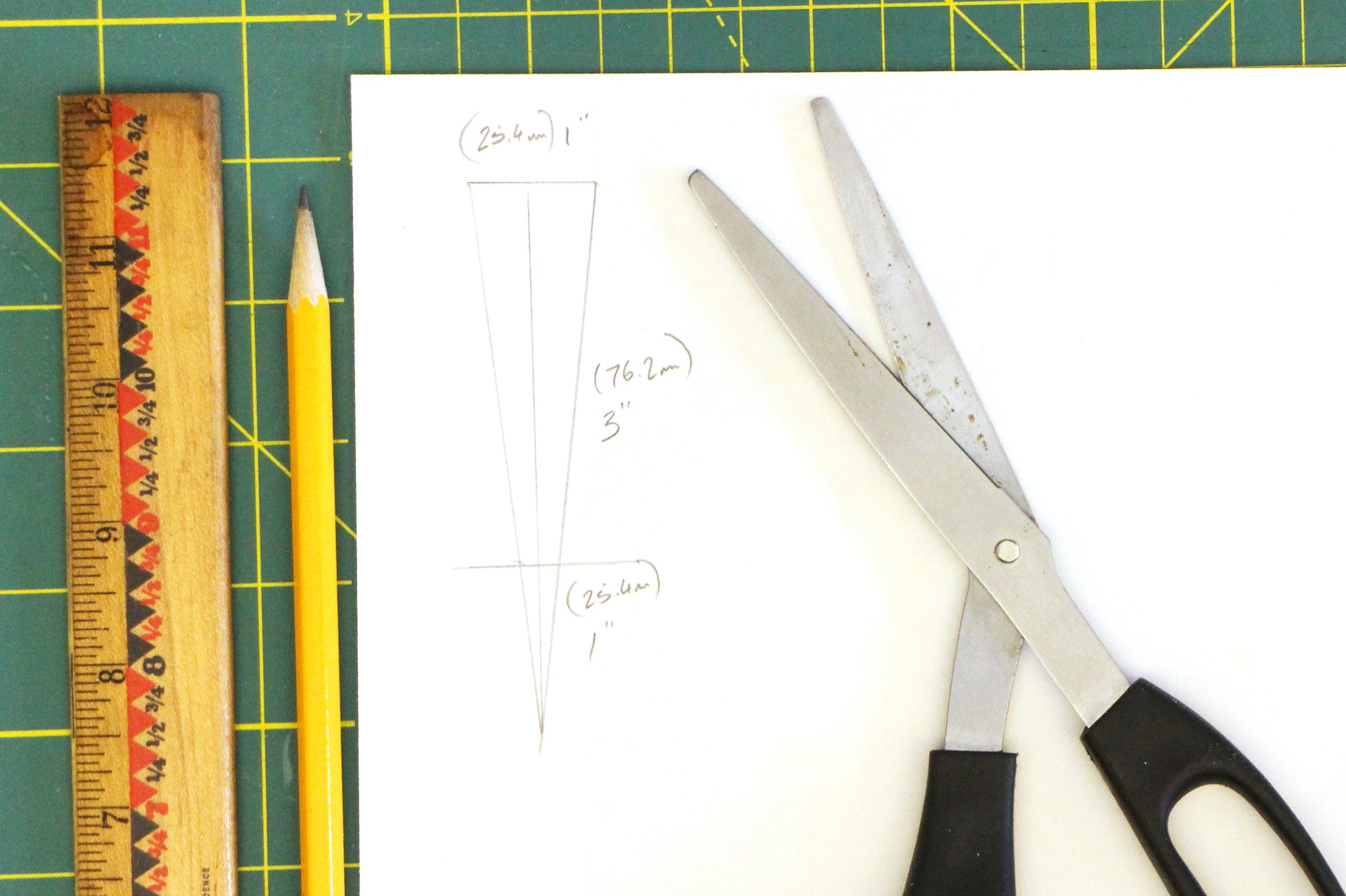

Step 14: Shock Cord Mount
Model rockets rely on a parachute to slow their descent after they have reached the apex of their flight. This parachute is attached to the nose cone which is tethered to the fuselage by a rubber shock cord (like a large rubber band). Here we will be making the mount that attaches the shock cord to the rocket fuselage.

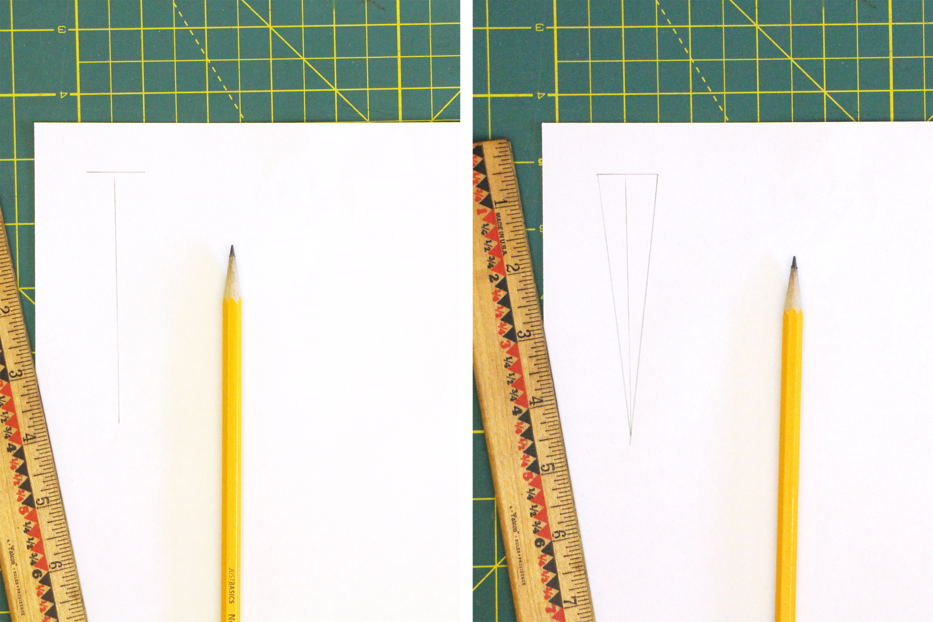

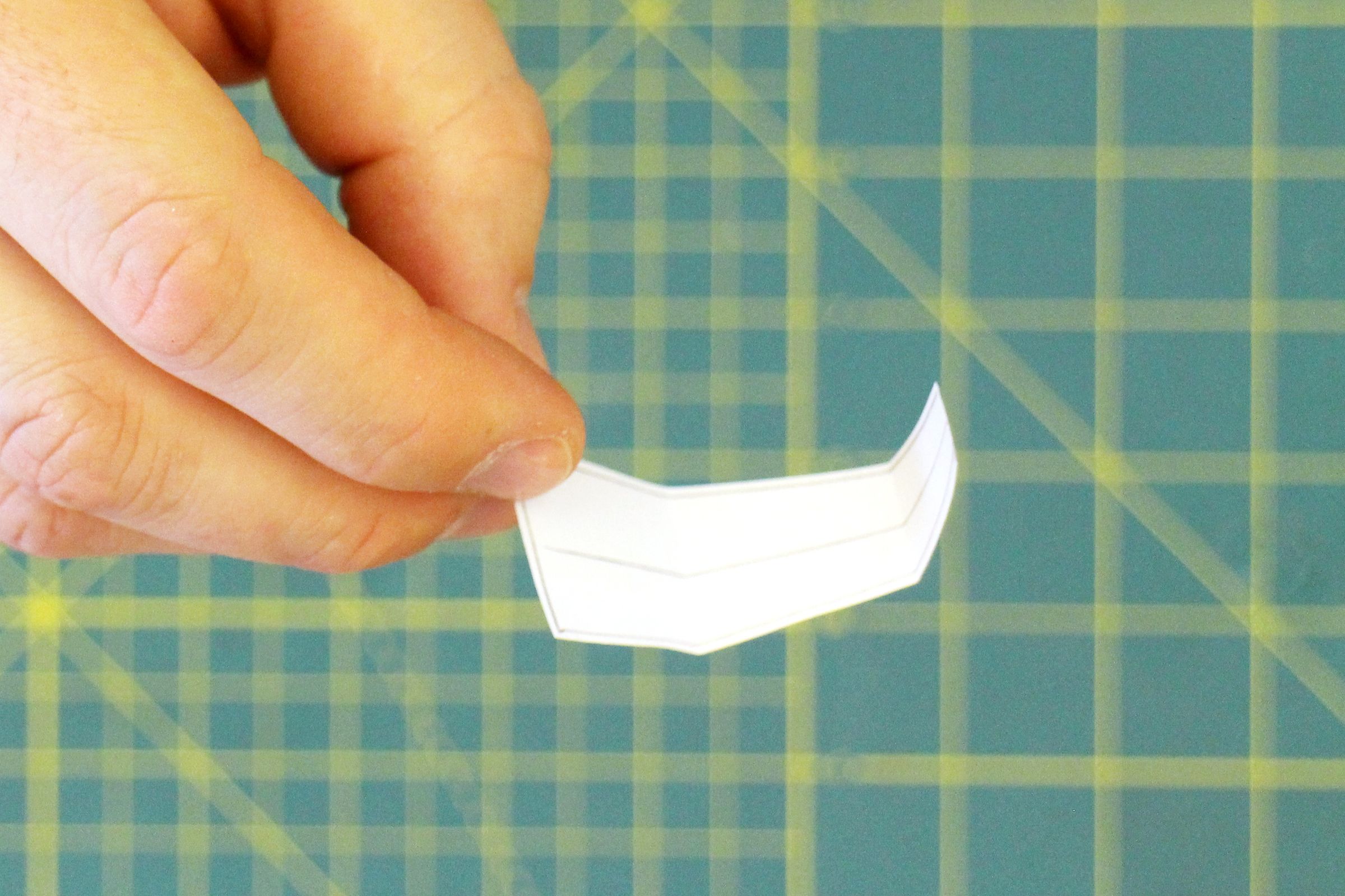

A standard piece of printer paper is all that's needed to make the shock cord mount. The basic shape of the mount will be an elongated triangle.
Using a pencil and a ruler draw the letter 'T' on the paper, with the leg of the letter about four times longer than the bar. Draw diagonal lines connecting the bar of the T to the leg terminal to create the elongated triangle shape.
The dimensions aren't critical as we're only going for a general shape. Roughly, the dimensions I used for my T-shape were 1" (25mm) for the top bar, and 4" (100mm) for the leg. Once you have a triangle shape cut it out with scissors Then clip off the sharp point of the triangle, about 1" up from the point.
With our truncated triangle shape finished, fold it into thirds.

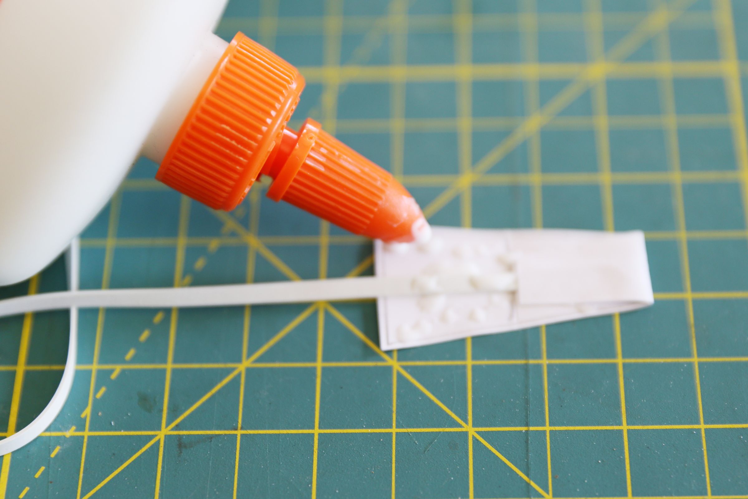

Step 15: Shock Cord

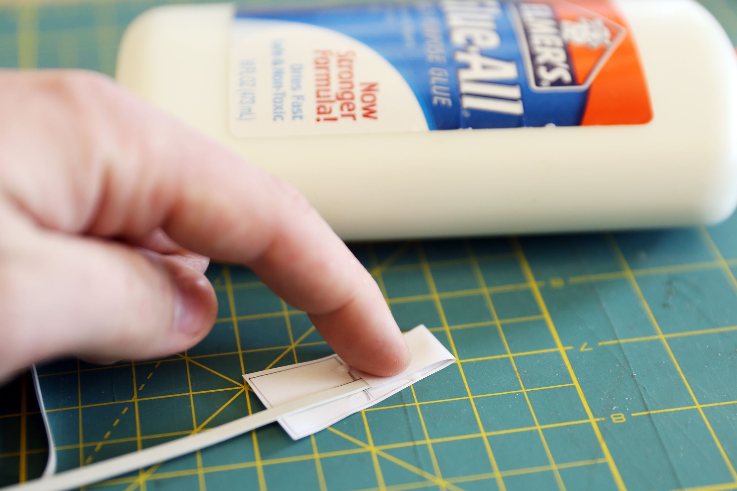

The shock cord gets glued into the triangle mount with white glue.
Place one end of the shock cord in the middle section of the paper mount. Then apply a dab of glue and fold down the thinner top section of the mount to seal in the end of the cord. Press firmly to secure the end of the cord in a paper sandwich.
Once you've done this, apply another dab of glue to the larger section of the triangle mount and fold the previously glued section downwards.
Press firmly to ensure good adhesion. The shock cord is now secured inside the shock cord mount.
Set the freshly glued shock cord mount aside to dry. While it's busy doing that, we can move on to painting the rocket body.

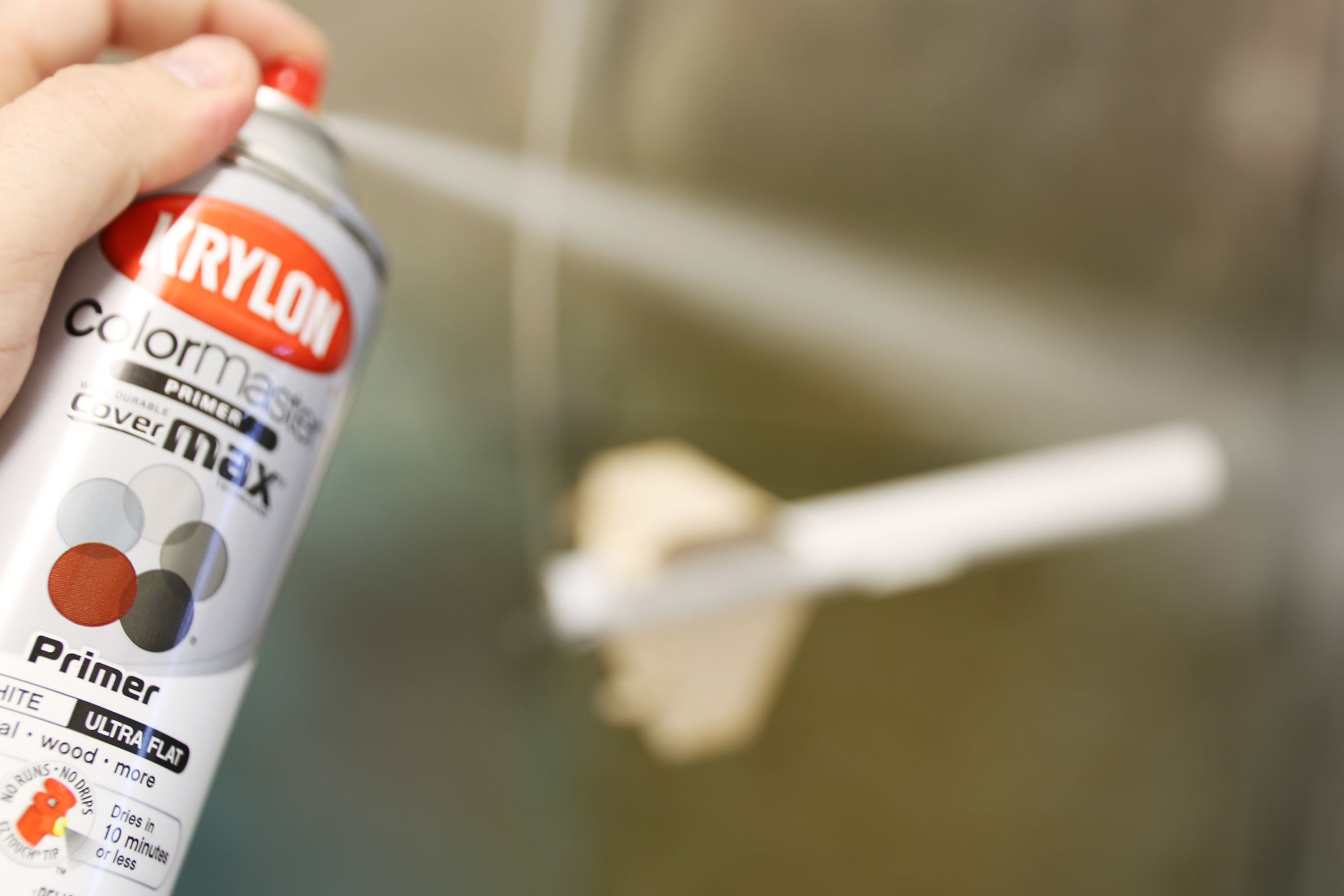

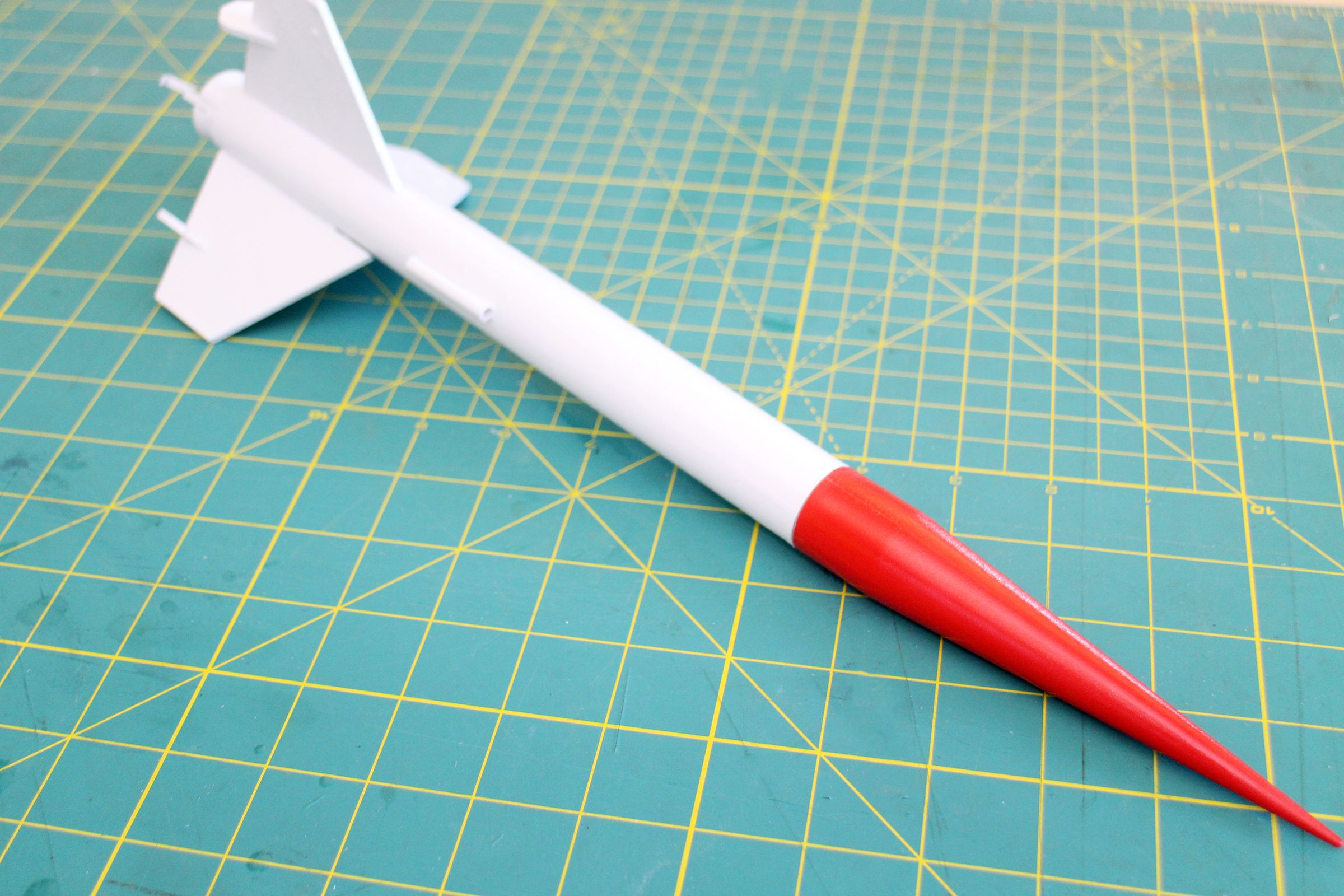

Step 16: Painting
Painting is optional, but it's been scientifically proven that decorated rockets outperform plain ones. Spray paint is the best choice to paint a rocket, as it's easy and provides even coverage.
Using a fine grit sandpaper (about 220 grit), gently sand the entire rocket to make a nice smooth surface finish. This is important as once paint it applied a rough surface will be very noticeable. When your rocket is smooth carefully wipe off any dust with a rag.
Before applying the paint color I wanted, I first sprayed a thin coat of primer. Primer works as a base coat for paint, applying an underlying white color to the piece and giving the paint better adhesion.

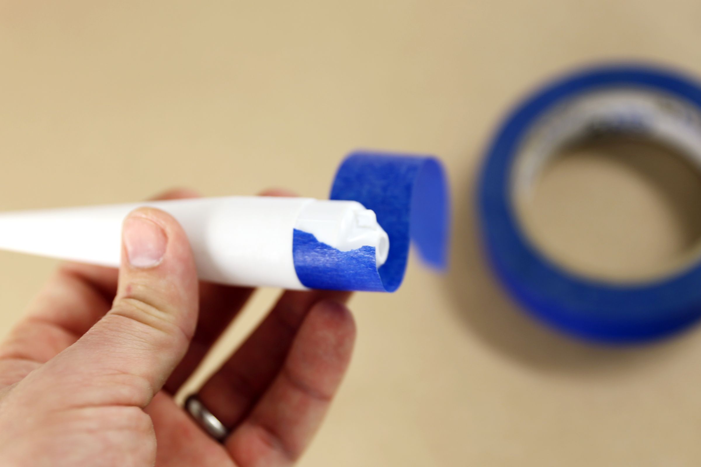

I protected areas that I didn't want painted, like the neck of the nose cone, with painters tape.
Here's the rocket after painting.

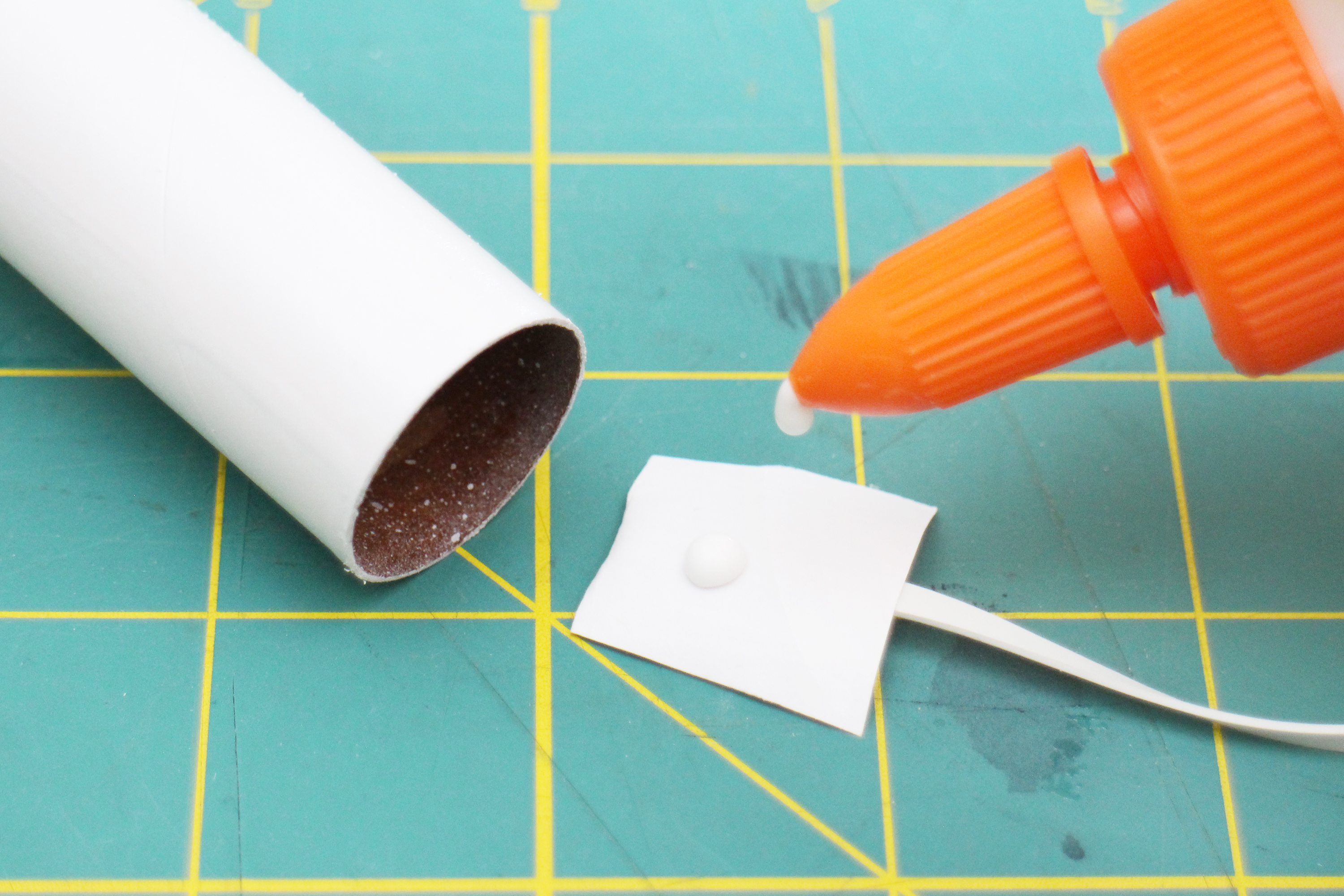

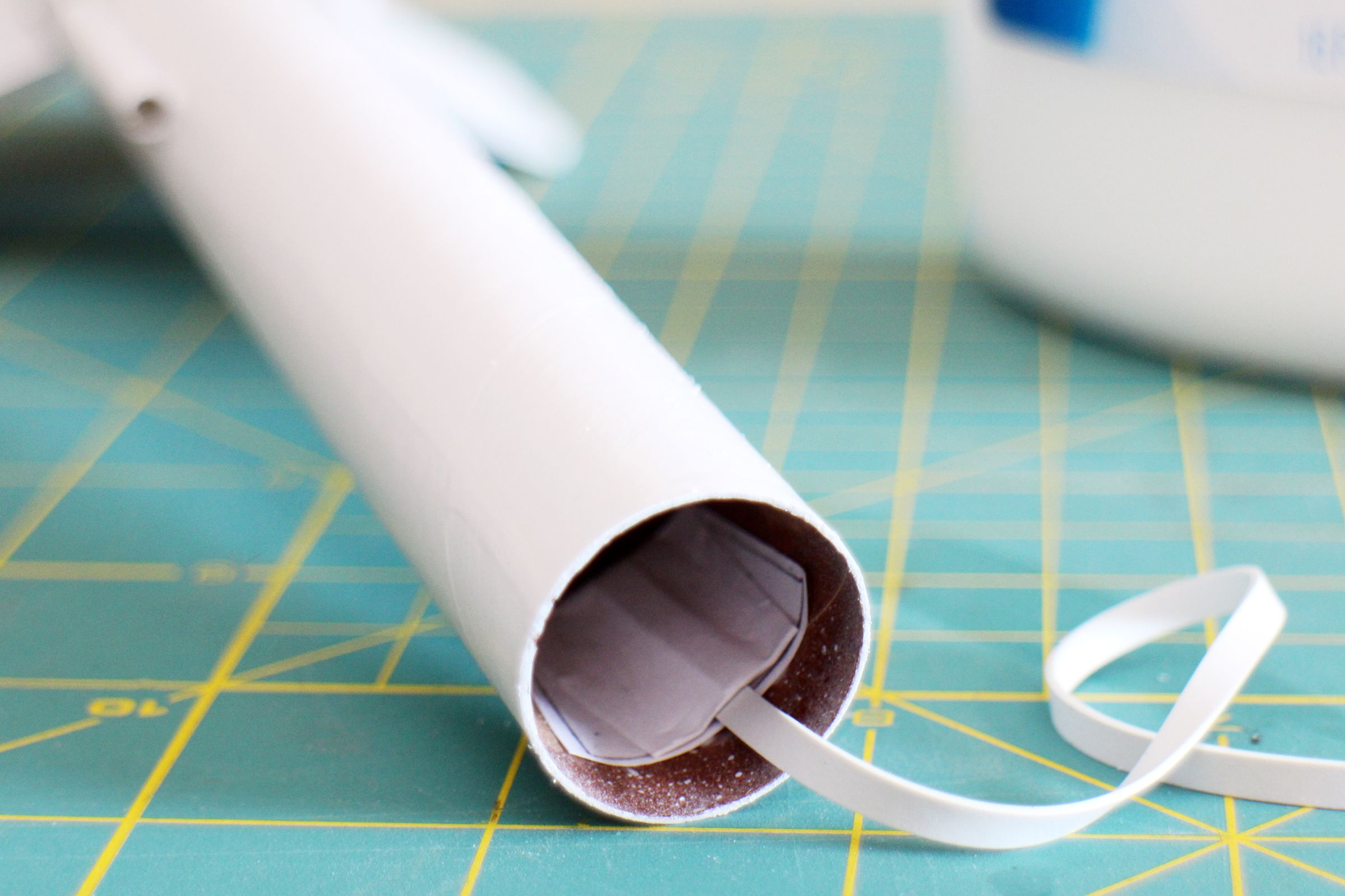

Step 17: Attach Shock Cord to Fuselage
After painting, the shock cord mount can be attached to the fuselage.
Using more PVA glue, attach the shock cord mount from the top of the fuselage on the inside.
Firmly press in place to ensure a good bond. Set aside for the glue to dry completely.

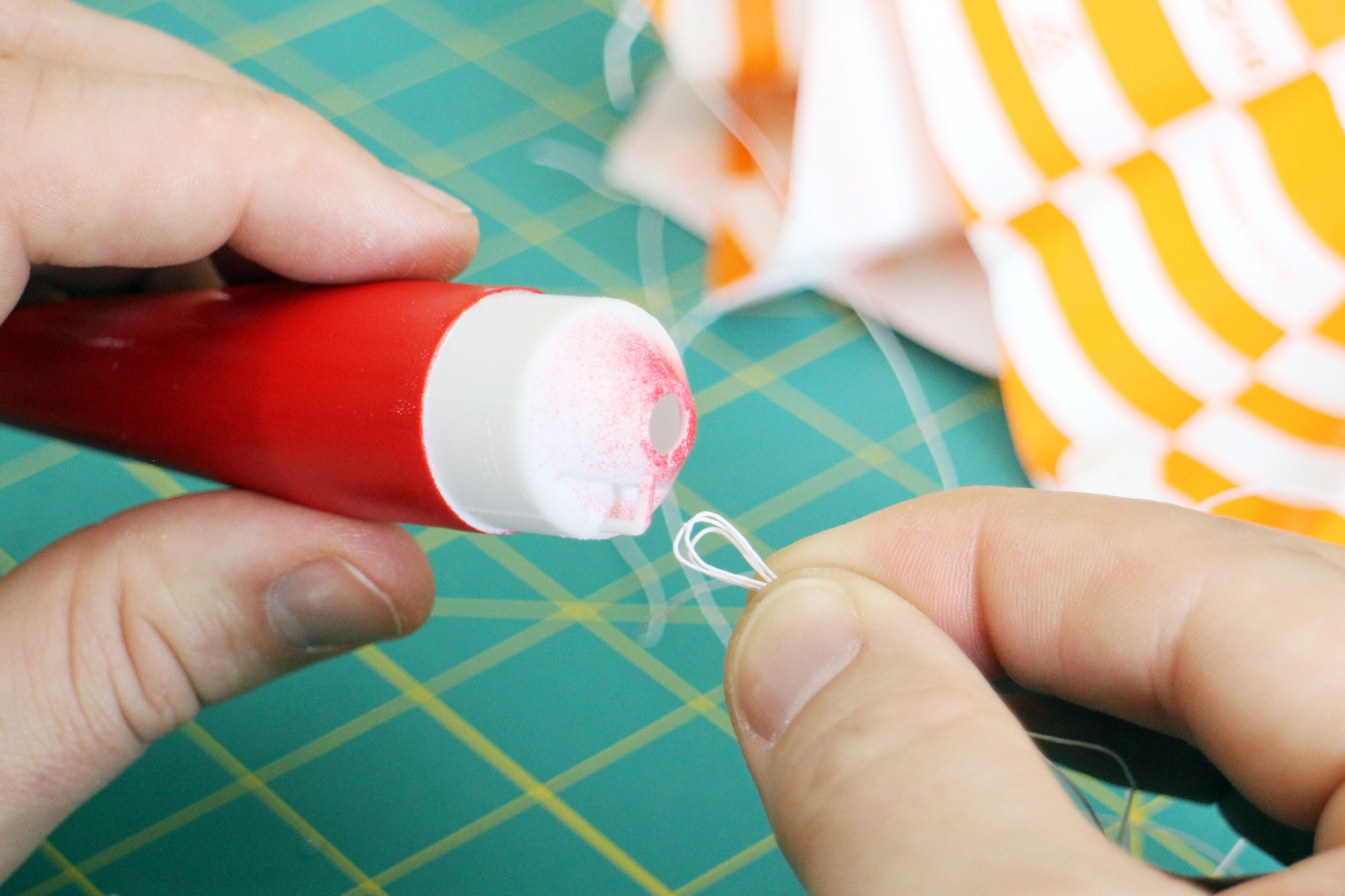

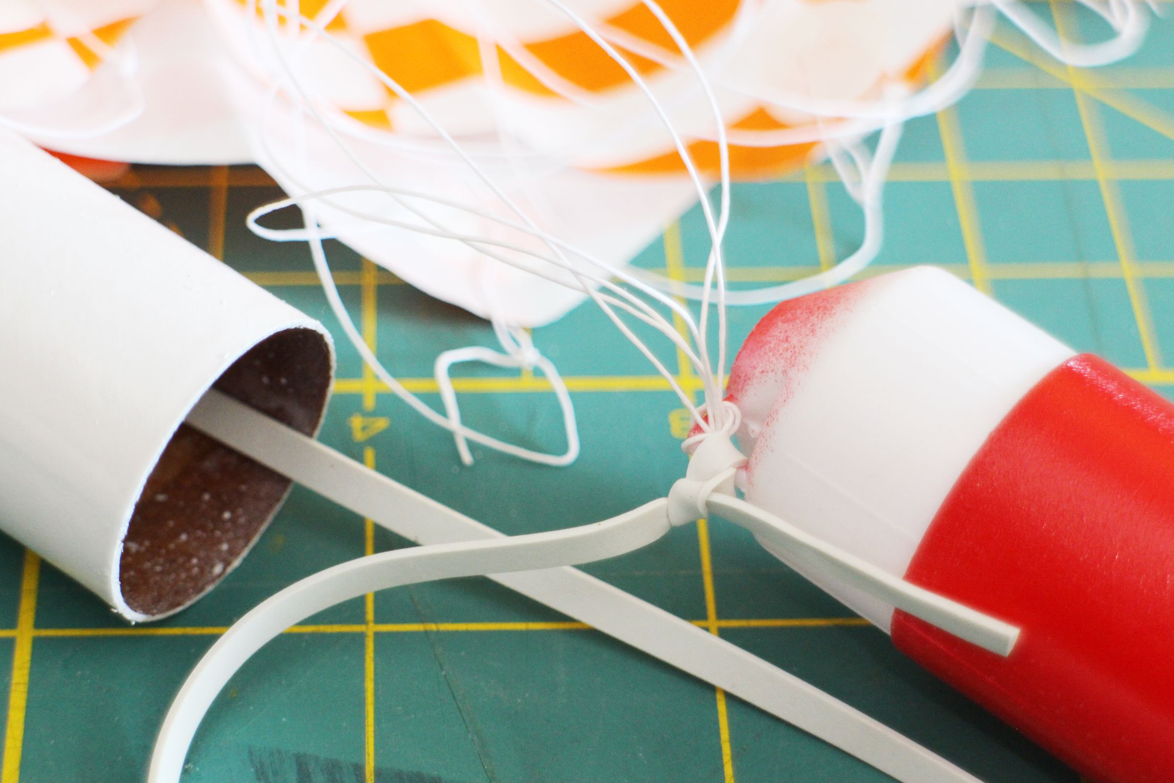

The parachute gets attached to the nose cone with a simple knot. The nose cone should have an obvious attachment point where the parachute cord can be threaded through and securely attached.
Make sure that your parachute cords are all approximately the same length, ensuring your chute will distribute the weight evenly when deployed.
Lastly, attach the loose end of the shock cord to the nose cone, tying a secure double not at the same attachment point as the parachute cord. The assembly of the rocket is complete!

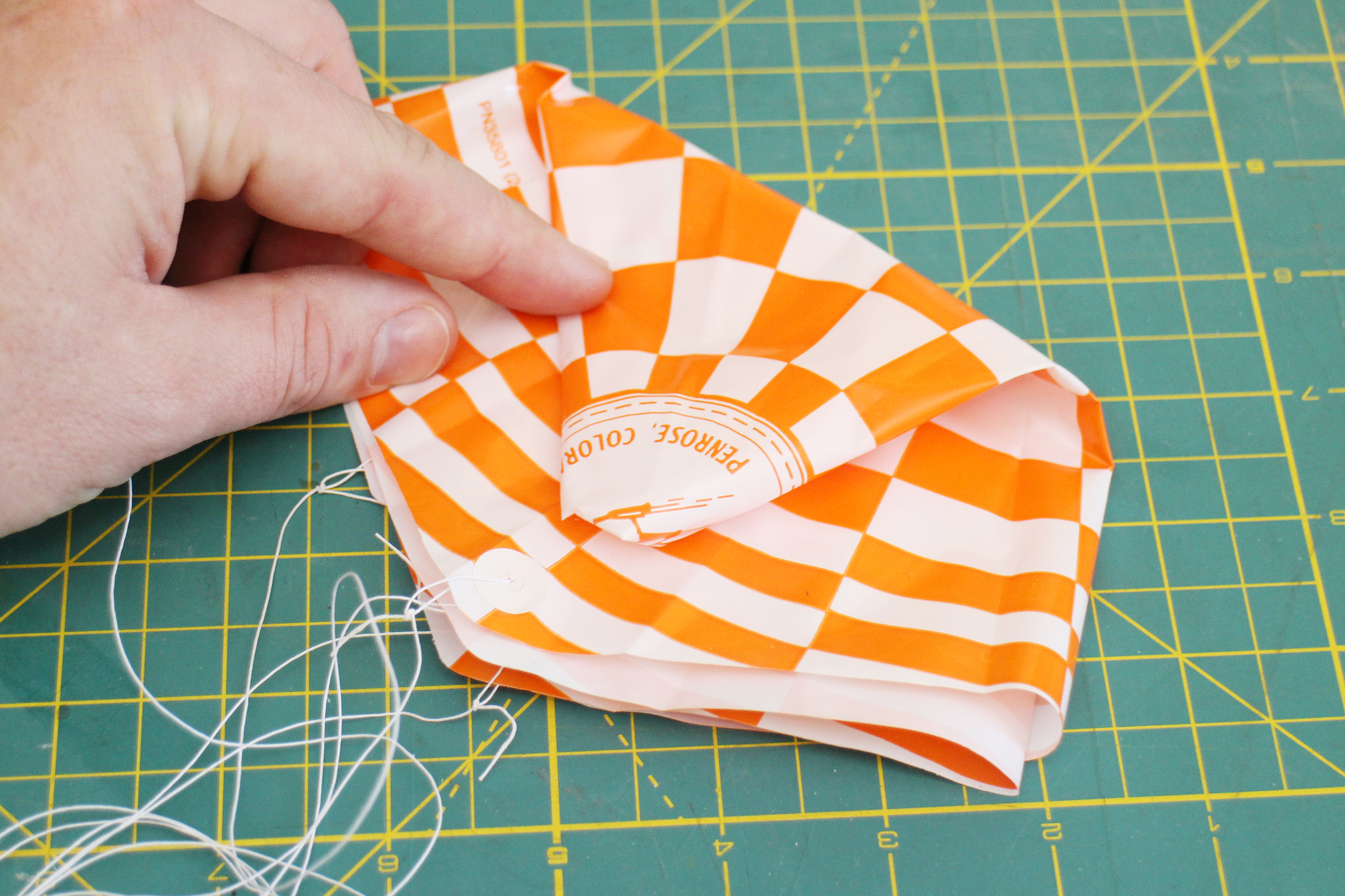

Step 19: Stuff Parachute

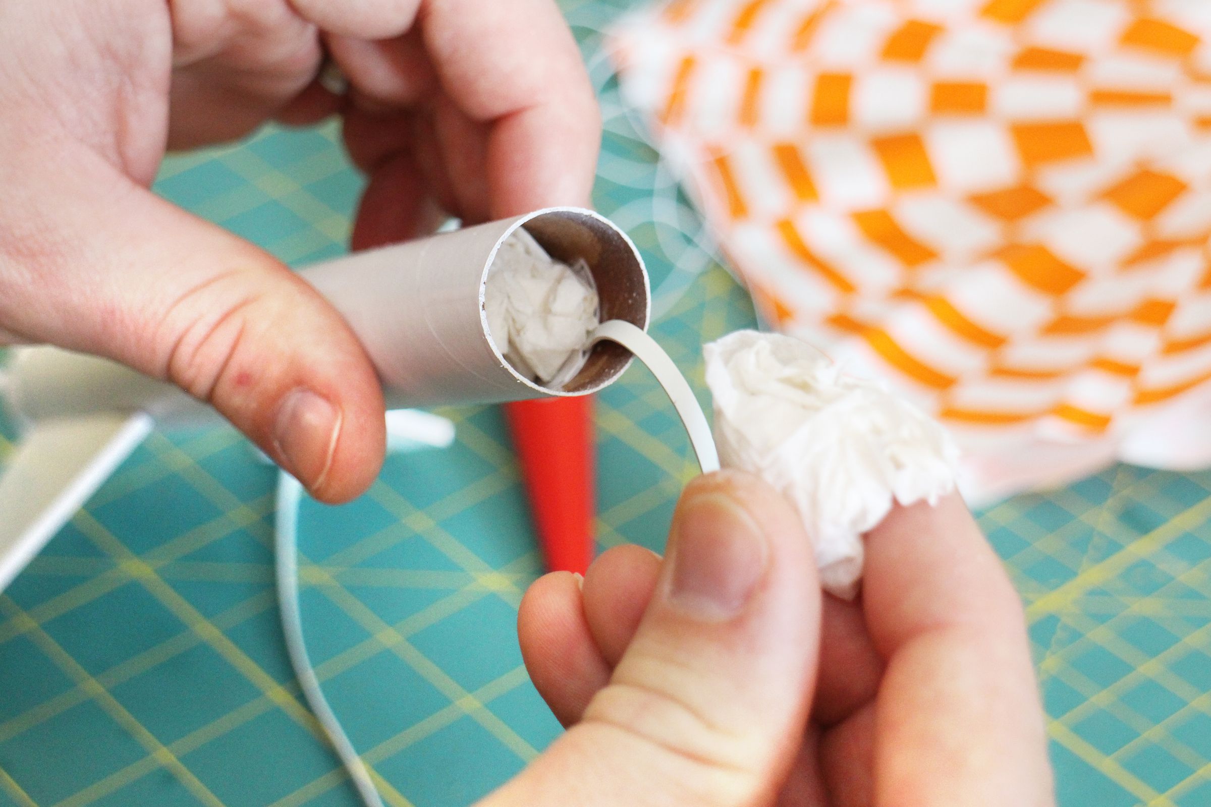

Before stuffing the parachute into the fuselage, we need to add some wadding. Wadding will helps control the blast that will push the nose cone outwards, ejecting the parachute. Without wadding, the blast can melt the parachute and prevent any controlled descent.
Stuff 2-3 bunched up pieces of wadding into the neck of the fuselage. The aim is to stuff the fuselage with enough wadding to make the ejection blast knock the cone off, but not so much wadding that it jams the fuselage and inhibits the blast.
Lay the parachute flat, fold over lengthwise, then wrap the edges inwards to make a tube shape. Insert the folded parachute into the fuselage and close the rocket up with the nose cone.

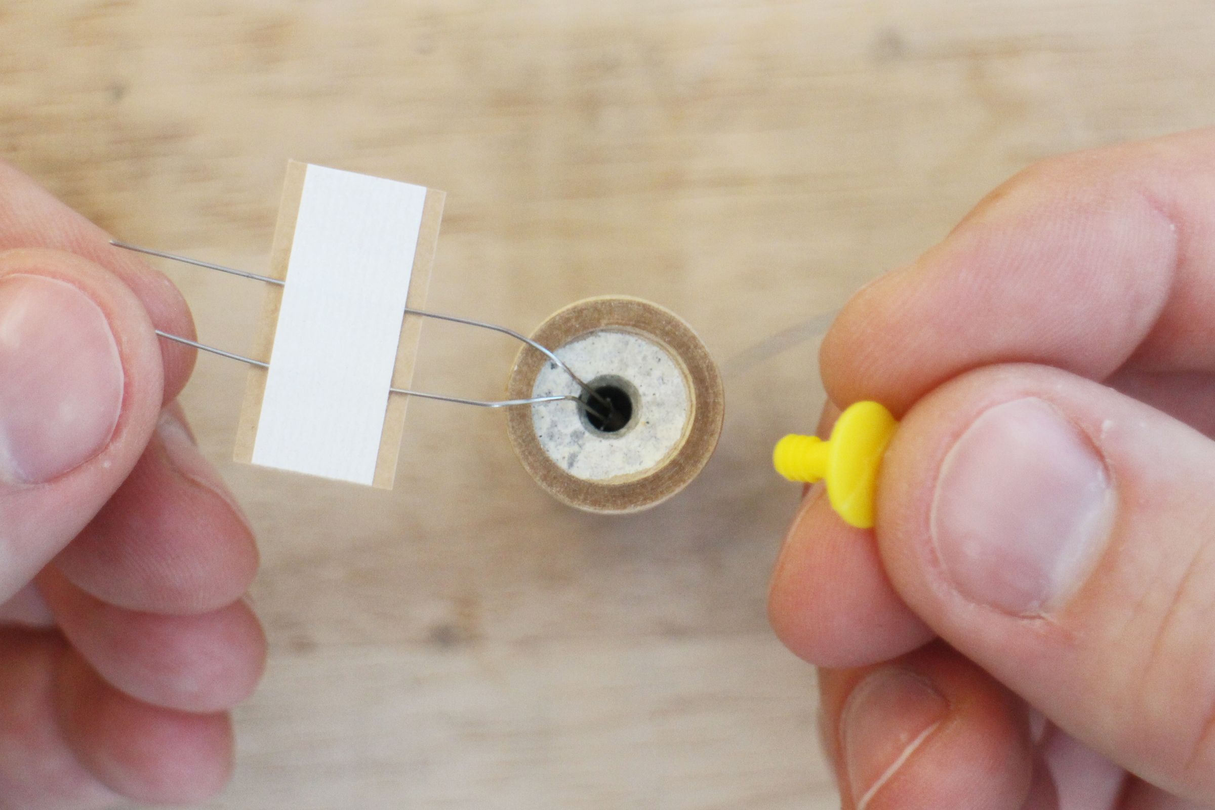

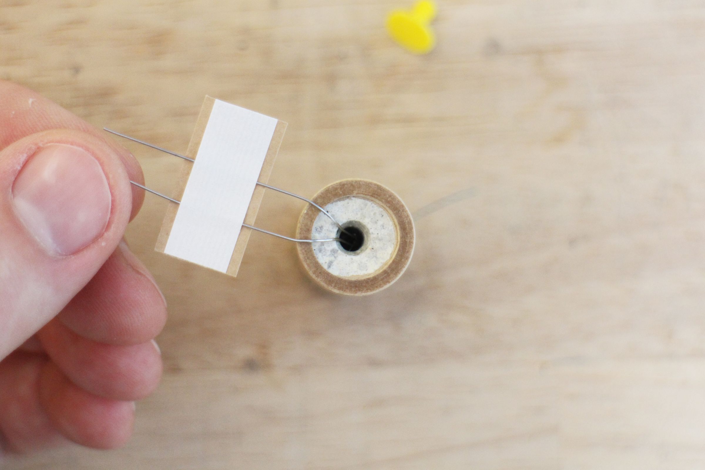

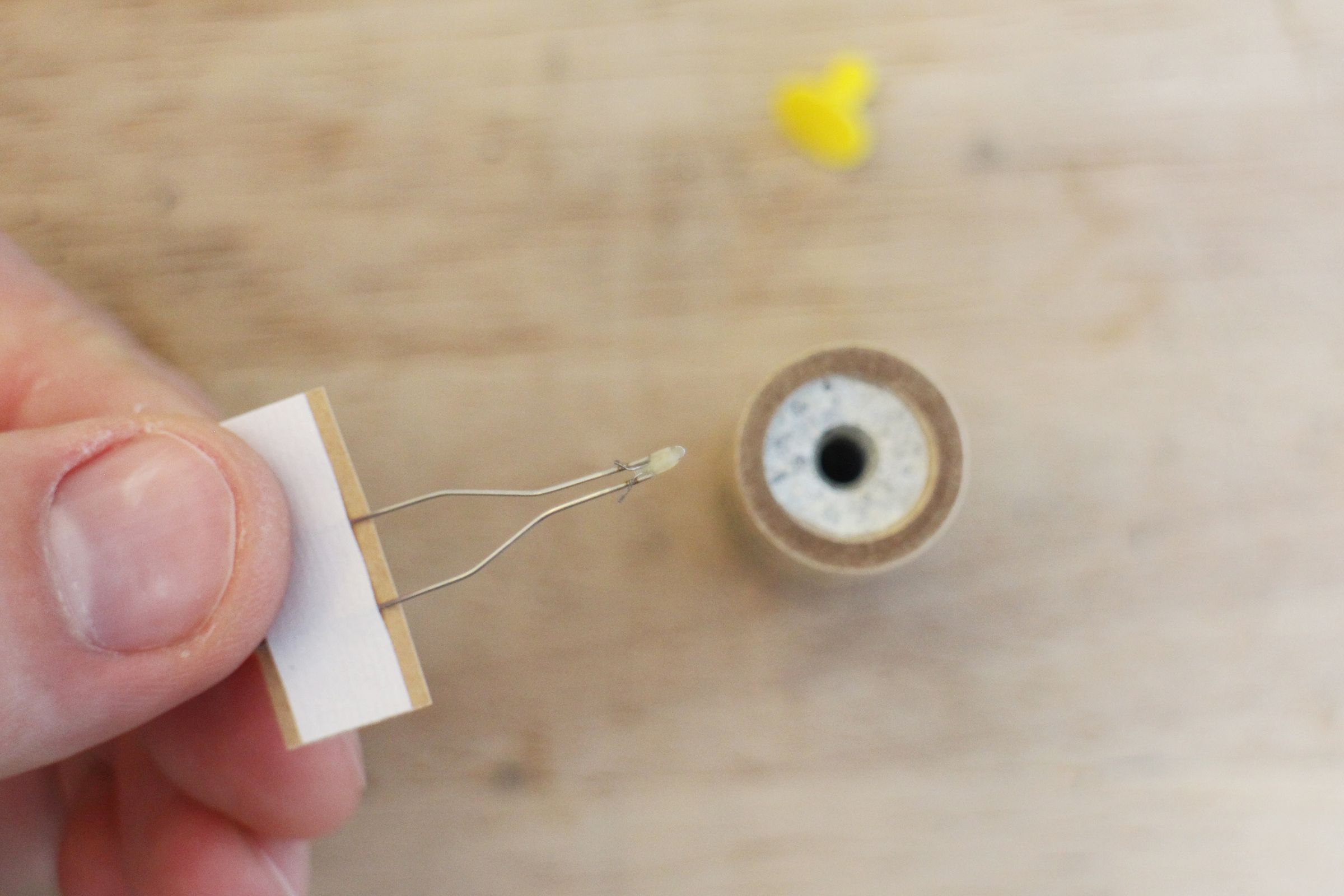

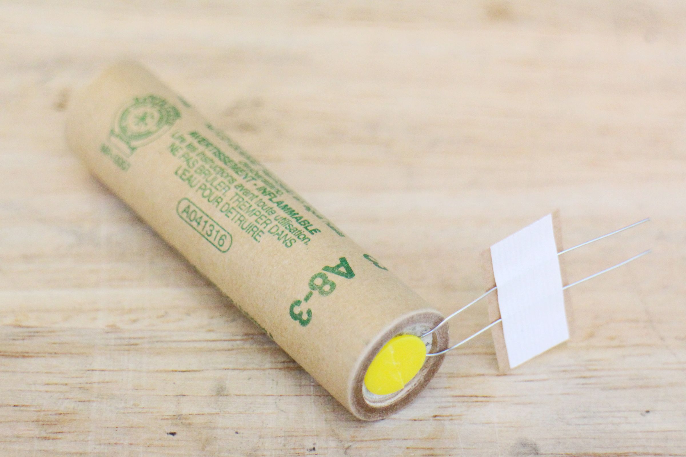

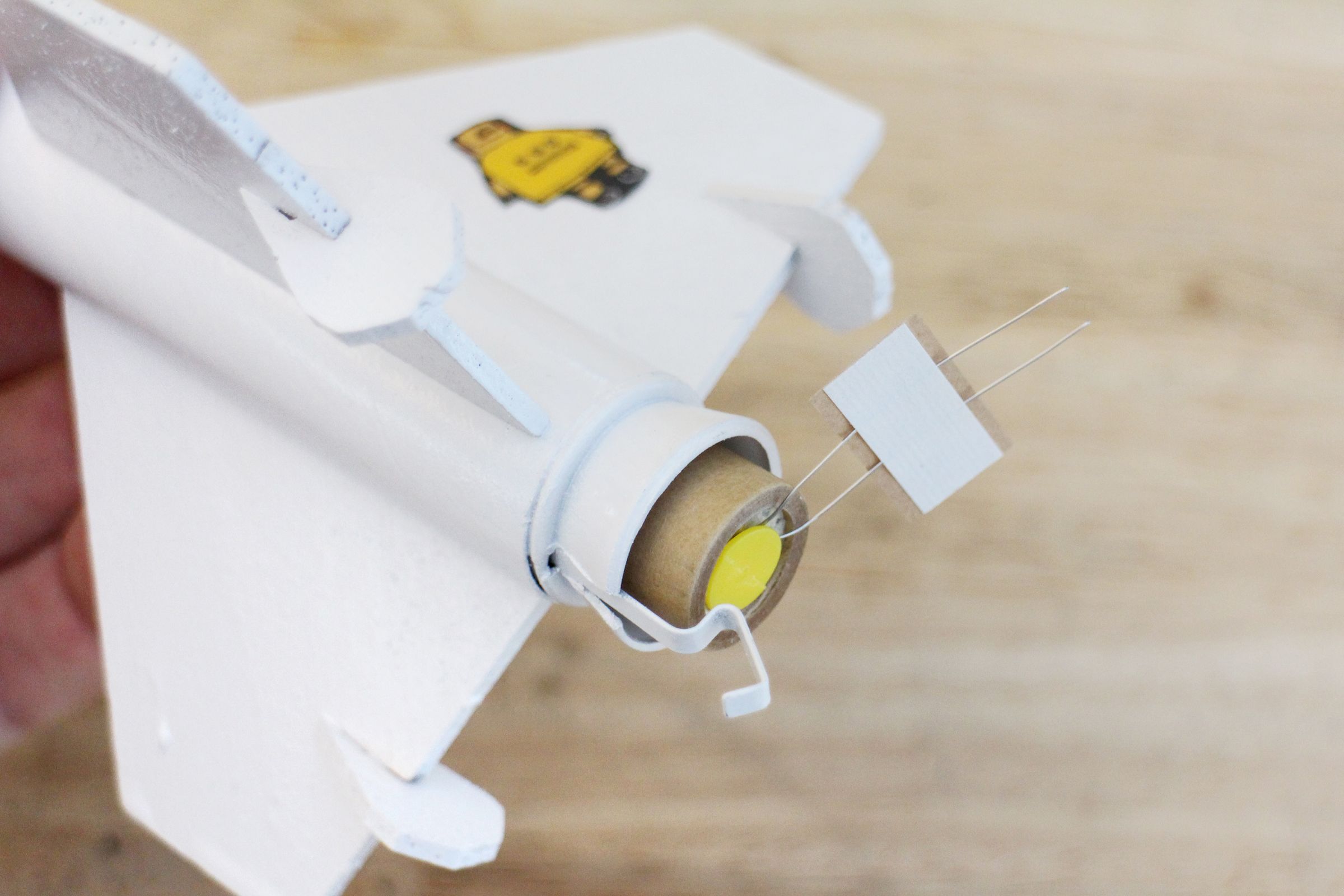

Model rocket engines require an igniter to operate. These igniters take an electrical current and convert it to heat through a thin metal wire. This wire, when glowing red hot, will ignite the rocket and allow your rocket to blast off.

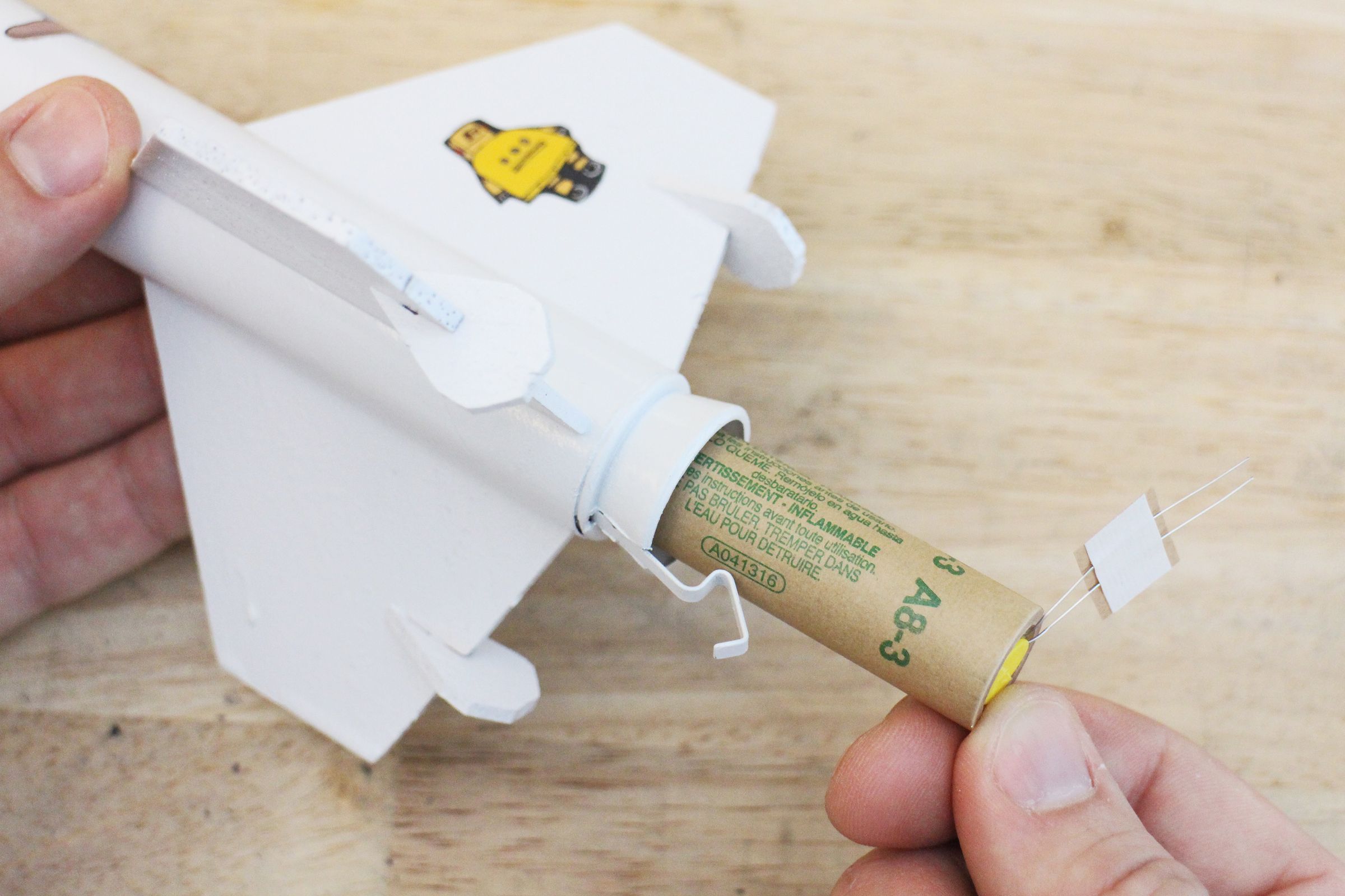

Cut or tear off one rocket igniter and insert it into the bottom of the rocket engine until it touches the bottom of the cavity. Then, bend the igniter wires away from the cavity and install the plug. The plug will keep the the ignition wires in contact with the rocket engine for when you're ready to launch.
After the rocket engine has been prepared, it can be slid into the rocket fuselage until it's fully seated and locked in place by the engine hook.
