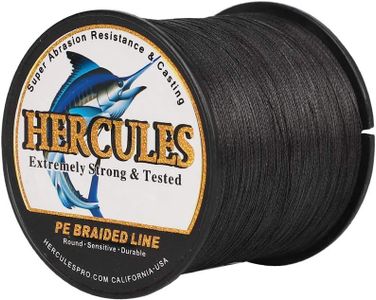

  • Strong thread, I used some fishing line.

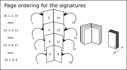

Printing the pages with a single side printed takes time and planning. You cannot batch print (well you probably can but it would take some planning and I didn't do that. I just wanted to get printing.)
I would put one sheet in and print the first pair of pages, for the first leaf 1 and 20 were on the same page, when that printed correctly I flipped the paper and printed the second pages, 2 and 19, and so-on until the first signature was printed. rinse and repeat until all the pages are printed.
The last third or so of my book was blank, like in the film, to show that it was an ongoing diary.
Keeping track of the order is very important, so i kept the signatures together and separated each one with a book mark of a blank piece of paper.
