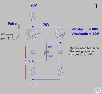

(This is based on Ronald Dekker's excellent site on neon ring counters. If you want more information on neon glow lamps in general, check out my previous Instructable or this excellent overview.)

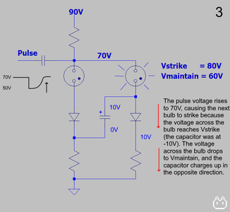

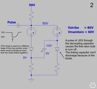

Neon ring counters take advantage of the fact that neon lamps turn on or "strike" at one voltage, and then the voltage across the bulb immediately drops to a lower "maintaining" voltage, below which the bulb will turn off. The key to the ring counter is that if a neon bulb is given a voltage halfway between its striking and maintaining voltages, it will only take a small negative change in voltage to turn the bulb off, or a small positive change to turn the bulb on. Let's see how it works with some hypothetical neon lamps that have a striking voltage of 80V and a maintaining voltage of 60V.
1. Initially, the bulb on the left is on and current flows from the 90V power supply, through the left bulb and a diode and resistor to ground. Since the bulb is on, the voltage across it is 60V, so the capacitor in the middle charges up to 70 - 60 = 10V.
2. An external pulse generator delivers a -20V pulse capacitively coupled to the shared wire of the bulbs, which causes the voltage given to the bulbs to drop from 70V to 50V (watch the black arrow in the upper left). This is less than the left bulb's maintaining voltage, so it turns off. The capacitor in the middle is still charged up to 10V, and it can't discharge because of the diode on the right, so the bottom of the right bulb takes on a voltage of -10V.
3. The voltage of the shared wire rises back up to 70V. This isn't enough to cause the first lamp to strike, since 70V < 80V. However, the second lamp had -10V on its bottom side, and 70V - (-10V) = 80V. Since the charged capacitor lowered the voltage on the negative side of the second bulb, the voltage across the second bulb reaches its striking voltage, so the second bulb turns on. Current flows through the second bulb and its resistor and diode to ground, and the capacitor in the middle charges up to 10V in the opposite direction it was charged previously.
To make a ring counter with multiple neon lamps, all you have to do is add another lamp, diode and resistor in series, then connect a capacitor from the negative side of the diode in the previous stage to the positive side of the diode in the new stage. Then, if you connect the final stage to your first stage, you'll form a loop and the neon glow lamps will go around in a ring forever and ever and ever - that's why it's called a ring counter!
When we design our ring counter, we'll want to decide on values for the supply resistor and the resistors under each lamp (the lamp resistors will all be the same resistance). Our goal is to pick resistors that make the current through our neon lamps close to the suggested current from the datasheet, but most importantly to make the voltage on the positive side of the bulbs halfway between the striking and maintaining voltage of the bulbs. These resistances depend on four things:
- Ibulb (bulb current)
- Vstrike
- Vmaintain
- Vsupply
I'll give you the equations for the resistances here, but first I want to point out an important detail: This is all under the assumption that all of your neon glow lamps have identical striking voltages and maintaining voltages! In reality, this is not the case, and it's especially true when using cheap neon indicator lights like the NE-2 bulbs I used. Because of this, it's important to age your bulbs (as described in the next section) to make sure their electrical characteristics don't change over time, and then to measure your bulbs and select neon lamps with similar striking and maintaining voltages. Even then, it's not a given that your ring counter will work, so you should breadboard it and let it run for a long time before soldering things together.
Ok, here are the equations. They come directly from the fact that we want the current through the bulbs to be Ibulb and the positive side of the bulbs to have a voltage halfway between Vmaintain and Vsupply. I'm calling the single power supply resistor Ra, and the multiple neon lamp resistors Rc.
- Rc = (Vstrike - Vmaintain) / (2 * Ibulb)
- Ra = (Vsupply - Vmaintain - Ibulb * Rc) / Ibulb
Ronald Dekker derives these equations and extends them to cases when your bulbs don't all have the same striking and maintaining voltages, so check out his site if you're interested - there's a lot of good stuff about ring counters there.
One more thing - we need to generate the pulses that make the ring counter advance. I chose to do this with a simple neon glow lamp relaxation oscillator. A capacitor in parallel to a neon lamp charges up to the striking voltage, causing the lamp to turn on and discharge the capacitor to the lamp maintaining voltage, and so on. The neon lamp voltage forms a sawtooth-like wave instead of a pulse, but I was able to make it work with the ring counter with hardly any trouble (as long as the pulse drops low enough to turn the previous bulb off, the voltage to the bulbs will rise until it forces the next bulb on). If you're making a ring counter for a clock, then I wouldn't recommend this because the frequency of the relaxation oscillator depends on the capacitor, the resistor, and the striking and maintaining voltages of the neon lamp. The neon bulb's voltages can change over time as the lamp ages or even be affected by the ambient light level (this is called the dark effect), and you wouldn't want that to make your clock lose track of time! A neon relaxation oscillator is perfect for us though, since we don't care about the precise frequency changing and the flashing bulb makes it look like the heart is beating.

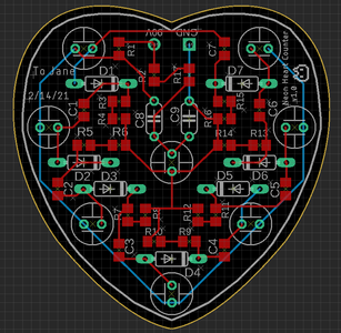

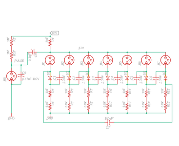

Step 4: Design the Heart-Shaped PCB
I decided to use Autodesk EAGLE to put the ring counter on a heart-shaped PCB, with the ring counter neon bulbs along the outside and the oscillator neon bulb in the middle. This gives the impression that the heart is beating since the middle bulb flashes each time the ring counter advances, which I thought was pretty neat. I used 0805 surface-mount resistors, and 0805 surface-mount capacitors to link the ring counter stages together, but kept the oscillator capacitor and the coupling capacitor as through-hole since they need to be rated for 100V. I picked 1N4148 diodes, but I think other diodes would work just fine. The vias at the top of the PCB are for the the ground and 90V wires from the adjustable DC supply. The wires will be soldered in from behind the board, so we won't actually see those wires when the case is fully assembled.
One important thing to keep in mind if you decide to make this yourself: make sure to change the name on the upper left of the board. I don't think your special someone would be too happy if you got them a heart with someone else's name on it!

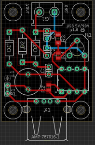

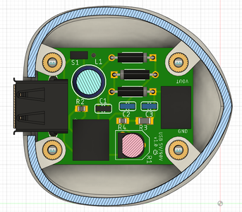

Step 5: Supply a Supply! (60-100V DC From 5V USB)
We need a convenient way to supply 90V or so DC at low current to the ring counter, so I also designed a PCB that converts 5V from a USB jack to any voltage between 60V and about 100V. This uses the LT1073 DC/DC converter and a voltage multiplier in exactly the same way as my last Instructable, a wirelessly rechargeable Neon Lamp Tea Light. I explain the operation of the LT1073 in detail there, so I won't go into it much here. The 10k potentiometer R1 determines the output voltage, so turning the potentiometer left all the way will give around 60V, and turning the potentiometer right will give a maximum of 100V. One more thing to know is that the 220 ohm resistor R2 will limit the current draw of the LT1073 to less than 500mA. This means that, theoretically, a computer should consider this circuit a high-power USB device and happily deliver 5V at 500mA or less. This seemed to work when I tried it, but I care about my computer quite a lot, so out of fear and cowardice I now have my heart plugged in to an old phone charger.
I have to admit, I made an awkward mistake when designing this circuit. The USB connector here is a standard USB type A female connector. This means that you need a cable with a USB type A male connector on each end if you want to plug this power supply into a computer or a power brick. Well, apparently, that's not allowed! Wikipedia actually labels such a cable as "Proprietary, Hazardous." Supposedly I should have used a USB mini or micro connector on my board, which I probably would have done in the first place if I didn't already have these USB type A receptacles lying around. This isn't a real problem since you can still buy these "hazardous" cables online, but it's something to keep in mind.
I also decided not to put a switch on the case for the heart, since I thought it would look a little ugly and wasn't necessary. I figured I would reuse this supply for other projects though, so I included space for a small "on" switch on the bottom left of the board, although we'll just be soldering those two vias together with a wire.

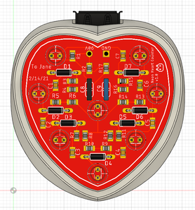

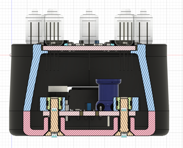

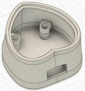

Step 8: Design a Case
I designed my 3D printed case in Fusion 360, and I think it turned out pretty well! Eagle created 3D models of both of my boards and sent them over to Fusion, which made it pretty easy to put things together (although a couple colors got messed up, not sure about that).
The case will print in two pieces, a base piece and a walls/top piece. The heart PCB sits in an indentation in the upper part of the case, while the power supply sits on the bottom part. There are holes to hold screw inserts in the top piece, and holes for flat-headed screws to go through on the bottom, so the case screws together with four screws. The screws go through those drill holes in the corners of the power supply PCB, holding it in place, which is important because it takes moderate force to plug in a USB cable to the power supply. The flat-head screws sit flush with the bottom of the case (hopefully).
I couldn't think of a tricky way to secure the heart PCB without covering part of it, so we'll just glue that in. I suggest using some sort of transparent glue - I used tacky glue.
Our case looks pretty sweet, so let's try to print it!

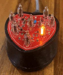

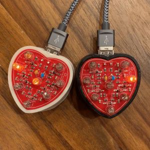

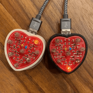

Step 12: Results
Congratulations, you've completed your adorable neon ring counter heart! How did it turn out? I'm really happy with how this project went, I thought it would be hard to make a ring counter using NE-2 bulbs from what I heard online but it wasn't too bad. I like the aesthetic effect of the light traveling around the outside when the middle bulb flashes, especially with the red PCB.
I got so attached to the first heart I made (the black one) that I couldn't bear to give it away, so I made a second one as a gift. They count at slightly different rates, but I also think that's pretty cute.
