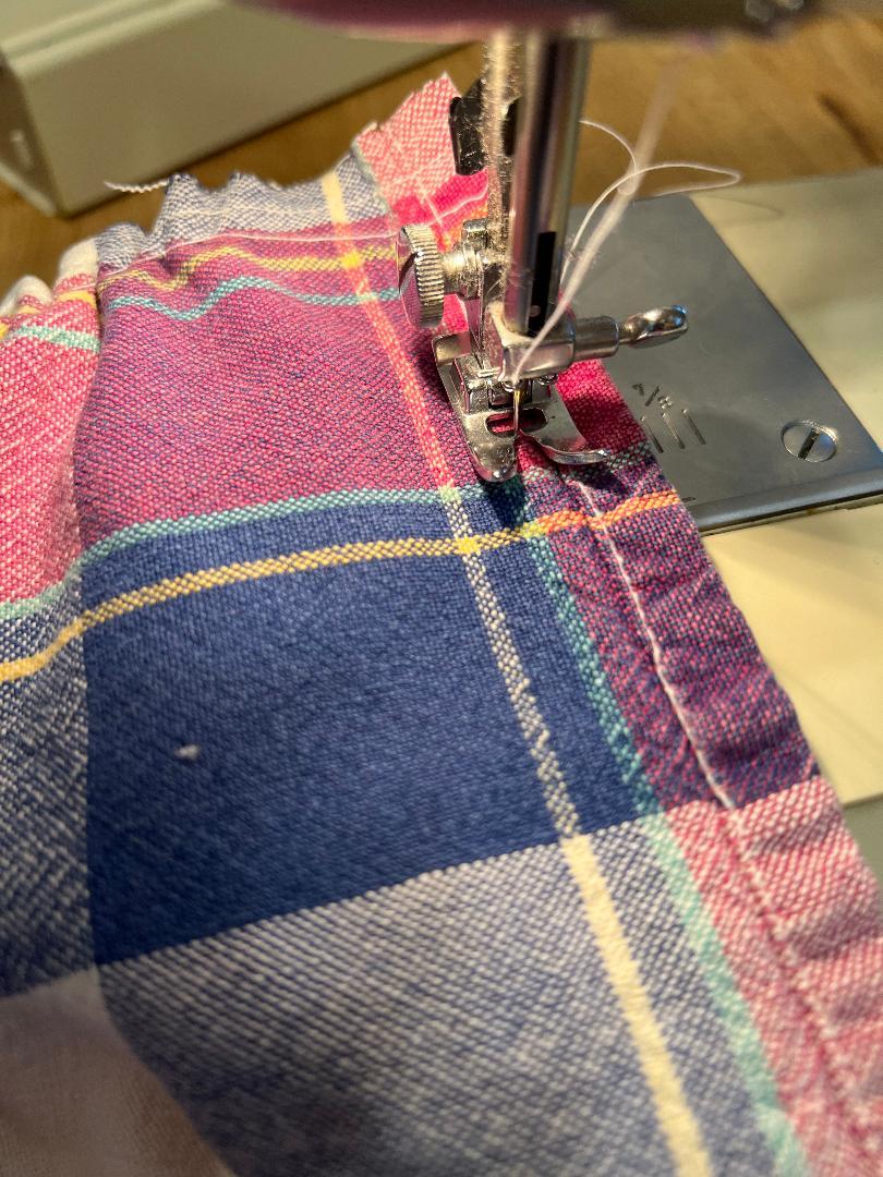

Step 5: Make the Side Seam
Sew the side of the skirt, inside-out, matched up from top to bottom. Sew a 5/8-inch seam.

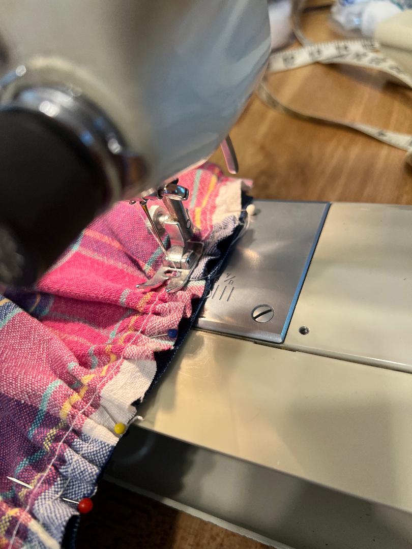

Step 6: Put Them Together
Lay out the shorts inside-out. Also have the skirt inside-out. Match up the bottom edge of the shorts to the top edge of the skirt. Pin in place. If they don't match up, gently pull up with a seam ripper on the basting stitches in the top of the skirt in different areas until the material lines up with the shorts.
Step 7: Completing the Skirt
Sew a 5/8-inch seam, connecting the bottom of the shorts to the skirt. Since the bottom edge of the material was a finished edge, now the skirt is complete! It went together fairly quickly and easily. I wasn't sure if I liked the belt pictured so I thought I would figure that out later.

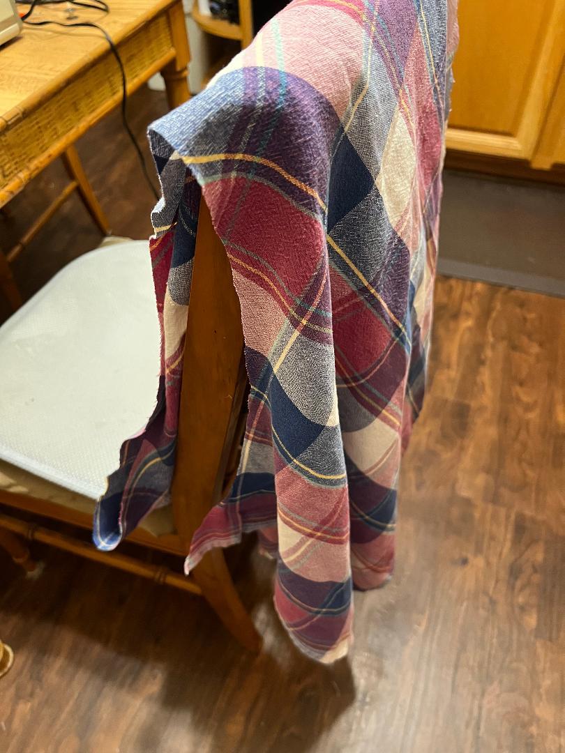

Step 8: Start the Bolero Jacket
Fold over the leftover material with the inside out. The back center of the bolero would be on the fold. I had seen the above idea for a pattern online. I lined up the folded bolero sweater with the side of the folded fabric as a guide. Pin together. I figured I would just outline what I wanted to make. Draw the shape of the bolero with the pencil on the material making it about an inch wider for the seam.
Step 9: Cut It
I cut along the line I had drawn and used the sweater as a guide to form the length of the bottom of the bolero. Since it was folded over, both sides match.

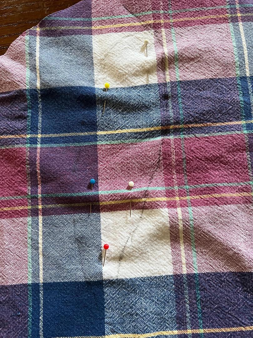

Step 12: Make Darts
While wearing the bolero, I pinned it to make darts at each side of the bust line to pull up the front sides of the bolero. Then I sewed the darts in place, being sure the darts were folded on the inside.
Step 13: More Darts
When I had the bolero on, it also needed 2 darts on the bottom back and 2 darts on the upper back. I measured how wide to make them while wearing the bolero and pinned all 4. I took it off then sewed the darts in place. The bolero was now form fitting and I was happy with the results.

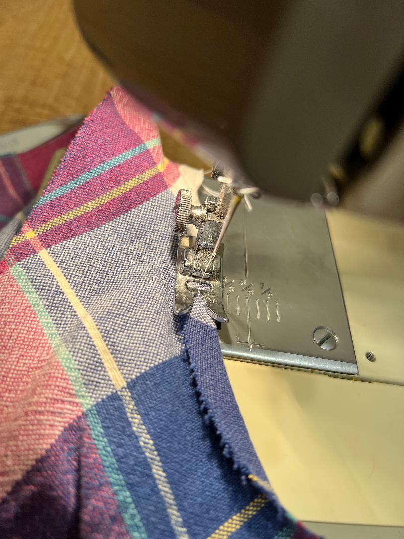

Step 14: Sew the Armholes
Fold down each armhole 1/4-inch while sewing them down on the inside of the bolero.
Step 15: Finish the Edges
Turn down remaining edges 1/4-inch and sew to finish off.

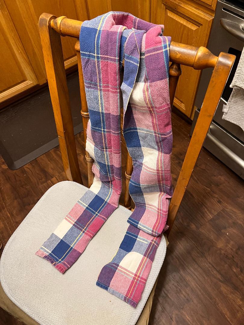

Step 17: Start the Sash
I measured a piece of fabric 5 inches across and 63 inches long.
Step 18: Sew It
Sew a 5/8 inch seam down the edge of the inside of the sash. Also, sew along one bottom edge. Pull the inside out so the seam is on the inside. Sew down the unfinished end, turning the edge to the inside. Push the finished sash through the belt loops of the shorts.
