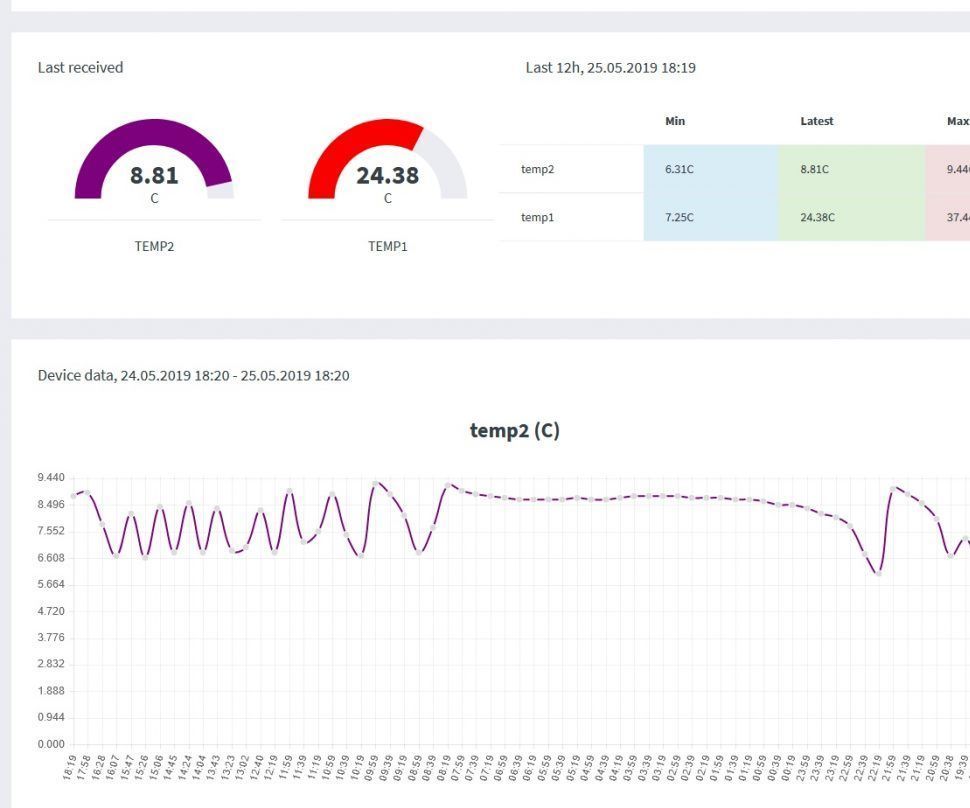

Step 4: Check Data on LoggingForest Platform
After that your device will start sending data to loggingforest and you can see it there
In loggingforest device edit just define parameters name and values as on screen 1
Click on preview as on screen 2
And you will see nice data as on screen 3
Feel free to comment and share your logger, my is visible on image 4
