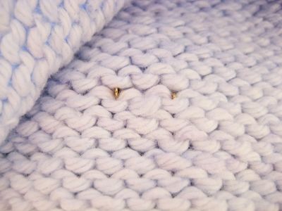

Set the end of one handle onto the bag where you want it to be. I set mine 3 inches from the outside edge. They need to be at least 4 inches from the top. Drop the prongs between knit stitches, being careful to to push them through the yarn because that will weaken the bag.

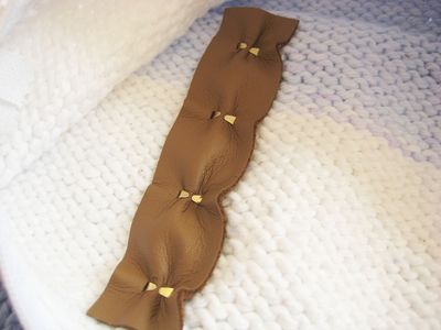

Adjust the prongs on the inside, then set one of the small pieces of leather over and now, finally, bend the prongs. You might have to smush down on the leather and knitting a bit to fold the prongs well.
Work your way up the rest of the studs. Use the vertical lines of knitting to keep the studs in line. The leather on the inside might not be perfectly flat but it's just there for support. Make sure no prongs are poking out because they'll catch on what you put in the bag, then repeat for the rest of the straps!
