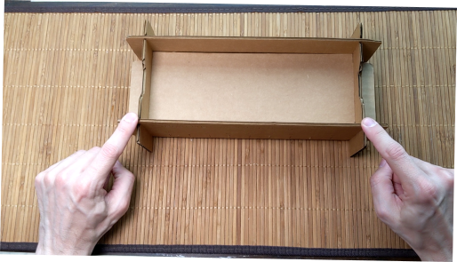

First make sure you have all the pieces: two long ones, two short ones, and one brace.
Got everything? Perfect. Slide a short piece at the end of the brace, and do the same on the other end of the brave.
Next let's put the sides together. Flip the loom over the tabs point up, then slide on a long piece of the loom and do the same for the other side.
Finally, flip your loom upside down: your loom is ready!

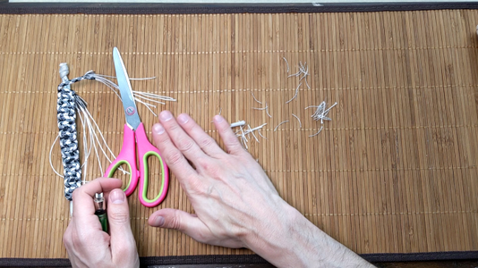

Melt the fraying ends of the paracord with your lighter, and once they're nice and melted squish them with the flat of your scissors' blades. Repeat with all the other unfinished ends!
