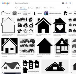

Search for a picture of your chosen background on an image search engine (I use Google). I find it is helpful to search ‘silhouette’ and ‘free’ along with your search criteria to find a black and white picture that will be easy to convert into a model. (see pic 1)
Once you have found a picture you are happy with download it as an image file and convert it into an svg file using a free online converter such as: https://image.online-convert.com/

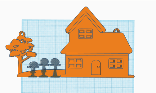

If you want different parts of the house to be in different colours, create a series of pictures filling in some of the details each time and convert each picture. (see pic 2)

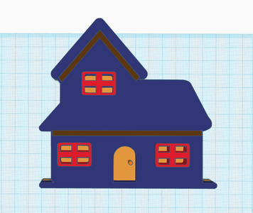

In Tinkercad, create a new design and import your svg files in. You may need to resize your models, you want your background to just fit onto your 3d printer bed, as big as it can be, mine is approximately 220mm wide.
If you have chosen to use several pictures to pick out different parts of your background in different colours change the heights of these pieces so that the one with the least holes is at the bottom. I sized mine from 6mm to 12mm high. Align all the pieces and make sure you can see all the features you wanted to pick out (see pic 1)
Now you need to create a plain area for the keychains to attach, I created a grassed area between my house and tree where my keychain people would stand. Make the height of this part different from the other parts, this is so that we can have it a separate colour. (see pic 2)

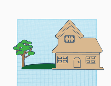

Import the people keychain files, attached here, to your tinkercad, adding one for each family member. Lay the keychains out on your background model to see how they will look and adapt your background model so that you can fit everybody on.
Once you are happy, import the ‘hole’ files for each keychain and place them on the background where the keychains are, then delete the keychains. Raise all your hole models by 2mm and group the holes and background.
