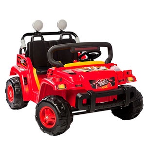

Santa brought a Power Wheels Jeep to my kids this Christmas. I was quite surprised that there was NOT a master ON/OFF switch on the thing. And of course, Christmas morning, the first thing my daughter did was hop in and try to run of her brother.
To charge the car, the manufacturer also wants you to unscrew 2 screws on the hood, unhook the battery from the motors, hookup the charger, leave it charging for 18+ hours, and reverse the process to put it all back together. This proves to be a giant pain.
