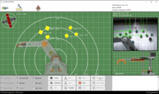

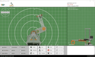

The control APP for MacOS and Windows is freely available and 100% OPEN. User guide here

- Google Blockly controllable
- Trajectory movement (you can add up to 20.000 trajectory points)
- Real Time control using your mouse or Xbox/PS4 controller
- Leap Motion gesture control
- Artificial vision control OPENCV (Use your webcam to tell the robot what to do)
- 100% OPEN SOURCE (Arduino control board and Python control code)
- Control it via USB or WIFI
- Smartphone/ Tablet control APP (for iOS and Android devices)

Controlling two rotational articulations
A SCARA type robot, beside its advantages has an inherent problem: how to properly control the motors so you can get good speed and precision drawing simple geometric figures achieving good repeatability. It is not a simple thing to draw on a paper a straight like with a SCARA. A Cartesian robot (like a regular 3D printer or the iboardbot) is way easier to control as you only need to spin its controlling motors shafts certain number of steps (you can add a reduction but that will not change the way the robot moves). But a SCARA pivots around two points, the "shoulder" and the "elbow". We have created a powerful yet simple algorithm of control. You can take a look at it already implement in Python here, in the "HOW TO CONTROL THE SCARA Robotic Arm. CODE"
With a good motor control algorithm, even with the arm completely extended, the SCARA Robotic arm can achieve a 0.2 mm repeatability accuracy.
