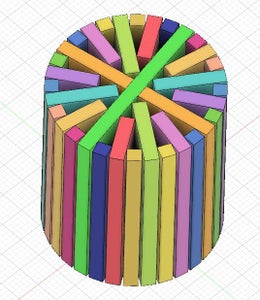

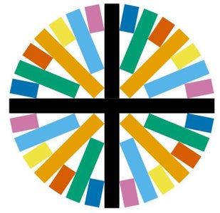

Step 1: Goal: 16 Interlocking Pieces
This photo shows a top-down view (from one of my original Inkscape trials) of what the end goal of this process is with 16 features aligned radially. Note that each piece (except the top one) is shown with a gap between its two halves but is actually connected lower in the stack with what I'll call a "tab".
The left side of the photo shows how the pieces are arranged at angles to one another:
  • Group 1: 1 piece at 0 degrees
  • Group 2: 1 piece at 90 degree angle to #1
  • Group 3: 2 pieces at 45 degree angles to #1 and 2
  • Group 4: 4 pieces at 22.5 degree angles to #1, 2, and 3
  • Group 5: 8 pieces at 11.25 degree angles to #1, 2, 3, and 4
If you notice a pattern between the number of pieces and the group that they're in, that will come up later!
The right side of the photo just shows the pieces color-coded (darkest to lightest) by their group.

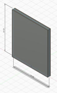

Step 3: Overall Dimensions and Slot Size
The plywood that I'm using for this project is 2.9mm thick, so I designed for that as it's important for the width of the slots!
I had a nice strip of 40mm tall plywood leftover from another project, so I figured I'd use that if I could! For 16 interlocking pieces, that means the thickness of the tab connecting the halves of each piece will be:
40mm tall / 16 pieces = 2.5mm tab
The width of each piece doesn't matter too much (as long as it's wider than the widest slot cut! See below for calculating), so I just made it an even 35mm wide.
So each piece with no slots cut in it will be 35mm wide x 40mm tall x 2.9mm thick with a 2.5mm middle connecting tab. The first photo shows a "full" piece with no slots cut in it.

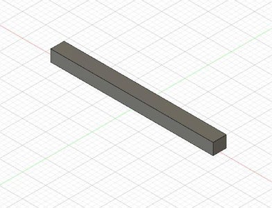

Step 4: Starting Small
EDIT/UPDATE!
I've played around with Fusion 360 more since publishing and would recommend using the extrusion tool rather than push pull in later steps as it allows you to more easily join new features to existing components rather than doing that as a separate process.

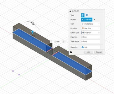

The initial sketch
Rather than starting with a full size (35mm x 40mm x 2.9mm) piece of the array, I found it was much easier to start with just a single section equal to the height of the tab that will connect the two halves of the pieces.
In my case, that tab will be 2.5mm tall, so my starting piece will be 35mm wide x 2.5mm tall x 2.9mm thick
I sketched this on the top plane as a 35mm x 2.9mm center rectangle with its center at the origin. The rectangle is centered on the origin so that rotating it about the Z axis in future steps will be simple.
The initial solid
The sketch is then Extruded to a distance of 2.5mm using a "One Side" extrusion. It's extruded to just one side because pieces in future steps will be mirrored across the top plane.

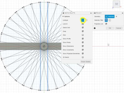

Step 5: Planning Ahead
To avoid having to create new rectangles using the equations shown in Step 3, we'll instead create a set of sketch geometries that can be used as references for future 3-dimensional features.
To do this, I created a new sketch which:
  • Copied the geometry of my initial sketch (using the "Project" sketch tool in the Create menu), and
  • Created a rotated array of additional rectangles using the Circular Pattern tool
  • Use "Angle" for Angular Spacing
  • Like many other programs, Fusion 360 includes the original feature in it's count when making arrays, so the Quantity should be 16.
  • The "Total Angle" is a bit tricky. You'd think it would be 180 degrees, but if we had the initial sketch rotated 180 degrees, it would just end up laying directly on top of itself. So instead, the "Total Angle" should be 180-11.25, or 168.75 degrees.
It definitely looks a little busy, but once you know what to look for later it's not too bad!

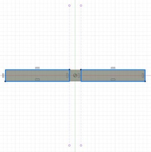

  1. Create a new sketch on the top face of the feature (right-click > Create Sketch)
  2. The next group is the 90 degree group, so we'll find the rectangle in the radial array of sketches that is at 90 degrees to the existing feature (you may need to turn on the visibility of that sketch)
  3. Click on the two long lines of the 90 degree rectangle (click + Shift +click) as shown in the second image.
  4. Click Create > Project / Include > Project
  5. Be sure to select Construction as the Linetype in the Sketch Palette as shown in the third image
  6. Hide the radial array sketch
  7. Draw two rectangles on the face of the existing feature (deselect the Construction Linetype!). It should be easy to snap them to the intersection between the projected geometry and the edges of the existing feature face (shown in fourth image)
  8. On the Modify tab, select Press/Pull
  9. Select the two rectangles as the profiles
  10. Distance should be equal to 2.5mm
  11. All other settings should be the default (as shown in the fifth image)

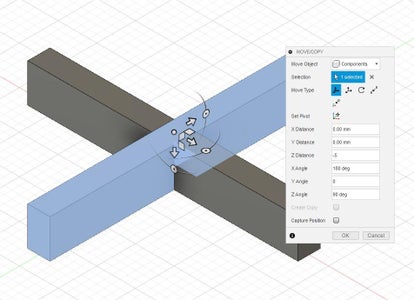

  12. Right-click on the body in the Browser panel on the left and click "Create Components from Bodies".
  13. This will turn the feature into a component. A component is needed because, as far as I'm aware, Fusion 360 will not let you copy and paste Bodies without them being linked. We'll need to make changes later that need to affect only individual pieces, so Components are necessary for that.
  14. Right-click on the newly created component in the Browser panel and click "Copy"
  15. Click somewhere in the main window (not on the component) or hit the Esc key to deselect the component
  16. Right-click anywhere in the main window and click "Paste New" to create a new component that's not linked to the original.
  17. In the Move/Copy menu that pops up immediately after you paste (shown in last image):
  18. Click on the icon next to Set Pivot, select the Origin (O) from the Browser panel, then click the check mark icon that is now next to Set Pivot.
  19. Change the Z Angle to 90
  20. Change the X Angle or Y Angle to 180
  21. Change the Z Distance to -5mm (2.5mm tab thickness x 2)
  22. The preview should show up to show you what it will look like! If that doesn't look right, you may need to change a few parameters, make sure you've selected the proper origin, etc.

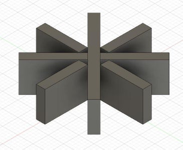

Step 8: Building Up Example - Group 3
As indicated in Step 1, Group 3 is made up of two components that are at 45 degree angles to Group 1 and Group 2.
It turns out that Group 3 is just a copy of the combination of Groups 1 and 2 (with the Press Pull sections created).
Follow the same process shown in Step 7, but create the rectangles using reference geometry from the 45 degree radial sketches instead of the 90 as shown in the first image. It doesn't matter which component you select to draw the sketch on, but you also need to select the outside edges of the face of the other one to Project sketch geometry as well, otherwise the rectangles won't snap to those corners.
The Press Pull distance for this one is now 5mm, because that's the total height of Groups 1 and 2 combined. If by chance the Press Pull doesn't join each new section to its original component (as it did with mine a couple of times and I'm not entirely sure why...) you can use the Combine tool to merge your target body (original component) and tool bodies (the newly Push Pull-ed bodies).
The attached images show Groups 1 and 2 with their extended sections (image 2) and Group 3 created, rotated, and translated (image 3).
