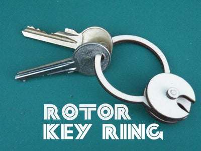

Many moons ago, I saw a picture of an old (possibly centuries old) brass key ring that kept the keys in place with rotating discs.
After a long time of the idea noodling around in the back of my head, the construction suddenly clicked, and (after a few iterations), this is the result.

I cut the key ring from 3mm plywood, and used a piece of 3mm thick bamboo dowel for the axle, and a drop of wood glue.
The files you need to cut your own are all attached to this step as well, so you can cut your key ring out of whatever materials you like, with whatever tools you like.
Step 2: Assembly
When you have cut your pieces, press one of the small pieces onto the bamboo dowel. The ring is sized to be a snug friction-fit.
Then slide on the first of the notched discs, then the main loop, then the other disc and the last small ring.
As you can see, the axle was far too long to be useful. I roughly trimmed it, then marked it more carefully before dismantling the keyring and trimming the axle to the right length.
I reassembled the key ring, this time with a drop of glue to hold each of the rings on the axle (be careful not to glue the notched discs onto the axle - they need to turn freely).
