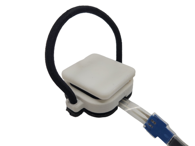

The housing for the weight sensory extension is printed in five parts: a bottom plate, a button, the button platform, a top plate (remix of ixp's design), and an elastic band. The unit's top, bottom, and button files are printed in PETG, and the platform file is printed in TPU. The force sensor is glued to the bottom plate, and the elastic band is threaded through the top and bottom plates to secure everything together. The button is placed inside the top plate and then the platform is fit-pressed into the button.
To connect the sensor to the microcontroller, we used a standard hookup for a force-sensitive resistor and connected the sensor to the expansion board using around 500mm worth of wire. Upload the .ino code file for the corresponding control unit and look at the values in the serial monitor. If everything is working correctly you can then connect to the sim and make ratios by holding objects of different weight.

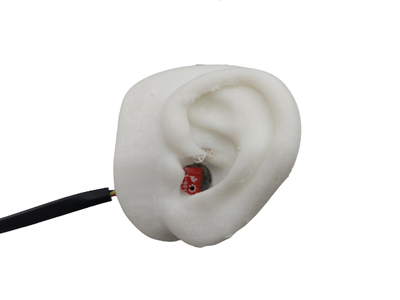

The ear (a remix of printable_models' design) can be printed in either TPU or PETG (depending if you want a squishy feel) and the MEMs microphone is secured in the ear with hot glue and sticky-backed velcro. To be able to detect a higher range of frequencies (up to 21k) we need to connect the mic to an op-amp to amplify the signal. The mic and op-amp hookup can be seen in figure 3, I also recommend using at least 800 mm worth of wire so that the mic/ear can be worn on different parts of the body. After soldering, upload the code and check that your device is working properly by using a tone generator to measure the frequency in the serial monitor.

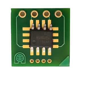

Once you have the GMR sensor and PCB, solder them together using the same orientation as shown in figure 4. It's super important that the sensor is placed correctly! Then make the connections between the sensor/PCB and microcontroller using around 400mm of wire. The finger sleeve (a remix of ZackFreedman design) is printed in TPU, and the sensor/PCB slides inside. Test the device by opening the serial monitor and holding the sensor near an object with a magnetic field, the values should get higher as you get closer to the field.

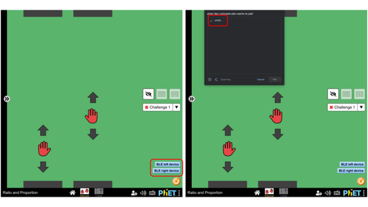

Once you have two sensory extension devices (two sensors & two microcontrollers) you're now ready to connect to Ratio and Proportion! First, select either the "BLE left device" or "BLE right device" and then a dialog box should open in the top left of the window, then select either the "nrf52L" or "nrf52R" and press "pair". Repeat the process for the other side, and now both sensory extension devices are connected to the sim. Have fun making ratios!
