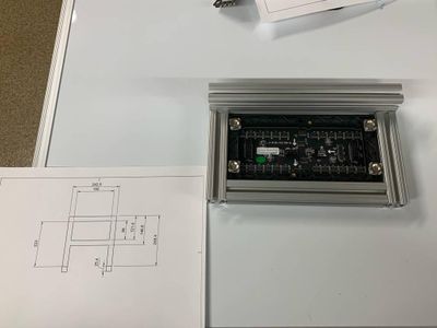

Measure, Measure, Measure.
You will hopefully have built and tested your display system. This is great because you can measure actual components. So, layout the working system, test it, unplug it and grab a ruler.

The way we approach this step is to unplug the LED panels. Attach the little magnetic feet that hopefully came with your panels and attach them to a convenient metal surface (White boards work great). Arrange the panels in the configuration they will be used. When you have settled on a configuration, push them together as close as you can. (pushing them against a long piece of scrap 8020 or a carpenters framing level helps.) Measure the dimensions and write them down. Now go away and do something else for a couple of hours. When you come back measure it again. Write the numbers next to the first set. They should be the same. These are now the input set of numbers for our cut calculations. (Make sure that you use the same ruler, meter stick or tape measure for all your measurements. )

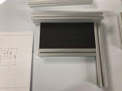

Ok, so now we measure everything again. Depending on your design, you will have a list of all the lengths of the extrusions you will have to cut in the next step. ( You can also use the list to order the extrusions pre-cut and taped from a manufacturer and skip the cutting yourself. )
You may wish to pre-mark the cut lines in order to compare them with your design before cutting. This dry fitting before cutting is a check on the overall measurements for your design. It may expose problems with your measurements before the extrusion is clamped into the saw.
If you are use re-cycled or scrap material, it is useful to lay the pieces out against the panel so you can see different possible configurations. You also want to check the ends of the extrusions to insure that you can make a flush connection.
In the example photos above we started with an intended build plan and modified it as we found pieces of extrusions in the scrap pile.

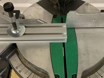

Cut the extrusions to length. Good practice here is to dry fit the pieces as they come off the saw.

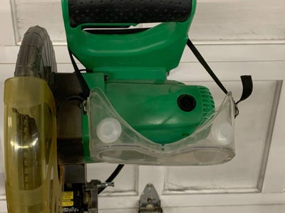

You may wish to read other Instructables to learn about how to cut Aluminum extrusions.
Ours can be found at: https://www.instructables.com/A-Simple-Method-to-...
