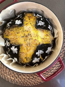

    - add other ingredients for a specific flavor (pull-apart garlic bread)

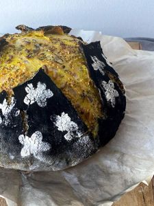

    - play with colors and decorate the loaf with bread stencil.

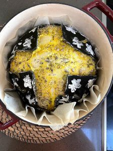

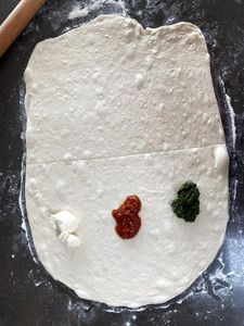

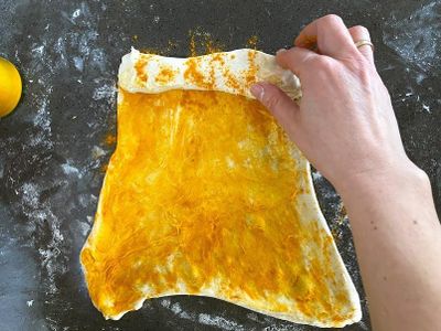

    Please note that further ingredients needed to make the trickier breads (from pic.3) are listed along with the specific instructions, so read first, before jumping into making the recipes.

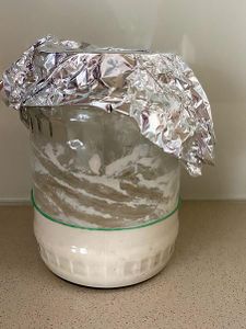

    Step 1: ​Refresh Starter 1.
    Before you start to make the dough, you need to refresh the starter ie. give it a boost of energy by adding twice its quantity of flour and water to get it ready to raise the dough.
    You’ll need:
    • clean jar
    • mature starter
    • strong white bread flour
    • water (room temperature)
    [If you do not use your starter regularly it may need to be refreshed twice to get nice and strong. In this case, take the stock starter out of the fridge at 10 pm (Day 0) and follow the same process as written below.]

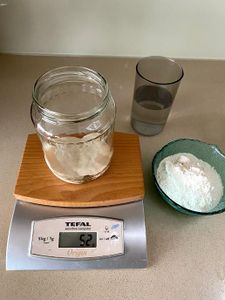

    8 am (Day 1)

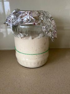

    Measure 50 g starter, 100 g flour and 100 g cold water into a clean jar, mix well and let it sit – loosely covered with a lid on the counter at room temperature. Regarding consistency, it should be denser than pancake batter, check video.
    (Discard the rest of the stock starter or save it for making crackers for instance.)
    Step 2: ​Refresh Starter 2.

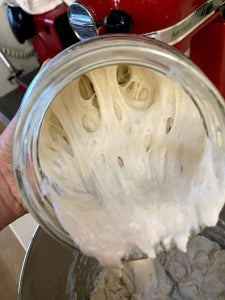

    You will experience a significant change in the volume and the structure of the starter, its volume will double (at least) and it will get bubbly (you can see the holes in picture 3).
    As for how long it takes, my experience is that it is ready to go into the dough within 5-7 hours after being refreshed. However, actual time may depend on the strength of the starter (how old it is and how often it’s used) and also the surrounding temperature.
    If you are unsure about whether the starter is ready, place a spoonful into cold water, it should float (pic.5.).
    Please note that when the starter runs out of food it will start to fall, which means that it loses its strength and may not be active enough to raise the dough.

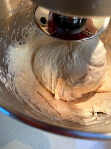

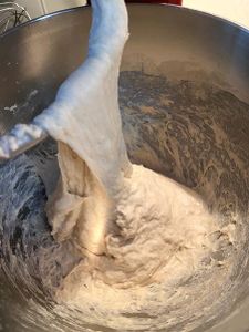

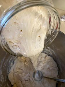

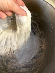

    Add the starter to the flour and water mixture and knead with the stand mixer equipped with a dough hook attachment at low speed twice for 2-3 minutes with a one-minute break in between.
    Add salt (salt and wild yeast do not get on well, therefore I suggest to let the starter work itself into the dough first and add salt only at this point). Knead for another 2 minutes.

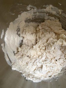

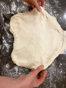

    Now, it is very important that not all flours are exactly the same, some may require a little more water. What we are aiming at is a dense but not too stiff dough. If it climbs on the dough hook and stays feel free to add another tablespoon of water or two. I think the ideal consistency is when part of the dough starts to climb on the dough hook but slides down relatively easily when lifting the mixer head. At this stage the dough may feel sticky, it is completely normal, it will lose its stickiness as you proceed.
    In picture 2 you can see the threads of gluten already developing in the starter. These threads will support bread structure and will enclose gas developed during fermentation.
    In the last picture you can already see that the gluten is holding firm, you can stretch the dough without breaking it (aka gluten test).

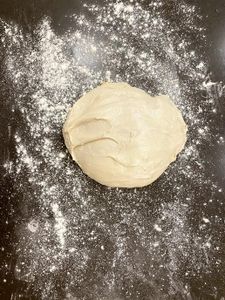

    Step 5: Knead by Hand

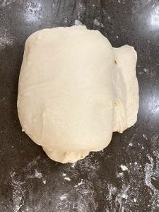

    Dump the dough onto the lightly floured countertop. Lightly oil a bowl (you may also use the same mixing bowl).
    There are various methods how to knead bread, my preference is the so called slap and fold method in which as the name suggests, you slap the dough on the counter then fold it (see video) repeating the process for a while. I usually count them till 100.
    Another method is classic kneading, that is pushing the dough forward with your palm, then lifting it back with your fingers and turn (check out the video here (step 2.).
    Finally, form the dough into a ball, put it into a lightly oiled bowl, turn the dough do that it is covered with oil all around, cover with a kitchen towel and let it sit for about 45 minutes.

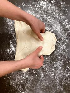

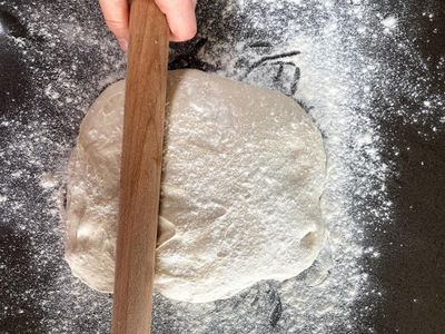

    Step 6: Folding
    First of all, what is the purpose of folding? Stretching the dough and folding it back into itself helps to equalize dough temperature, trap air into the dough (you will see more and more bubbles developing after each fold) and helps to strengthen the dough (so that it will not flatten out when removed from the banneton before baking).
    Please note that these times are not set in stone, the rule of thumb is that the dough should have a rest of 30-60 minutes between every two folds and 90 minutes following the last fold.
    4:00. pm - First fold

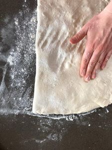

    Dump the dough onto the lightly floured countertop and stretch it with your hands into a rectangle (actually it may be stretched into an unexpectedly large rectangle: roughly 50x70 cms).
    Fold the dough from the short side like an envelope (three – fold), turn it 90 degrees so that once again it is the short side close to you. Fold it in three from this direction also (or roll it like a cake roll), then put it back into the bowl (covered) and let it rest. You may have to add another tablespoon of oil into the bowl to prevent sticking.
    4:45 pm - Second fold
    Repeat the process written above (from this folding on I always make three-fold from one direction and then rolling from the other).
    As the dough gets stronger, you will not be able to stretch the dough as much as the previous time.
    5:30 pm - Third fold with the same technique
    6:15 pm - Fourth fold with the same technique, transfer it back into the bowl, cover and let it rest for 1.5 hours this time.

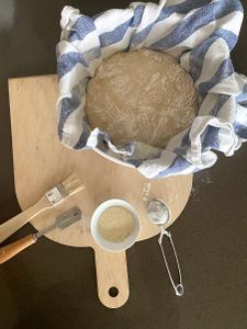

    Prepping banneton:
    Line the banneton with a kitchen towel, dust generously with flour. Especially when you start making bread it is always better to add too much flour than not enough.

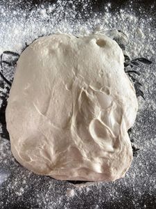

    1. Flip the dough from the proofing bowl onto a lightly floured countertop.
    2. Spread it out gently to form a rectangle(ish) form,

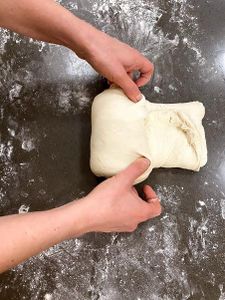

    3. Fold the longer left side of the dough a little over the middle, then fold the longer right side on top.
    4. Fold down the dough starting from the top as if you were rolling it.
    5. With both hands or with a bench knife tuck and drag the towards you a couple of times turning the dough in between to create tension on the outside of the dough.
    6. Place the dough seam side up into the (kitchen towel lined and floured) banneton. Should the seam split, pinch it together with your fingers.
    7. Dust the sides and the top of the dough with flour and fold the kitchen towel over.

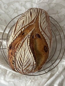

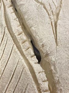

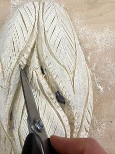

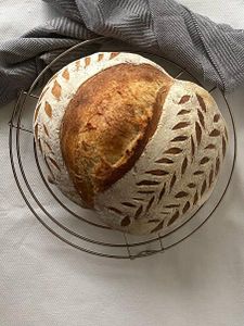

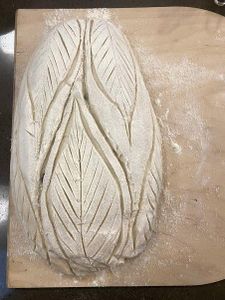

      Step 9: Scoring - Theory

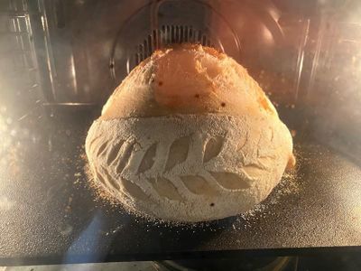

      Scoring has two main purposes, firstly it helps to control the enormous expansion when baking ie. the bread is more likely to open up along scored lines rather than just erupting like a volcano wherever it happens to be the weakest.
      Also, scoring is fun, and we end up with a more beautiful loaf.

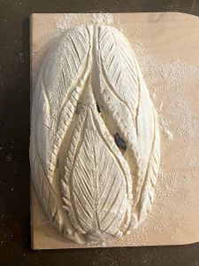

      In accordance with the above, there are actually two kind of cuts:
      1. I strongly suggest to make at least one deep cut minimum 15 mm deep to help set the direction for the bread where to expand in the oven. First I was afraid that making a deep cut would ruin the structure of the dough, but along the way I learned that it actually does not.
      2. Decorative cuts are totally optional. They should be less deep, but you should still cut through the skin slightly. These cuts could actually have different depths depending on to what extent you are expecting them to open up while baking. This is something you'll learn by experience!
      Tips:
      1. The sharper the tool you use for scoring, the better. At the beginning, I borrowed a precision cutter from my hubby, then I bought a lame.
      2. Start off with a simple slash or cross, and get on with more elaborate designs later on. Gain experince with practice and find your style.
      3. When you make decorative cuts, I suggest to make a scratch to mark the place of your deep cut first, then do the decorative scoring, then cut deep along the pre-marked line. The reason for this is that the deep cut opens up faster, so you don't have to worry about your bread losing its shape while fiddling with the decor.
      Step 10: Scoring - Practice
      Remember that the oven should be pre-heated to the highest temperature at least 50 minutes prior to the start of baking!
      You'll need:
      • formed dough
      • cornmeal/ semolina flour / rice flour (1 handful)
      • peel (or a rather thin yet sturdy wooden board)
      • brush
      • small sieve / tea strainer
      • lame / extremely sharp knife (you can also use scissors to make cuts)
      Instructions (video tutorialavailable):
      Dust the peel with cornmeal to avoid the dough sticking to it. Note: If you are planning to bake the bread in a Dutch oven, transfer the dough on a piece of parchment instead. Otherwise it would be impossible to place the dough into the burning hot pot.
      Gently turn the dough - holding it back with one hand - onto the dusted peel.
      If there are lumps of flour on the surface of the dough, remove them with a brush.
      Dust the dough in an even, thin layer with flour. Dusting will help the pattern stand out.
      (Mark the line where the deep slash will go and make the decorative cuts. - Optional)
      Make at least one deep slash in the dough.

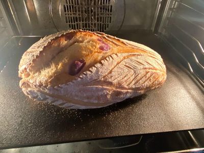

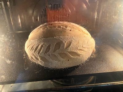

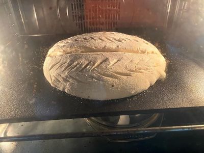

      Step 11: Bake
      After proper pre-heating ...
      Version A/ Baking Steel or stone
      Slide the dough onto the baking stone from the peel.
      Toss a few ice cubes into the bottom of the oven.
      Bake at 250 degrees Celsius for 20 minutes, then open the oven door for a couple of seconds to let the steam out, lower the temperature to 210 degrees Celsius and keep on baking for another 15-20 minutes depending on your oven. You know that it is ready when you hear a hollow sound when you tap the bottom of the loaf.
      Version B/ Dutch oven

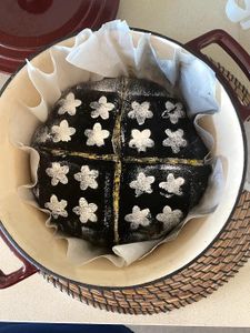

      Using oven gloves, take the Dutch oven out of the oven, lift the lid, gently lower the dough with the parchment, put the lid back on and place the Dutch oven back into the oven. Probably no need to say, but the door of the oven should not be left open while the dough is being transferred into the Dutch oven.
      Bake at 250 Celsius for 20 minutes, then remove the lid of the Dutch oven , lower the temperature to 210 and keep on baking for another 15-20 minutes depending on your oven. You know that it is ready when you hear a hollow sound when you tap the bottom of the loaf.
      You can see in the picture that a cosiderable growth in volume takes place in the oven. This is the so called oven spring.

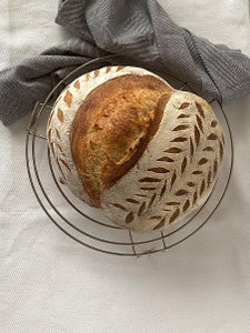

      Step 12: Done
      I guess here comes the hardest part of the process, to wait till your loaf cools before you get to eating it. :-)

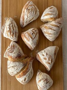

      Step 13: Variations - Rolls
      Follow the process until step 8. then:

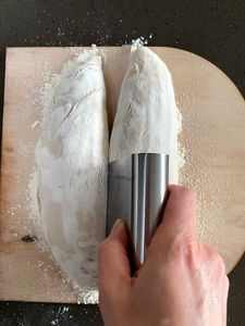

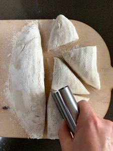

      Turn the dough out onto the dusted peel.
      Cut the loaf with a dough scraper / sharp knife.
      Score if you wish.
      Bake for 10 minutes at 250 Celsius then lower temp to 210 and bake until golden brown (10-15 minutes).

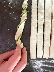

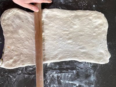

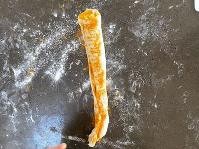

      Step 14: Variations - Grissini 1.
      You'll need:
      • 2 tablespoons cream cheese
      • 1 tablespoons pesto
      • 2 tablespoons tomato sauce

      2. Next day, dump the dough out on a lightly floured surface (pic 3.).
      3. Roll it about 5 mm thin with a rolling pin (pic 4-5.).

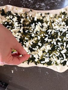

      1. Leave one half of the dough empty and spread the cream cheese, pesto and tomato sauce on the other half (1/3 of the area each, pic 1.).
      2. Add olives on top of the tomato sauce then scatter shredded cheese all over (pic 2.).

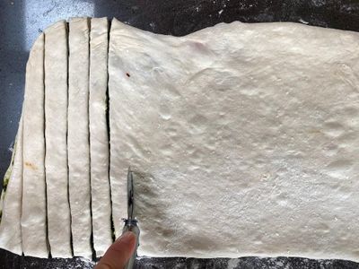

      4. Cut into strips with a pizza cutter (pic. 6.)

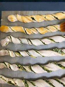

      5. Twist each strip and line them up on a baking tray lined with silicone mat (pic 7.).
      6. Apply egg wash (pic 8.)

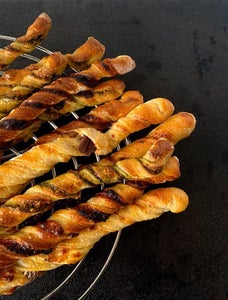

      7. Bake them in the preheated oven at 180 Celsius for about 12-15 minutes until they get golden brown.

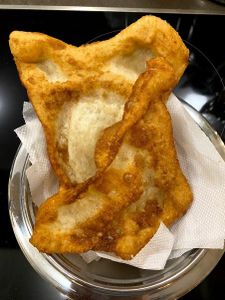

      5. Stretch a piece of dough by hand and dump it into the hot oil. It is very important that the oil should be hot, otherwise lángos will soak up lots of oil and that's no good.
      6. Fry on both sides until golden brown.

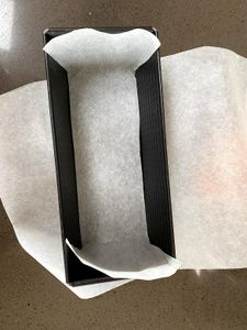

      • 30 x 10 cm loaf form
      Instructions:
      1. Follow the process until step 6., and after the fourth fold place the dough in an oiled bowl covered with clingfilm into the fridge for at least overnight.
      2. Next day, line the mold with parchment paper.

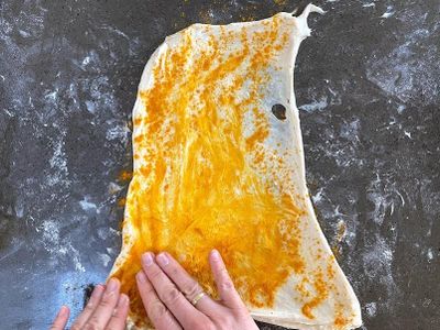

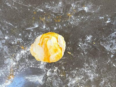

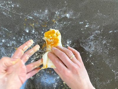

      1. Cut off about 1/5 - 1/6 of the dough and color it with turmeric: stretch it apart, dust with turmeric, rub it in slightly, roll from top to bottom into a rope, then dust with a little more turmeric and roll across into a ball.
      2. Practically, you are also coloring the small dough along with the first fold. No big deal.
      3. Place it into a small oiled saucer and cover.
      4. Make the first fold also with the rest of the dough (white dough).
      5. Make the second, third and fourth folds with both the white and the yellow doughs separately with the necessary rest in between folds as described in step 6.

      Step 21: Score and Bake
      Next day, gently turn the dough out onto a peel dusted with cornmeal or covered with parchment.
      Dust the outside with the rest of the charcoal and rub it in slightly.
      Apply a design if you wish.
      Using a bread stencil is a great way to decorate bread, just lay it on top of the bread, dust with flour and remove.
      Then make at least two cuts (a cross) on the outer dough, this way it will open up when baking. Bake according to the instructions detailed in step 10.
      This time I used a dutch oven. The first photo shows the raw dough just placed into the sizzling hot pot, the second, half - way baked (lid just removed), the third ready baked.
