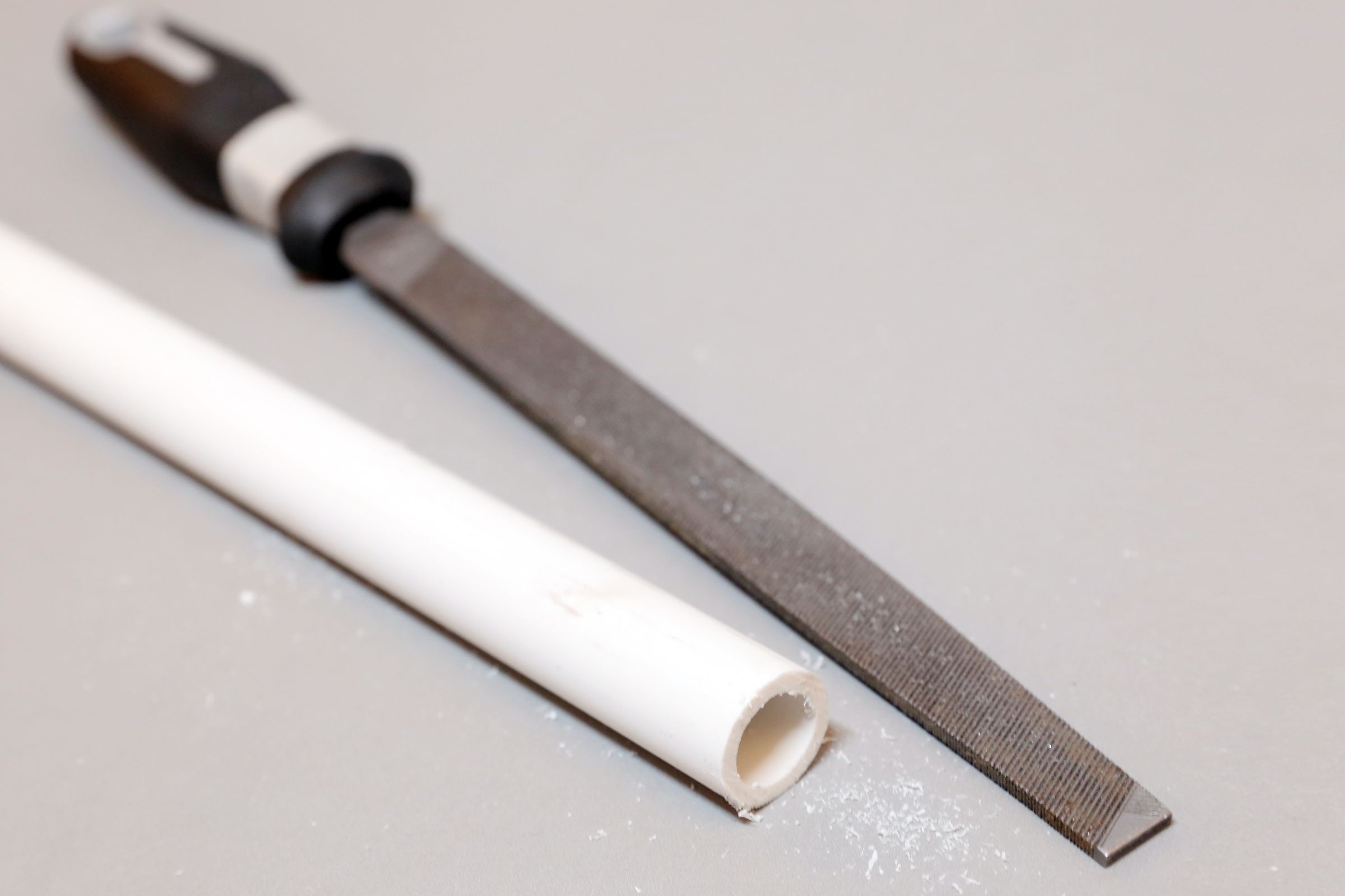

The cut ends can be cleaned up with a file. Cleaning the ends removes burrs and makes for a smoother interface when we cement the pipe to the connectors later.

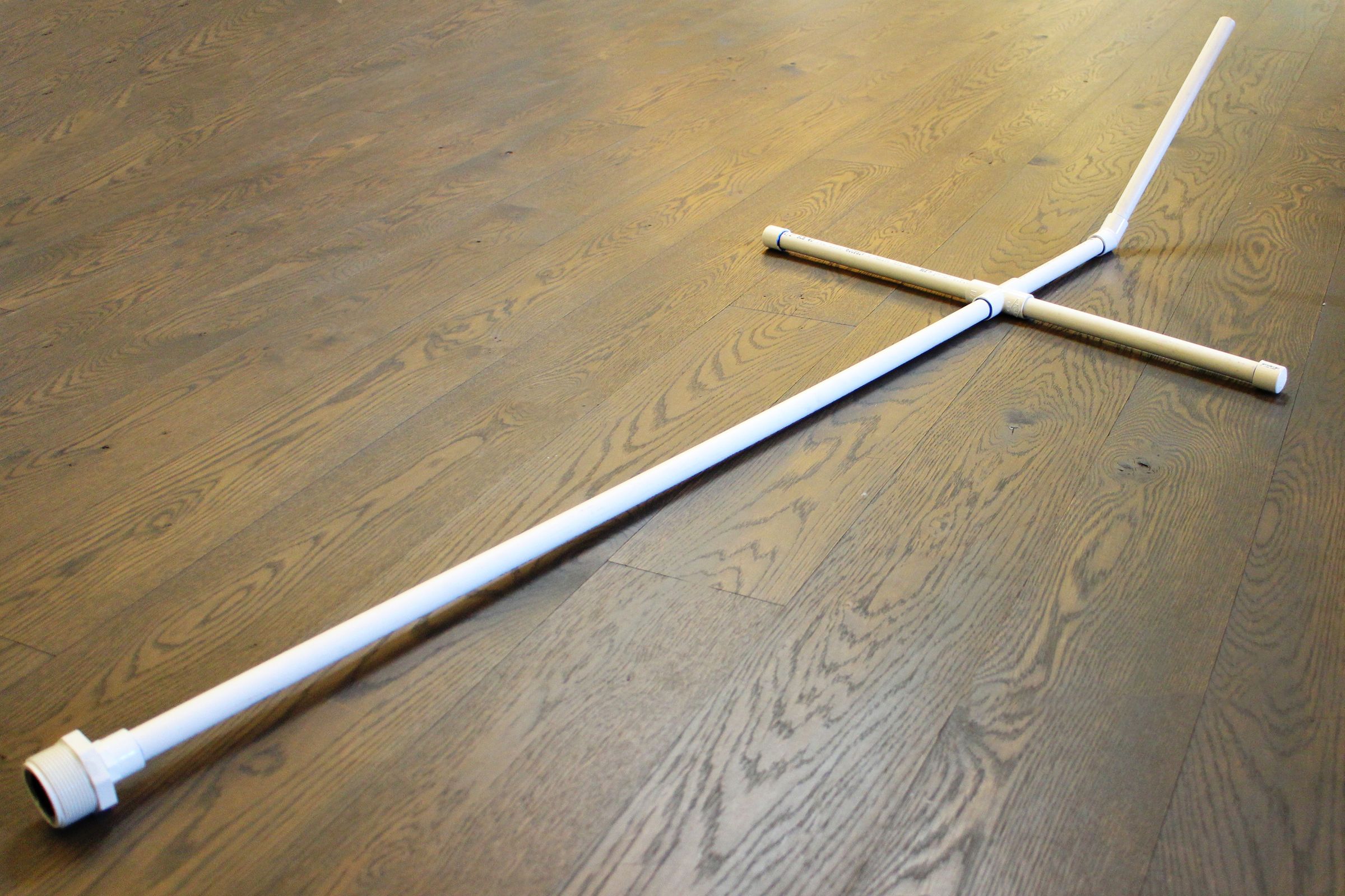

Below is the basic launch apparatus we're going to make. You can probably determine how to make it just from looking at the image, but I'll walk you through the process.

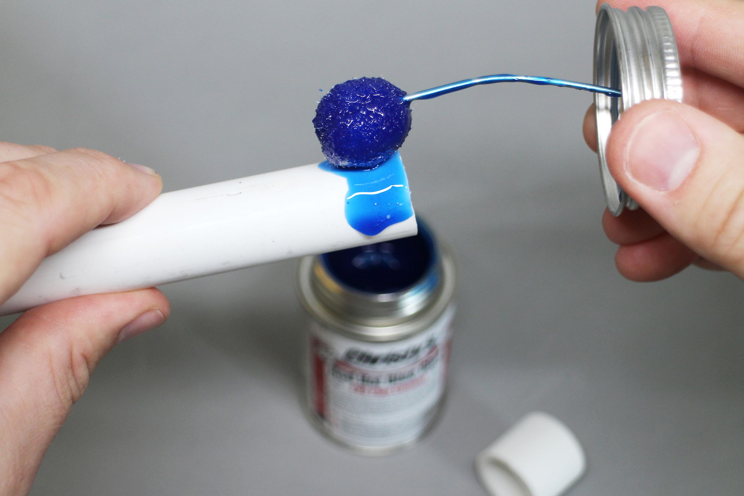

Before starting any cementing, it's a good idea to make sure you're working in a well ventilated area and on a work surface that's protected. PVC cement is a solvent, and dyed a very nice deep blue, so it will stain everything from both the dye and the chemicals in the solvent. Be careful!
Opening the PVC cement you'll see that there's an applicator brush attached to the underside of the lid. This is very handy. I like to apply the PVC cement over the bottle, that way any drips will make it back into the bottle and hopefully not make a mess.
Starting with the end caps and the two 12" PVC stabilizer sections, remove the cement lid and use the applicator to brush on about a 1/2" band of cement around the entire circumference on one end of one of the PVC stabilizer sections. Working rapidly, use the applicator to brush the inside of one end cap. While the cement is still wet quickly insert the cemented end cap onto the cemented end of the PVC pipe and twist until the cap cannot be pushed any further on the end of the pipe.
The twisting action will help distribute the solvent and ensure a tight bond between the two PVC pieces. The cement only take a few seconds to completely harden; set aside the cemented PVC stabilizer and repeat the process with the other stabilizer section and end cap.

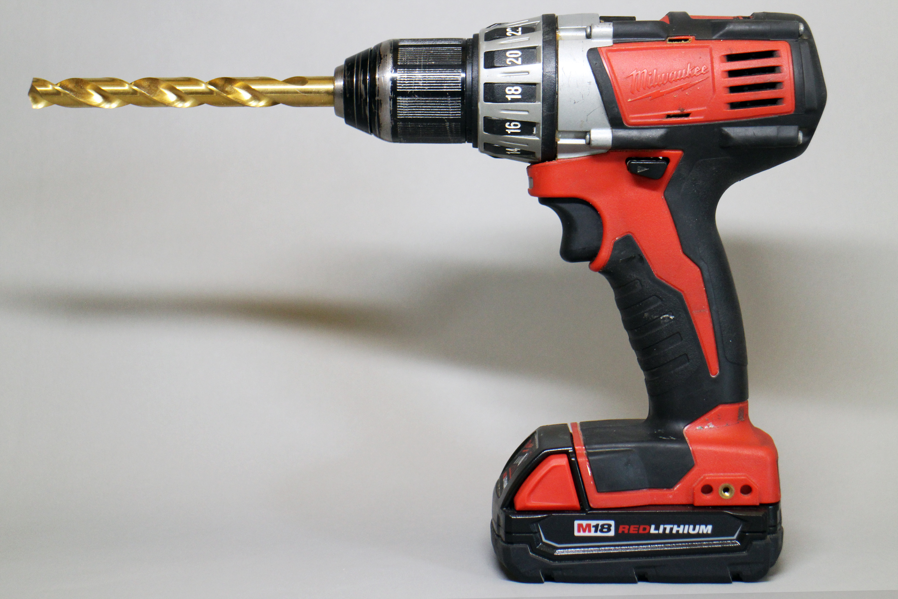

Step 7: Bottle Interface

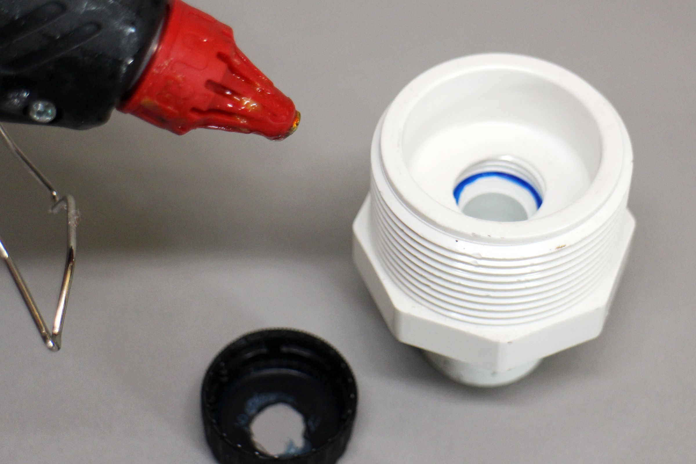

To get the air from the plastic 2 liter soda bottle through the cap and into the PVC apparatus, there needs to be a hole in the cap that will allow the air to pass through.
Using a ½" drill bit in a power drill, an opening was made in the middle of the plastic bottle screw cap. Instead of clamping down the cap, I found it easier to drill the opening while the cap was still on the bottle.

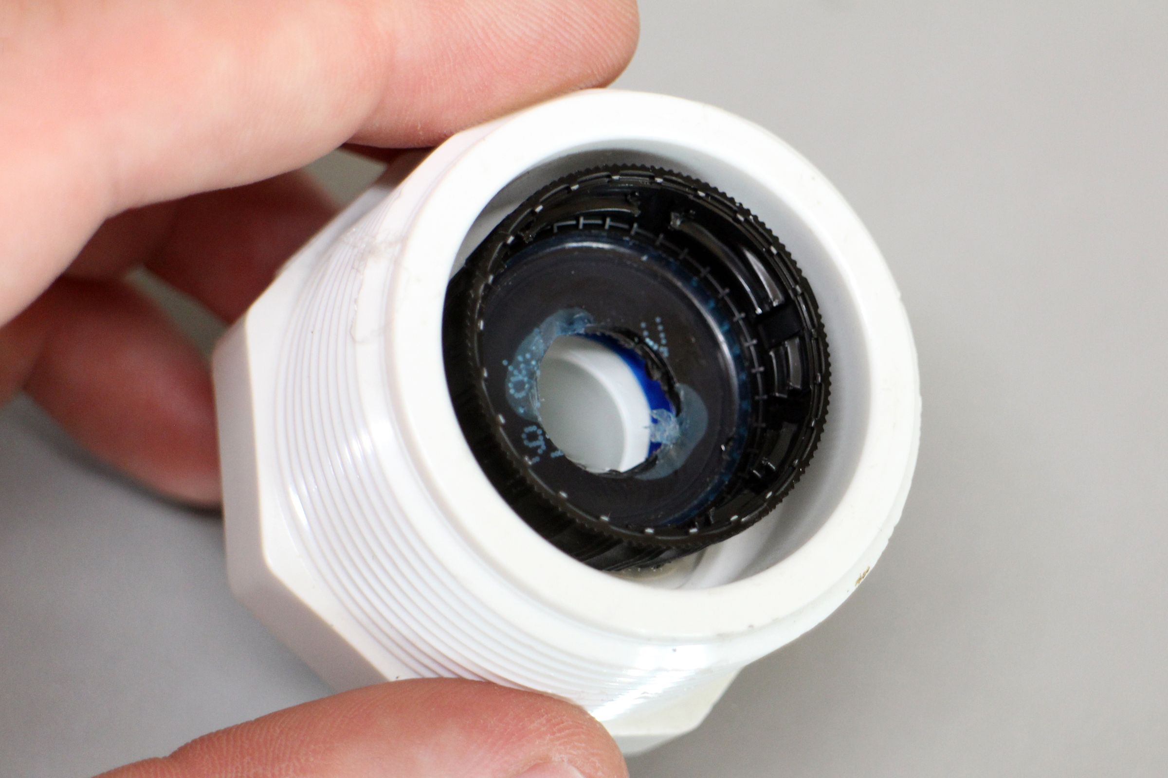

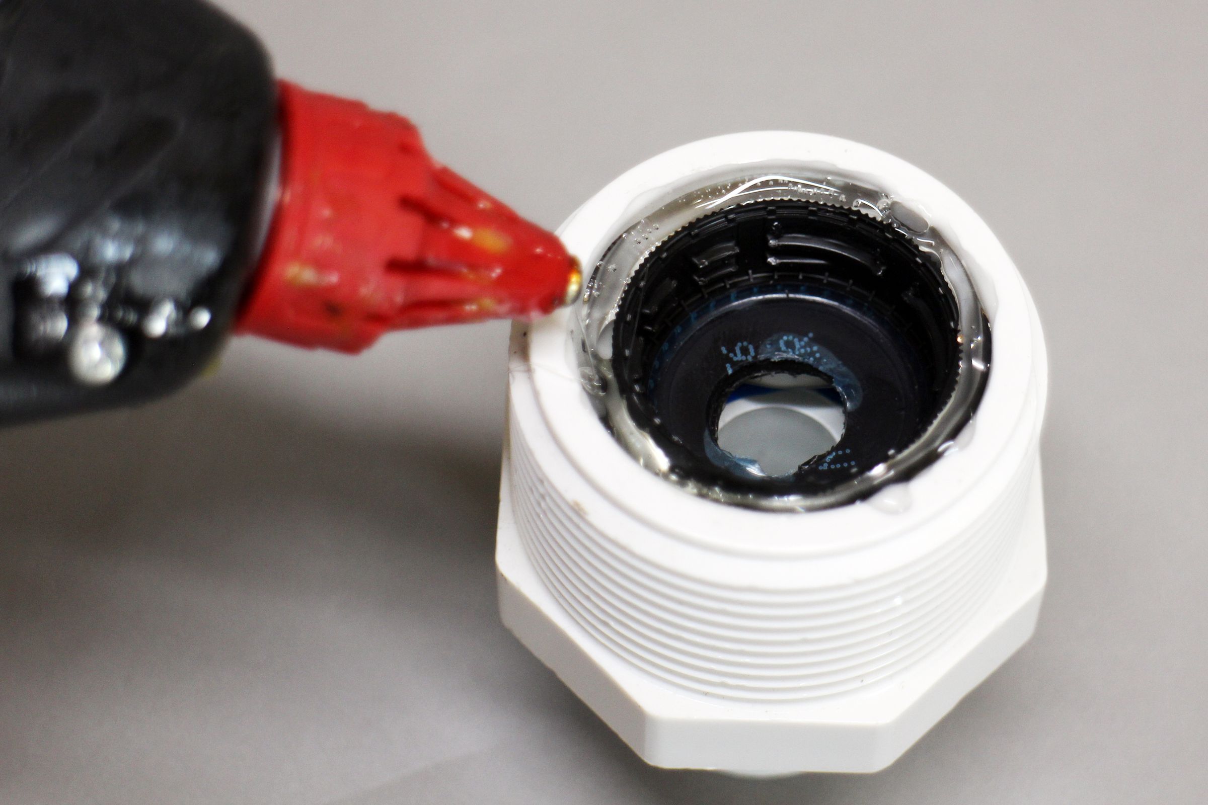

Once the hole in the cap has been made, remove the cap from the bottle and set the bottle aside. Warm up the hot glue gun and apply a generous bead of glue to the inside of the 2" PVC connector. Be careful not to get any glue inside the 1" opening, only around it.
Place the drilled plastic bottle cap into the 2" connector and line up the drill opening with the 1" opening at the bottom of the connector. Hold firmly in place until the glue has cooled and securely holding the cap in place.
To ensure a good seal between the plastic cap and the PVC, and to prevent the cap from accidentally being blasted out of the 2" connector, more hot glue was inserted between the outside of the bottle cap and the inside of the 2" connector.
Step 8: PVC Glue - Bottle Connector

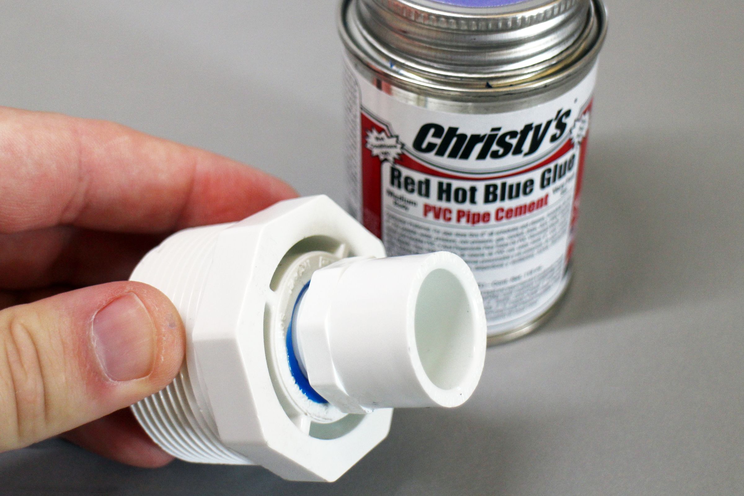

The final piece of the launch assembly is the connection between the apparatus and the bottle that will be the bladder that forces air through the PVC tube.
Our PVC pipe is ½" in diameter, and the soda bottle screw cap is about 1-¼", so we'll need a way to connect this cap to the rest of the apparatus. Since PVC pipes come in all kinds of diameters there are a whole host of connectors and reducers that help us solve this problem. What we need is a connector that is large enough on one end to accommodate the 1-¼:" plastic screw cap and then reduces down to the ½" diameter of the pipe we are using.
At my hardware store I could find a 2" to 1" reduction connector, which took me part of the way to my ½" goal. Then I used a 1" to ½" connector so the bottle could connect to the rest of the assembly.
If your PVC connectors are threaded, PVC cement will work just as well. Cement was brushed onto the threaded interior of the 2" to 1" connector and then threaded end of the 1" to ½" connector. The two components were quickly screwed together as far as they could go before the cement set and seized the two pieces together.
Step 9: PVC Glue - Bottle to Air Tube
With the cap installed in the bottle connector the last component can be installed on the launch apparatus.
Using more PVC cement glue the ½" opening of the bottle connector to one end of the 40" air tube section of ½" diameter of PVC tube. Then, connect the other end of the air tube PVC section to the last opening of the 4-way splitter with stabilizer arms.

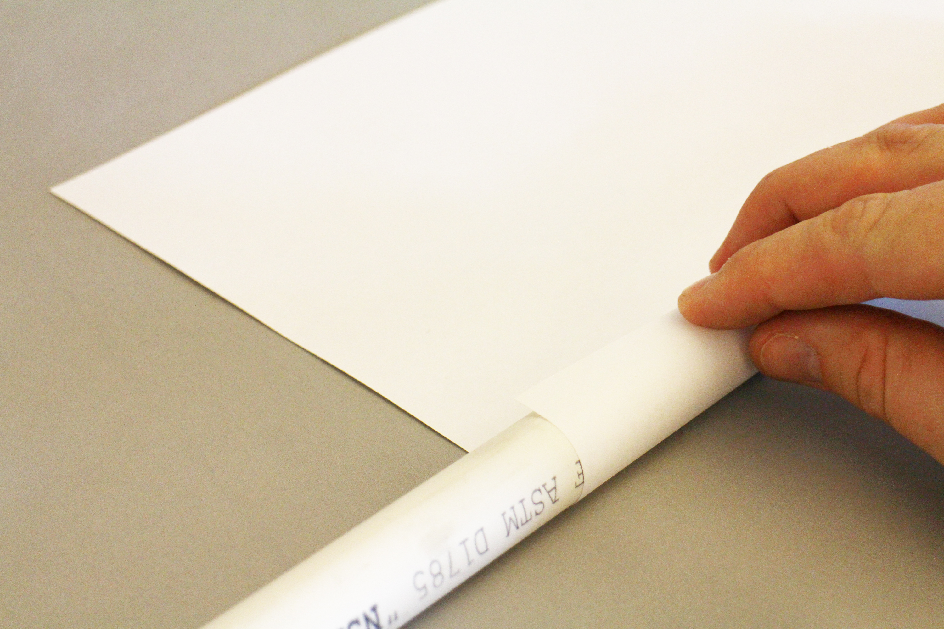

Before we start rolling the decorated rockets on the PVC, we need to first roll a blank sheet of paper onto the PVC rocket forming tube. Roll one sheet of printer paper lengthwise onto the PVC pipe and tape it in place.
This sheet of paper will increase the diameter of the PVC, allowing the rockets we roll onto it to be slightly larger than the bare PVC pipe of the firing tube on the rocket launch assembly. This will make it easier to slide the paper rockets onto the pipe.

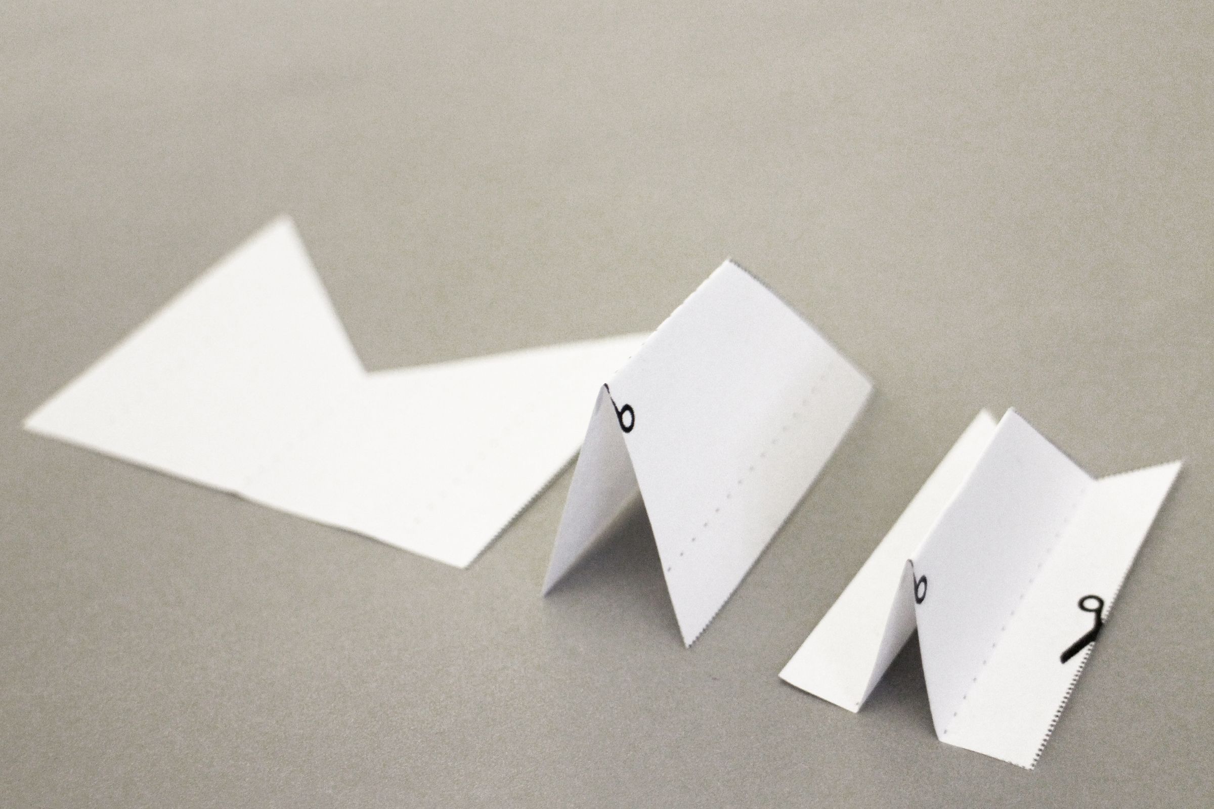

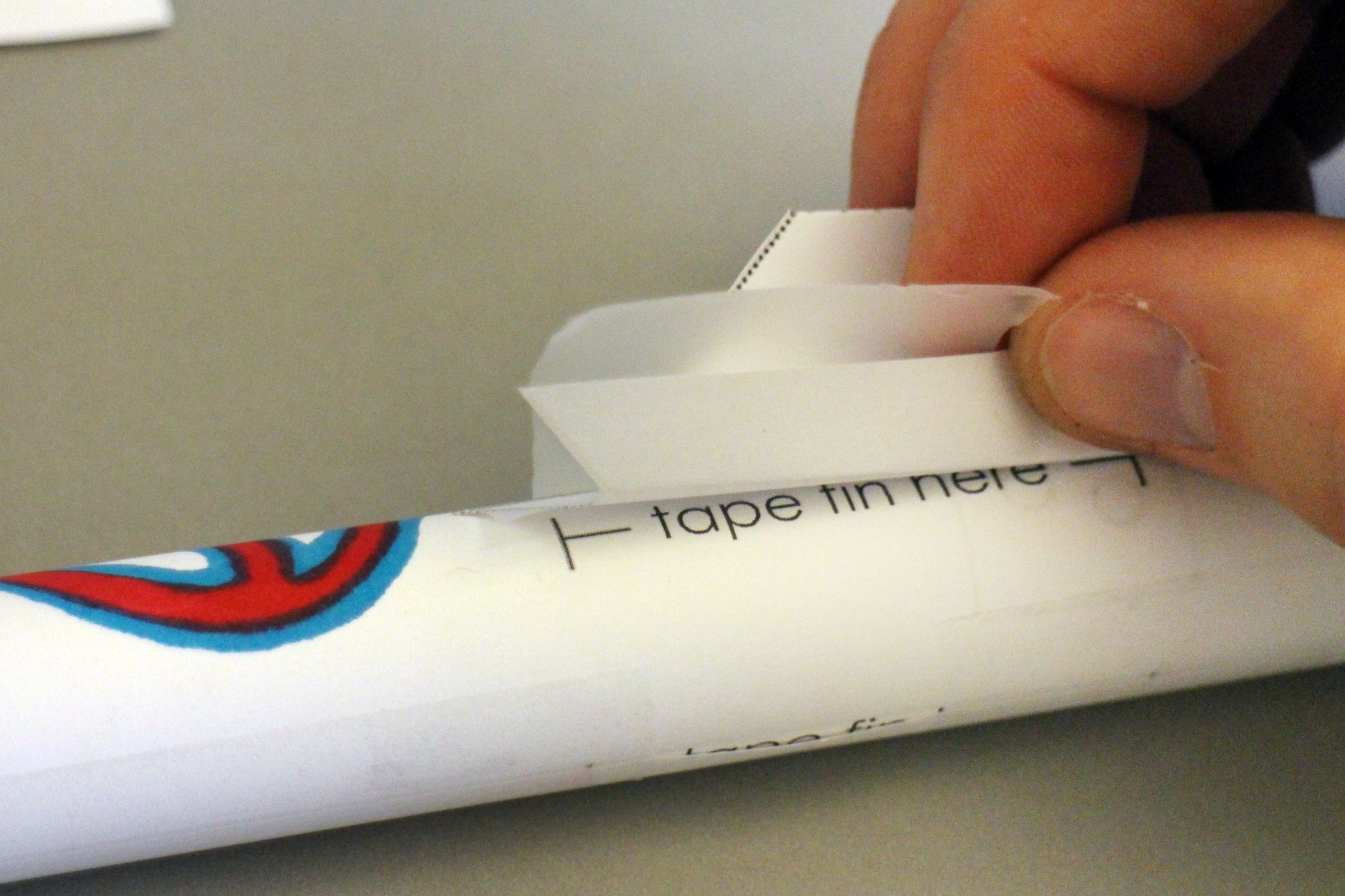

Place your decorated sheet with the design facing downward and roll lengthwise onto the rocket forming tubes, starting with the instructional area on the template and rolling until the decorations overlap the instructions. Sparingly use tape to secure the decorated rocket along its length to prevent it from unrolling. Make sure not to tape the rocket to the rocket forming tube.
Each paper fin will have dotted fold lines that show where to fold to get the right shape. Start by folding the fin in half, then fold each edge the opposite direction to make the mounting edges for the fin.
The template has marked areas where each fin can be attached after it's been rolled onto the rocket forming tube. Use tape to secure the fins to the marked areas on your decorated rocket.

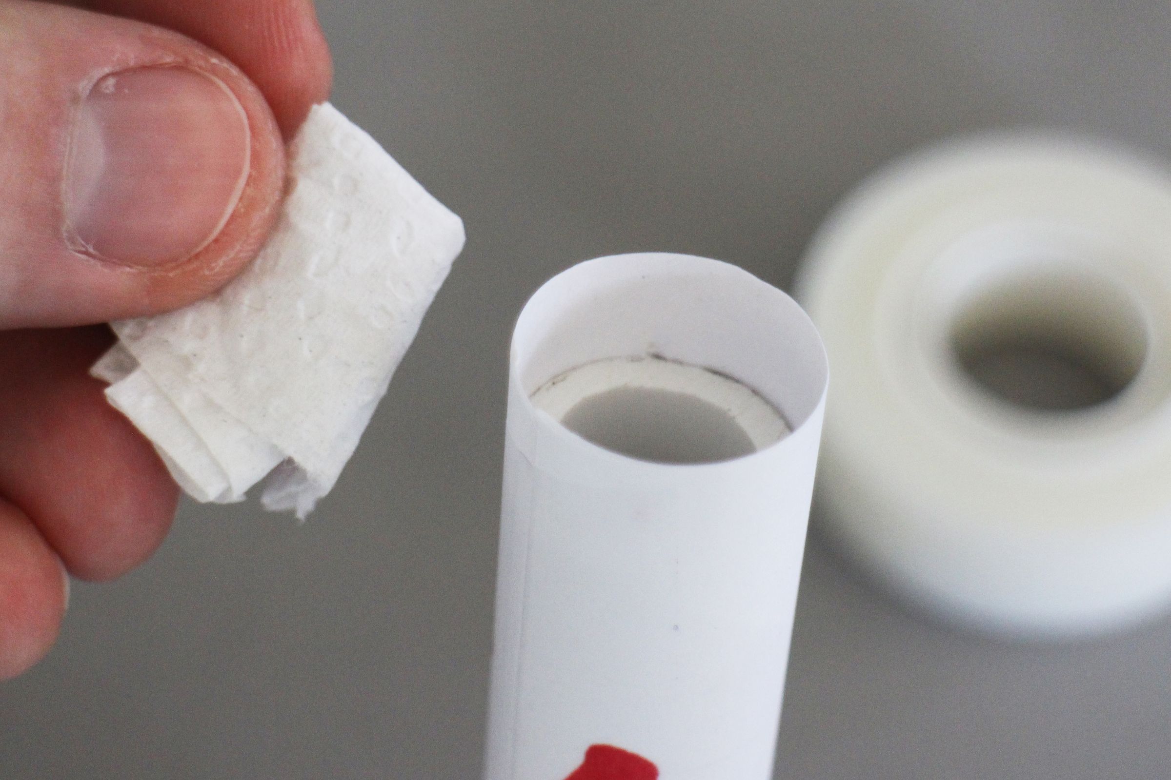

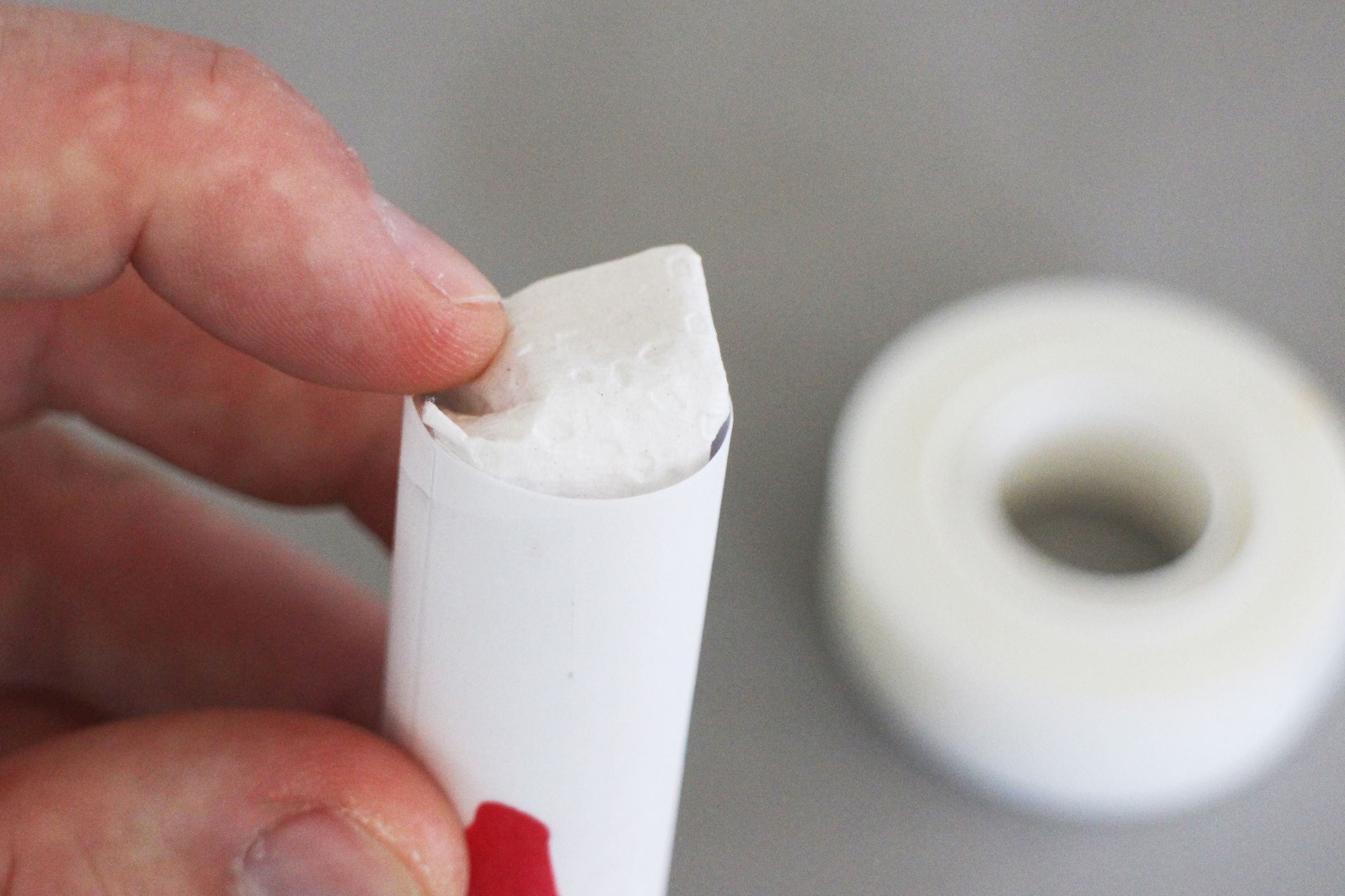

Step 14: Ballast

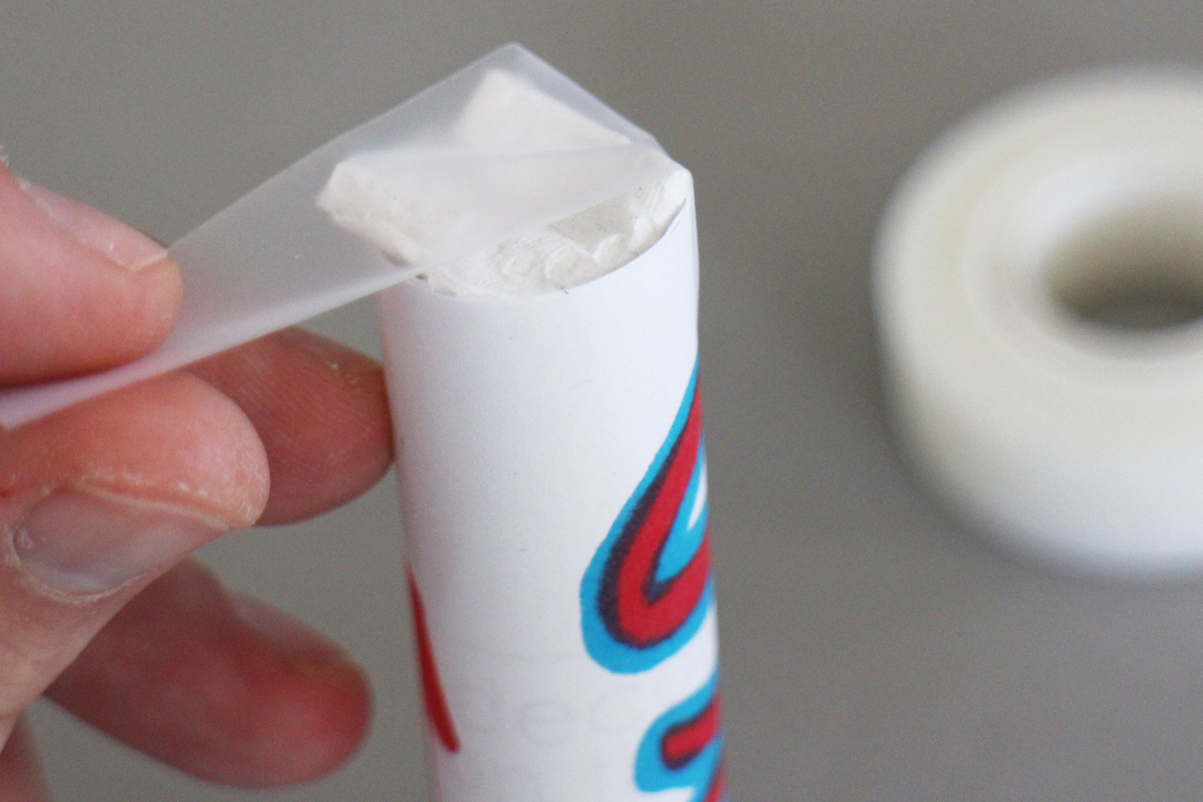

If we just taped the tip of the rocket and tried to launch they wouldn't go anywhere, as there needs to be weight in the rocket nose that will give the rocket mass for inertia when it's launched. Inertia is the scientific word to describe an object to continue motion in a straight line until it's changed by an external force, like gravity and drag. By adding weight to the top of the rocket, we're giving it mass which will allow the rocket to use the momentum we give it on launch and continue it's forward momentum. The weight added to the rocket is called ballast.
Since our rockets are very light they don't need much ballast; paper towel or cotton balls work well for ballast. With the rocket still on the rocket forming tube, wad up your ballast and place it on the top of your rocket. Slide your rolled rocket up the tube slightly to encapsulate the wadding.
Secure the wadding inside the decorated tube with some tape, ensuring not to tape the rocket to the forming tube.
Cover the entire top opening with more tape, sealing the ballast inside the rocket body and forming an airtight seal at the top of the rocket.
The rocket is now complete and can be removed from the forming tube. Continue forming as may rockets as you like, and if you made additional forming tubes you can have a few rocket making stations going at once.

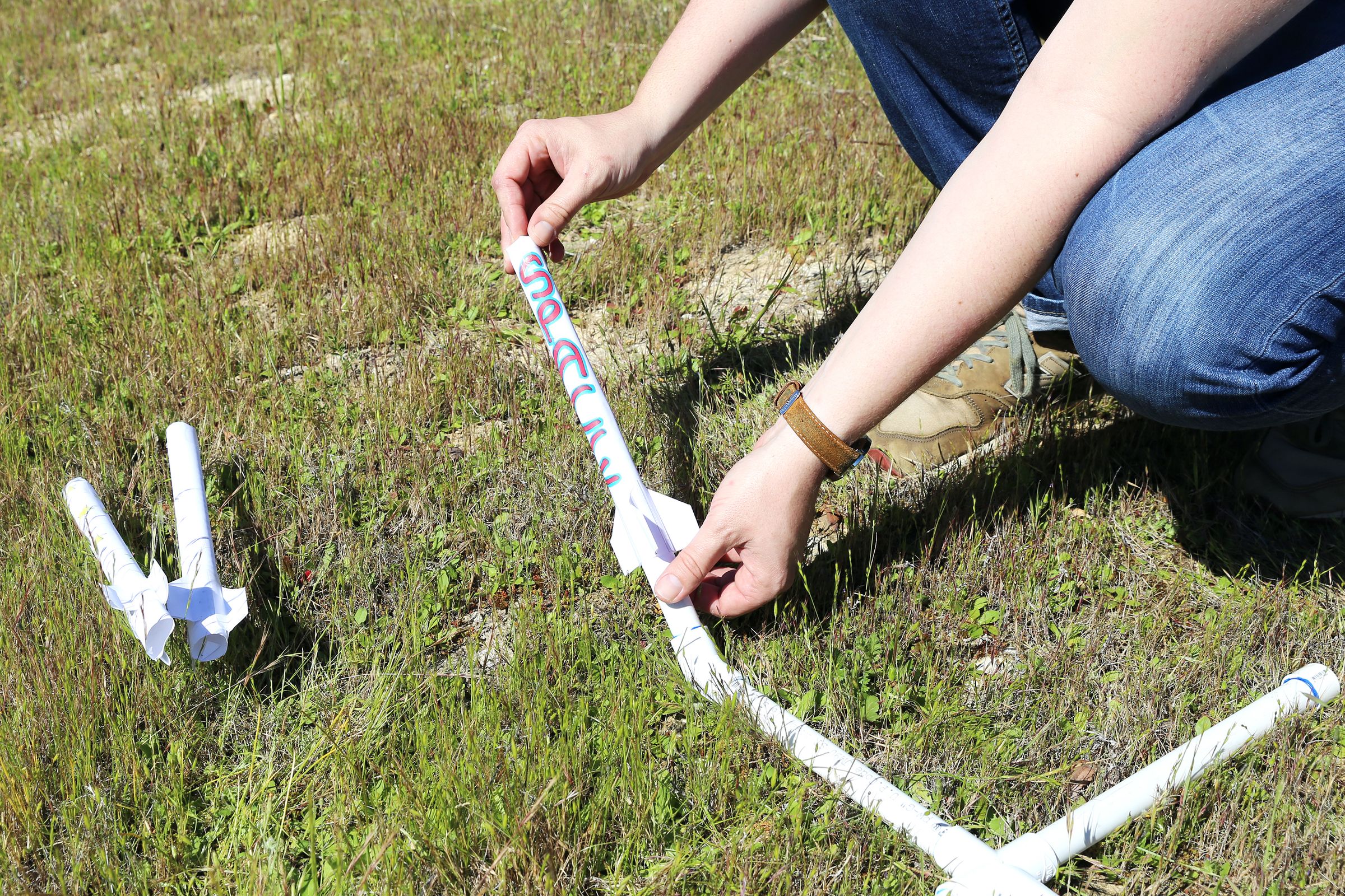

With all your rockets pre-rolled, place one rocket on the angled end of the firing tube and ensure it's on all the way.
Once the rocket is on the firing tube the empty bottle bladder can be added. By adding the bottle after the rocket has been installed you minimize the risk of accidentally launching the rocket before you're ready.
Screw the bottle into the threaded end of the launcher until it's tight and set the bottle and launcher assembly down on the ground.

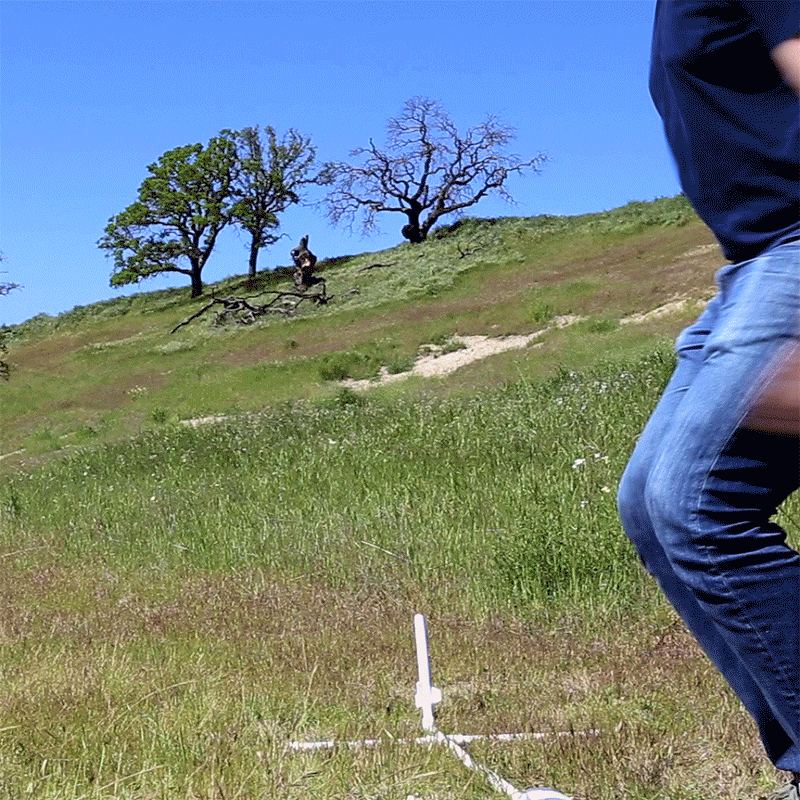

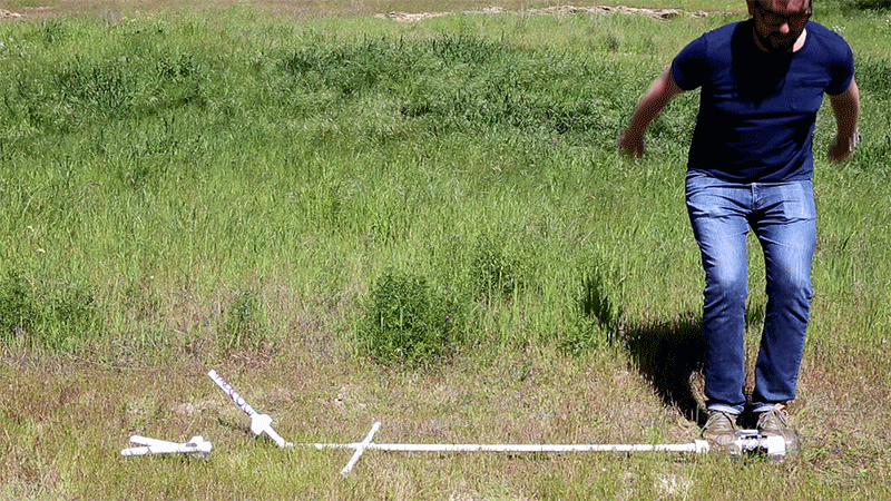

Step 16: Launch!
With your custom decorated rocket on the launcher, step up to the bottle and jump as high as you can and land with both feet on the bottle.
Timing your jump for both feet to land on the bottle will delivery the maximum pressure through the launcher and into the rocket, making it travel as far as possible. The same bottle bladder can be used multiple times, but after a few launches you'll notice that the bottle might be cracking and needs to be replaced.
