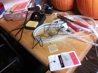

Electronics
-rectifier: You need this to convert the AC output from the bike dynamo to DC, which the LEDs need.
-capacitor: I used one: 4700 uF from radioshack
-LED strip: I purchased a 5 meter (~16ft) $15 strip off Amazon. The important part is it takes 12V. You could use another type of LED strip. This one came with a controller and remote, but you could definitely modify this project to run off your own, potentially Arduino-powered, LED strip (but those weren't in the budget). I bought a weather-proof one. If you buy RGBW instead of RGB you will have problems finding a y-splitter for it, unless you want to make your own (RGBW is 5 pins, RGB is 4).
-old or cheap 12V/650mA+ wall charger (or 12 -to- whatever the range of your LED strip is - mine took 12 to 24 V. I just plugged the charger in directly to the control box first to make sure it worked. your strip might need higher current than 650mA, it depends, mine would run off anything under 2000mA). Quite a few devices you might not need anymore could have these, like this one. Check your cable box!
-cables and alligator clips (we used alligator clips throughout testing)
-breadboard (you could do this without one, but it would be a lot neater and less likely to short out if you get one!)
- y-splitter to connect 2 strands of the LED (one for each chain side of the swing - you will be cutting the LED strip) to the control box
-1 or 2 4-pin pieces to convert the female ends to male ends. If you are doing RGBW you will need 5 pin ones or to make your own using these. The pins come with the y-splitter (as in link above).
-extension cable for the power (5-12V DC plug extension, probably 12ft, can find on amazon, 2.1mm x 5.5mm). not pictured.
-velcro for the cables
-electrical tape
-tupperware or other container to house the completed circuit and battery
if you are going to do the battery addition:
-switch (we used a SPDT - single pole, double throw switch like this one)
-diode to protect the 12V battery (FR202 "fast recovery" diode with 2A forward, 100V backwards works - some diodes with lower forward voltages might be better at charging the battery)
-RC/hobby 11.1V (12.6V fully charged) LiPo battery with pins for attachment (usually comes as a set from hobby stores)
tools: soldering iron, solder, wire cutter (one that can remove insulation), voltmeter, scissors to cut LED strip

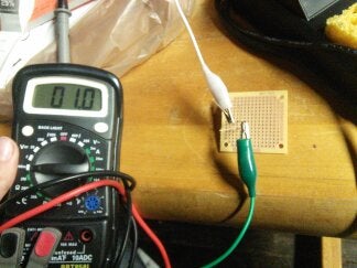

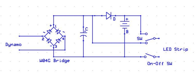

Step 2: Circuit Step 1: Rectifier
Note that out circuit diagram above does not include a protective diode, which we add in the full circuit later. Right now we are just looking at everything to the left of the switch and battery - that is just a rectifier and capacitor. From that you just add output cables, and that is all you truly need unless you want to add the potential for a battery (if you do, you can take this circuit with you anywhere and attach the dynamo to a bike wheel and run LEDs off your bike using combined battery and dynamo power as you ride! so it adds versatility. Additionally, the battery can let you take photos in the field while no one is on a swing, etc, and be recharged through use)
The first thing you need to add is the rectifier. Here we used a bridge rectifier. This converts the AC signal from the bicycle dynamo to DC.
It has a specific polarization you need to keep in mind. This should be marked on the rectifier, probably with a + sign. The negative pole is directly opposite it. The other 2 leads are for AC input. they are -not- polarized. You can check the polarization with a voltmeter. If the positive lead is on the positive terminal of the rectifier, it will register positive (on most voltmeters this will be a 1.0). If the positive lead of the voltmeter is on the negative terminal of the rectifier, it will register negative.
Solder the rectifier to the breadboard when you achieve the orientation you desire (you will be adding a fairly large capacitor, so keep that in mind! leave enough space!)
After the other components are added you will want to add shrink tubing to and cut one of the 2 AC leads shorter than the other - so that they cannot short each other out. you will end up trimming any excess from the + and - leads as well so they can't short anything out. keep this in mind as you are adding the capacitor and DC output cable!

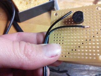

Step 4: Circuit Step 3: Add Capacitor
I used a 4700uF capacitor from radioShack.
This definitely has polarity as well. Usually they have a negative marking, or arrows pointing to the negative side. You will be attaching and soldering these legs to the same points you attached the output cable in the last step to. These attachment points will each have the correct leg of the rectifier, the correct leg of the output cable and the correct leg of the capacitor. You will likely need to bend the legs of the capacitor to attach them horizontally on a small board.
Solder the capacitor legs to the rectifier and output once you have checked that they are correctly oriented as described above).

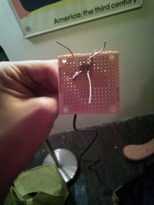

Step 5: Adding a Battery and Switch to the Circuit (optional)
This step is entirely optional! If it is beyond your scope and soldering skills, don't worry! the circuit will work with just a capacitor and a rectifier. All you need to do is trim the + and - ends of the rectifier, and then add shrink tubing to the AC input leads of the rectifier and cut one shorter than the other so that they won't interfere. you can see in the photo of the underside of the circuit above the AC leads before we cut one of them shorter and added the tubing (just insulation so nothing would short out). At that point, you can have a fully functioning swing light circuit, already!
now, if you want to add a battery, so that you can have the option of powering the strip without motion or maybe charging devices (you might want to modify it further for that):
In the end we ended up reconfiguring the circuit, according to the diagram (minus one switch - you only need one as the LED strip is controlled by a remote)...the switch labeled "on/off" is optional.
We learned that we had put the capacitor in inefficiently - it could take up less of the board a different way.
We added a switch, 2 jumpers (small insulated wire pieces), pins for the battery connection, a 100V reverse voltage and 1.2V forward voltage at 2A FR202 diode to prevent charge from flowing back into and damaging the circuit and dynamo and to allow charging when the battery is not in use, and a 11.1V (11.1-12.6, fully charged) LiPo battery from a RC hobby supplier. The diode is a change from the circuit in the first step.
The diode does not protect from overcharging the battery, just from backflow and discharge of the battery when not in use. The battery we used is 1000mAh.
Keeping the original setup (but moving the output cables a little) the battery (cable to attach the battery to/header pins) is attached in parallel with the capacitor, with the diode in series with the + end of both. A SPDT: single pole double throw switch is added, where both sides of the switch turn on (the up position powers the circuit only via the battery and diode, the down position allows the light strip to be powered directly from the rectifier circuit.) The battery charges off excess voltage- when the voltage exceeds the forward voltage of the diode (1.2V) and the current voltage of the battery. To not use the battery, disconnect it or use an on-off-on switch (the SPDT switch here does have a center position where it is not connected to either side and can only charge the battery, though - and is effective).
You can see the completed circuit in the photos.

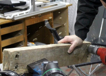

You will be drilling the wood next. In this case, the holes need to match the placement of u-bolts (or another similar attachment mechanism). You could alternatively use eye-bolts. Even with rope, I like to have 2 holes on each side. Usually, I need a 17mm drill bit for 10mm rope. We used a pre-made swing from my former projects for the u-bolt, and the 17mm holes were slightly wide, but worked. Not everyone has quite so large wood-working drill bits on hand!
Test the u-bolt sizing with the drilled holes and mark where you want to drill. I bought what I think was 2 3/4" u-bolts, but the next size up is probably even better.
whatever you do, do not consider nailing! I used those once with a swing, never again! they are dangerous, especially when a piece of wood is subjected to weight. Use bolts, and if anything is pulled upwards, make sure it is pulled upwards against the bottom of the swing, securing it in place.

Step 16: Drilling Holes
You will need to drill the holes for the swing chain in a slit shape. The angle of ours' formed almost an "X" if you were to look from above as the width of the PVC accommodated slightly more than one link, and they are offset from each other. As these slits will likely still be a little loose around the swing chain, you will need to secure the chain to the swing arm (this has nothing to do with weight bearing). We used zip-ties for this.
We used a drill and a dremel for this process (and a hacksaw, but let's not talk about that, you shouldn't try that). A file would also be good.
You also need to drill holes in the arms the bike chain or cord goes through, wide enough for the cord. Even if you are using all bike chain, you will probably need a tiny bit of cord at the top to secure it.

Step 19: Testing Your LEDs
This needs to happen with both your rectifier + capacitor circuit and your battery. If you choose to do the full circuit, simply flip the switch between testing and roll the wheel with your hands (or you can use the swing if you're lucky enough to be able to at this point and extra careful!). Make sure they function as you expect. Pictured is a 4-pin connector needed to plug the LEDs into their control box. your LED kit should come with this. Keep in mind you will need this for the cable routing!
Step 20: Cutting the LED Strip
There is a good tutorial here:
http://www.ecolocityled.com/category/soldering_led_strip_waterproof
Most pre-made strips have regular marks, RGB or RGBW, etc, that will designate the points at which you can cut the strip. You can usually just use scissors.
We cut 2x 5ft pieces (after making sure 5ft was the length we would use) off of the strip, one from each end, so that each piece had one adapter on it. Keep in mind that you will now have 2 pieces, one with a male adapter and one with a female adapter. To route the cables to a y-splitter later, you will need an extra 4-pin male adapter piece to make them both male.
