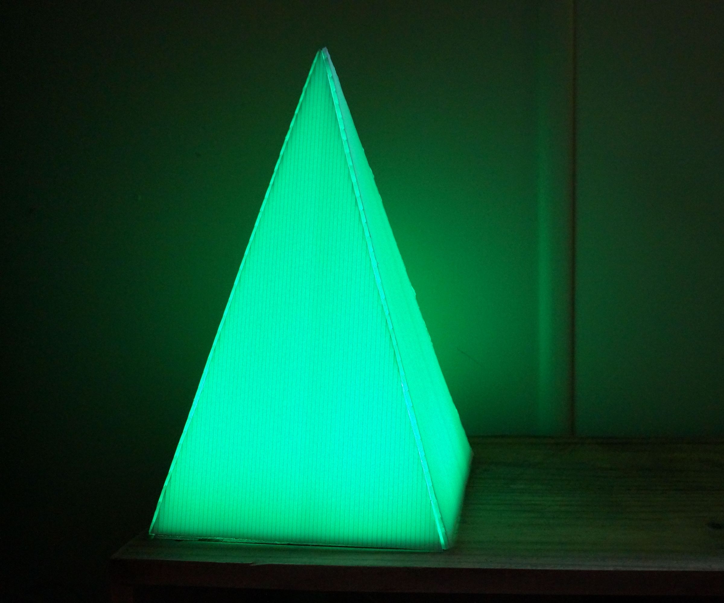

Tapping Light or 'Tap Light' is an IRL version of those fun games you play while you are waiting for something to load. Be that a video game level, an awesome Youtube video, or just google.com (thanks internet!)
It uses an Arduino Nano combined with an WS2811 led (love these!) and a Piezo Tap Sensor. This is bundled up inside an awesome wood and acrylic case to give you the Tapping Light.

Step 3: Circuit
Now grab the Piezo tap sensor, Arduino Nano and WS2811 LED.
First, some pre-flight steps:
- The Arduino Nano should not have pins soldered to it.
- The WS2811 LED should be sanded down to be nice and small & square
- The Piezo Tap sensor should not have pins soldered to it.
Once that is checked, you can proceed to create the circuit.
- The Piezo Tap Sensor's 2 outputs need to go with 1 of them (doesn't matter which) to ground and the other to analog in 7
- The WS2811 LED's +5v and GND go to their respective pins while the DATA IN needs to go to digital pin 9.
After all that, get the components in a good position with the LED preferably in the center, then secure it all down with hot glue.
